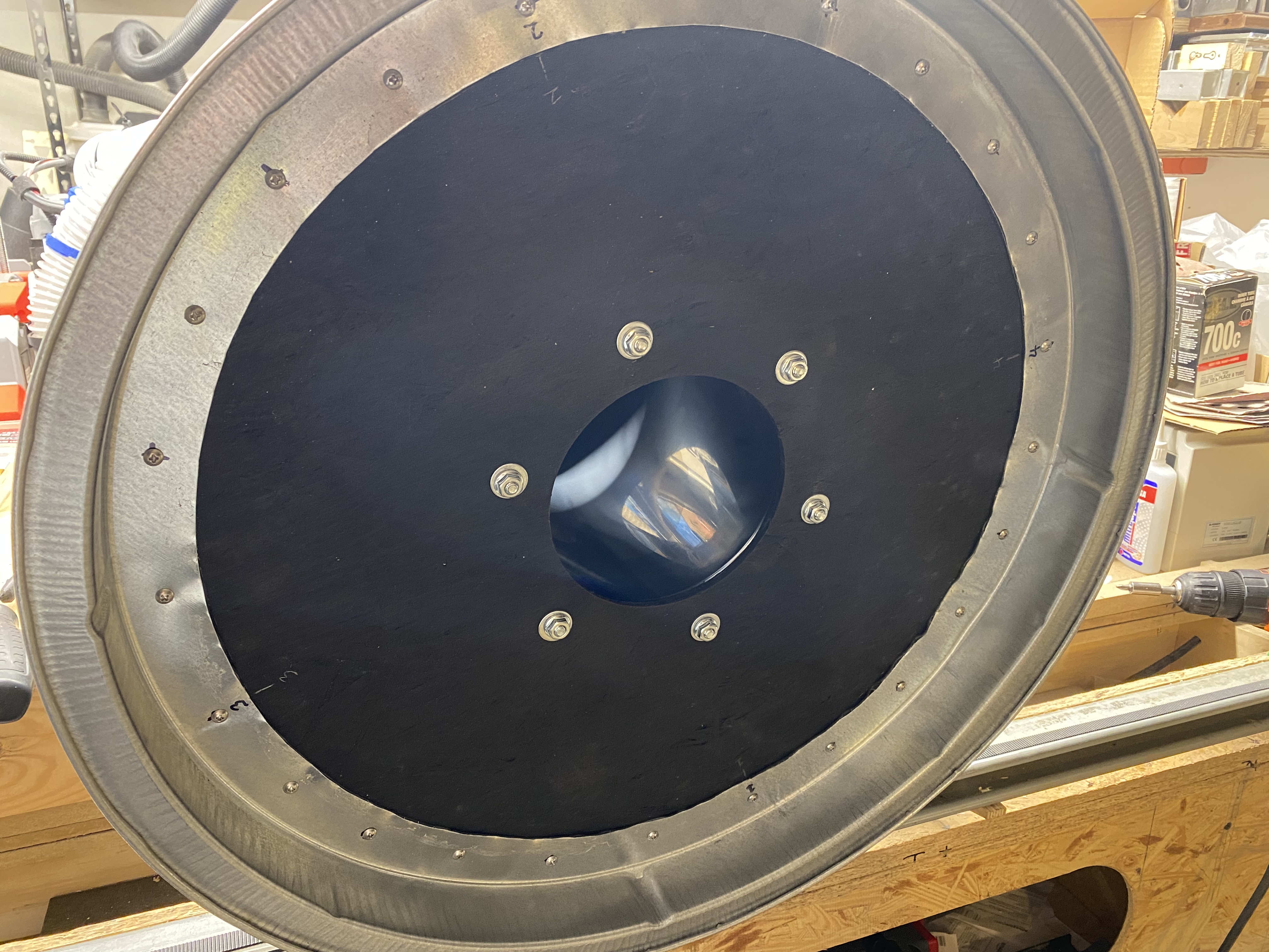

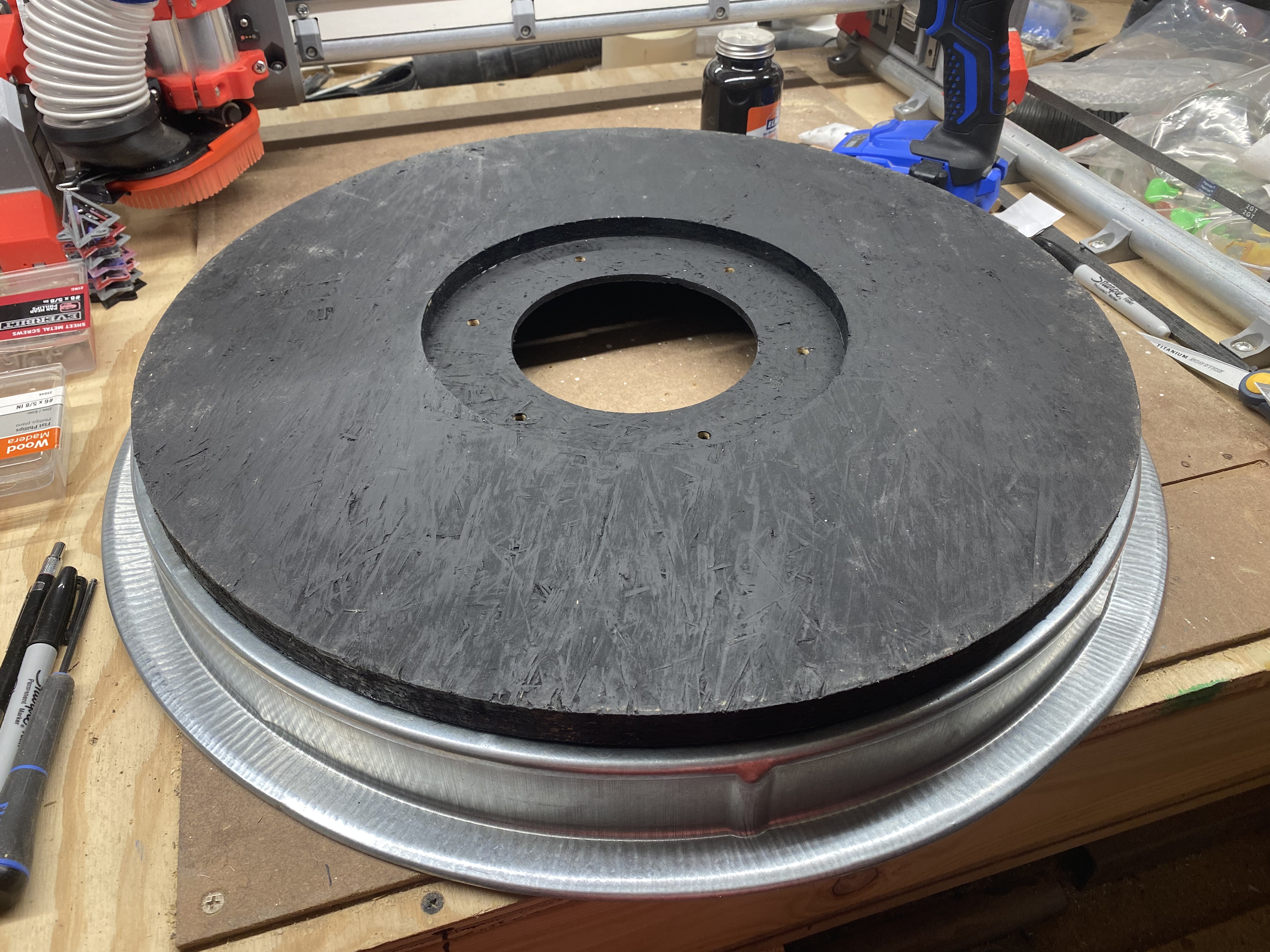

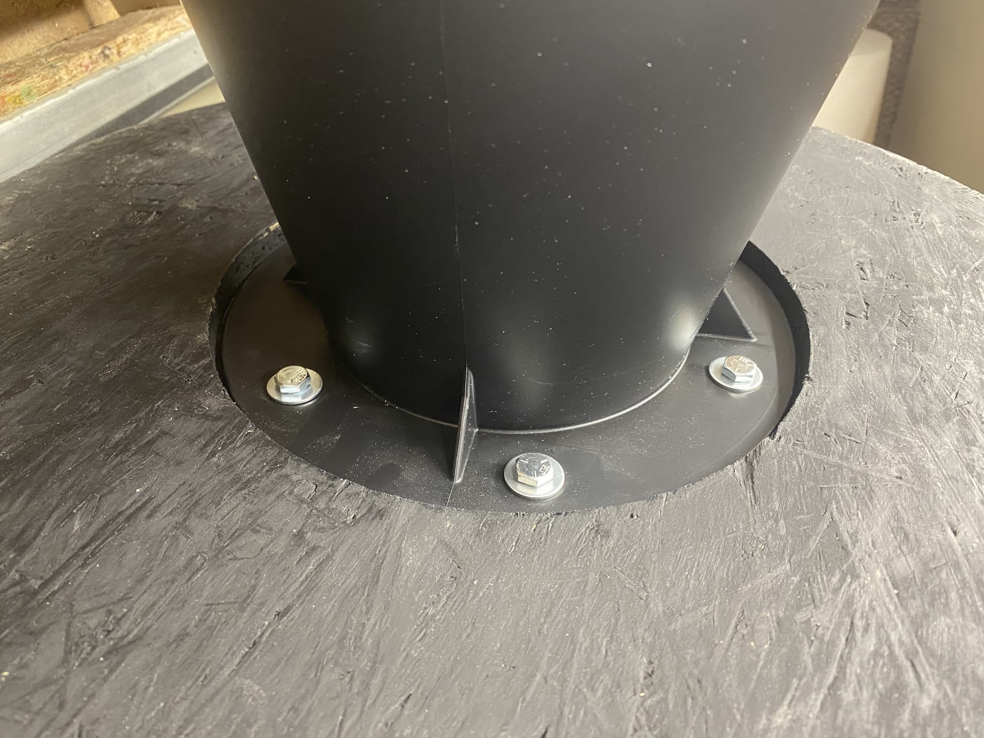

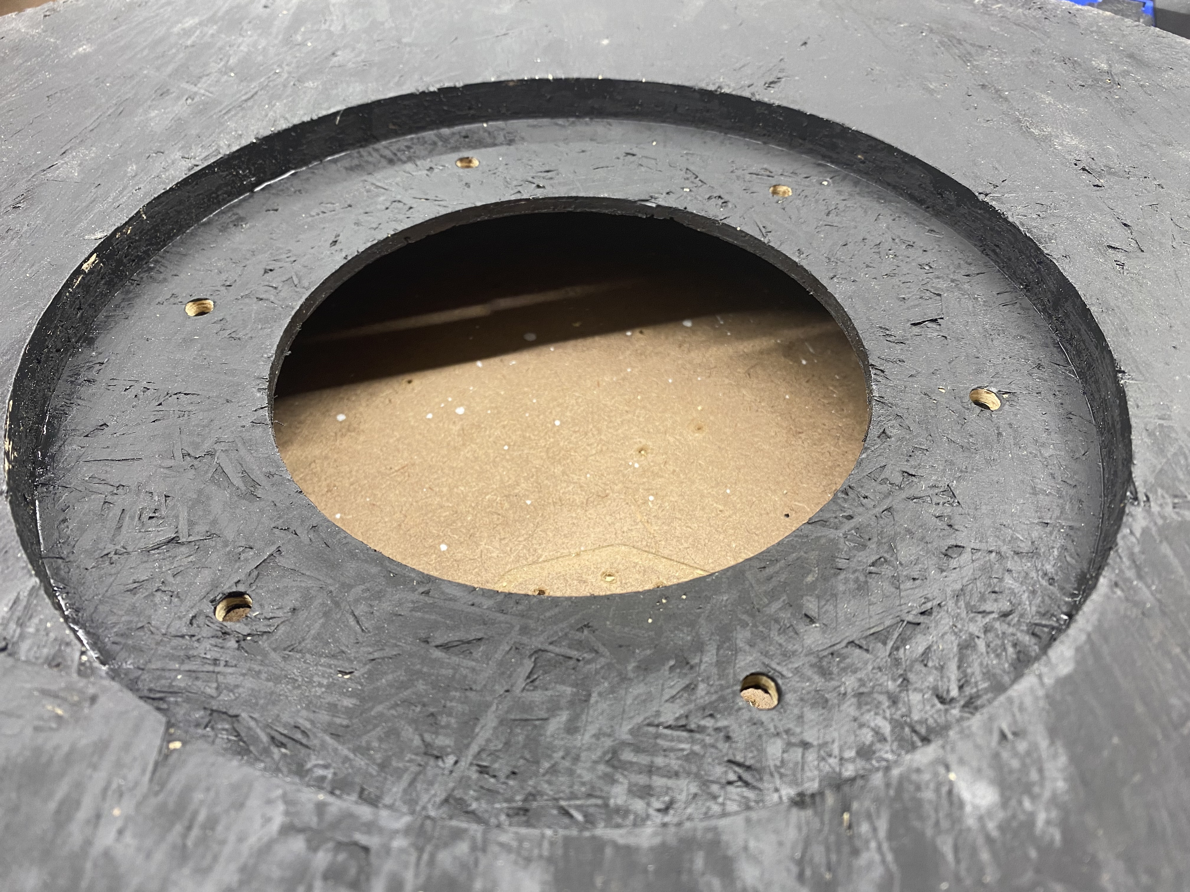

I used LR4 (RC3) to cut some weathered “Avantech” (sp?) brand OSB to create a new lid for a trash can being turned into dust collection bin for Super Dust Deputy 4/5. Between a little sanding and some black enamel RustOleum paint, the fact that it was weathered won’t matter, thus it’s being salvaged instead of thrown away.

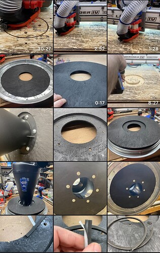

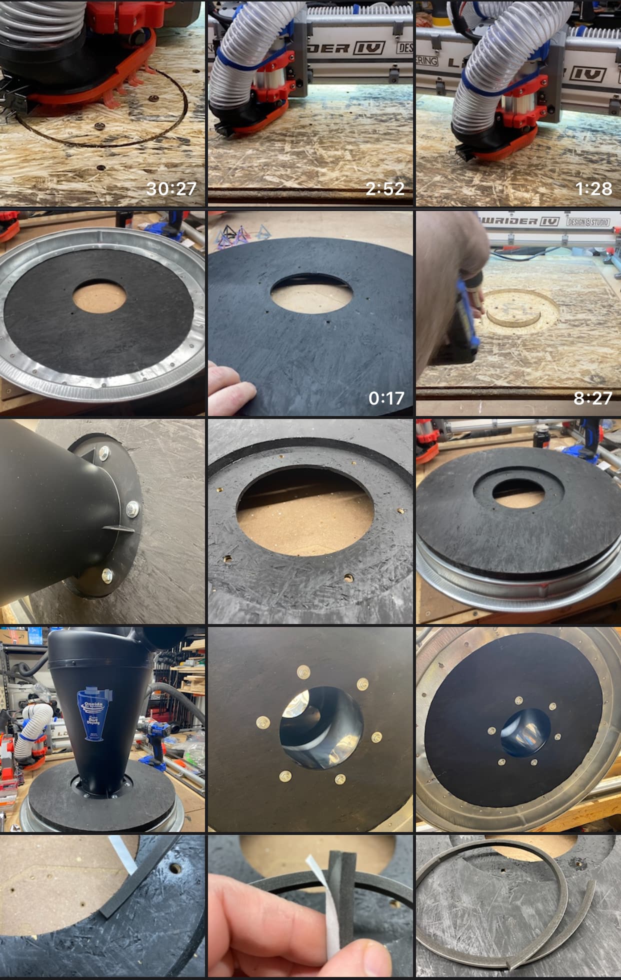

I videoed the drilling, pocketing, and cuts, but I have not edited or posted video.

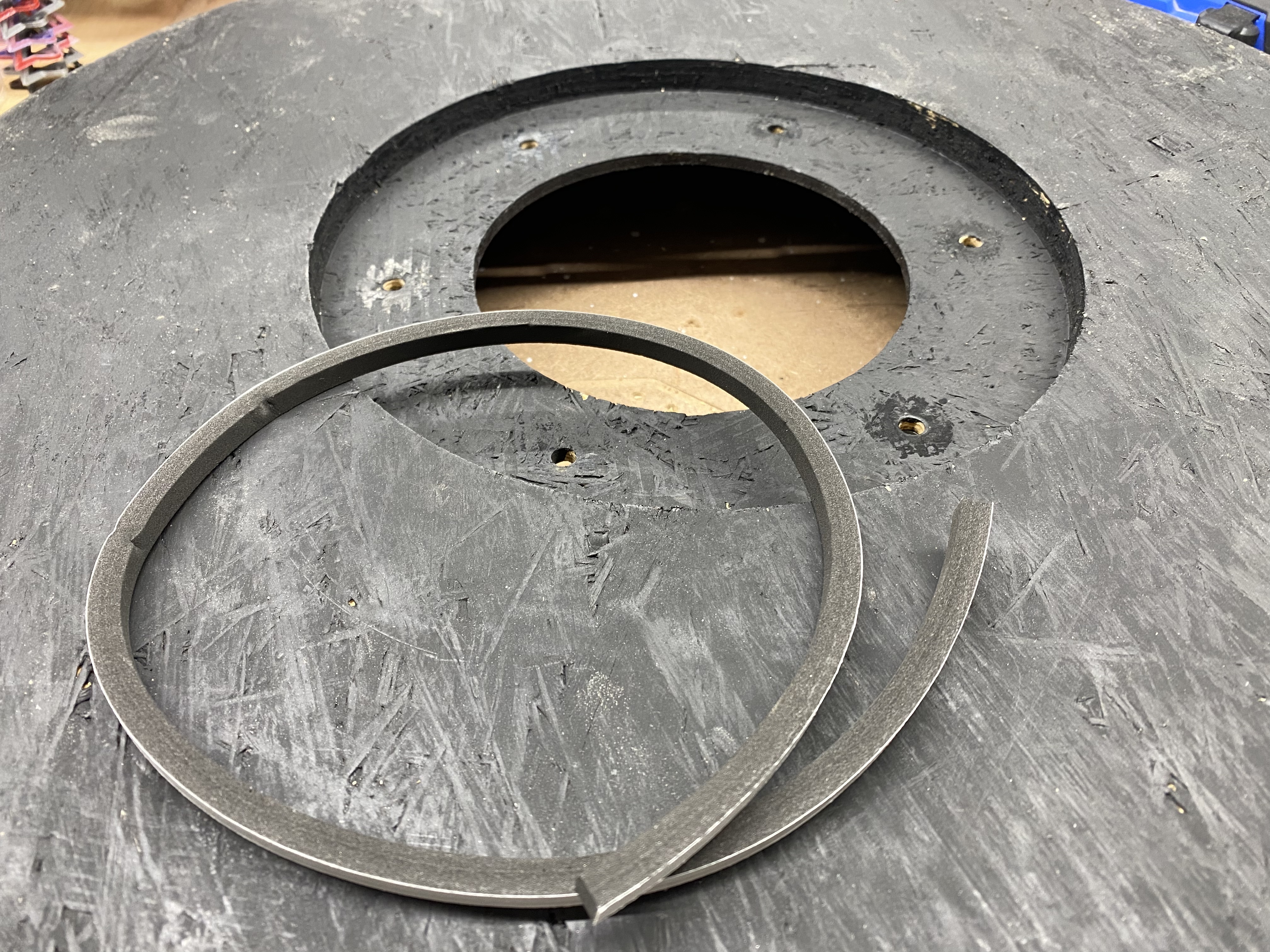

The top of the new lid. Pocketed simply because the provided bolts were for a lid no thicker than 1/4" and “I could so I did.” LOL.
The pocketed area was about 1 or 2mm larger than the base of the Super Dust Deputy 4/5, for easy fit. Shown below.

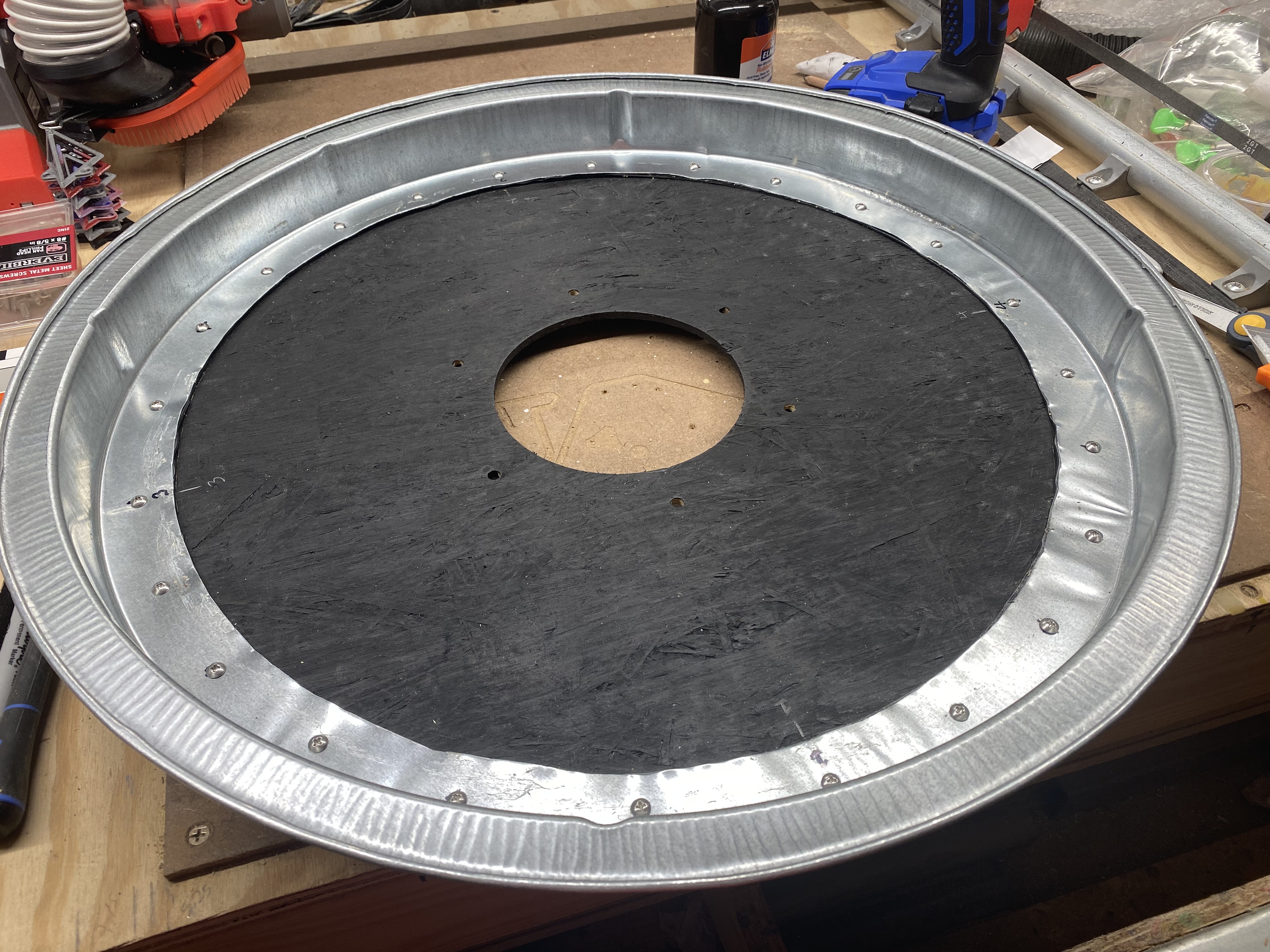

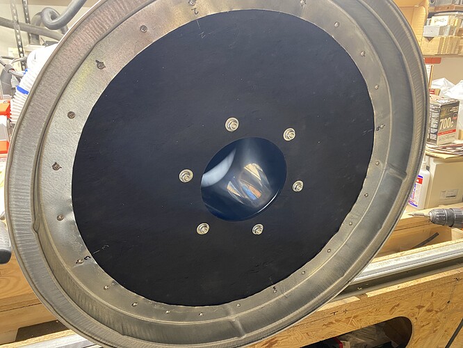

The under side. The trash can’s lid had a domed shape to it, so I cut most of it off, leaving only the outer “disk” which was “mostly flat.” I cut a bicycle tire inner tube to use as a gasket for attaching the wood to the metal trash can lid.
Pocketed it with the same 1/8" bit I did the drilling and cutting with. Only took slightly longer, and I got to be lazy and not bother with a tool change to a 1/4" or something.

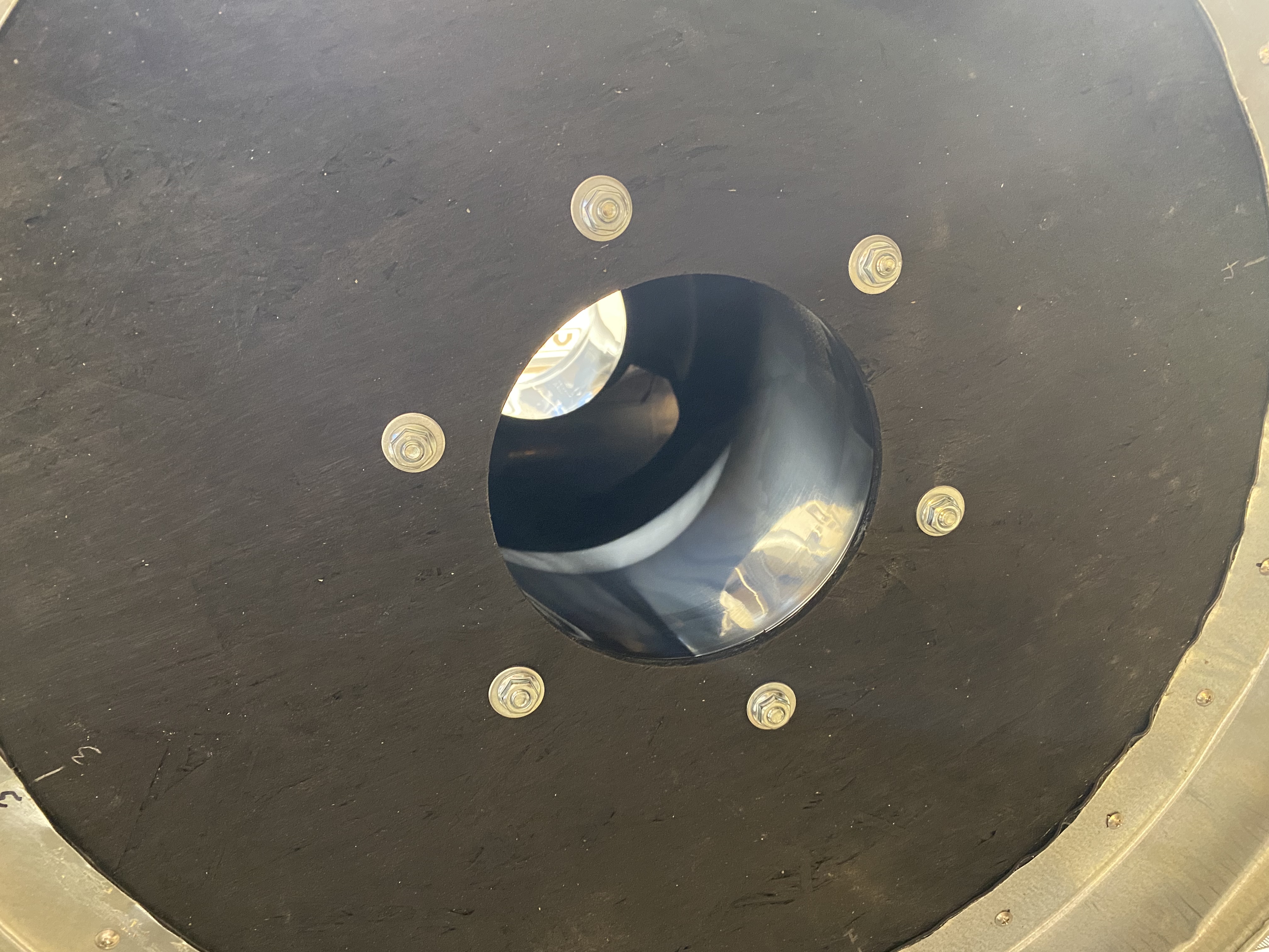

Test fit of bolt hole locations.

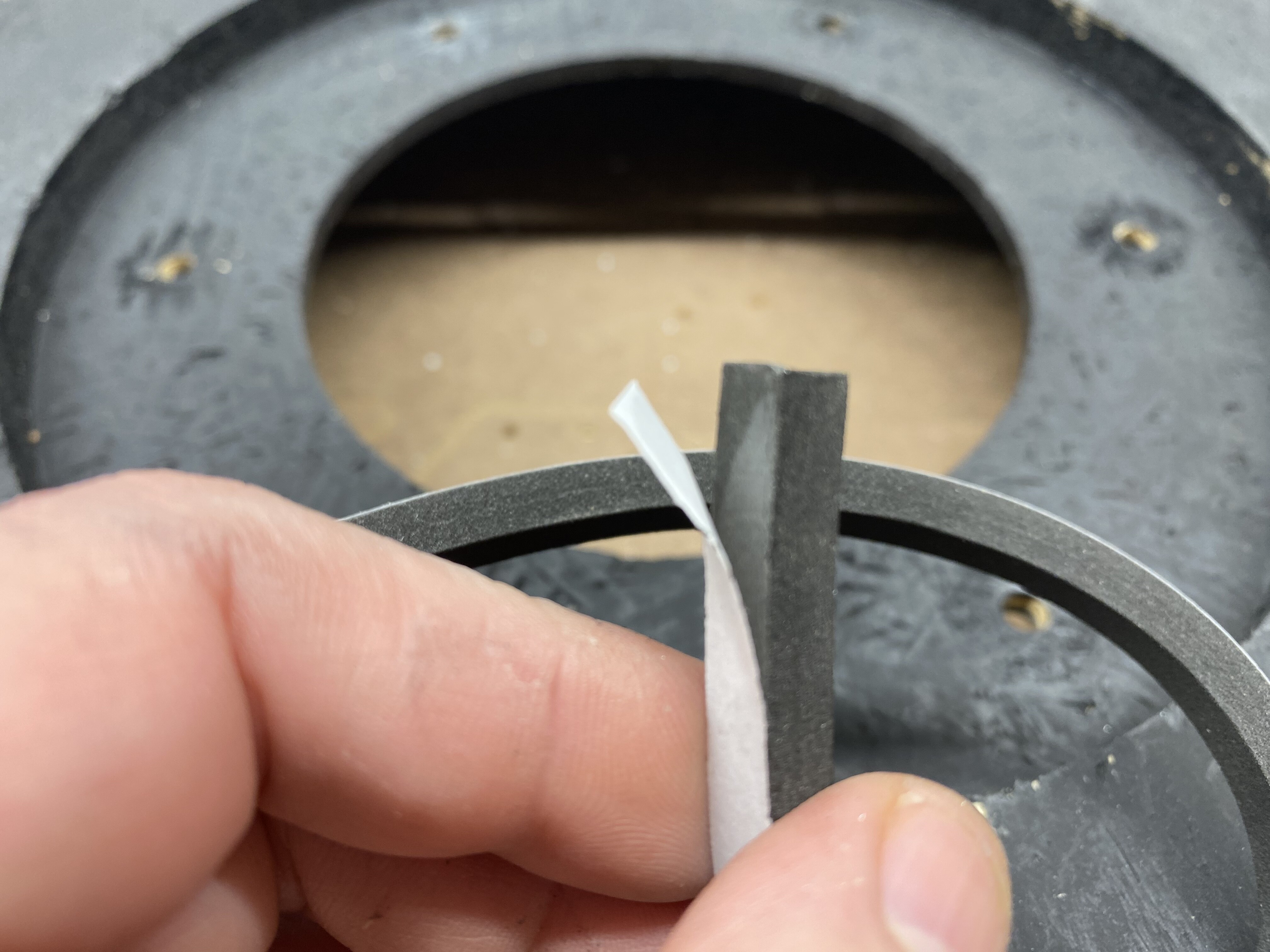

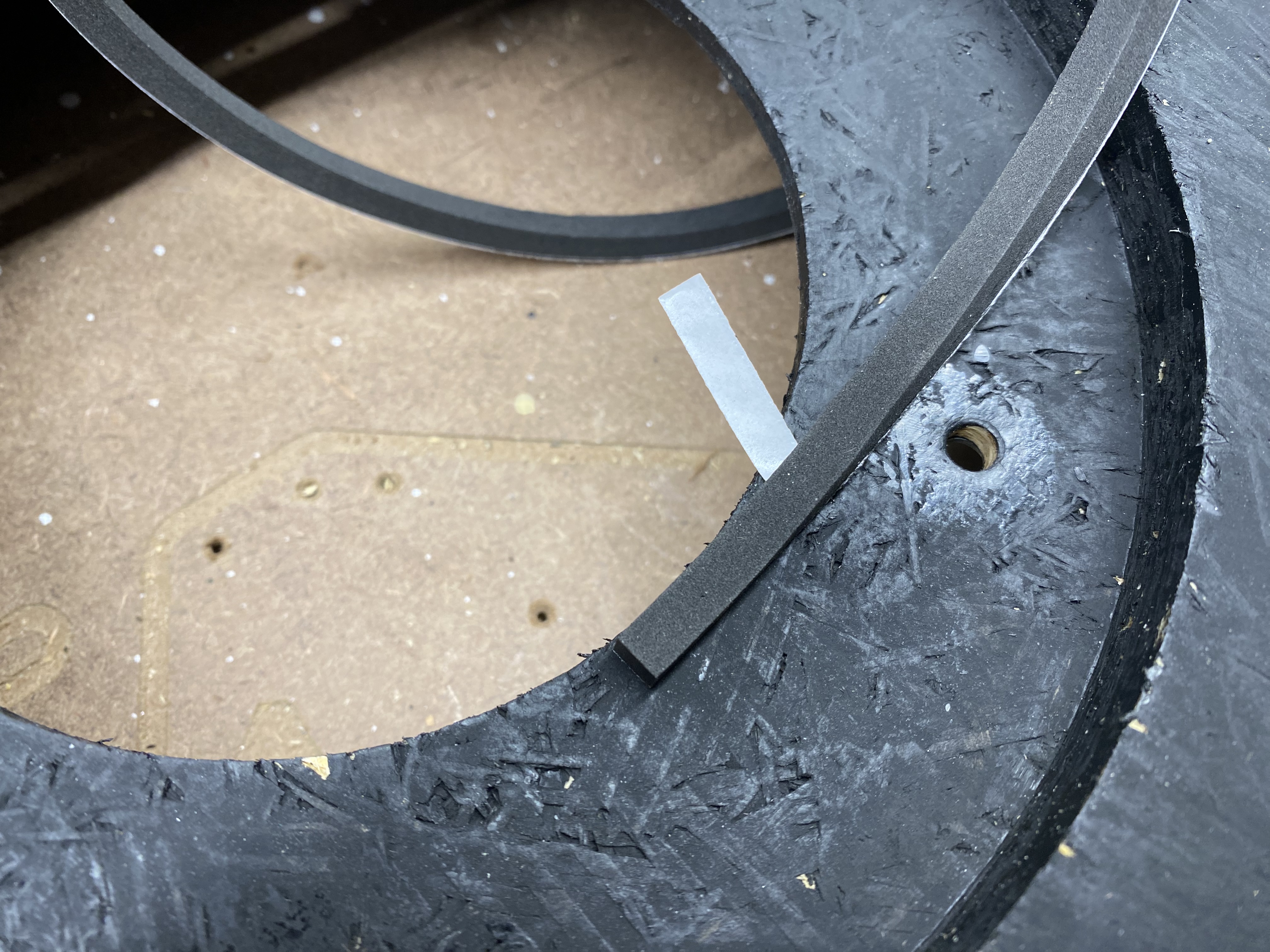

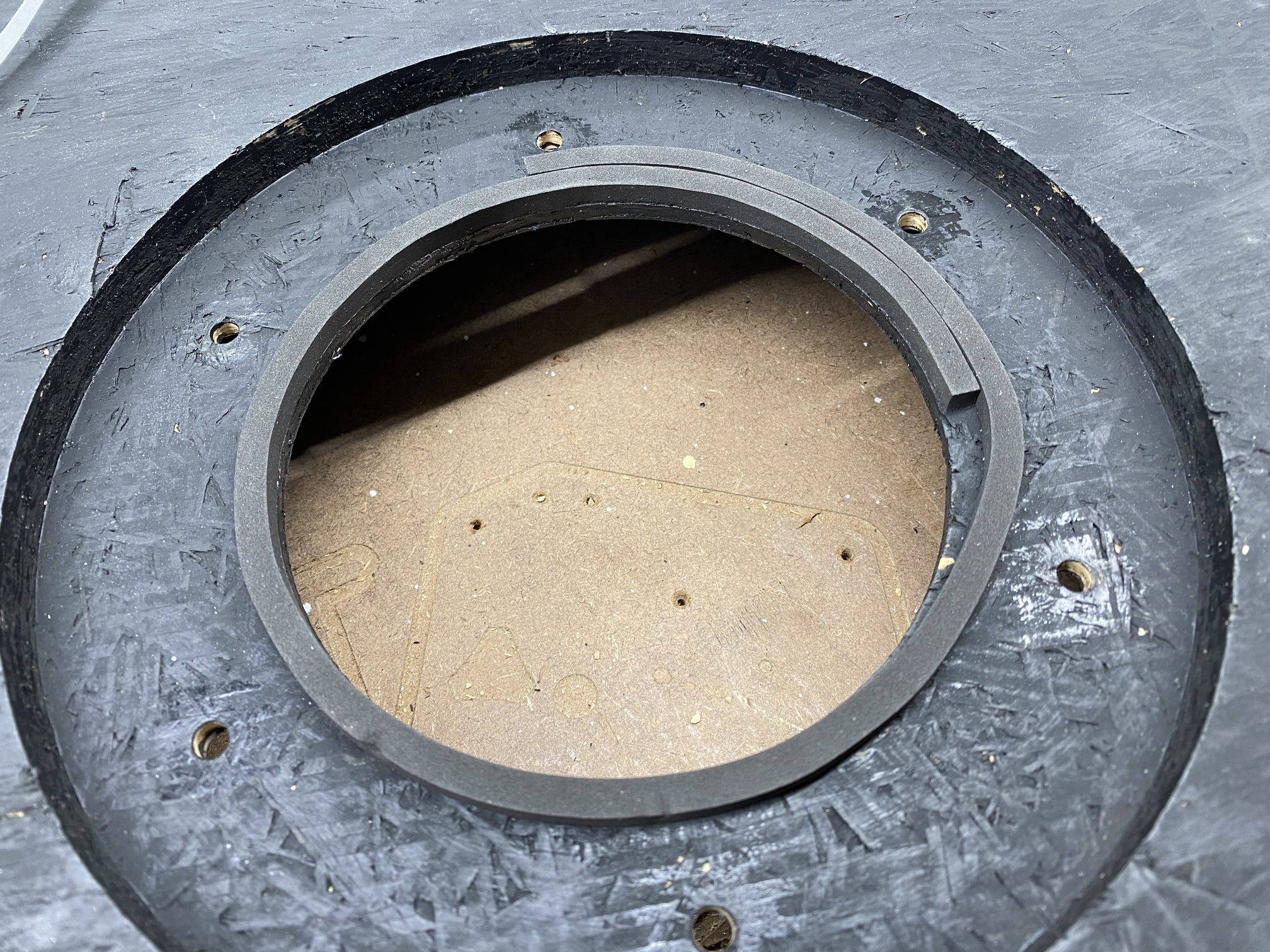

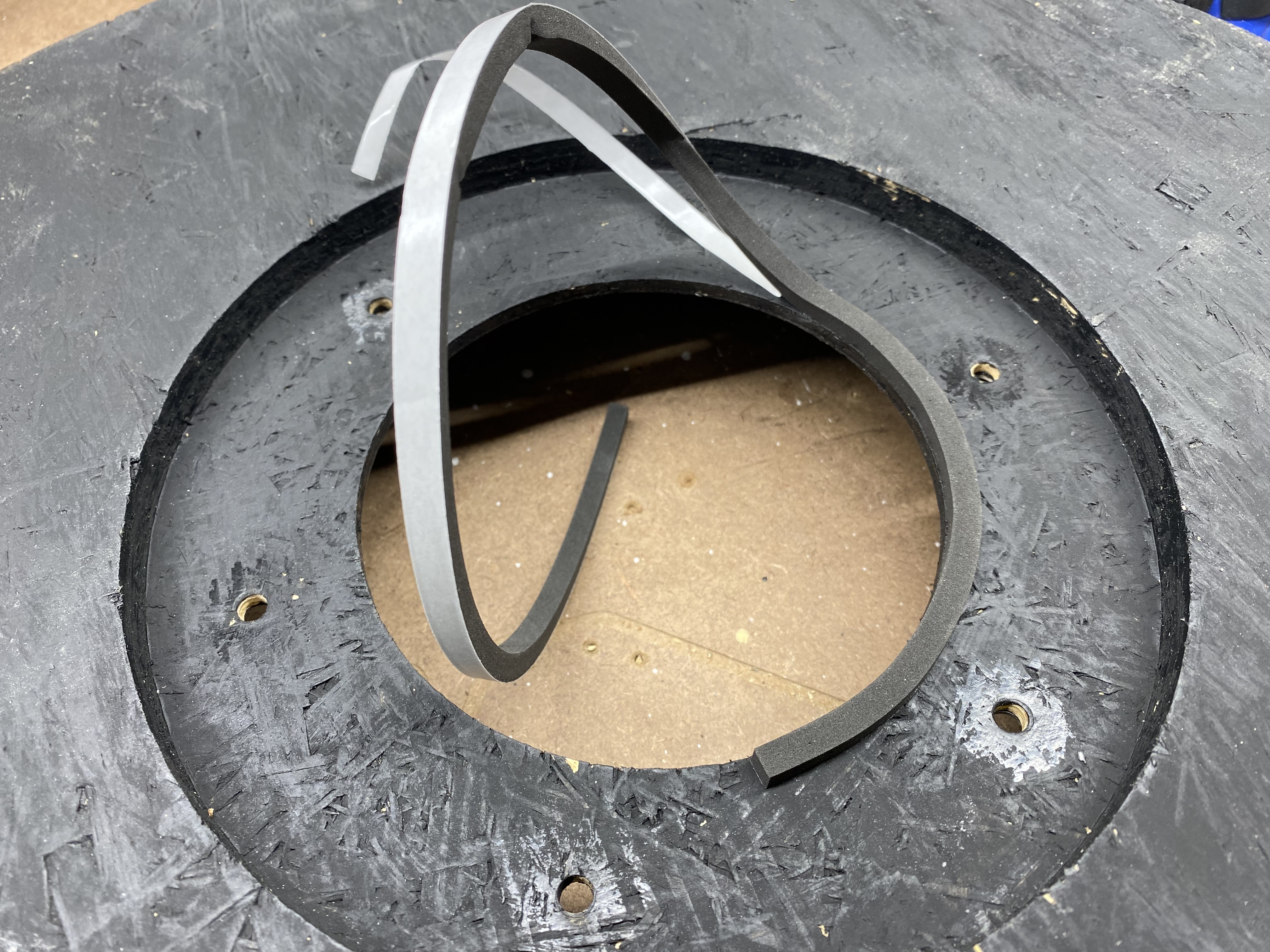

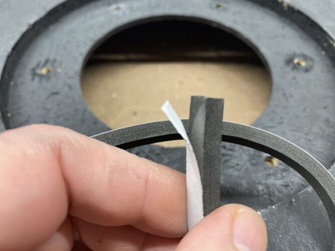

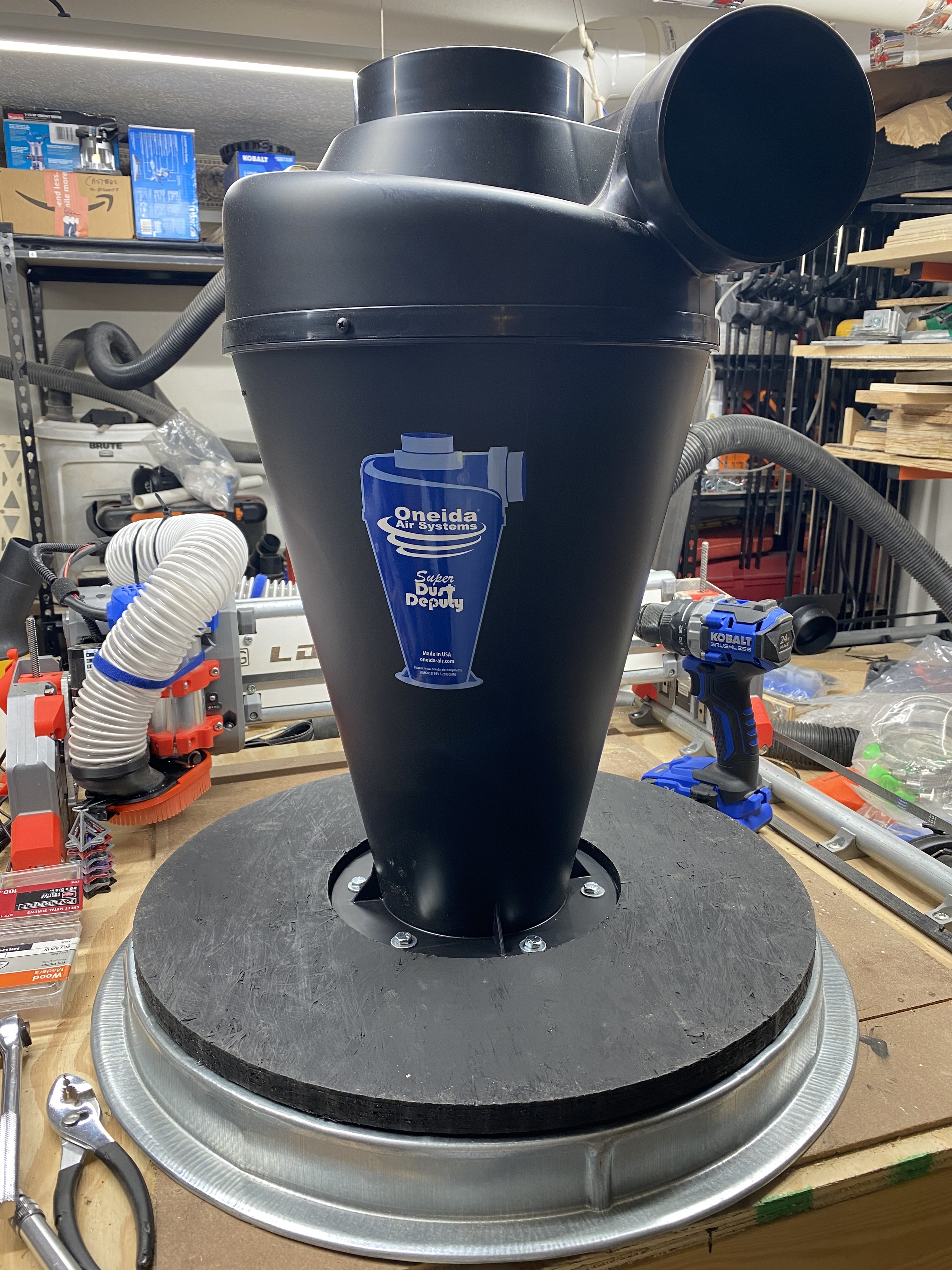

Time to peel and stick the foam gasket provided with the Super Dust Deputy 4/5.

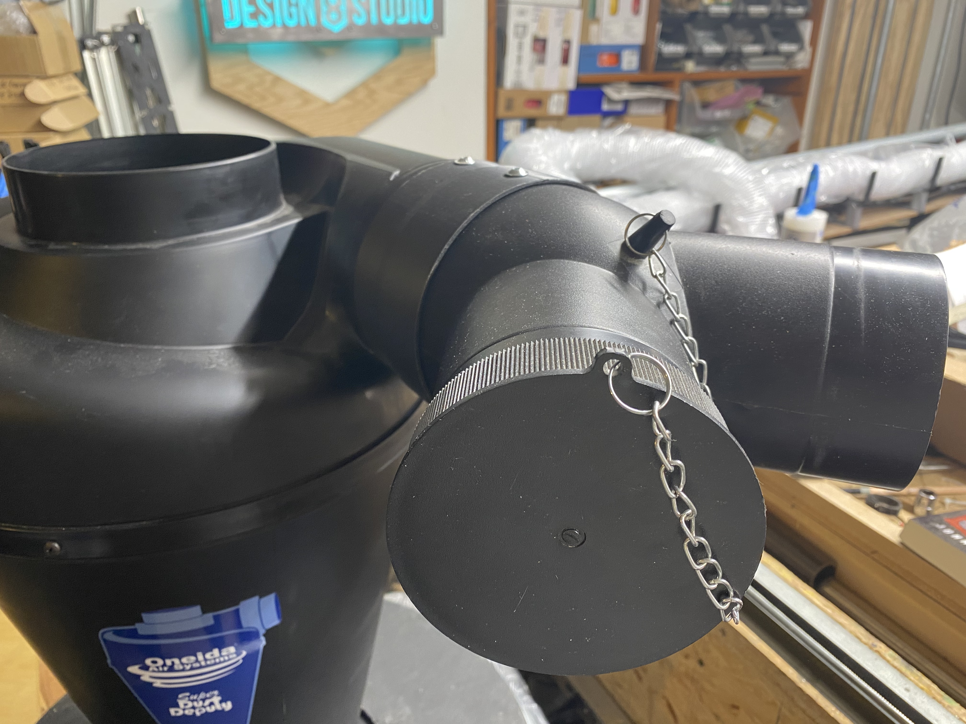

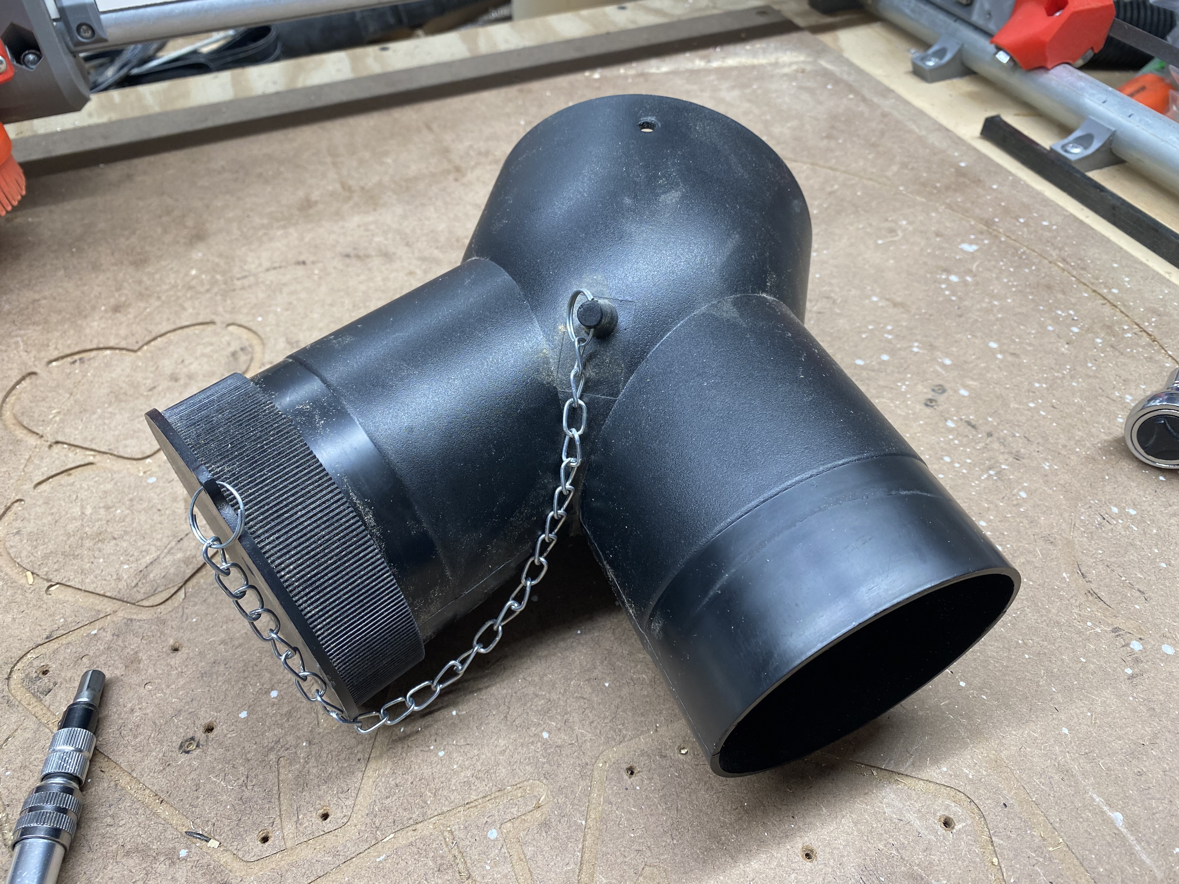

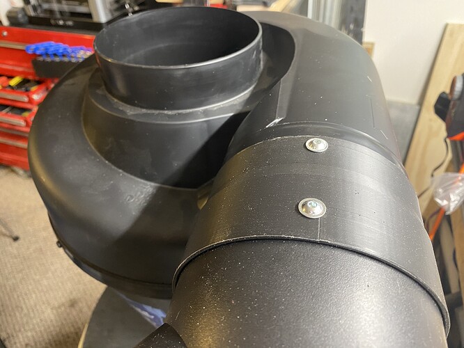

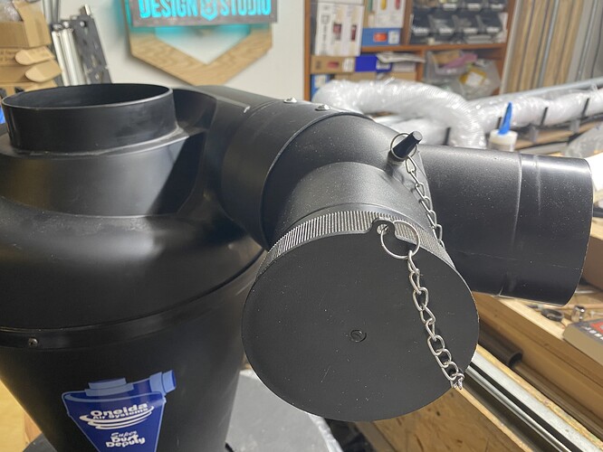

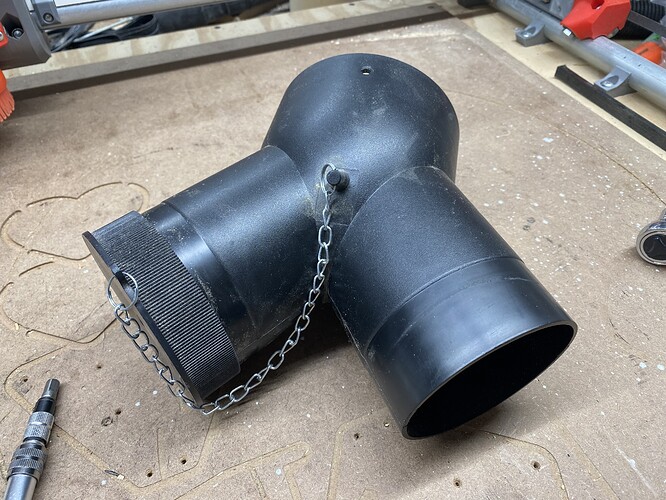

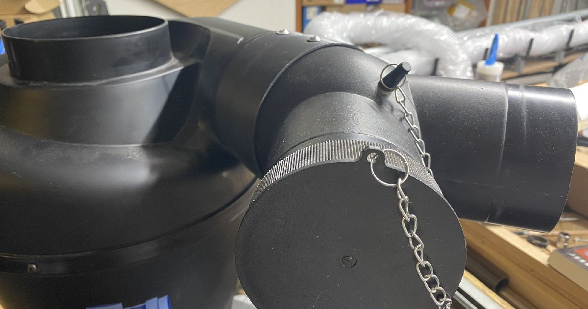

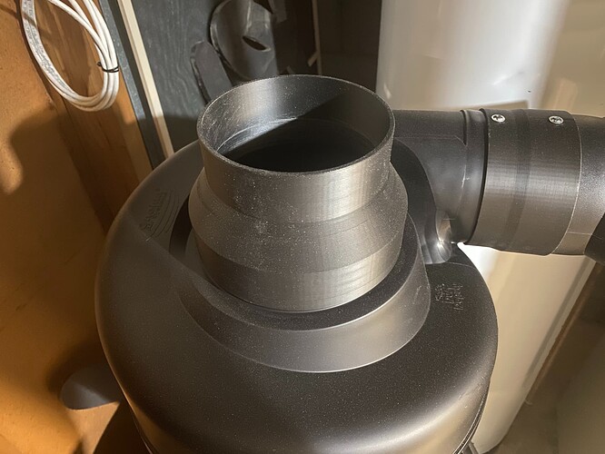

The Harbor Frieght Dust Collector comes with a 2-into-1 joiner at its dust-air inlet. It’s two 4" into one 5".

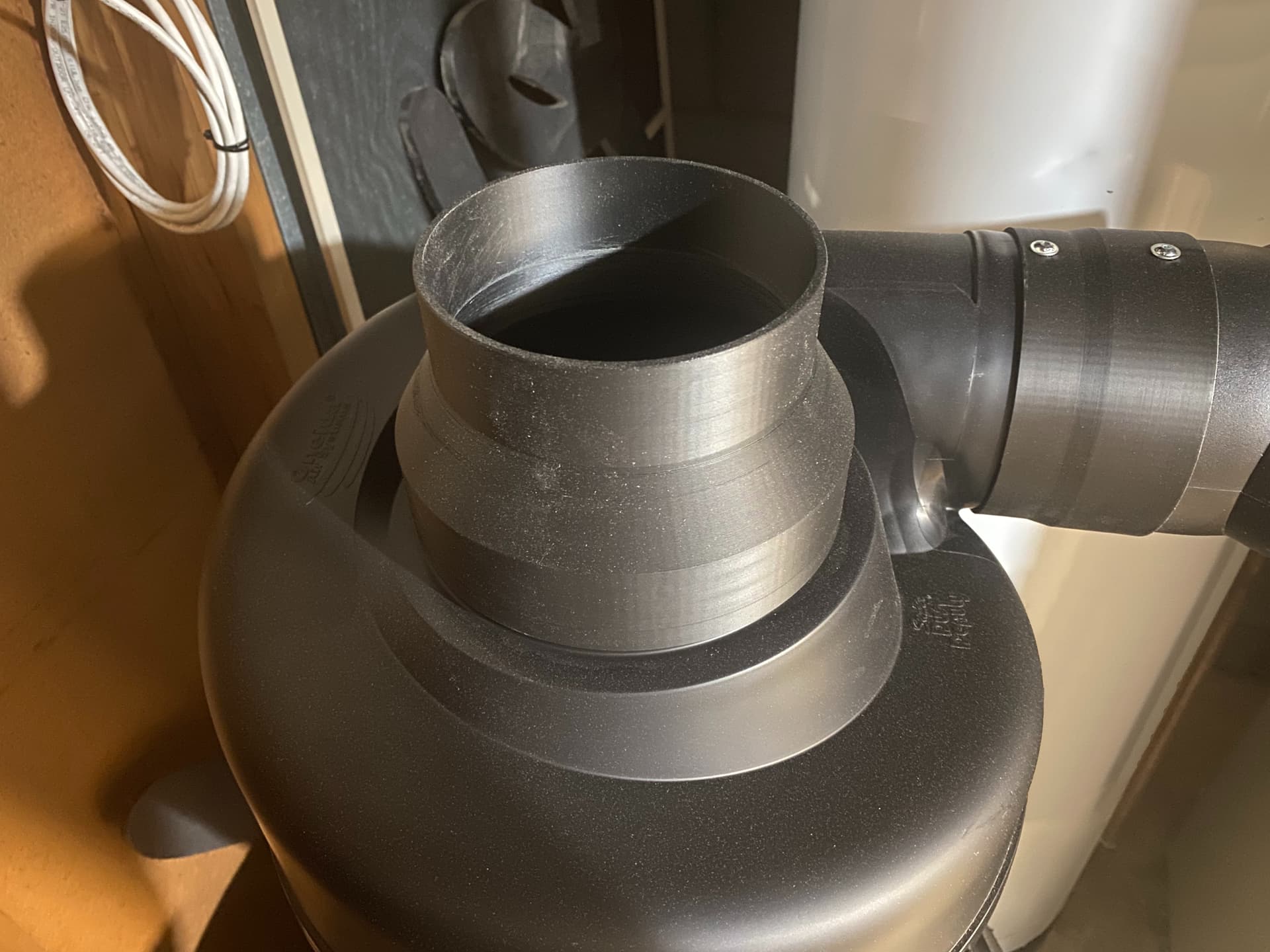

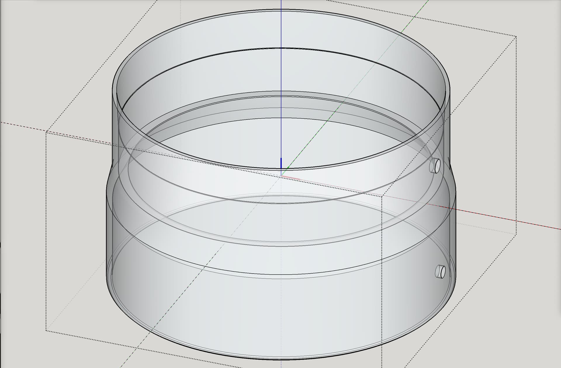

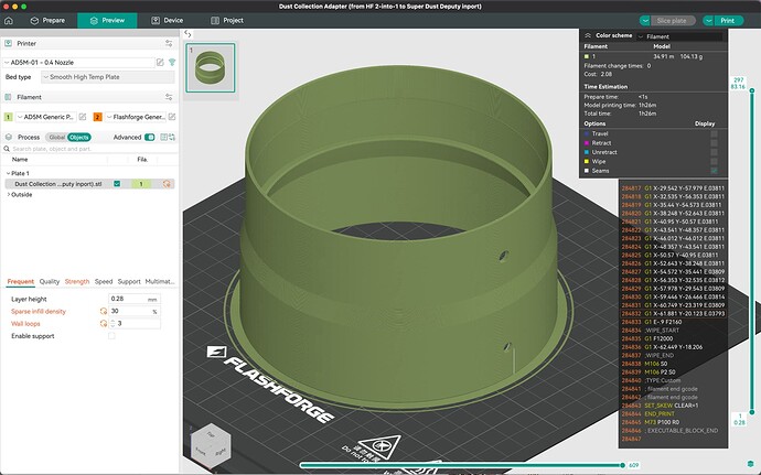

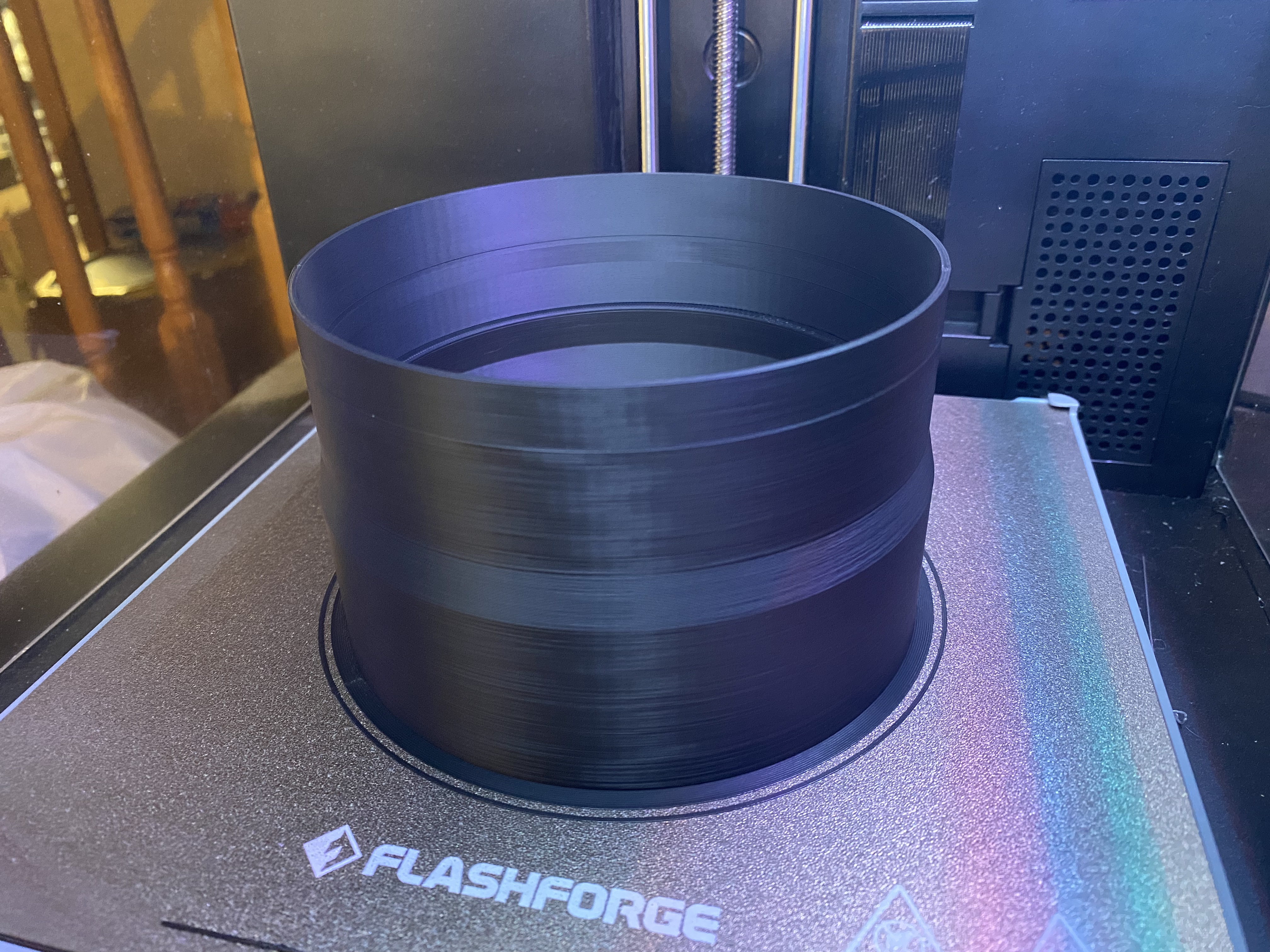

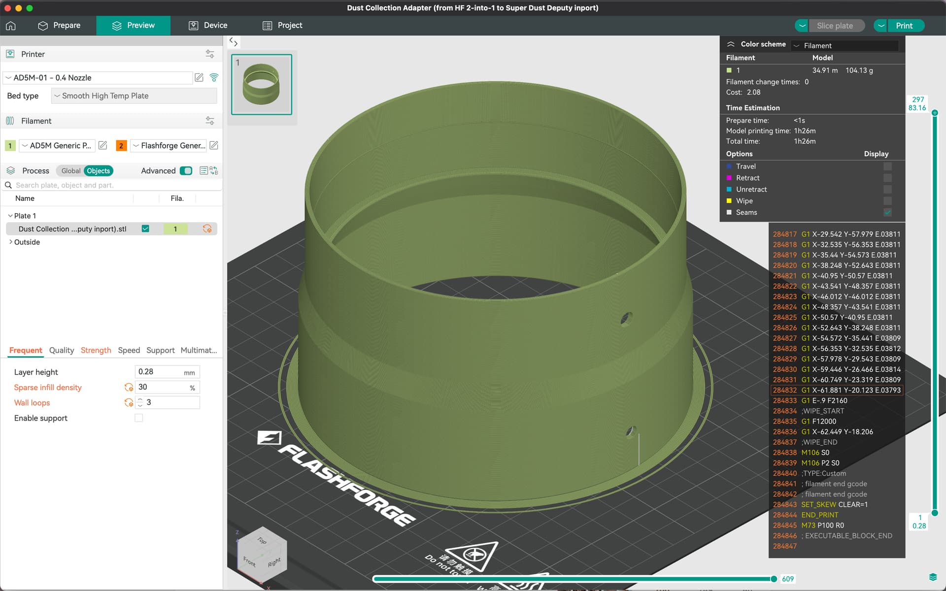

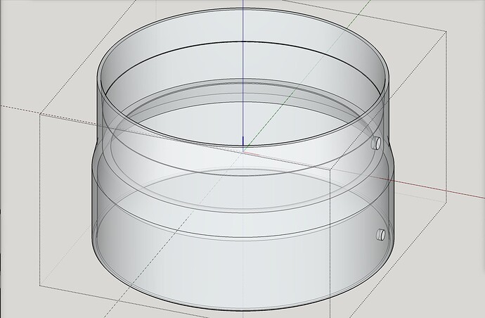

The Super Dust Deputy 4/5 can receive either 4" or 5" in from a tool hose, and either 4" or 6" out to the dust collector. Comes with two adapters (they both can either change the 5" in to a 4" in, or change the 6" out to a 4" out). But I want to preserve that 5" in and that 6" out. For the 5" in, I modeled up an adapter in SketchUp, which I am currently printing.

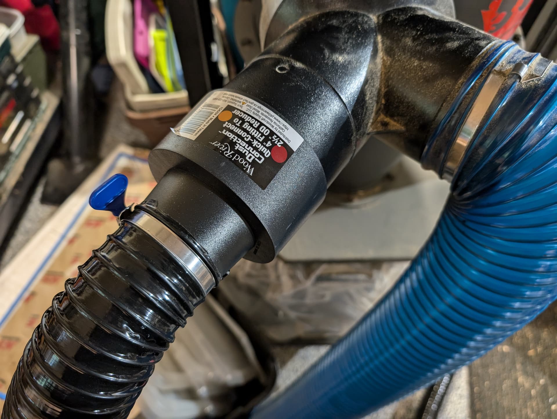

Thanks for this, made me decide to go ahead with a 2.5", A=4.9 in^2 hose instead of my 1.5", A=1.76 in^2. More than twice the area! Not sure exactly how that would work out for airflow, but sure seems like a big jump. I’m still adapting it to my 4" dust collector, but should get some substantial benefit with the bigger hose.
Great! My understanding is that with a dust collector made for 4" hose / pipe, you want to stay at 4" for as close to the tool as you can, and if you have to reduce, make the reduction no smaller than 2.5" and as short a run of that as is doable. My Harbor Freight dust collector is made to support two 4" runs (I’m not sure if it supports use of two 4" running simultaneously?). I never use two 4" at the same time. Almost always, the 4" is getting reduced to 2.5" — relatively close to the tool / machine. It seems to work quite well.

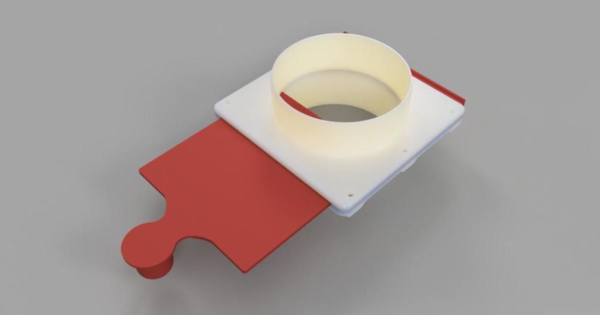

If you cannot get ahold to an injection molded one in time and affordably, they can be printed!
Also, I wanted to mention one printable model in particular. This one
If you have ever had a store bought, injection molded one get clogged with fine dust and need cleaned out to be able to seal, then you know it’s a bit of a headache. The one shown here, has it so the end can be be popped off, to shove the fine dust out the end, with a closing of the gate type motion, and then snap the end back in, friction fit. Like, like.
(Not my model. I heard about in a YouTube video.)

Also, here’s a link for the adapter for the “Y” (posted about above) as well:

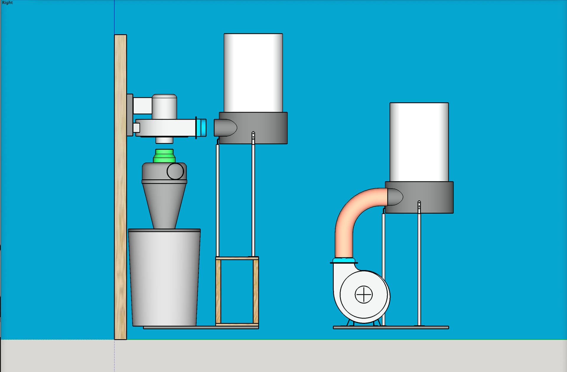

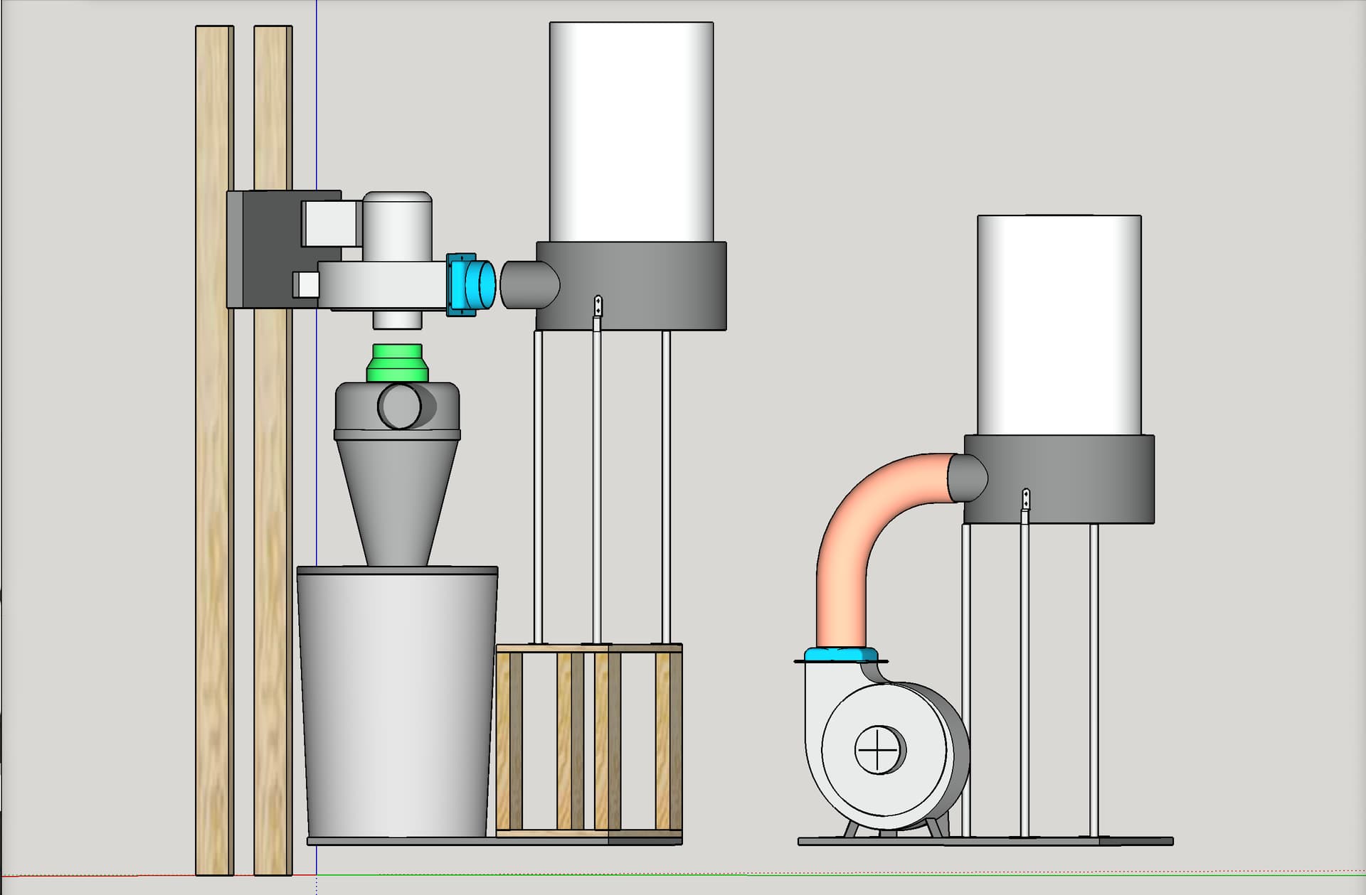

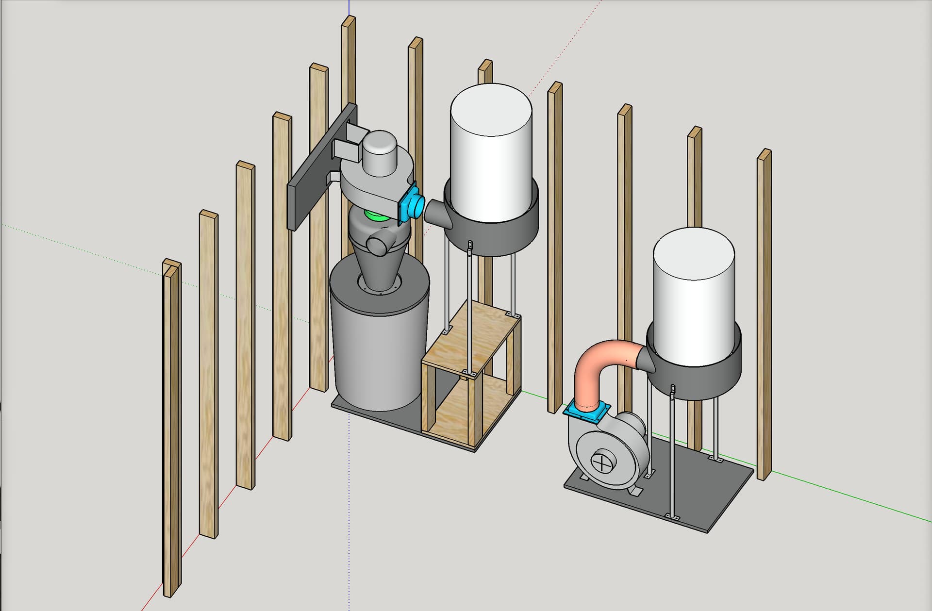

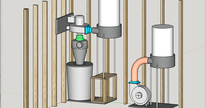

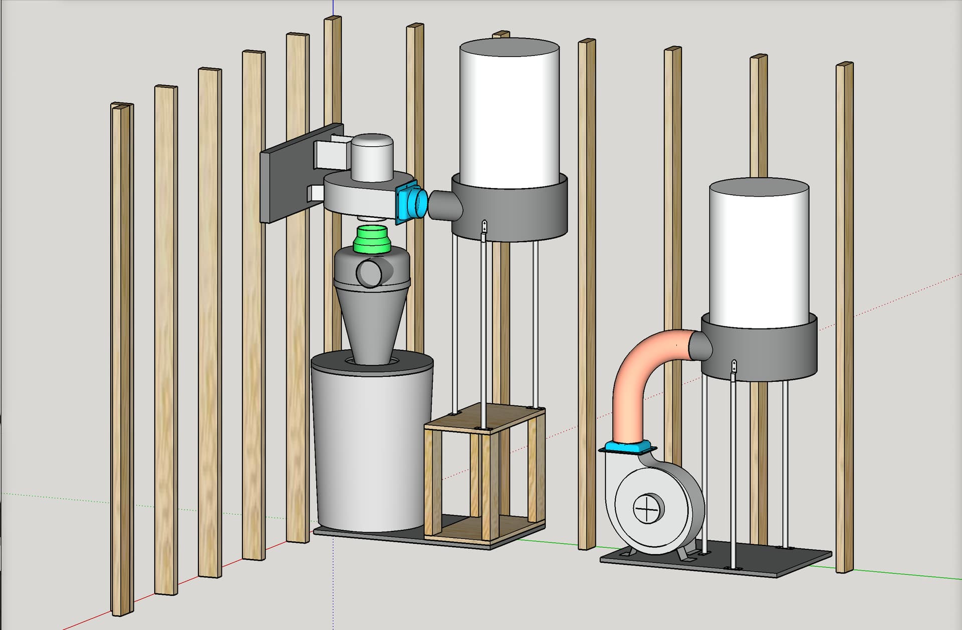

Ok, so I mocked up my stock, store-bought Harbor Freight 2HP dust collector, so I could plan for rearranging its parts to make my setup 2-stage instead of 1-stage.
In real life the stock factory version was positioned on the left, but in these screen shots, I (virtually) moved it to the right so it could be compared with the re-arranged version now on the left.
In the stock configuration, the stock hose (marked in salmon color / pink color) is a factory 5" diameter hose. By cutting two portions off, one slightly shorter than 5" in length and another slightly shorter than 6" in length, I will be able to connect the “Super Dust Deputy 4/5” to the blower motor, coming from the 3D printed adapter marked in green, going from 6" down to 5" inlet on the blower / impeller area, and will also be able to connect the stock, factory 5" air outlet on the blower motor, marked in blue, to the 5" air inlet on the separator ring. The white cylinder on top the separator ring represents either the factory bag filter or my pleated canister filter. The empty area under the separator ring would either have the factory plastic bag, or in my case, my trashcan that attaches to a DIY quick-connect MDF ring feature that I had previously modeled and made.
The model currently does not show the casters on the base, but I have the base floating about how high it is on the stock casters.
The basic idea is that I will build a wooden box, attach it to the base, and attach the support rods that hold the separator ring, thus elevating the separator ring to the new higher location. This will also nudge the separator ring closer to the end of the base, allowing room for the new galvanized steel trashcan my “Super Dust Deputy 4/5” is attached to.

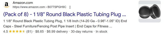

Looking good, that dust collection is going to rock. May I ask where you got those EMT plugs? I can only find 3/4" ones on printables, but figured I’d ask before I design my own. Unless you bought yours off Grainger or something, which seems un-Doug-like.
I’m getting close.
Indeed, I designed them myself. The issue with them is that when the EMT are cut with a tubing cutter, it results in a significant bur on the inside lip. Getting bur removed is a bit tedious. So then, do you design them to fit with the bur? Or not? As sure as I post one made for a bur, somebody who cuts with a chop saw says my print does not fit. If I design to fit without the bur, someone who cuts with a tubing cutter says they don’t fit. I’m sure there has to be a way to design a “compliant” plug that can pop over a bur and fit both ways, but I have not taken time to develop that. LOL
Any time that you cut with a tubing/pipe cutter, the next step should ALWAYS be to de-burr the inside of the tube/conduit/pipe. This is a bit of a safety thing on larger pipe/conduit, as the sharp edge can act as a knife edge on either your finger or whatever you are pulling through the conduit. For small copper and steel tubing, it is required in order to properly flare the end for creating a seal on the fitting.
Or at least, that’s they way I was trained back in the day!
