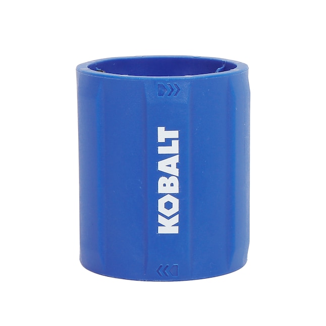

Indeed, a “one size fits all” design seems unlikely to fit for everyone. I’ll slap together one that fits my “mostly deburred” 1" ID pipes. Those Amazon ones are expensive and definitely would not fit. I see some on Grainger for 1" EMT but 3D printed ones will be perfect and “almost free.”

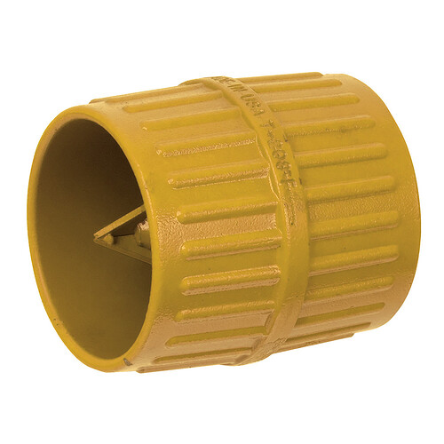

I try. Using a brand new deburring blade it shaves off some filings, but as I keep pushing and trying, I still have some bur left. At least I get the sharpness knocked off of it.
Short of using a dremel tool, I’ve had the same experience.
Before I got the actual conduit tool I did it with a half round file, takes about 1 minute a side. A deburring tool is not easy to use in steel on an edge that large, but a file guts right through.
This is what I used, but unfortunately no longer in production…
Lowes website shows this on sale (clearance) for $10.57, but “in store only.”
https://www.lowes.com/pd/Kobalt-1-8-in-5-8-in-Removal-Tool/1002645156
So it was marked down even more than this. Got it for only $5.57.
Did they have any Kobalt routers on clearance as well…? :upside_down_face:
NOTE: Can’t speak for un-reamed 1" EMT, but fit my 1" EMT perfectly. Also, agree not cheap at $1+ each, but free shipping with Prime.
Ah, I misread them as 1 1/8" ID. Cool!
