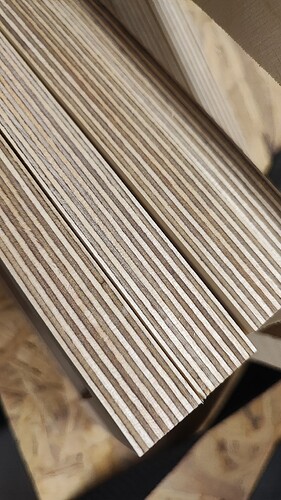

Look at those smooth cuts! Look at them! No sanding involved, just after cutting.
So sexy. :smiling_face_with_three_hearts:
:drooling_face:
oh yeah!
Very nice !! Is that like full 19mm ply ?
Cwispy
18mm beech ply. :slightly_smiling_face:
C’mon friend, don’t hold out on us, what is your secret recipe for such perfection? Tool? Feeds and speeds?
It’s above: Der Froschkönig - Lowrider 3 in Oldenburg, Germany - #324 by Tokoloshe :smiley: I went through a whole Odyssey before finally seing the light like Jake in the Blues Brothers, the light being a 1-flute instead of a burr-endmill. :smiley:
I went pretty conservatively with a DOC of 4.7mm and 1200mm/min with a 3.175mm 1-flute endmill. Had it on setting 3 on the Makita, think I could have cut either deeper or faster.
