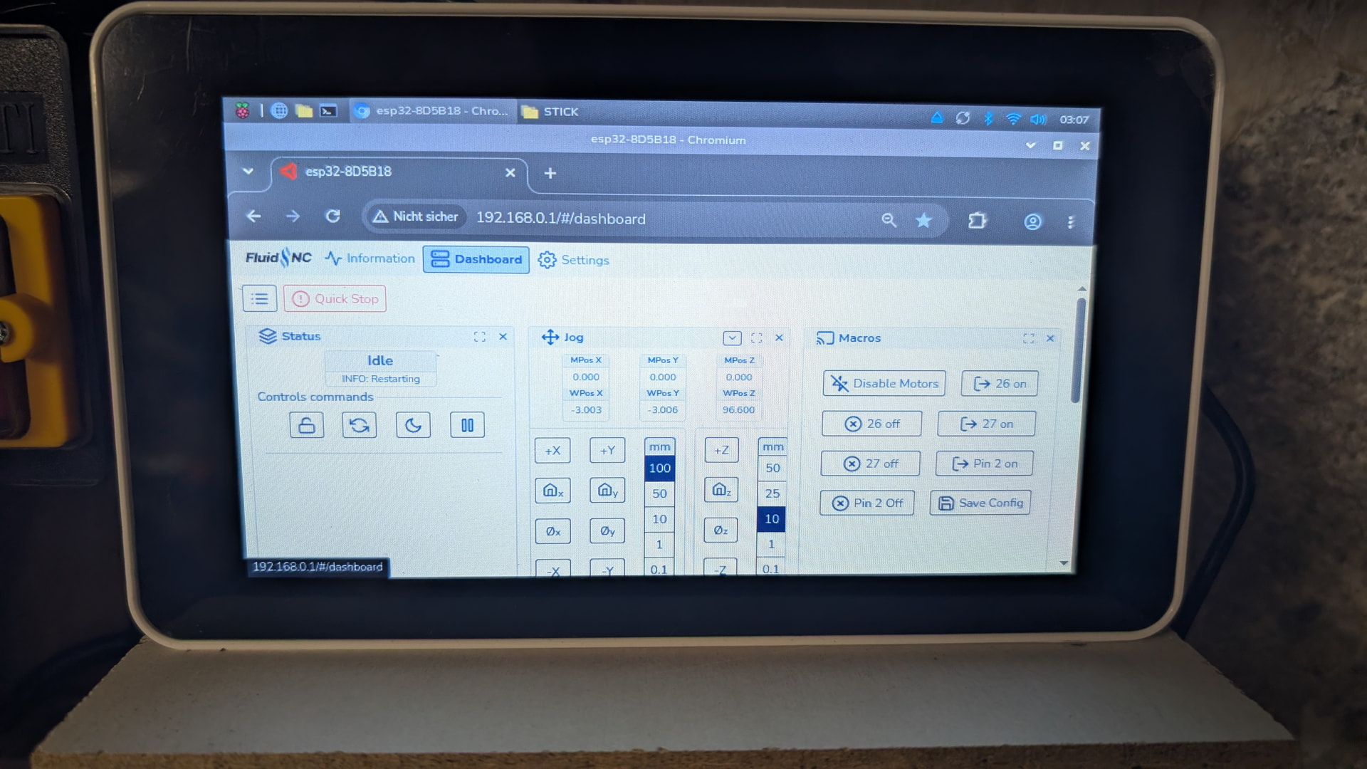

Hi! I think I made something wrong.. my dashboard looks completely different and i am missing the feed override.
Whats my problem here?
That’s Webui V3. Click on Settings and you can enable the Spindle overides if it is off. I think it’s in the 3rd menu. I don’t remember what the name of the menu is, sorry.

Great thanks, I found it!
And I was only a little confused, because some of you have this fancy jog circle thing.
