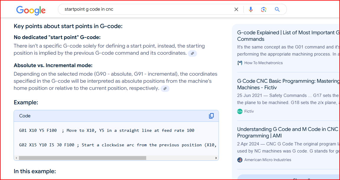

main question is there a code I can add in here to take X, Y to a start point from home before it starts cutting code
say X600 , Y1500 if i want start in centre
that way i can move area of slab to that start point

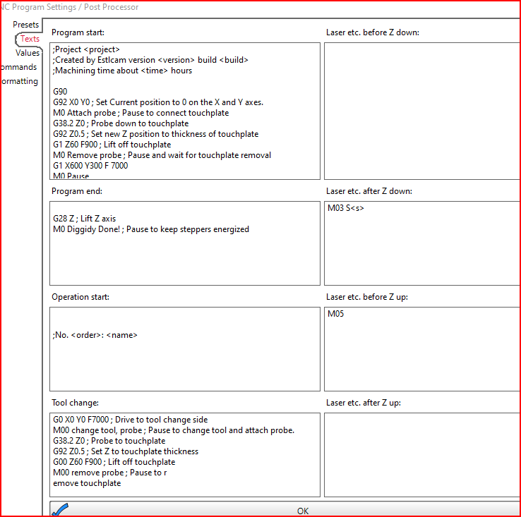

im picking id add line in here highlighted
unsure of which G code to put
from the example i found
would i put G1 X600 Y1500 F3000
or is it a G91
am i on right train of thought , or just derailed
if ur wondering what the
G1 Z35 F900 is

if my x0 and y 0 is where the green dot is and i probe there and do tool changes there. i want to than move router to red dot than pause , so i can move my work piece center to center or router bit than start cuts
You can move wherever you want. All the CAD outputs I see on this form use absolute coordinates (G90), so your command of G1 X600 Y1500 will work just fine. Your feedrates of F3000 for X,Y and 900 for Z are faster than I would run on my Primo, but the max federate in the firmware may be limiting the real feedrate. I’d hate for you to lose steps by running too fast a feedrate.
If you want to do this move for every job, you can add it to the Start Code section of your CAD program, or the Start Code section of your g-code sending solution (assuming you are not running off a SD card). You could add a pause (M0) to that code then have it return to 0,0 when you are done. Some g-code sending apps allow you to attach g-code to buttons, so you could add this to a button and execute it after homing but before the job is run.

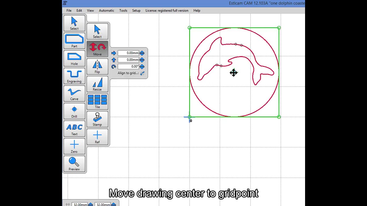

If that red dot is an Estlcam centered origin point you would need to add the following to the end of the program start section:
G0 X600 Y1500 F3000 ; move to workspace/project center
G92 X0 Y0 ; make it the origin
M0 ; pause to center board on project origin
In the tool change section you would need to change the tool change coordinates from G0 X0 Y0 (the center of the project/workspace) to:
G0 X-600 Y-1500 F3000 ; move to machine left-front corner
thanks dave
couple things is the G92 x0 y0 below so it rehomes before starting so after tool change it has the same 00 incase u bump spindle while setting material to midpoint
is it nesscury to have G0 X-600 Y-1500 F3000 in tool change, as once material screwed down dosent move till job finish
my current setting used for couple jobs and it works as i think it should
All G92 does is change the current workspace coordinates to the specified coordinates, G92 X0 Y0 makes the current location the origin/start/zero point. All Estlcam G-code X,Y coordinates that follow will be (and Texts entries need to be) some absolute (G90) distance from that X0,Y0 point. If the origin is X600 Y1500 from machine zero and you want the tool change to happen at machine zero you need a G0(0) (rapid move, not G1 machining) X-600 Y-1500 to get there.
My answer was for projects that have a center origin point (blue +, Zero tool), a setup that works with any size material/project that fits on your machine… Two centering options were posted in a previous reply (Centering Workspace Estl CAM - #5 by dalrun), here’s a third (the 4th/bottom Select icon can be used in newer versions):
