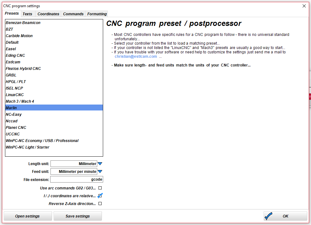

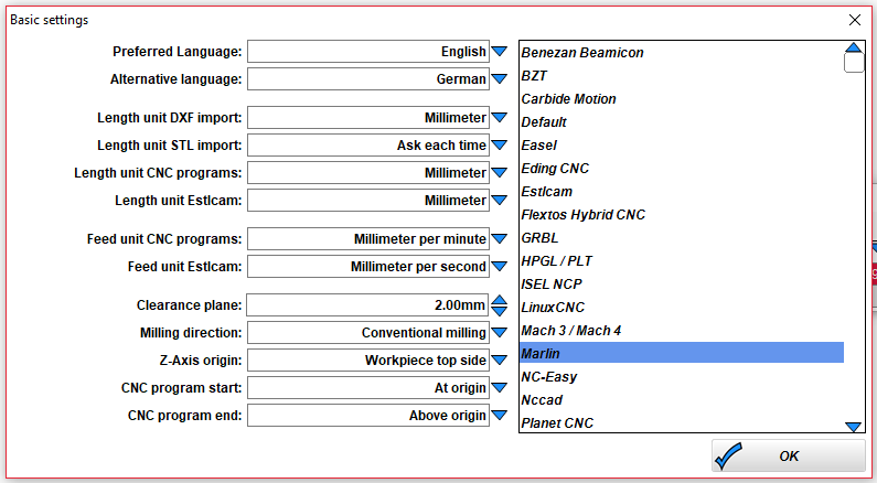

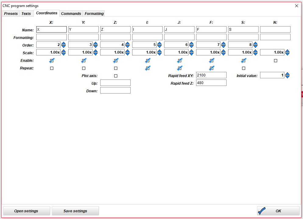

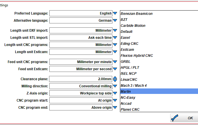

How about screen shots of your estlcam settings.
If you need anything additionally, feel free to ask.
Also, version 11.040
