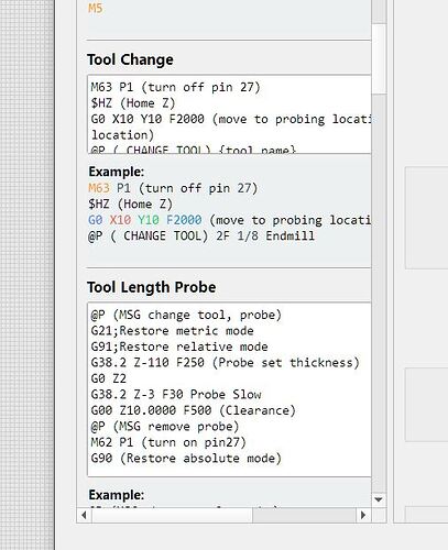

originally right from MM RC1 I took the milling basics settings from docs and had them in tool change box and it worked didnt use MM probing tool
MM dev team says im handling tool change diff than they planned
they wrote me a new code , which didn’t work it would go down touch probe and just freeze

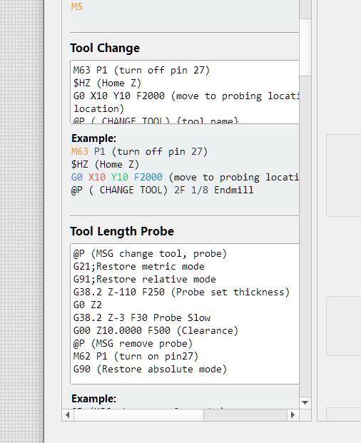

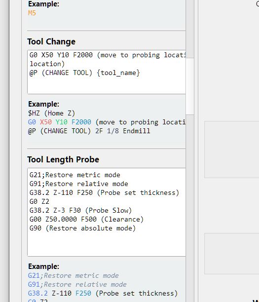

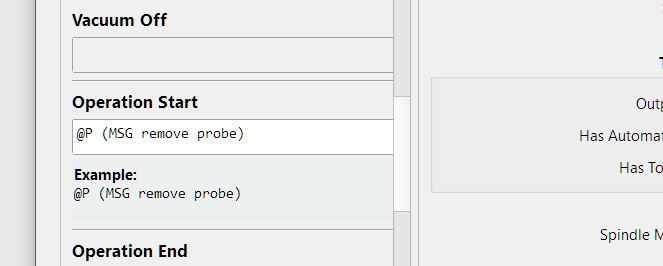

i compared the V1 milling basics and MM and changed it a bit to this , had to put pause in opp start box as it doesn’t like @P in probe command and if i didn’t have it in opp start box , as soon as probe done it raced off with probe still attached
and got it working sort of, randomly
1: after probing it moves up 50mm for me to fit dust shoe, now when i click continue it lowers tool to MM safe clearance height than travels across work piece , prior it would move over at the 50mm above
than other times it travels at 50mm to start point than lowers, next it will gradually lower as traveling to start point , its so over the place

G21
G90
G94

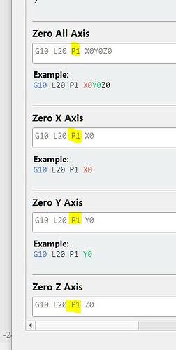

G10 L20 P0 X0 Y0 Z0 (set current location to zero, survives reboot)
G0 X10 Y10 F2000 (move to probing location)
M0 (MSG Attach probe)
G38.2 Z-110 F200 P0.5 (probe down set thickness )
G1 Z10 F900
M0 (MSG Remove probe)
M62 P1 (If used start spindle pin27 )
I guess it worked in early days so I just rolled with it , now that im at my machine every day theses issues are doing my head in , doesn’t help i took another knock so codes are just gibberish to me again

still trying work out whats wrong, while I’m waiting on response from MM im cross referencing everything in @vicious1 with MM docs

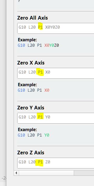

should i try putting G10 L20 P0 X0 Y0 Z0 (set current location to zero, survives reboot and in each x y and z changing P for P0
basically im clutching at straws as to why all of a sudden it does 1st tool path perfectly , than comes back to tool probe position , double probes as should moves to start position of 2 nd tool path change sweet.
than cuts air which is always 1 pass depth height above material ?
have done few tests with dif pass depths let it run its course and them measured depth to confirm it is 1 pass depth
also the G90 is in the probe box should this be there
Yeah use P0 for all of those.
I don’t see that in your screenshot.

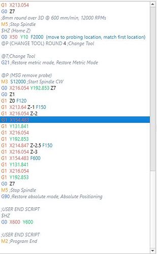

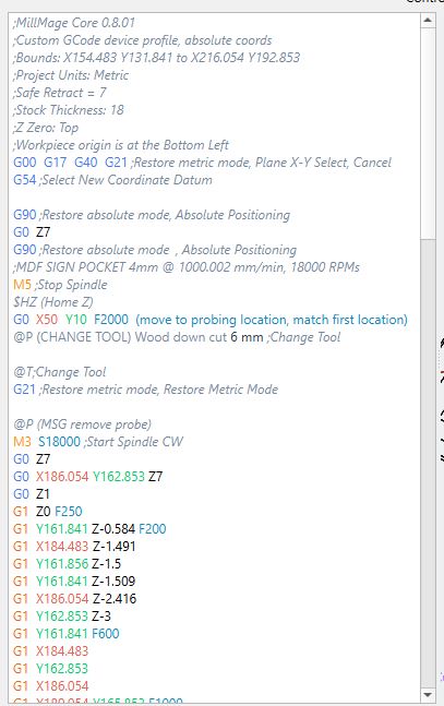

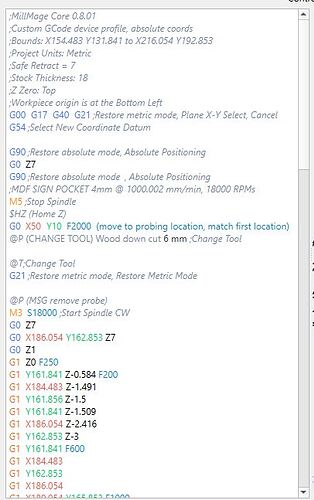

you need to look at the first dozen or so commands in your gcode. That will give you a real clear picture of why it is doing anything.
cheers
ok ill take screen shot later of gcode with current , than add codes into zero axis boxes and compare them
the g90 is up in screen shot of 1st part of post in tool length probe box

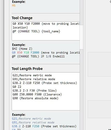

this is what i get with the codes in 1st part of post

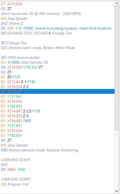

this the tool change part
This whole thing is hard to translate with how MM injects things outside the gcode you generate.
im hearing you on that one :), in the early RCs where i had the codes worked , now as they keep improving MM, what worked now doesn’t always , will just keep playing and see what happens i guess
i did just notice 1 rookie mistake i forgot the P0.5
have change gcode flavour to fluidnc instead of grbl see if that makes a difference
