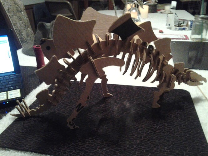

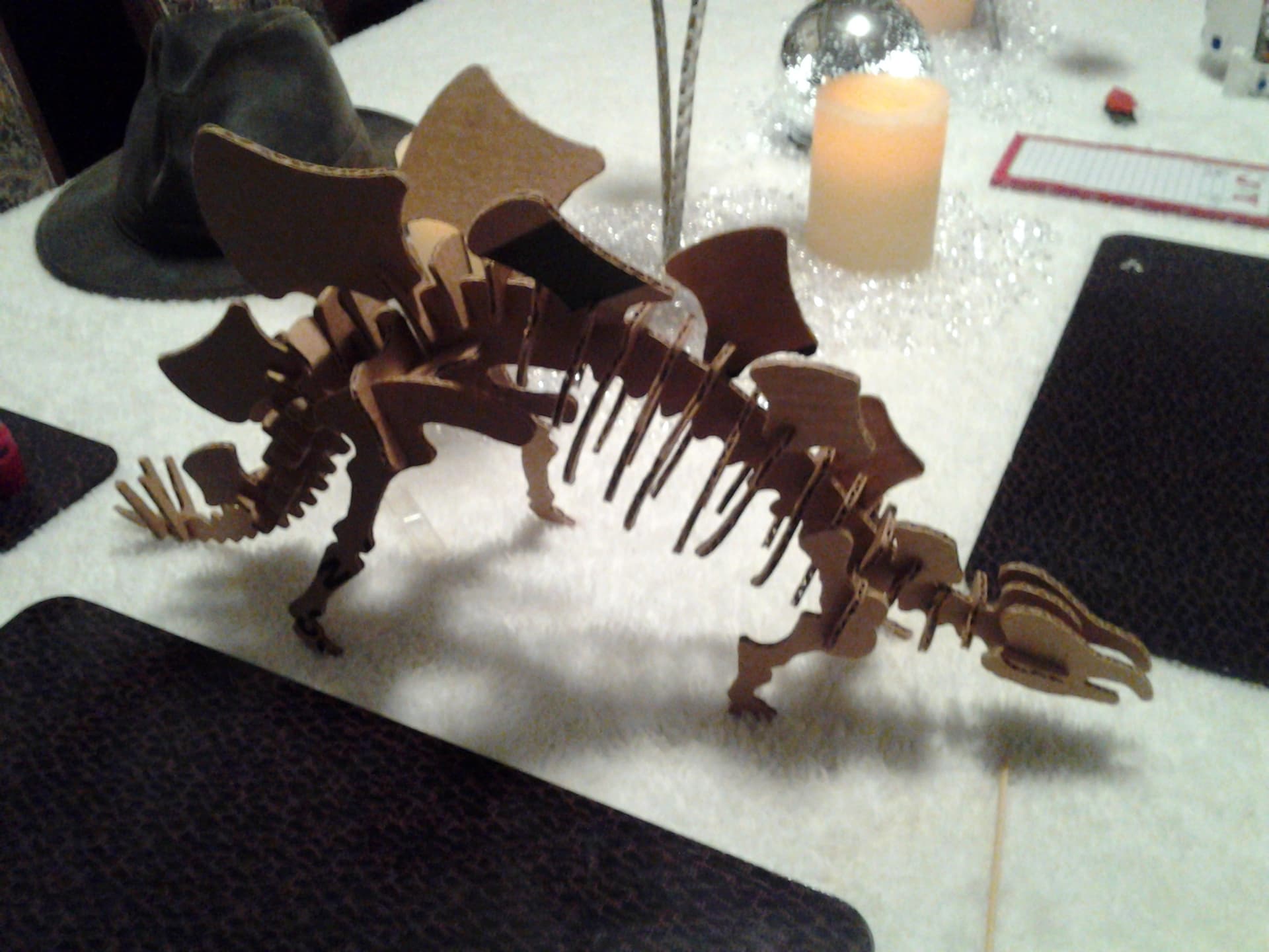

I’ve cut lots of cardboard with my laser, works really well. Bonus is because there’s no sideways forces you don’t even need to clamp it down
Me too.

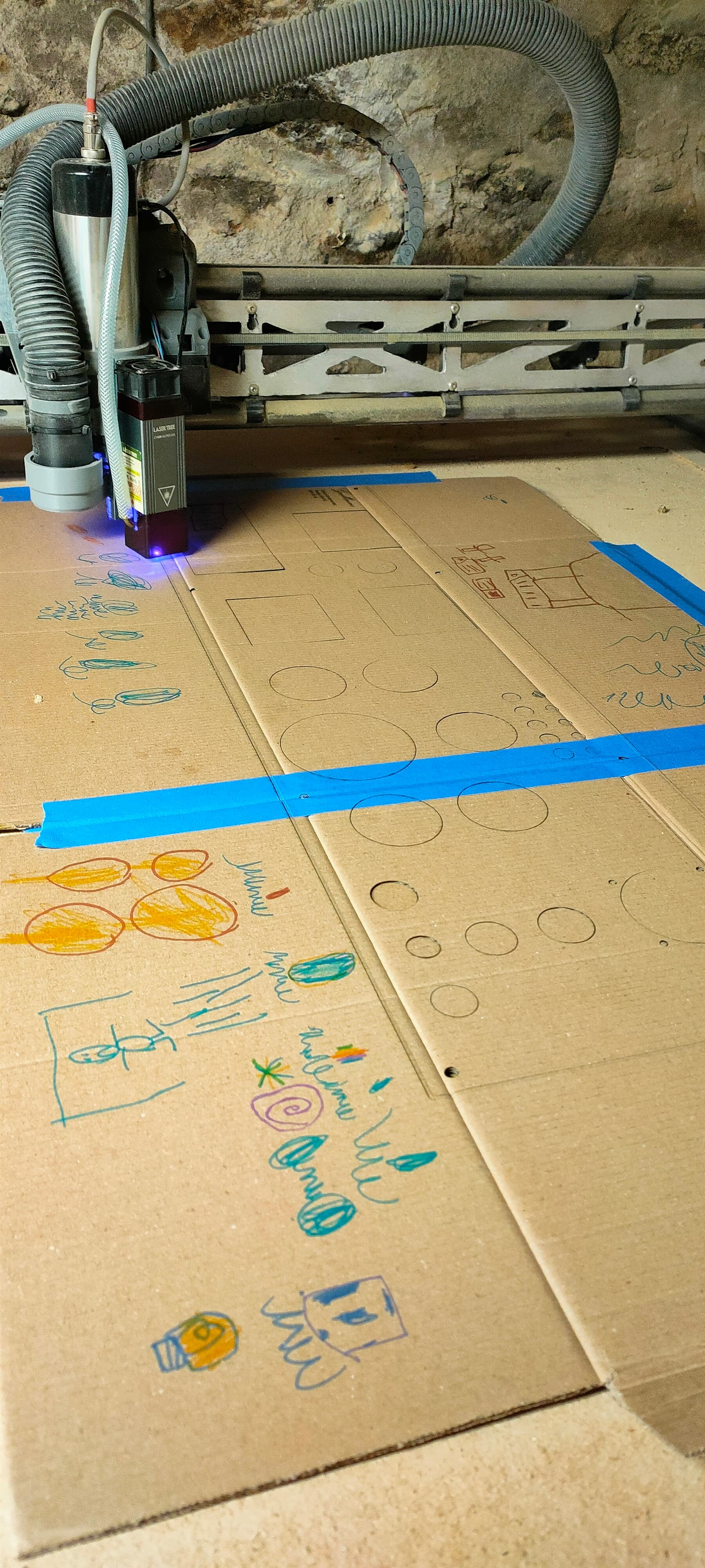

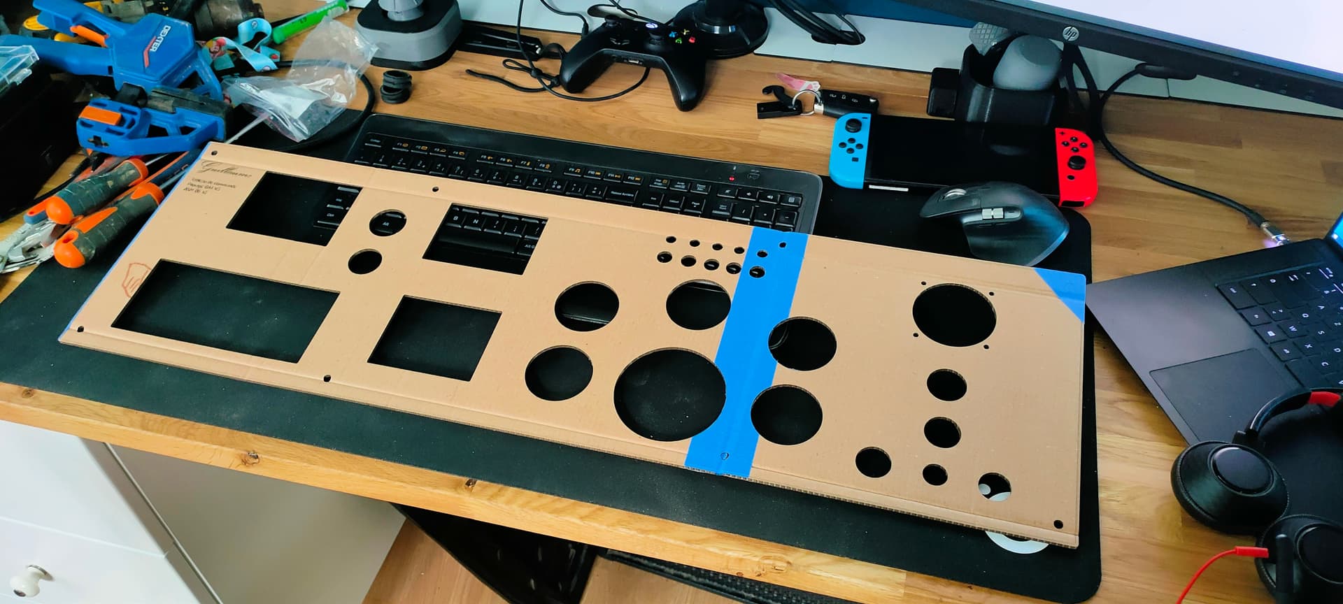

I regularly make templates and fit-tests with lasercut cardboards
It’s fast , cheap and easy
The main advantages are:
  • Can re-use the LR3, or build a New dedicated machine
  • Quite cheap
  • Very simple process, no finicky setup or adjustments
You have to take care of the smoke though…
The way I see it, you could build a second smaller lowrider on the lower shelf of your existing lowrider table
This would provide an easy structure for an enclosure, add some red plexiglass and you’re good to go
Having both machine on top of one another would probably help streamlining the production process too
@Fabien how do you manage folding the cardboard?
Same. I have found the smoke much better since I got air assist.

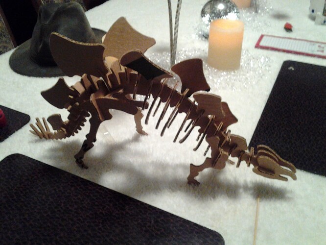

I got the kids a cardboard construction set for Christmas last year so their demand for cardboard is insatiable
(Just for illustration - not my kid)
IMG_2690
