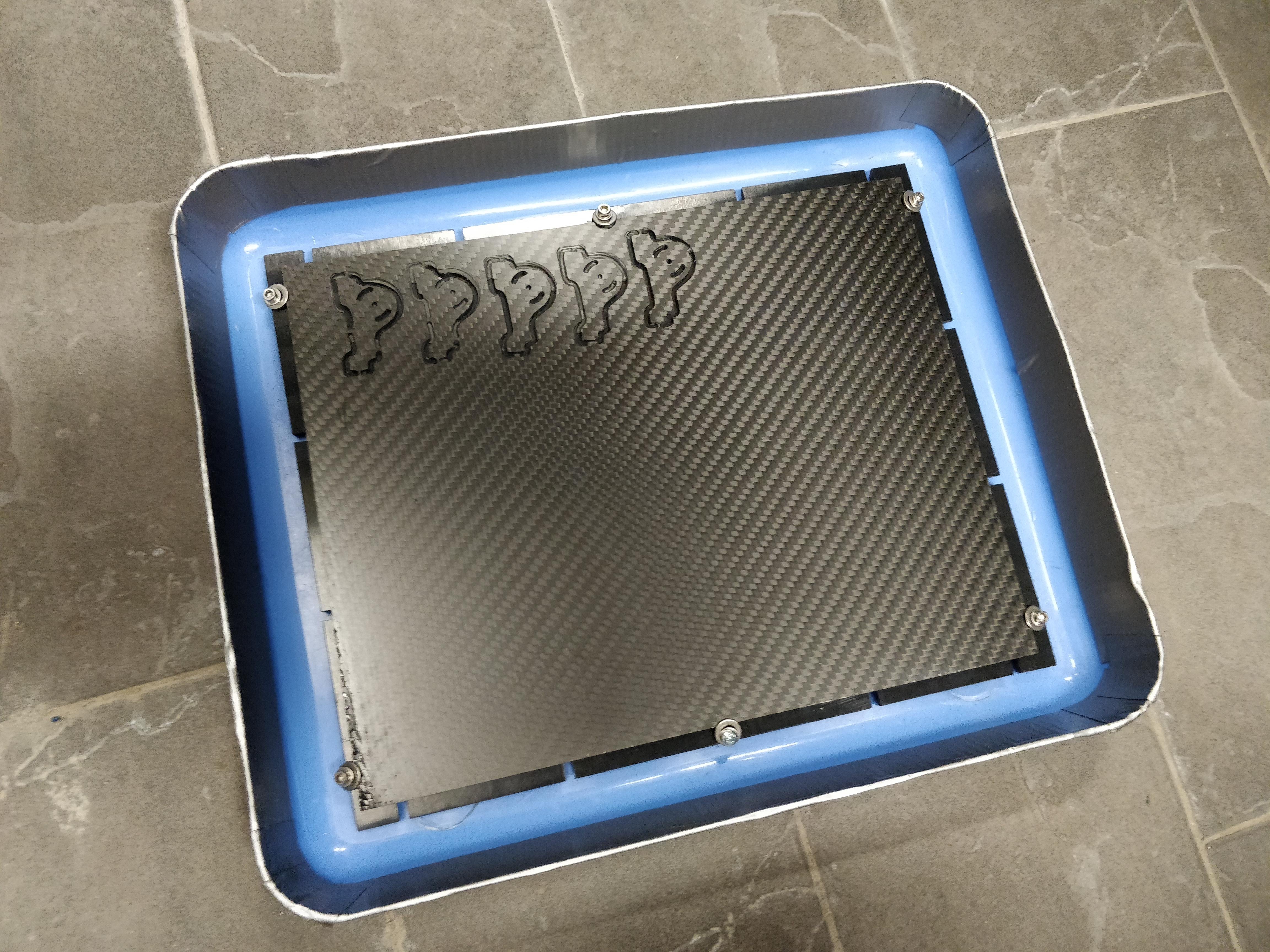

Here are some pictures of my workpiece. The pieces underlined in red belong to the first cut, the ones in yellow to the second; videos of the first cut are included.

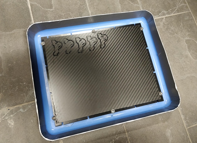

Things improved a lot with the new bits - there’s a reason they make them, after all… Here are some pictures of the cut plus a bonus shot of the shroud I made to contain spills. It works quite well, I was not expecting it!
There’s still some slop in the cut, I’ve carefully inspected the corner mounts and they indeed developed ~1mm of slack. I think I’ll get some acrylic and cut a pattern into it to hold a few nuts and bolts to keep the sheet steady. @Barry99705 suggested to use insulation foam, but the one I have at hand is too thick and I don’t think it wouldn’t absorb water.

Any details on the tray you’re using? I’ve been wanting to make something similar. For workholding I was thinking about double sided tape to cheap HPDE cutting boards as a waterproof spoilboard you could bolt down to your water tray somehow.
I’ve found a 5mm black PVC sheet around the house, I’ll use that as a spoilboard inside the tray since the speeds should be adequate to avoid getting melt plastic on the bit for the last pass. I’ll lower my extra cutting depth, maybe only using 0.1 or 0.2mm more than the CF sheet’s thickness.
It is a very simple domestic plastic tray; I cut it to size and taped the edges, nothing fancy. It is held down to the bed with double sided tape and so far has kept up with some abuse. If I had to start over, I’d probably get some thick acrylic sheets and make a proper tray/box, sealing the edges with silicone and placing all the needed fastening holes directly in it. Getting a tray this low off the machine is kinda uncomfortable when it’s filled with polluted water that you’re trying not to spill everywhere… Maybe I should try to remove some of it with a syringe, first.

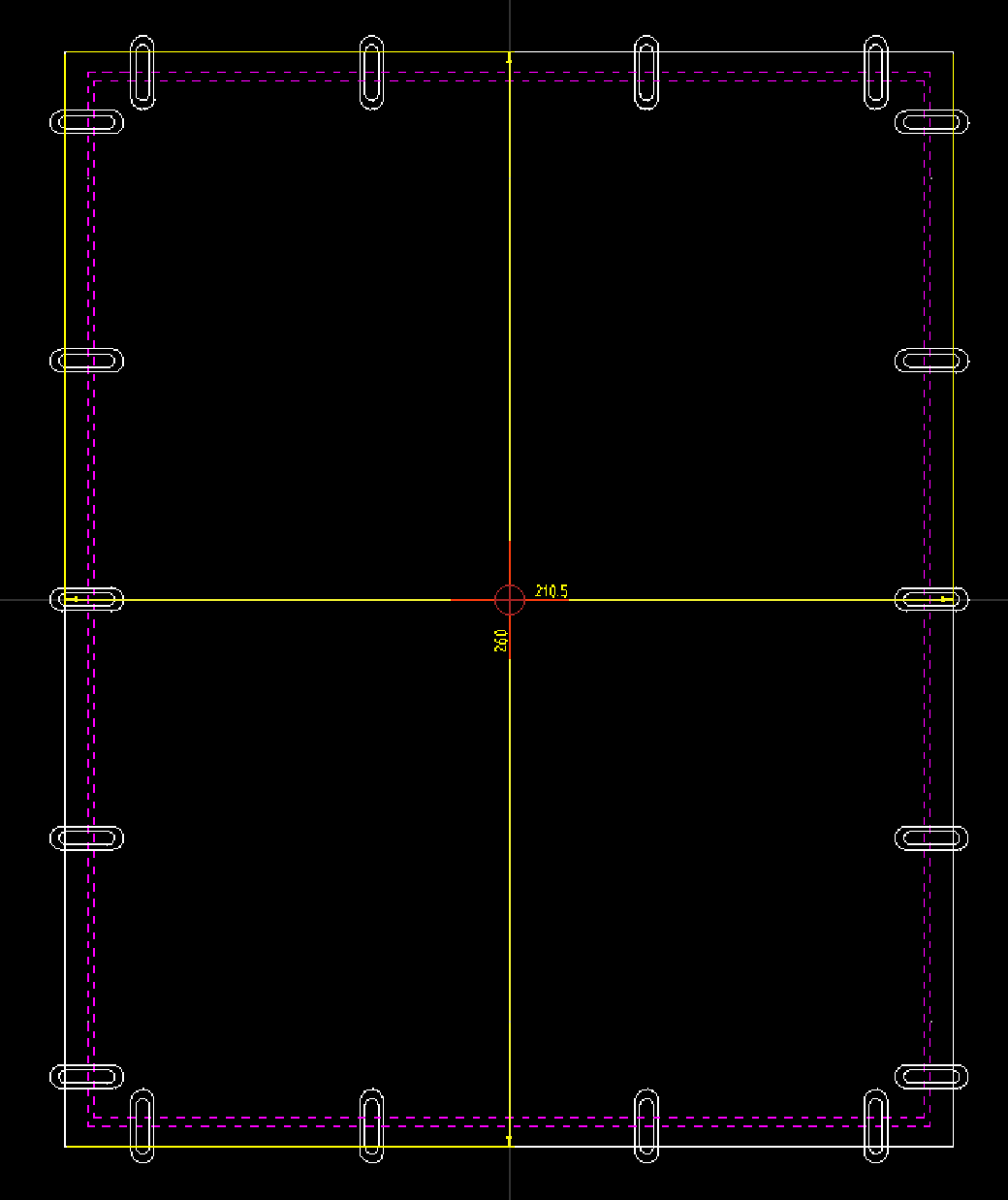

The supports at the corners were 3D-printed, but they don’t work well and need to be redesigned if I want to keep using that system. There’s also another printed rectangular support under the middle of the sheet.
The new tray base should be much better, I think I’ve nailed it with the nut slots in the PVC - this way it will adapt to the specs of the CF sheets that I’m using since they have a ~3mm tolerance on the reference dimensions. Using the machine to make its own accessories/mounts really reminds me of my first spools of filament used in my 3D printer :slight_smile:

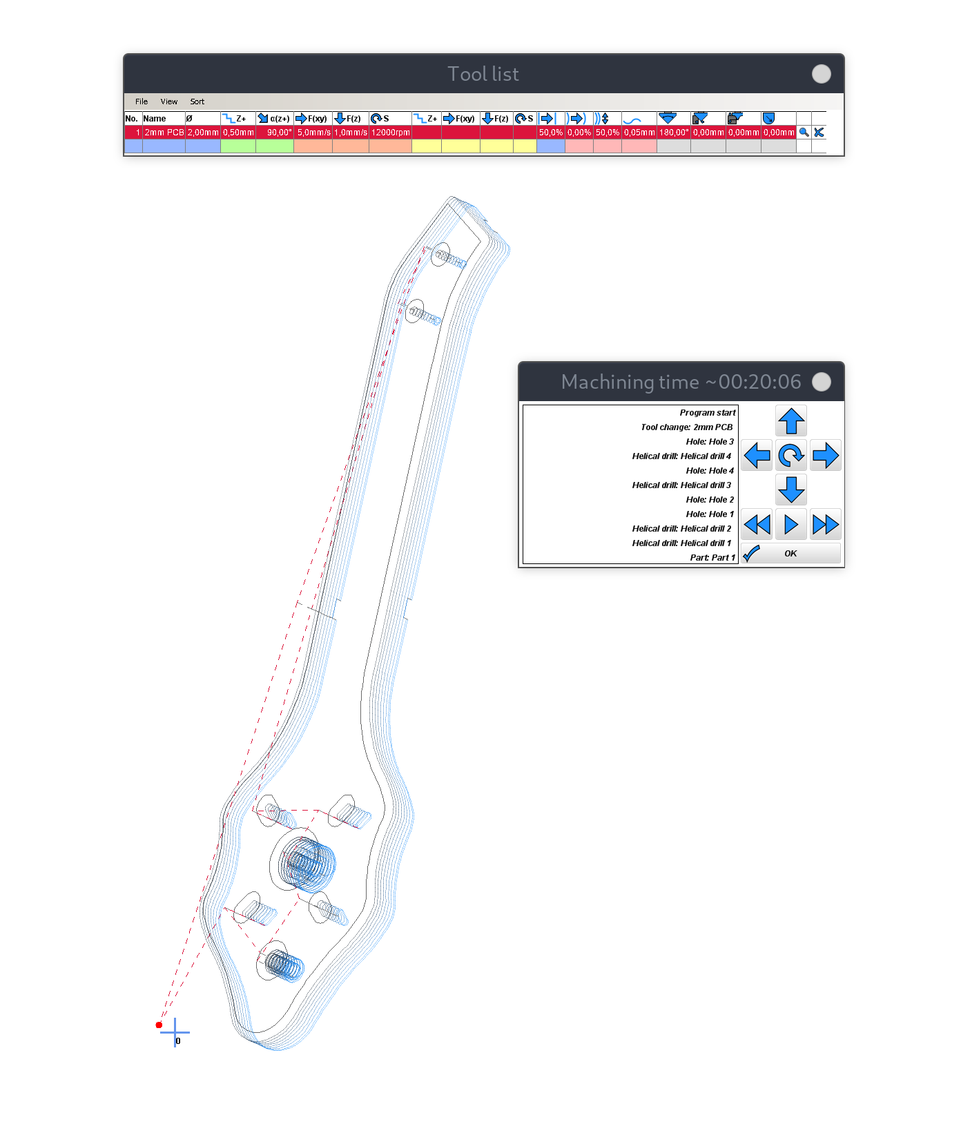

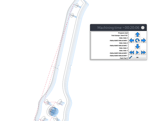

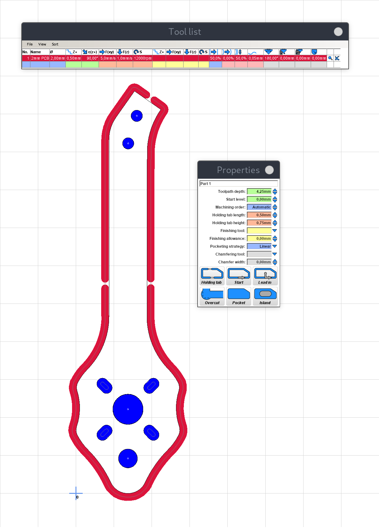

Today I tried cutting several pieces and the overall result was quite nice. I now have a problem, though, with the helically drilled holes: the spindle’s mount/assembly/everything flexes way too much when cutting such holes, and what should be a 3mm hole comes out as a wonky 2mm one (since I’m using a 2mm bit).

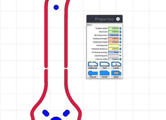

The speeds used were the ones above, I’ll try shallower passes of 0.5mm. Are there any machining tips I’m not aware of to bring the cut time down a little? I’ll need to cut a few of these pieces, and so far they’ve been pretty tedious to machine - 4x of them took ~50mins with the old feeds & speeds.
You need to use a finishing pass and you can cut way more aggressively.
If your tool is moving on the gantry you need to fix that. It should not move.
Finishing passes are a new tool to me, how would I benefit of them? My edges are already quite clean, I never thought of using them for speed gains.
The spindle flexes noticeably only in helical drills, I tried to move it by hand but it seems to be firmly locked in place. Could it be that, since it gets hot - I'll measure its temperature next time - during use, it softens the PLA mounts? I thought the flex was due to too much force being applied on the bit (e.g.: too fast), but I didn't notice this behavior on wood.

Always use a finishing pass if you plan on checking dimensions. No. Always use a finishing pass.
