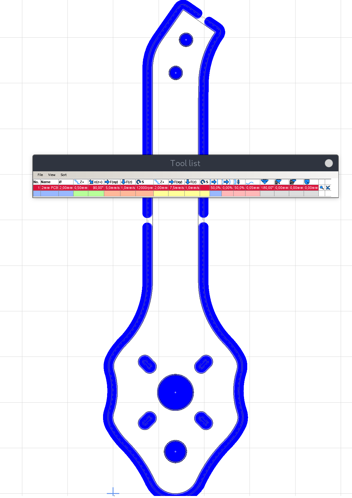

I took these pictures this morning. Let me know if there’s anything in particular that you wanted to see and I missed.
All the tension bolts are loose since the machine already is square, there are no cracked plastic pieces. Maybe I should enlarge the tool mount - could it be that those two rings are not stiff enough and twist on themselves? The Z assembly does not seem to be able to flex. I’ll try to get that on video if (when) it appears again.
Are you saying that I should pull the spindle up? I left it that much lower because this way I could have more clearance between the bit and the bottom of the Z rails, and I’d be able to cut in places where the whole Z assembly won’t fit when dropped down (like in the corners of the tray I’m using).

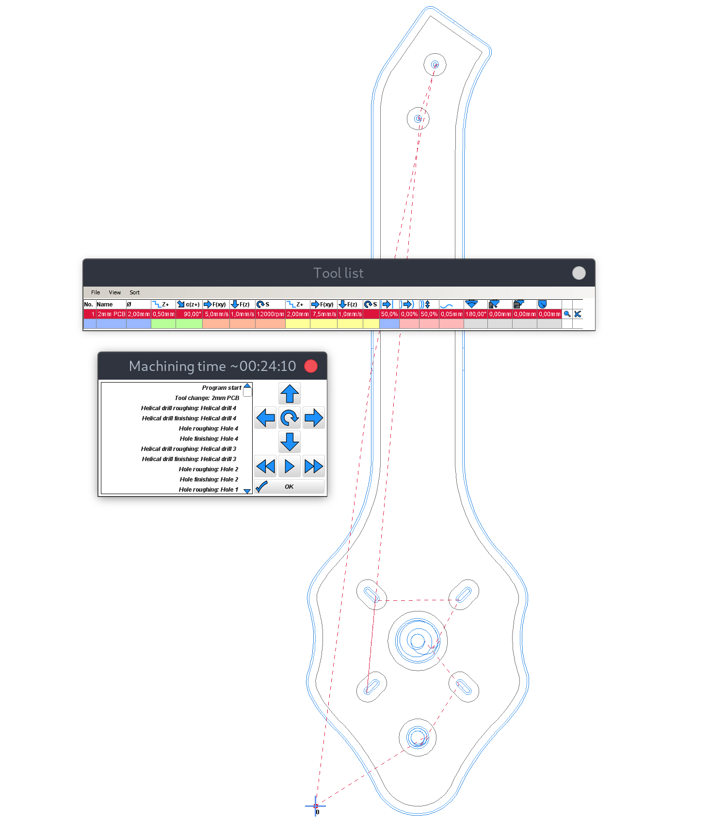

I’ve had small holes like that turn into triangles instead of holes with helical drilling before. I could tell if it was from the gcode, or marlin interpolating the curves into lines. They were close enough, so I didn’t really worry about them.

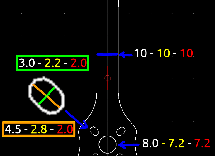

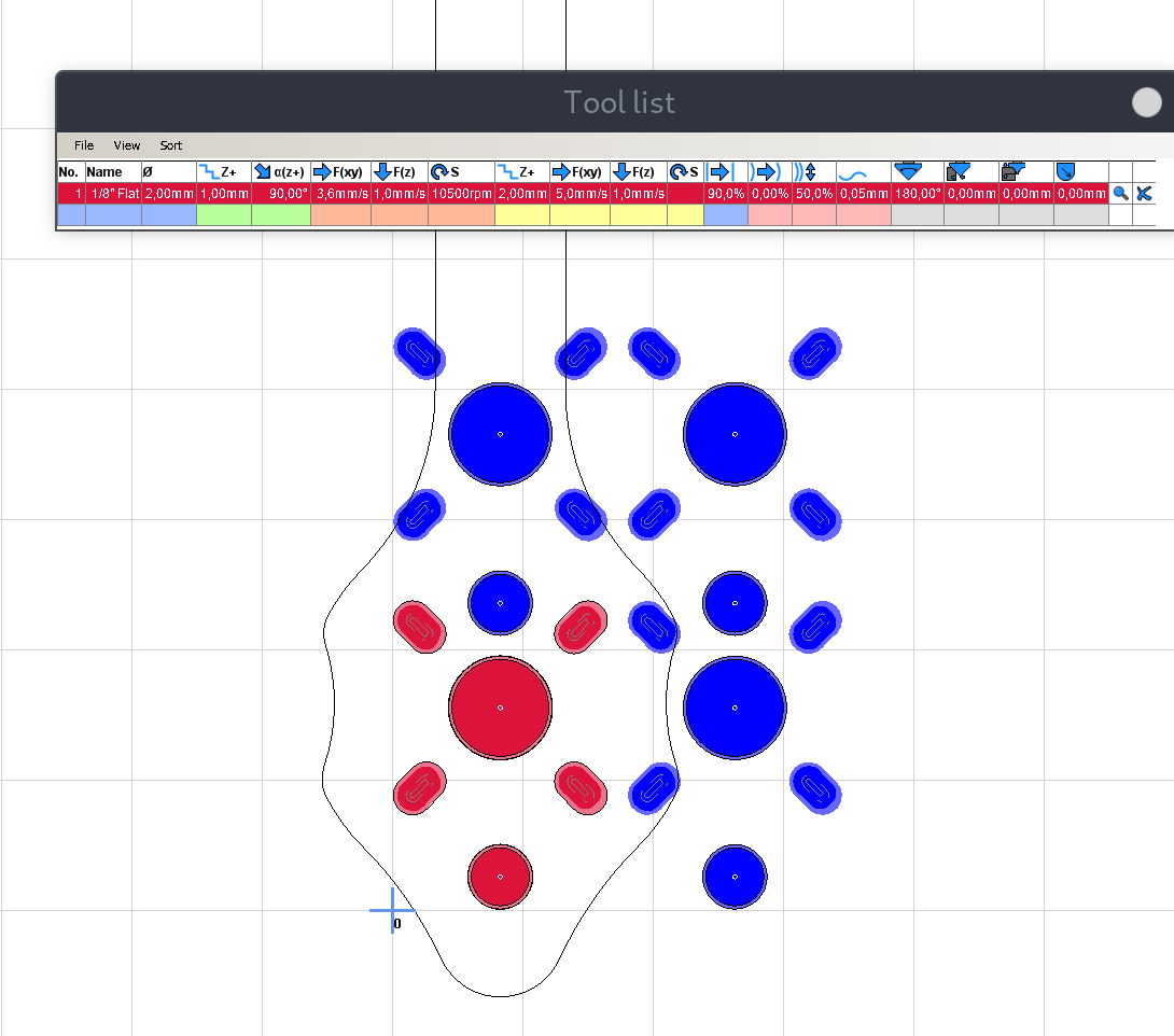

Mines are off enough to be useless, the four angled slots in the lower part should be 3x4.5mm but they basically turn out as slightly widened 2mm holes as per the pictures linked above; M3 bolts just won’t fit, let alone slide inside the slot… Maybe I should turn arcs off in Estlcam, just to be sure?

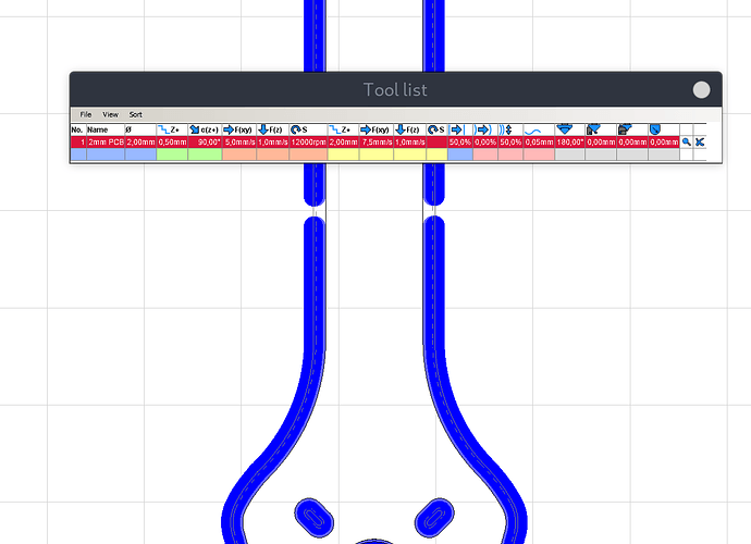

What do you think of these attached settings? I hope I’ll find some good combination soon because ordering more CF to cut test onto is going to be quite expensive.
arm.zip (6.92 KB)

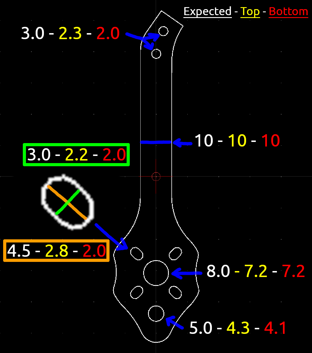

I tried the settings above, the end result did not change much; I’ve attached a picture with the expected and actual dimensions of the cuts. Before cutting I’ve also replaced the tool mount with a single block version with cooling.

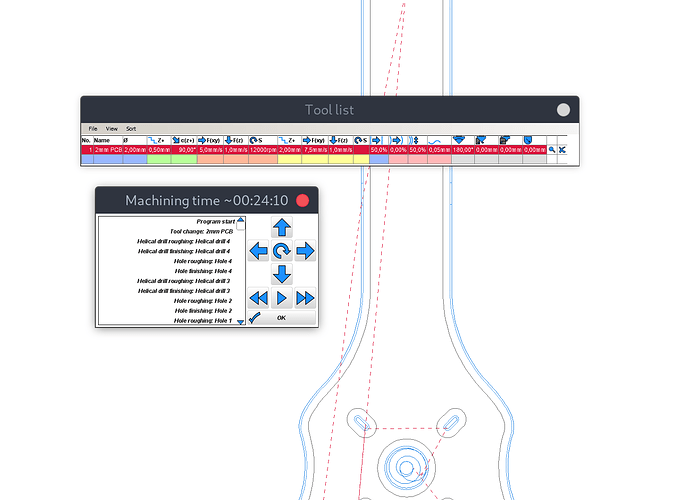

@vicious1, here are two videos of the flex - check your speaker’s volume before playing! The helical drilling looks too fast to me, does it follow the main feed or can it be tuned?

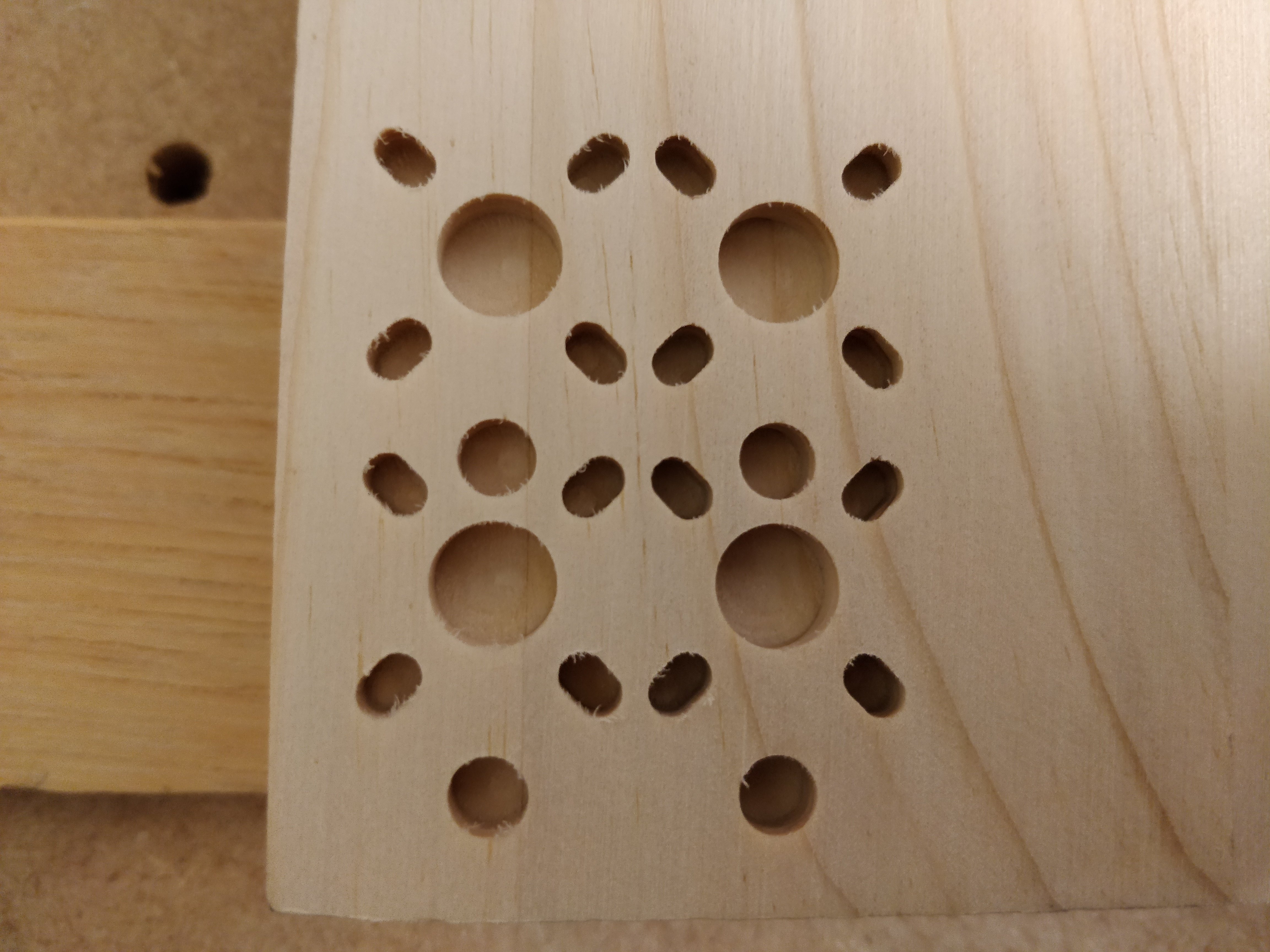

I’ve tried to cut a tiled pattern and it is indeed showing an erratic (but consistent) behavior: the dimensions aren’t exact even in wood, but the errors seem to be the very same in every tile.
Here are pictures of the cut and videos of the slack.

This is quite strange, since the tests that I initially did with the machine before the summer weren’t showing these effects - holes and slots were precise… Something that I’m overseeing must have worn out / cracked / bent. I’ll also try another test cut with arcs disabled, the fact that the errors are so exactly repeated between the tiles is very suspicious to me.

Based on the last video you in the album, it looks like one of your stepper pulleys is loose. I can’t move them when they are energized without skipping teeth. I’d check the tightness of the grub screw to make sure the pulley is firmly attached to the stepper motor shaft.

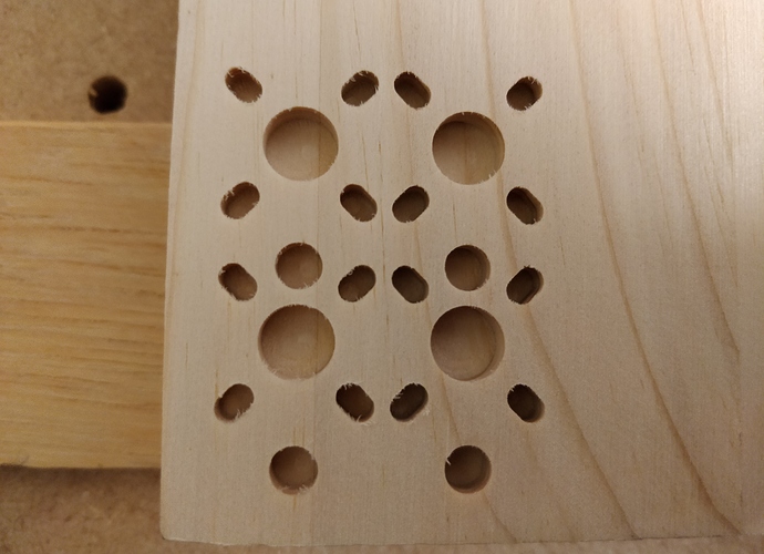

I finally got a precise cut in wood of this pattern! So far tightening the belts way more than I though was necessary worked, and disabling arcs in Estlcam probably took part in the trick as well (thanks for the pointer @barry99705). The pulleys’ grub screws were still tight.
I’ve also tightened the external bolts on the lower XYZ part, but they don’t seem to have a substantial effect on slack. I’ll see what kind of results I’ll get with CF now.
Making solid progress! The arcs is a tricky thing and can be tuned in config advanced. Depending on your firmware version it is probably best to leave them off, it just makes for a bigger gcode, no big deal. I had to tune this for last years MRRF plot with super tiny features.
Today I tried another pair of cuts in CF but they still don’t come out well: the dimensions got slightly better, but they still are nowhere close to the drawings. I tried the same settings above at 2.5 mm/s too but there were no noticeable improvements. Also no differences between using the diamond and the single upcut flute bits.
I think I’m missing something obvious here, since the cuts are good in softer materials (wood, PVC) but CF just won’t get machined precisely. I could give trochoidal milling a shot just for fun…
What are you doing for finishing passes?
0.2mm width, 2mm DOC, 5mm/s feed, 1mm/s plunge. A little bit faster than the standard cut, but I can’t see any evident deflection in the tool with these speeds.
How far out are your tolerances and are they consistently undersize/oversize depending on feature? Using Kevin’s tip from his aluminum guide to fudge your tool dia on finish pass to account for machine’s deflection has helped me dial in the last several thousandths. Haven’t tried CF yet, will hopefully be making my water table soon. I’ve had some CF sheet laying around for a long time, I really want to cut it.
The slots/holes are consistently undersized, unfortunately the dimensions have not varied that much from the drawing that I previously posted.
Changing the the theoretical tool diameter could fix the holes, but then the outer contour of the part wouldn’t be right… I’ll take a look at that guide anyway, thanks.

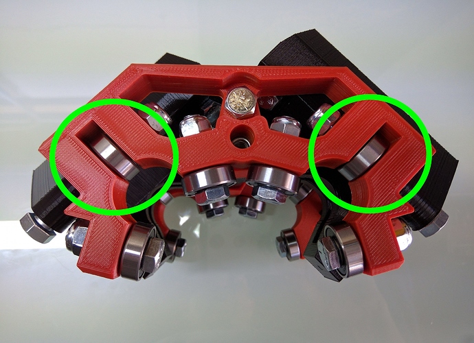

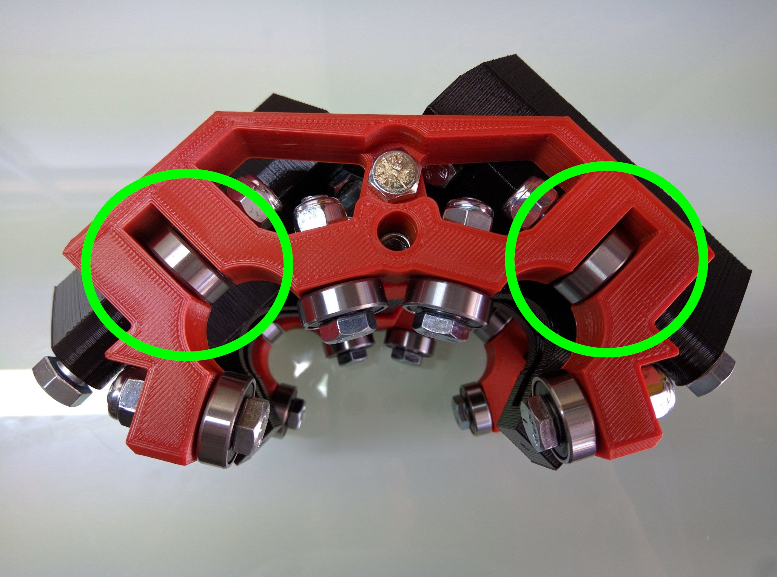

I’ve snugged up all the tension bolts and now the Z axis doesn’t wobble anymore: the bearings are much tighter on the vertical tubings and don’t slip anymore when pushed by hand. I’m only having trouble with the external-back ones (circled in green in the attached picture) that are not applying enough pressure on the tubings, but I’ll figure it out. @vicious1, am I doing this right? I’m not seeing bad effects on squareness right now.

You could have over tightened or your Z isn’t straight. I can only suggest taking it apart and starting again. Move the Z axis all teh way down and all the way up and see if it changes.
With no tension on any of the bolts it should be snug, it is an interference fit, Making everything tighter is usually a bad thing. It is meant for balance not overall tension or we would just start out cranking them all down as tight as possible.

I’ve loosened all the tension bolts and re-tightened them wisely, trying to get a good fit using only two sets of them as I read in other posts here. Now all the bearings are snug and don’t move when (reasonably) pushed by fingers. When the Z axis is all the way up the bearings that I marked in the last attachment feel looser then when it is all the way down, but I couldn’t figure out the reason for this.
