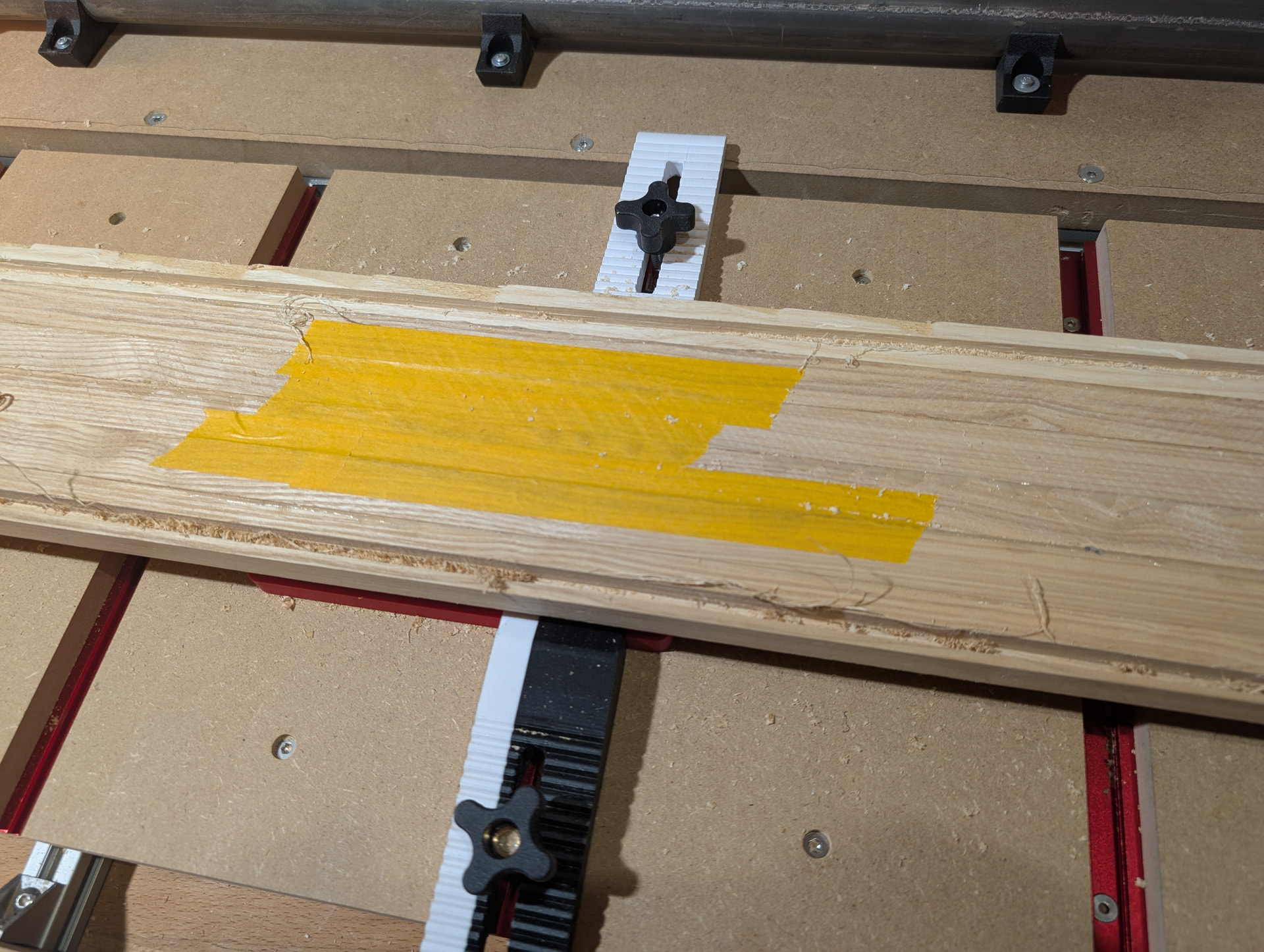

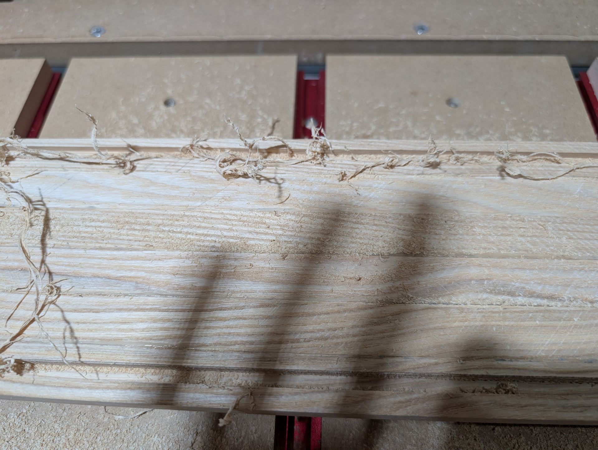

I am pretty sure is a bit issue but I have started to have these wood curls. Could you please confirm it is due to a not so sharp bit?
Can happen when you cut with the grain, then it rather curls. It depends on the wood you are using, maple loves doing it, other wood doesn’t. It happens mostly with shallower cuts.
Yes I am going with the grain. I see this both with ash and poplar. I will try to decrease the cutting depth.

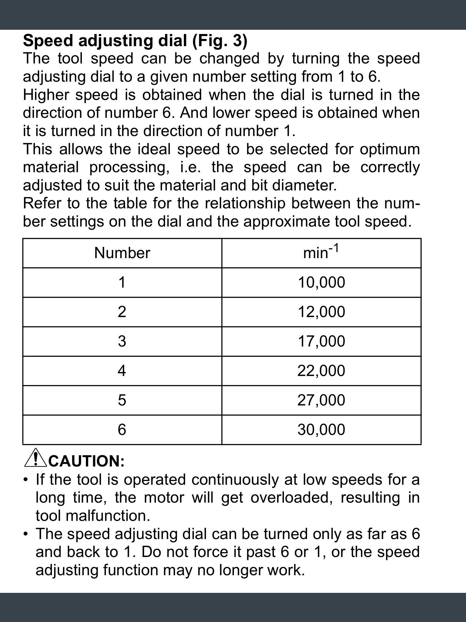

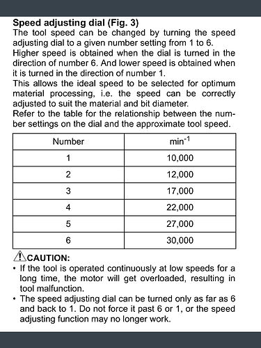

Is there an easy way to figure out the RPMs? The routers just have a numbered dial…how do you know what RPMs correspond to each setting? (I’m using the Carbide ER11 router which is a clone of the Makita I think).
Edit: nevermind…I found this chart for the Makita RT0700
Thanks all. Next time I will try with 3/6 which based on the table should be 17k rpm. I will also increase slightly the horizontal speed maybe to 2k mm/min

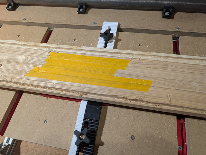

So I just tried with 3/6 on the nob and 2k mm/min. The curling has clearly decreased. I will tr the next ones with the same settings and a fresh bit to see if it improves even more.
