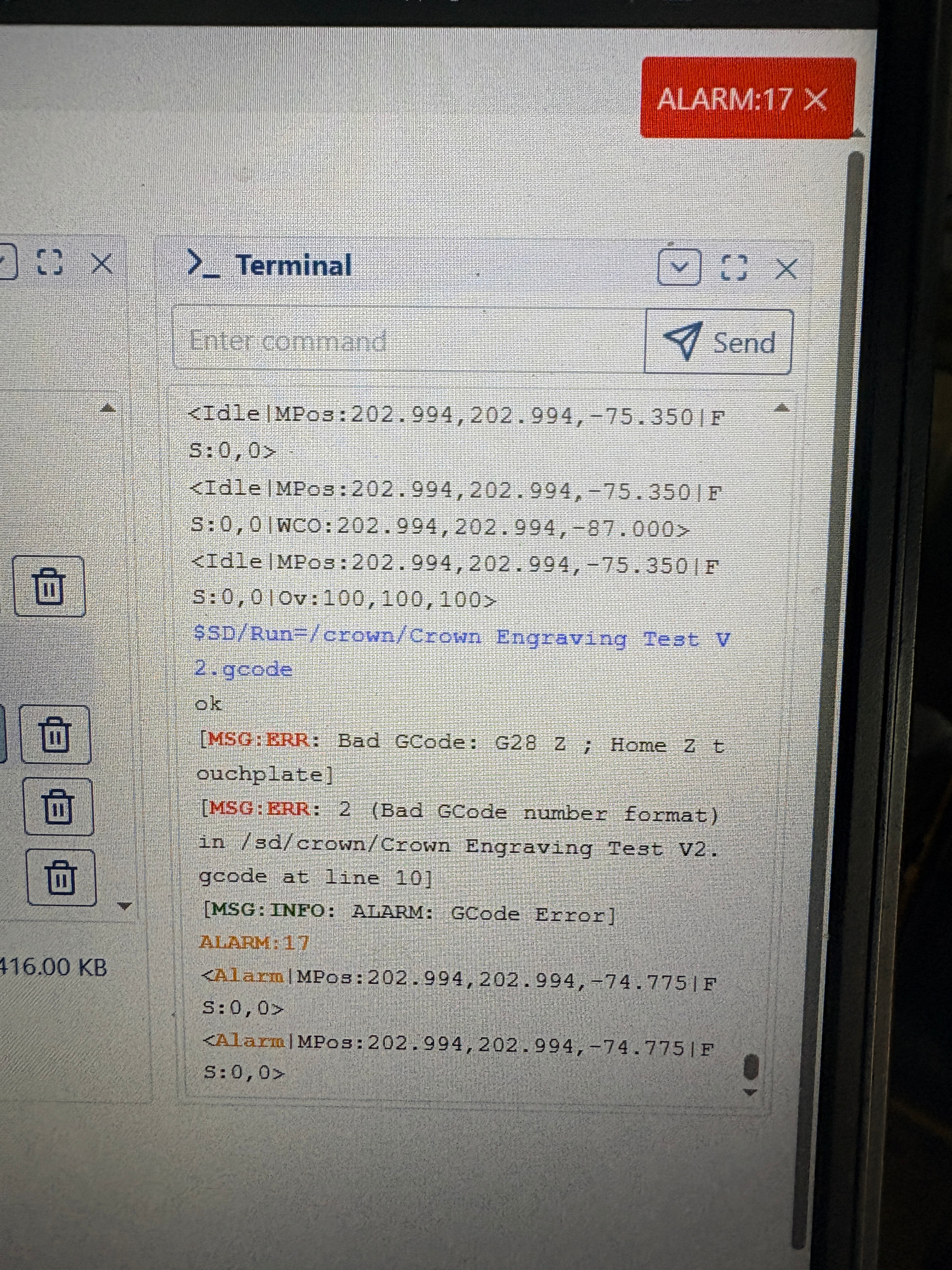

Hey everyone. I just finished building and dialing in my LowRider V4. I am trying to run the crown file i exported from EstlCAM and put in the Jackpot 3 board with the micro SD card. Everytime i hit run/play on the file in FluidNC I get an Error 17 and nothing moves. It says gcode error. Anyone know what Error 17 means and what i might be doing wrong?
G28 is not the right gcode for FluidNC for homing. It should be G38.2 as shown in the Estlcam setup in milling basics.
AFAIK, G38.2 is for probing (not for homing), both in Marlin and in GRBL/FluidNC
G28 is a Homing command in Marlin and GRBL, but appears to be a move to a predetermined position in FluidNC

Sorry, you are correct. For FluidNC, homing Z is $HZ.
Did you run the premade crown already to see whether it’s working otherwise?
are you using the default marlin basic machine setup in estlcam or GRBL? If unsure, just go to the basic settings and select GRBL and then regenerate the gcode file.
Can you check what encoding the gcode was saved in? On one of my laptops Estlcam saves UTF-8 BOM not plain UTF-8 for some reason, which causes that error
