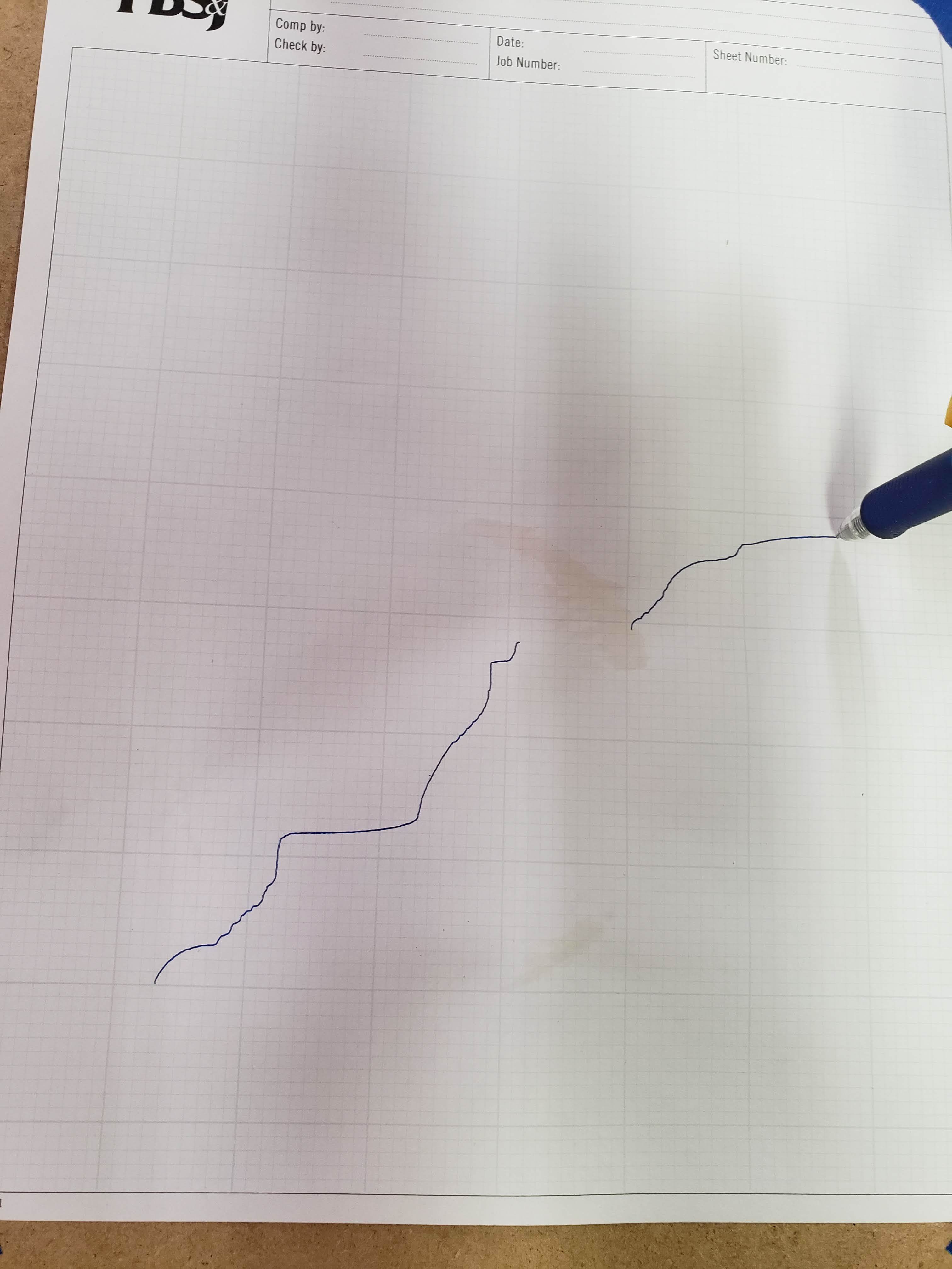

Hi,
Having an issue with my first crown test print.
I bought everything from you (#5084 - 6A / RAMBo Dual Firmware & Wire kit), no modifications to the firmware. I simply hooked it up and plugged in. The Rambo board, connects directly to computer. Followed the Getting Started instructions, all normal with manual control via direct connect from computer (x,y,z all go in the right direction. I then followed the Basic Instructions for the Crown, gcode loaded good and looked ready to go. So Start Print, and that is where things got weird, no crown - just some lines basically from lower left to upper right. Several reboots, resets, new gcodes - all same result
I did not install/connect the duel end stops yet, so maybe that’s part of it?
Attached screen shot, log, gcode and pic of printout.
Thanks!
crown-v2.gcode (13.5 KB)
Repetier-log.txt (30.1 KB)
End stops have to be hooked up.
I’ll hook them up tonight and try again. Thanks for the reply!
Thanks for the quick reply Barry. I just got done installing, wiring and hooking them up. Quick check yielded a nice little crown, you are my king!
Now off to calibrate. Thank you much for the help!
