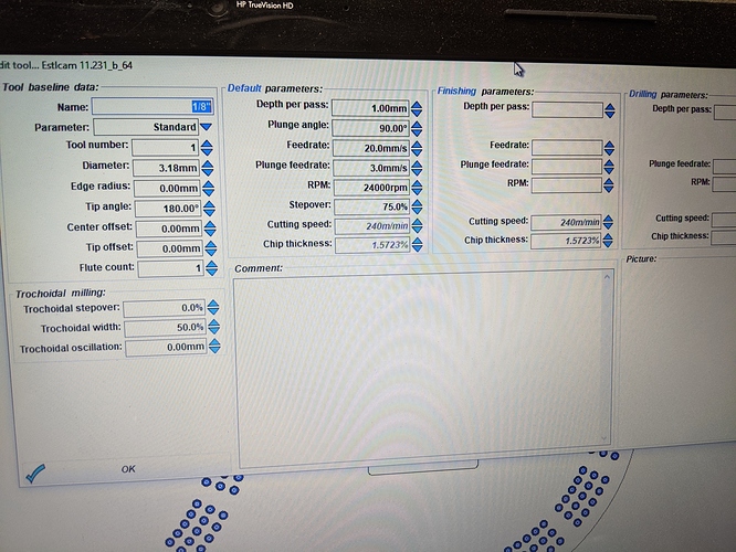

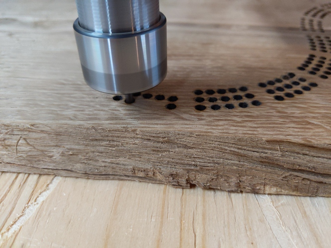

I’m not sure if it’s cheap bits, or the wrong bit settings, but I’m getting burnt holes
Tool settings
It could also just be the sheer number I’m doing…
Drill bit? Or end mill?
Is it pecking, or just going all the way in and then back out?
1/8 end mill, pecking
1mm at a time… Should probably go deeper I guess?
or do some test plunges at different speeds and see if you can go faster. Burning is usually caused by the end mill rubbing on the wood instead of cutting it, or from dust getting stuck in the hole and having the bit rub up against it.
Do you have a 1/8" drill bit you can try with? End mills aren’t really made for drilling. The flat ends causes them to wobble.
I’m assuming the end mill is an up-cut?

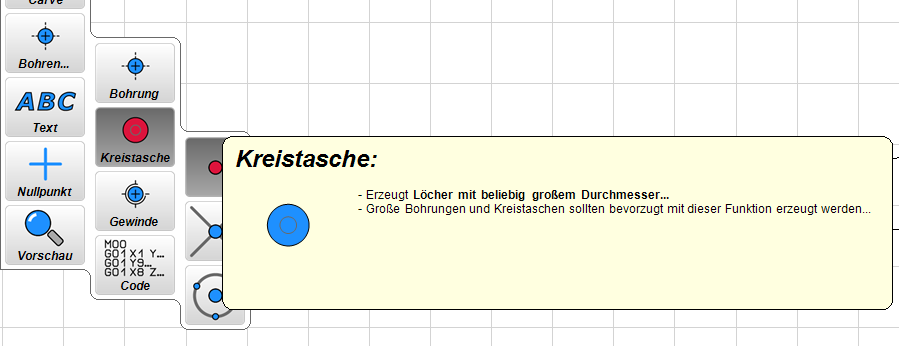

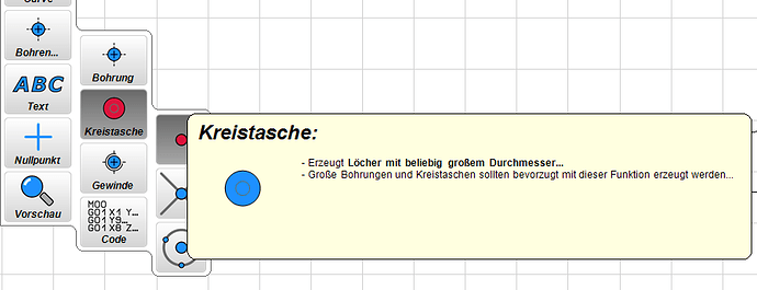

Another alternative would be to use a 1/16" end mill and do a helical-path cut where the bit would cut in a circle and work it’s way down while cutting the circle. Not sure if ESTLCam can do those or not. I’ve bored holes in wood using this method in Fusion 360.

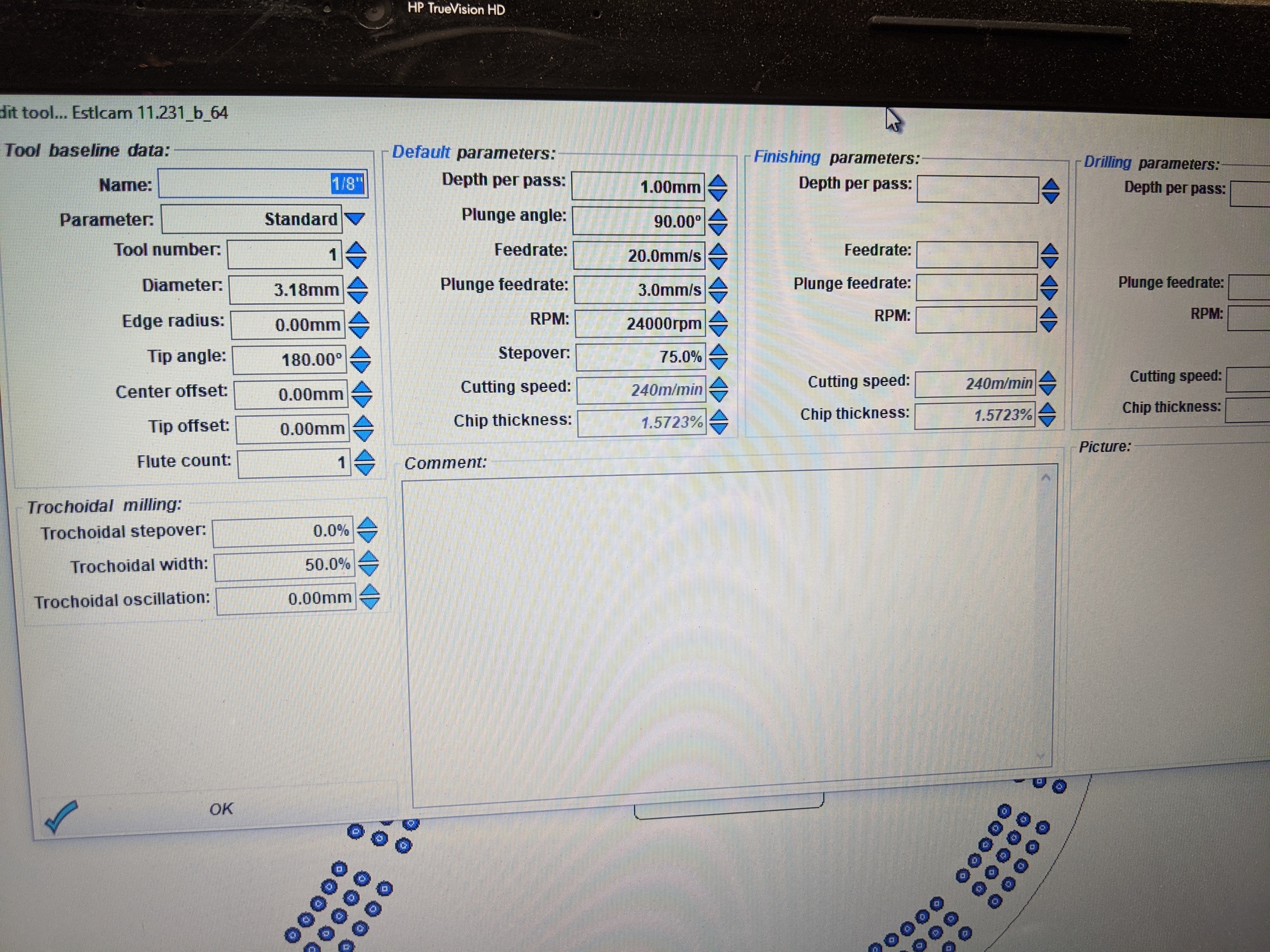

I’d also go back to trying different DOC and plunge speeds. You could be plunging too slow.
I’ve modified the tool settings to go from 1mm DOC to 2.6mm, (plunge rate is still 3mm/s) which I’m hoping still works fine, and will reduce the number of plunges from 13 per hole, to 5 per hole. (each hole is 13mm deep) … if nothing else, it reduces the job time from 3.5hrs to ~ 1.5hrs (I’ll know more precisely when I load it into repetier)
Estlcam can do that. Just did it today. I don’t know if it will work with those tiny holes of yours though.

Sure, ESTLCAM’s favourite way to make nice holes. Even in two passes, if you wish.

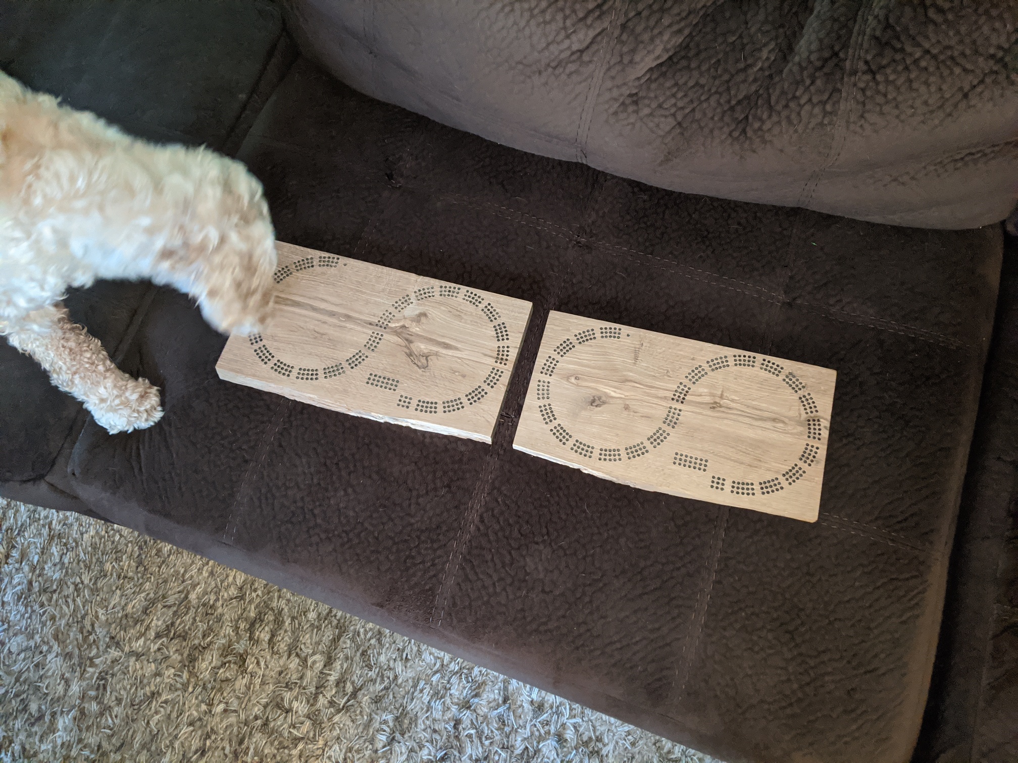

Ooh, new 2.6mm plunge depth reduces job time to 45 minutes
Looking good
