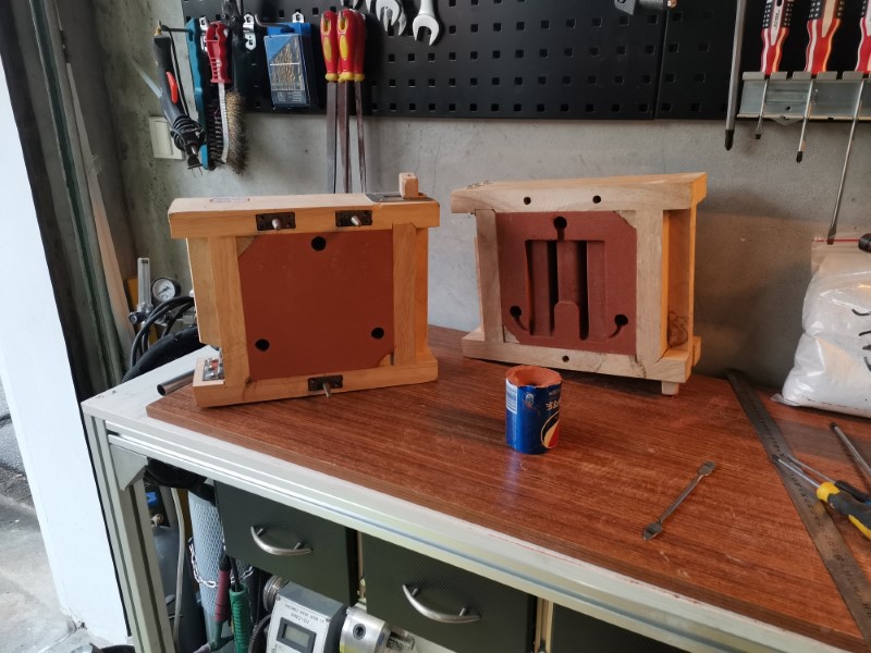

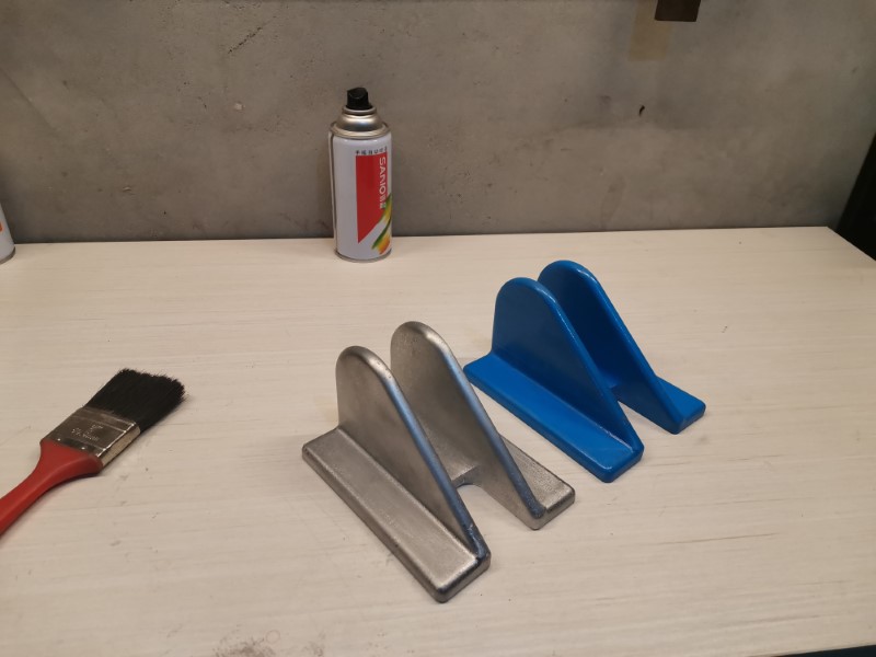

Here is my last aluminum casting, from a few weeks ago (this time using sand casting):
The mold:
Finished part:
