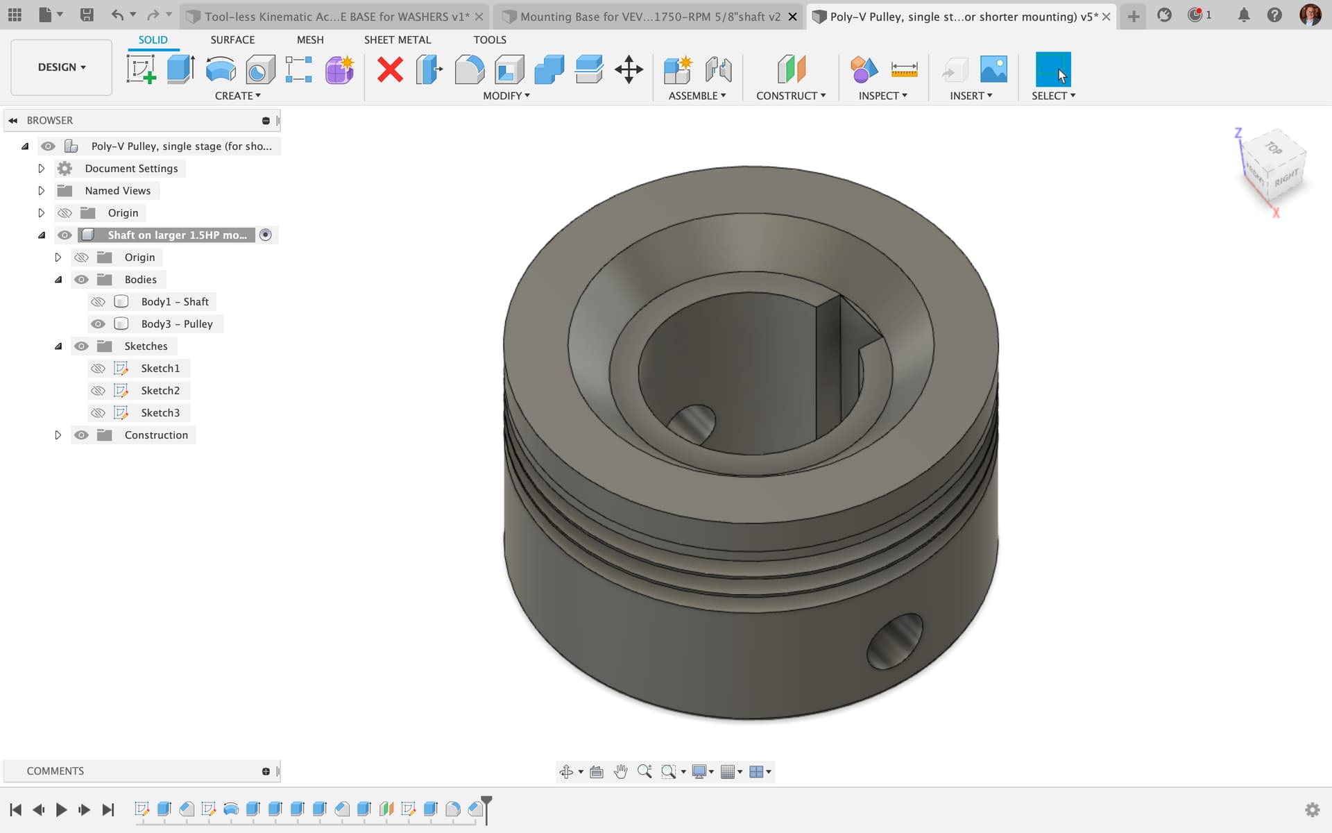

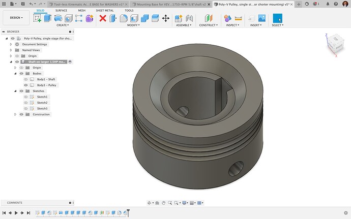

Crazy to try?! Printed Poly-V Pulley for 1.5HP Motor for Vevor 10" Bandsaw
Updated single stage pulley design:
UPDATE:

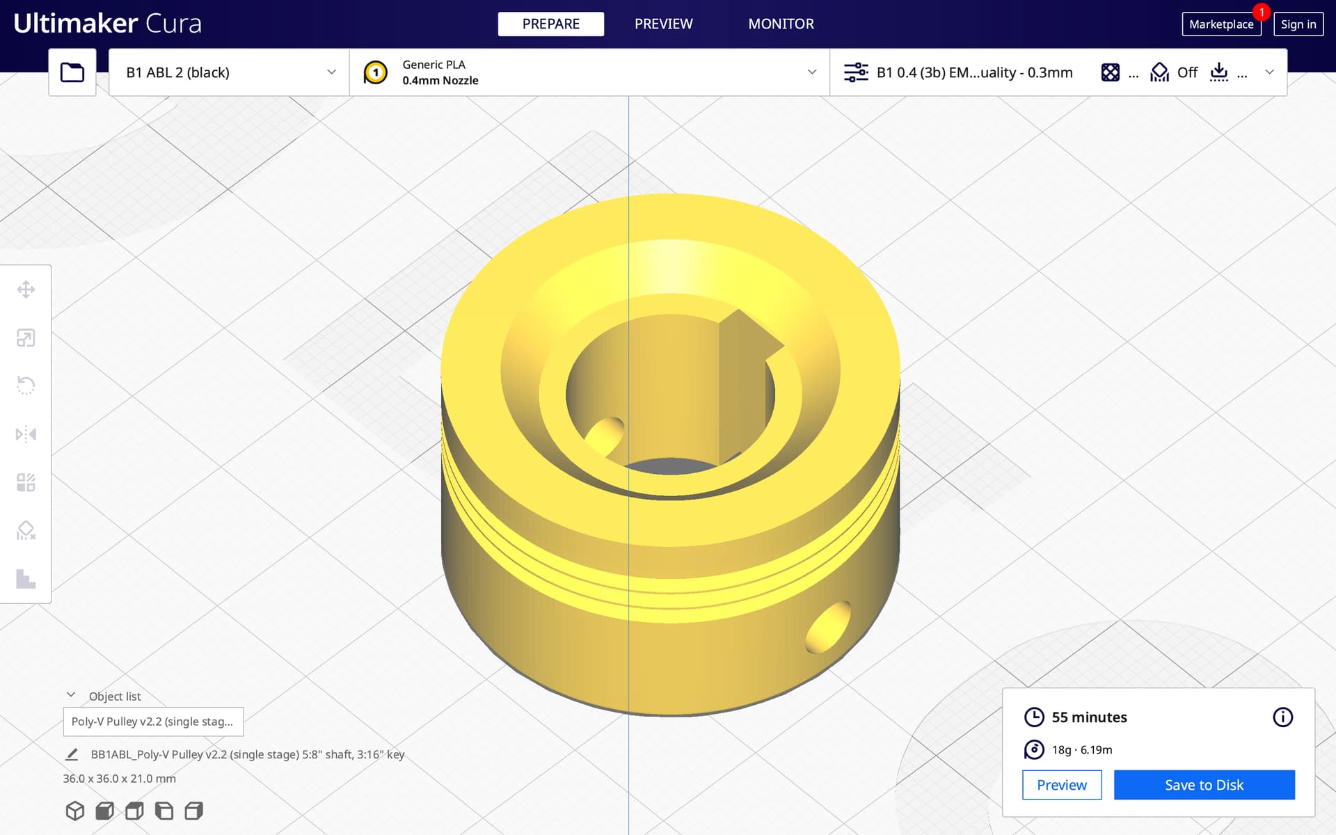

While working to install, I realized that the differences between old motor and new, old shaft and new, and old pulley and new, meant the new pulley must be single stage only, one speed instead of two, and the smaller of the two new stages has to be the one to keep (which is about as large as the larger of the two stages on the old one), and in revising the pulley to that new design, I decided to print with enough perimeter walls as to make the thing solid (no infill at all).
So that is currently printing.
Attached are STLs of the two stage (unused) and the one stage (used) as well as DXF and SVG of the mounting plate template.
Poly-V Pulley for 1.5 HP Motor for Bandsaw, 5:8" shaft, 3:16" key.zip (272.7 KB)
Mounting Plate Template for VEVOR Electric Motor 1.5-HP.dxf (314.6 KB)
Mounting Plate Template for VEVOR Electric Motor 1.5-HP FOR CUT

Great idea! Now why didn’t I think of that? Not too late!
Above, the zip file of STLs in the second post, has been updated to have two grub screw holes, for balance.
Update: so, the PLA print was not strong enough to serve for this purpose in this way. I’m concluding this effort as not a viable option, and resorting back to search for normal metal pulleys.
How did the pulley fail? I was thinking that the tension from the belt would be likely to split the pulley in half.
If that’s the case then you could try replacing both sides together and using a toothed belt instead of a V-belt. That would make the forces involved more in-line with the strongest part of the print. Alternatively, you could also try making a couple of metal plates/washers and using screws between them to ‘sandwich’ the pulley together?
As soon as the blade got any resistance, the force required to spin the belt was more than the grip of the plastic pulley on the belt. This allowed the belt to not turn while the pulley still turned. This resulted in friction, which caused heat that softened the plastic. It did not last long after that. I should have seen it coming.
Right, that makes sense. You could always try printing the pulley with the ‘fuzzy skin’ option or gluing something to it to increase the friction?
