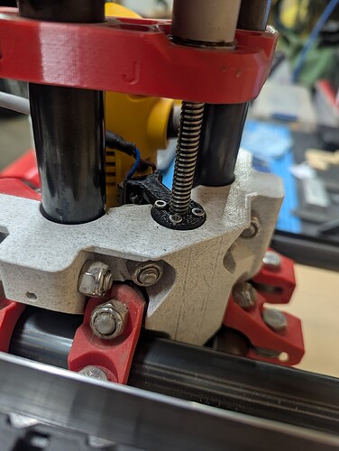

Crashed my Z axis twice this weekend
Hey folks, I’ve been messing around setting work offset and saving to eeprom. It’s nice being able to return to my fences automatically.
My Z axis switch works just fine during homing, but I discovered that while operating from a work offset, I refracted to high and broken my Z switch mount.
Movement isn’t being hauled when switch is triggered.

You should start by fixing you switches and showing good test results with M119 before you do anything else.
You shouldn’t need to mess with compiling anything.
If, after you fix the switches you still have motion issues, then we explore what you did to EEPROM.
Edit, also to clarify- with default configuration, the end stops are only active when homing. When running a job they have no effect.

When I running M119, close the switch. z_max shows triggered.
Is z_min responsible for hauling movement during G0 movement?
In the default configuration, no endstop is active on any axis to halt movement, G0 or any other motion.

The LR series is designed to be robust to most travel into the limits. If you have a workflow that requires the end stops be active then you would have to recompile.
I’m Curious- what happened to the end stop that broke?
You can enable it, I work with endstops that can trigger while cutting.
Why do you have an endstop on Z though? :sweat_smile:
The 3D printed mount bent/broke. I just had to reprint the mount. My retract setting from fusion was too great from where I set 0,0,0 for a ghost run of the gcode. So the 25mm retract when I was only 10mm from the switch was my own fault.
