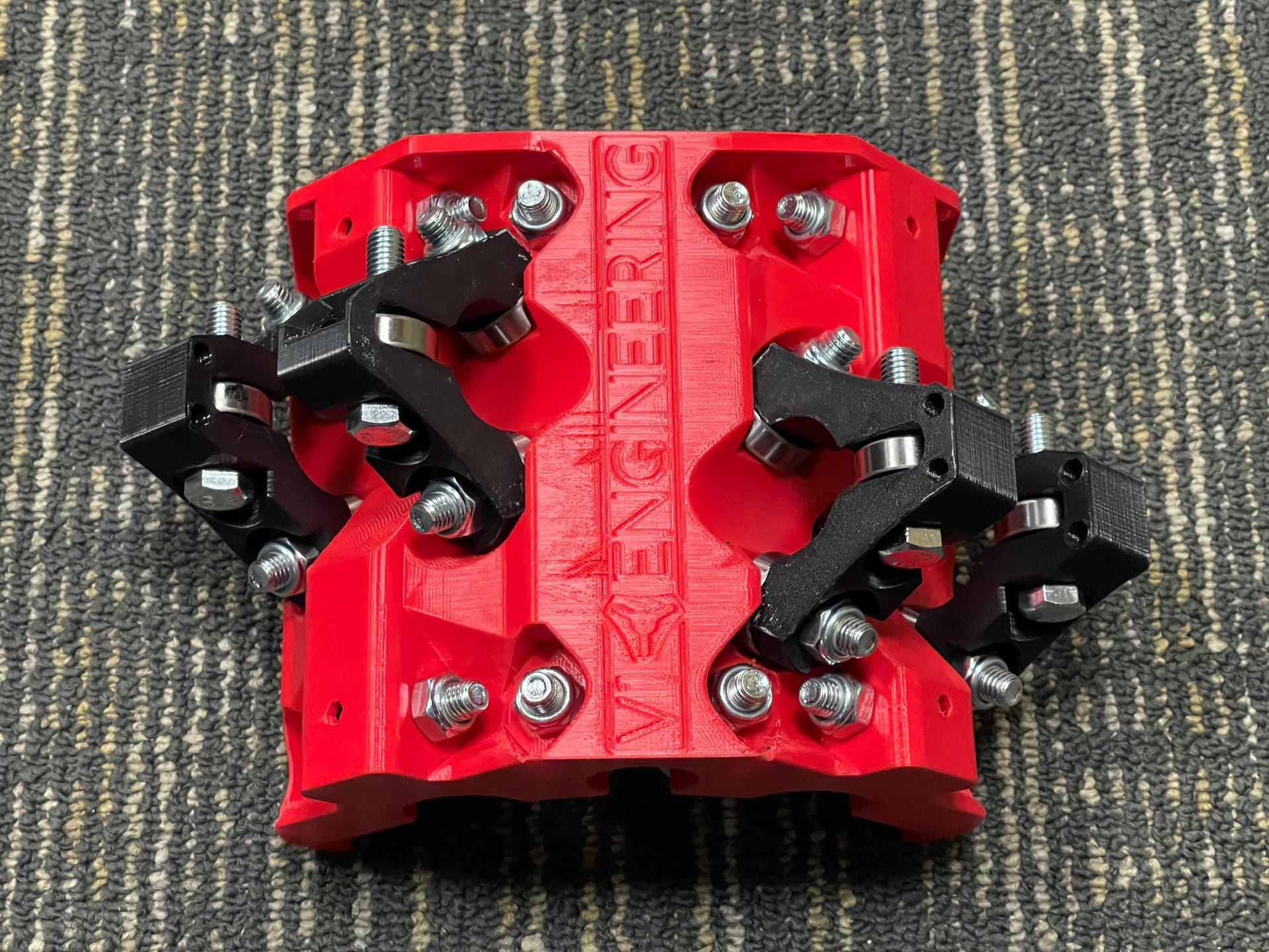

A little progress from today.
As you can see I don’t exactly follow the directions. I need to find a board to mount it on. I ordered some belt and need to find a few stepper motors that I’m sure I have as spares.
This seems like a good place to put my MPCNC until I get it working. I really need to find some 3/4" screws so I can mount the feet and get it all squared up. I can move the core around very easy the way it is now.

That looks really nice together.
Just a heads up, your trucks are on backwards :slight_smile:
You’ll get a couple more inches in the X+ and Y+ directions if you swap them.
