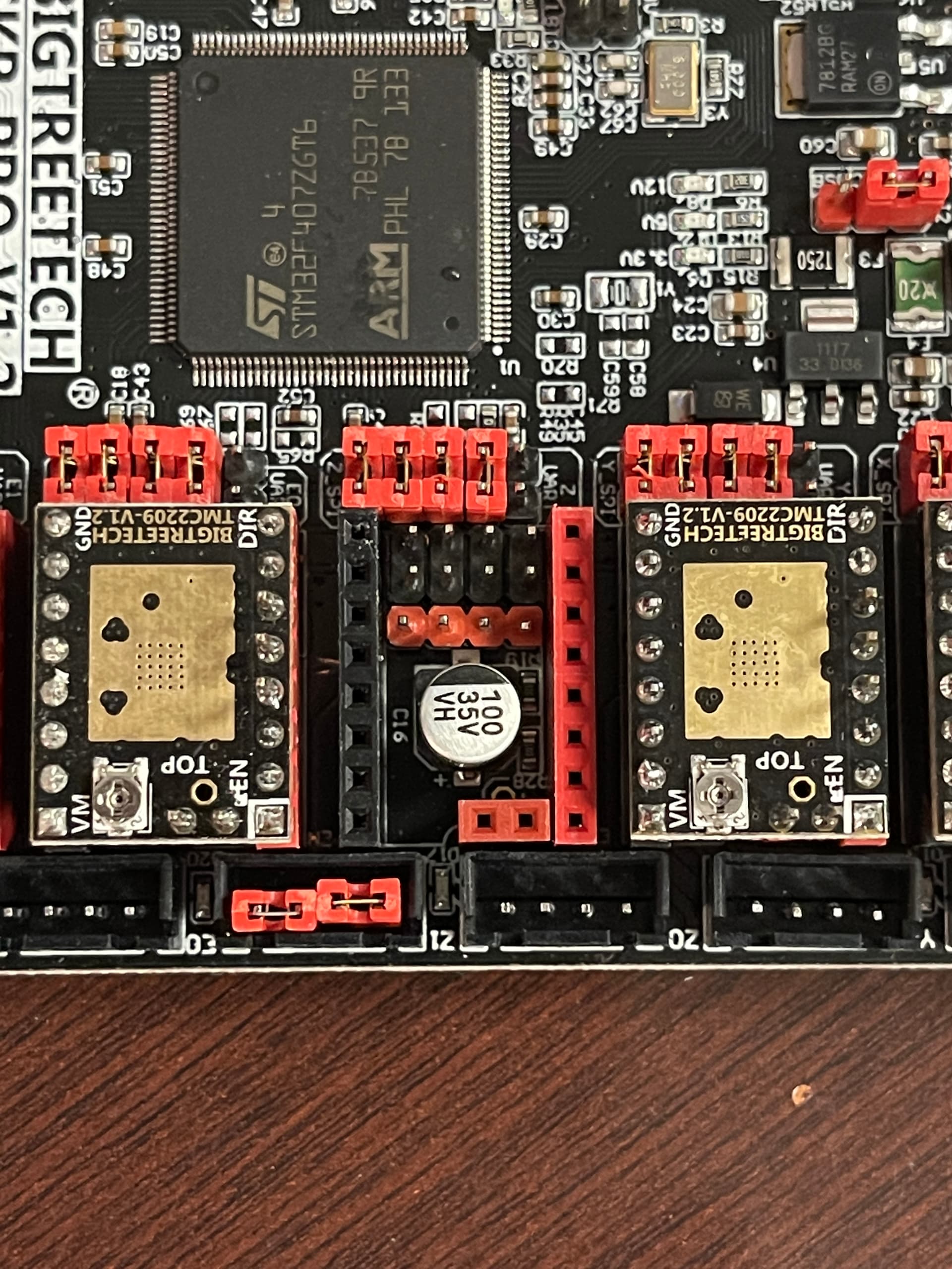

Not sure if this is really an issue or not but this middle stepper driver will not go in all the way on my SKR-Pro V1.2 I purchased from V1engineering.
It should not be an issue but why is it happening? Is the bent/cut pin hitting or something else?
I tried it with another stepper driver but it still won’t go in all the way. With a jumper the pin will only go down so far in the top left black “connector”. The rest of them are ok.
Two things. First is it could be fine and good to go. If it does not work you can carefully pull off the black socket and look for anything odd, and put the socket back on.
I should have just left it alone I guess. That pin pulled out with the black plug. Doesn’t look like a very good soldering job. The first 2 pins pulled up a little as well, but the last pin is off totally.

Well I read over the part about if it does not work. After pulling the other JST plastic shields I didn’t think it would be all that hard to pull it off.
After lunch I can try fixing it. Any chance I could just use E2 instead?
You can swap the pin numbers in the firmware to use the other port, if you can’t easily fix it.
If I sent you a bad board though I will swap with you if this sort of fix is not an option for you, I will give it a try. It’s just faster for you if you can easily solder it in.
I hate to have you replace the board but I think that might be the best option.
If you want I can cover part of it since I pulled the plastic connector off.

Send me your order number, no worries about pulling that off. I would have done it anyway, just make sure it ends up in the box in case I can repair it.
