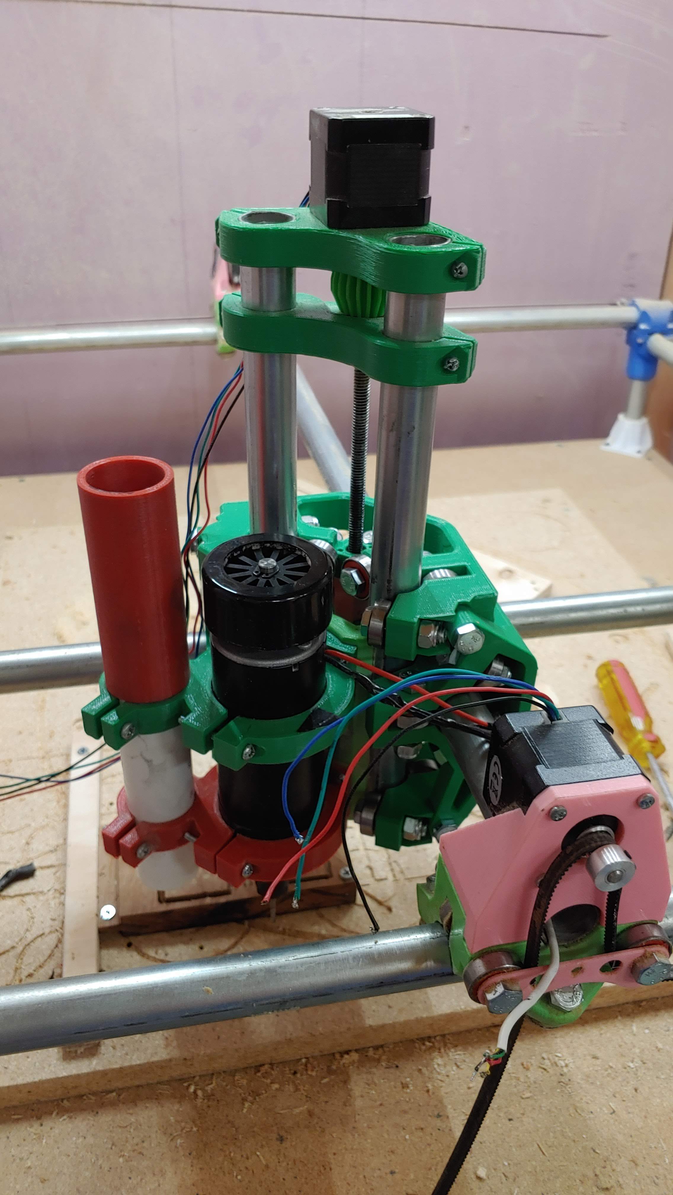

I was noticing that I was getting really nasty chatter. I kept adjusting my feeds and nothing was helping. Yesterday I took some time to go tighten up some bolts as it looked like the XY gantry was wobbling.

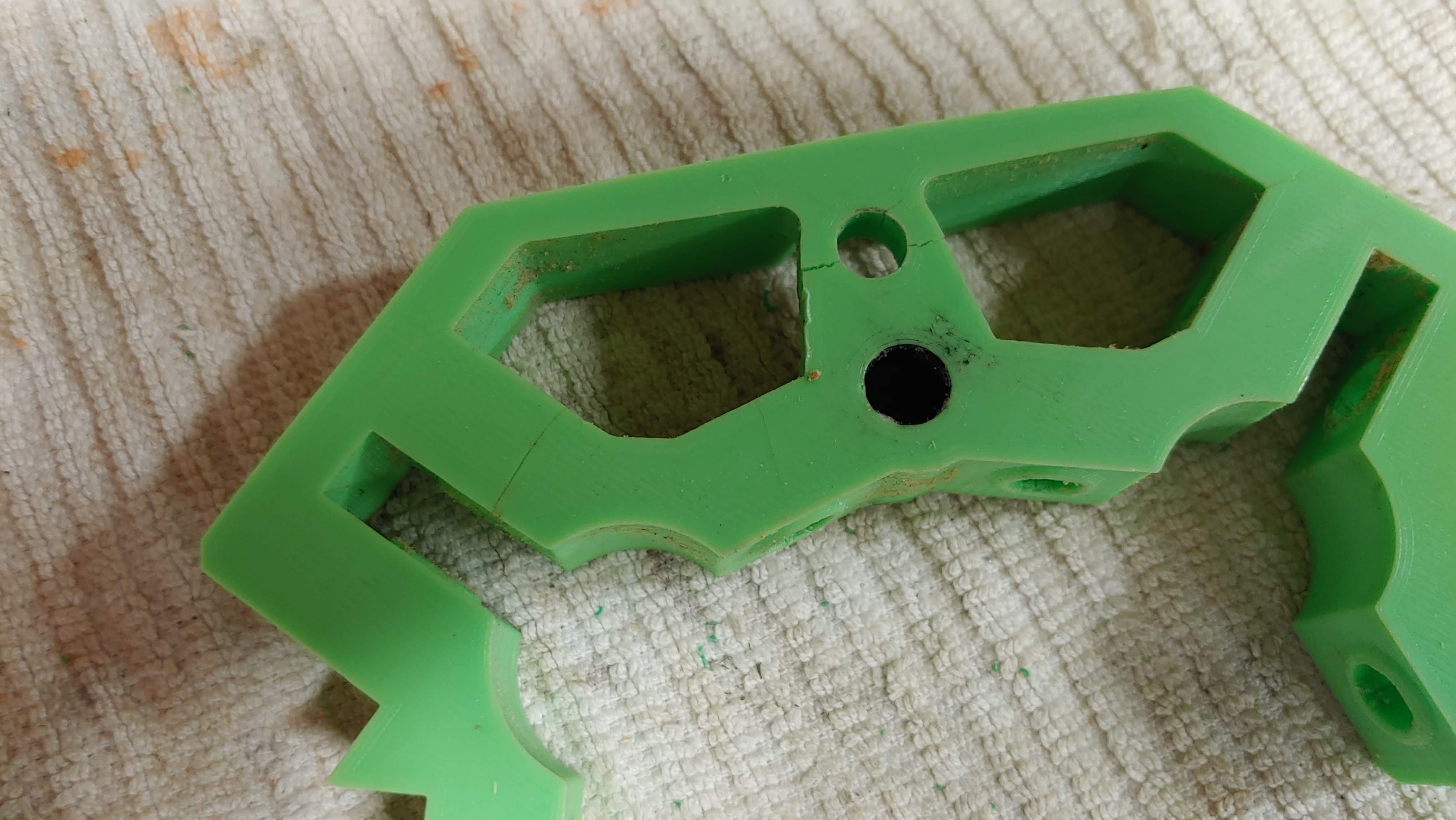

When to tighten one of the bolts and saw nothing but cracks around it.
Looks like I’ll be printing a new gantry soon.
Waaaay too tight! ?
Original parts from when I built the machine almost 2 years ago. This picture was taken BEFORE I went to put a wrench on them.
This brings up questions, though…

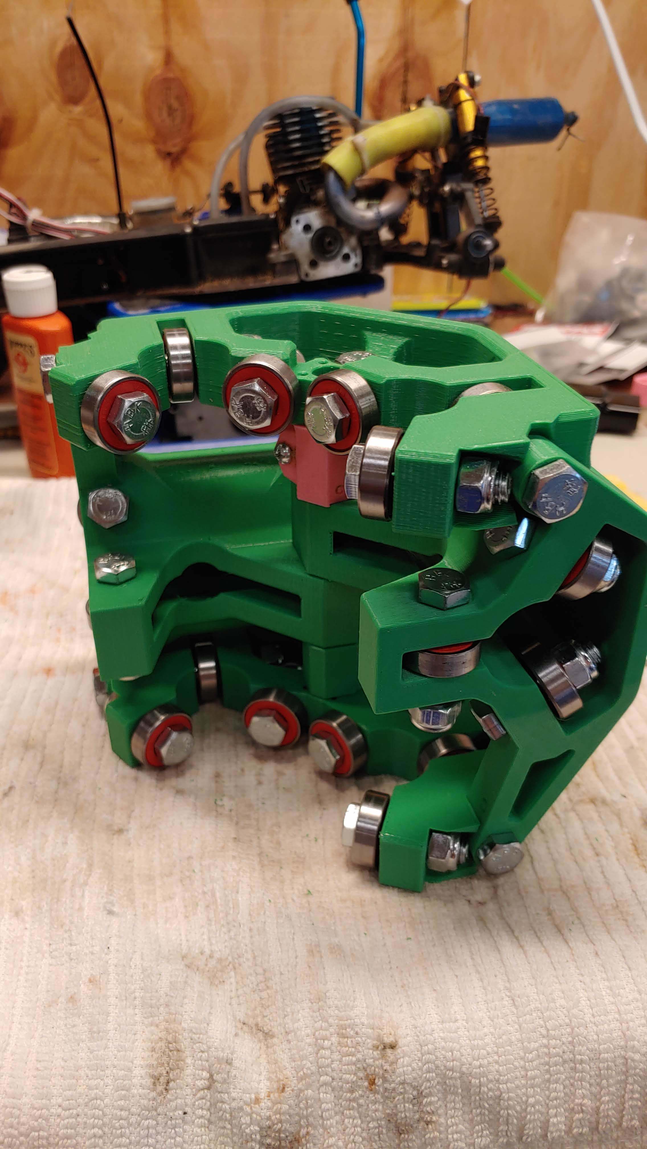

Got the XYZ parts printed.
Just need to print the two XY parts now
Got the last XY part printed last night. My little, highly modified, Geeetech Aluminum printer has been really consistent with PLA lately. I’m hoping I can get the gantry swapped out this weekend, but I also want to get a new workbench built. Not sure I can get to both projects.

Almost have the gantry swapped out. You can see where the old pieces cracked over time. That would explain the issues I’ve been having with chatter and a semi-loose gantry.
All I have left to do is solder the steppers back together, square up the gantry, and re-tension the belts. I need to stop and buy some zip ties on the way home for that.
Good news is… The old nut holder for the threaded rod fits the new burly parts.
