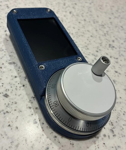

One other question, as the board has an RJ11 port on it, I can use a simple phone cord to connect my newly built pendant, right?
That is correct as long as it is a 6 conductor cord I believe. The pins don’t line up correctly for a 4 conductor cord if I remember right
Yes you can. I have one plugged into mine.
Not really. Depends on your chosen definition of RJ11, RJ12, or RJ14.
You need a 6 conductor (6P6C) cable, rather than a “simple” phone cable that has only 2 or 4 wires (1 or 2 pairs).
This is what I have: Amazon.com: NECABLES 2Pack RJ12 Cable 6ft Phone Cord RJ12 6P6C Male to Male Straight Wired for Both Data and Voice Use Black - 6 Feet : Electronics
Don’t get a RJ12 cord with “flip” wiring.
