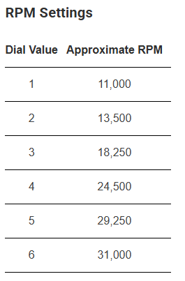

I would enter the RPM since that will calculate the chip thickness.
You’ll just have to translate the RPM to the dial position on the router when you run it.
Hmm, it looks like the Carbide ER-11 Router went from $60 to $120.
You give estlcam the feedrate, RPM and tool data. It then calculates the resulting chip load. It does not calculate it’s required feedrate from your rpm and desired chip load.
If your spindle speed is not gcode-controlled, setting the wrong RPM just makes estlcam display the wrong chipload to you.
