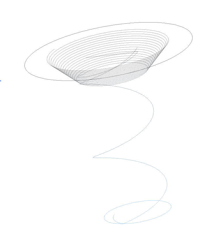

Hello,
yes - bore holes and helical drill holes can be countersunk by just specifying a chamfer with no tool.
It will then create the countersink with the same tool in a spiral motion:
Christian
