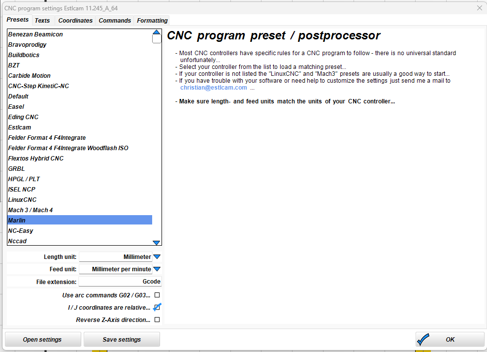

Test cut with arcs turned off is done, I came up with a rectangle of 4.91x5.91"
With arcs turned on it was 4.88x5.88 so it’s a little better.
5x6in_no_arc.Gcode (18.5 KB)
As far as I can tell, GCode still shows a move from X22.225 to X155.575, which is 133.35mm, or 5.25"…so something else must be up

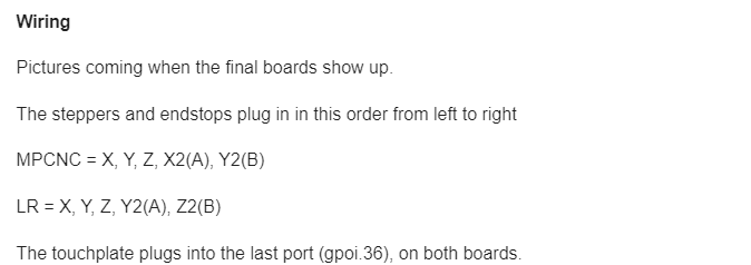

Not to get too OT here but I couldn’t figure out where to plug the endstop switches in.
The page for it says pics coming soon.
Jackpot CNC Controller - V1 Engineering Documentation
If I start down the trial and error road, I’m bound to fry the board

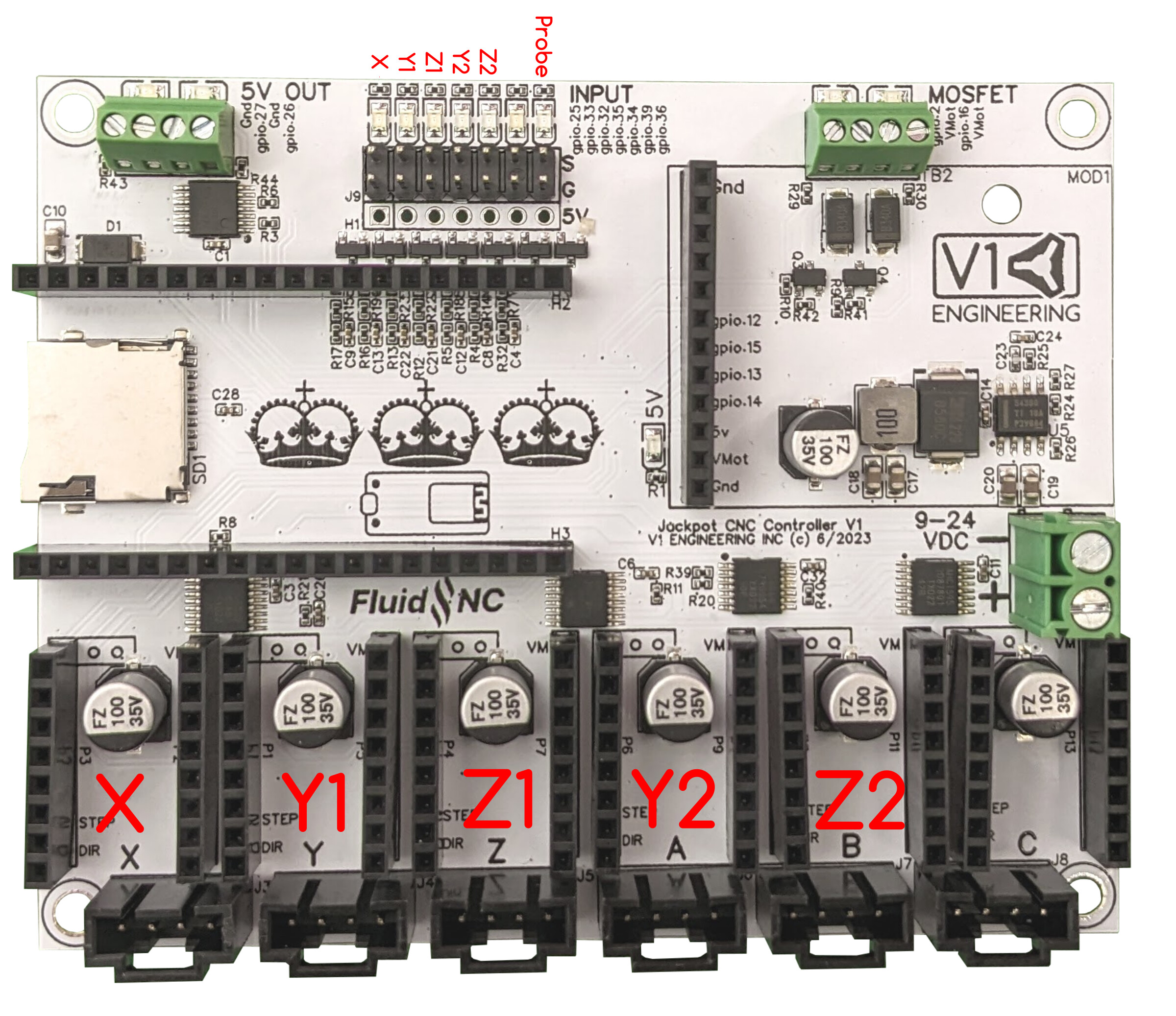

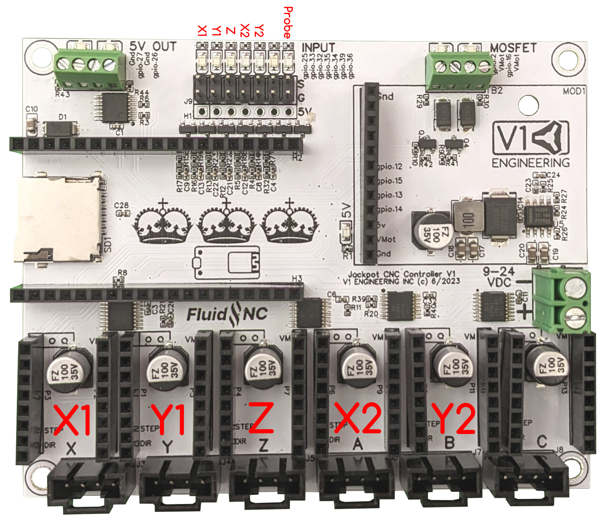

Ryan posted some pics there. I used that to wire mine
How do these look?
I think it’s good. Basic confirmation I was placing them in the right spot was about all I was looking for outside of what was already there.
Maybe goes without saying but for noobs it could be helpful to be explicit.
LR3: X min, Y1 min, Z1 max, Y2 min, Z2 max.

It did already say
My issue with it as a noob, was it wasn’t clear to me which side was left or right, so I was concerned about screwing something up. The steppers were easy because it was the only one with drivers in it, but I wasn’t for sure which side to start on for the endstops, and wasn’t sure about wire orientation and whether it mattered if the plugs were flipped.
But looks like Ryan already updated the docs with the new pics for both, so I think it would have been much clearer for me with the way it is now.
(Although it does still say “The touchplate plugs into the last port (gpoi.36), on both boards.” @vicious1 )
I added it to the docs with the machine name under it.
What part of that isn’t sitting right with you?
These are great. Sometimes when a wire comes loose, I’ll just google search for these wiring diagrams so it would be useful if you put “LR3” or “MPCNC” on the image so it’s immediately obvious when they get surfaced in a google search.

gpio.36 rather than gpoi.36, right?
Ohhhhhhh yup, that dern spelln’ get me again.

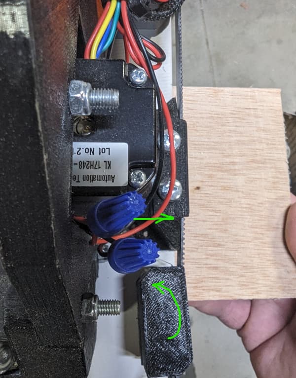

To get to the punchline, part of my issue was my Y1 belt being too tight, in combination with the belt end stops being slightly misaligned. here’s a photo:
I added a couple of green arrows although it’s easy enough to see that the belt block had rotated a bit under the (over) tension of the belt, and then it created this issue where the lowrider’s Y1 motor /pulleys now sit proud of the belt rather than being perfectly in line with it.
As you may have seen in my previous posts, I was having a lot of trouble with 1/8" inaccuracies previously and thought it may be something to do with a bad compile I had done of marlin on my SKRPro, or something along those lines. After installing the Jackpot controller, I was able to cut out smaller test pieces with quite good accuracy, however, on larger cuts that got a lot deeper into the LR3’s X and Y travel, I was once again finding inaccuracies that were in the 1/8 to 3/16" range. After may attempts at re-squaring and a slight adjustment of the E-steps in both X & Y, I was getting dead accurate measurements between 3 of the 4 corners, but the side of the rectangle where the X axis was maxed out always gave me a measurement that was 1/8" too long and I just couldn’t get the diagonals to match. After loosening the Y1 belt, I finally got a perfect 90 degree rectangle with all four sides being accurate lengths.
