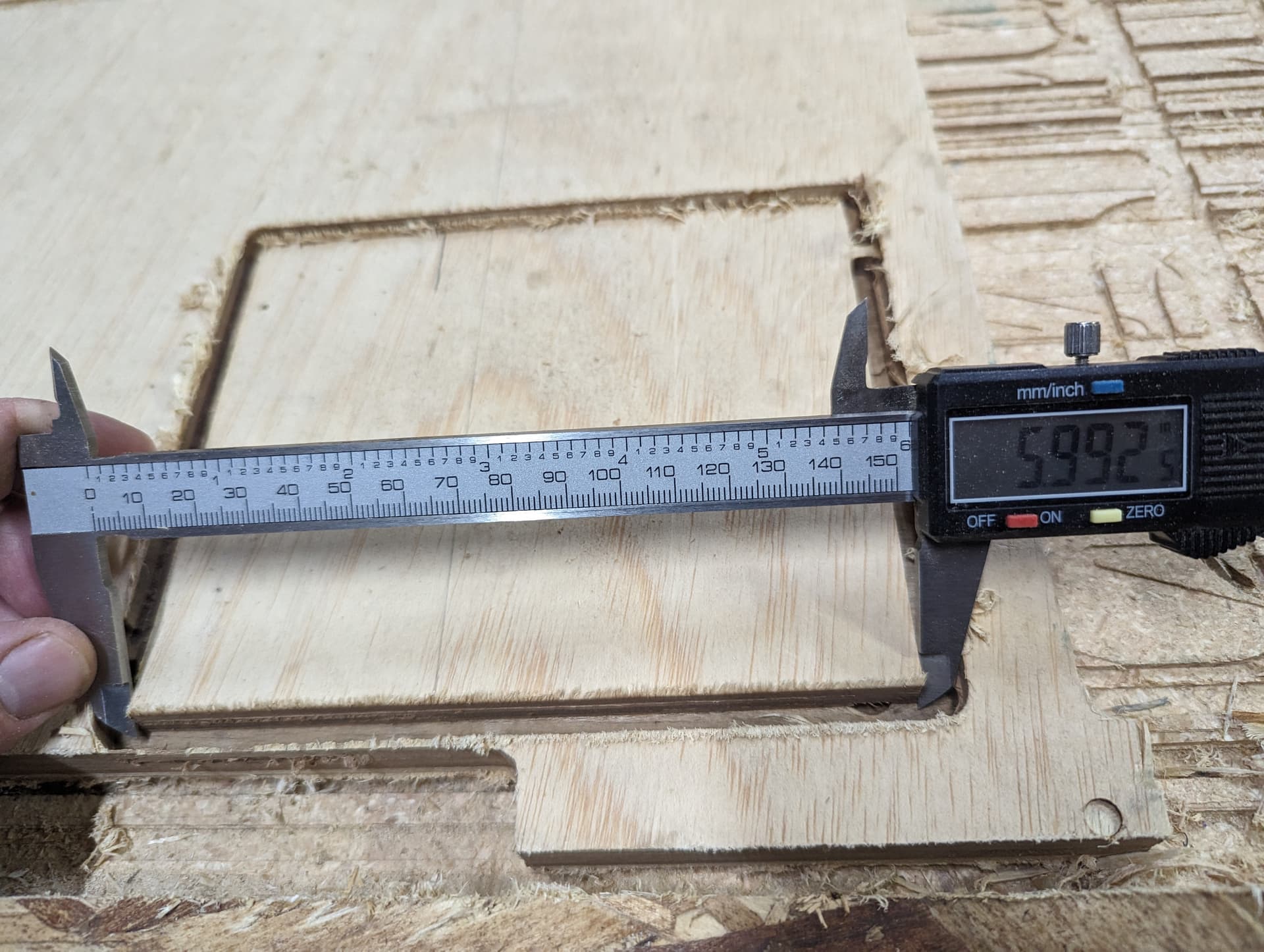

I’m blown away with these results, here’s what my LR3 cut for a 6" wide hole:
A little hard to see but it reads 5.99", so only off by 1/100th of an inch!!!
When I offset my 6" wide piece by 1/16 (effectively making the drawing 6 1/8" across) , get the same result, off by only 1/100" WOW!!!

It could also be that the core is loose, wobbling left to right. So if it goes to the left, it tilts as well so that the cut is short, tilting to the other side when going the other direction. Are the cuts only off on X, or also on Y?
What’s up with the circled area? Estlcam likes to close its paths, but this obviously isn’t.
This speaks to some sort of movement of the machine that it isn’t designed for. I see a similar artefact in the other picture as well. It looks like the shape isn’t properly closed.
The above response about the core possibly being loose and allowing movement seems like it could be, or else the belts are loose and have slack. Either way, this doesn’t look like the hardware is correctly set up.
If that’s multiple shallow passes and not a single full-depth cut, then that would have to be a holding tab, perhaps?

That is in fact a holding tab.
I’ve been over all the belts and grub screws so there are definitely no loose parts at this point. In fact it’s cutting very accurately.
I’m convinced that when I select "part* in estlcam it’s center in the toolpath on the line instead of cutting the edge of the line. In other words, it’s reducing the size of my part by 1/2 the width of the bit.
