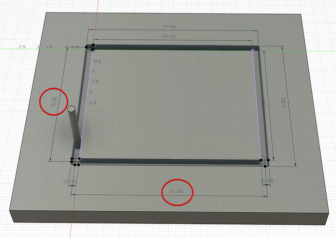

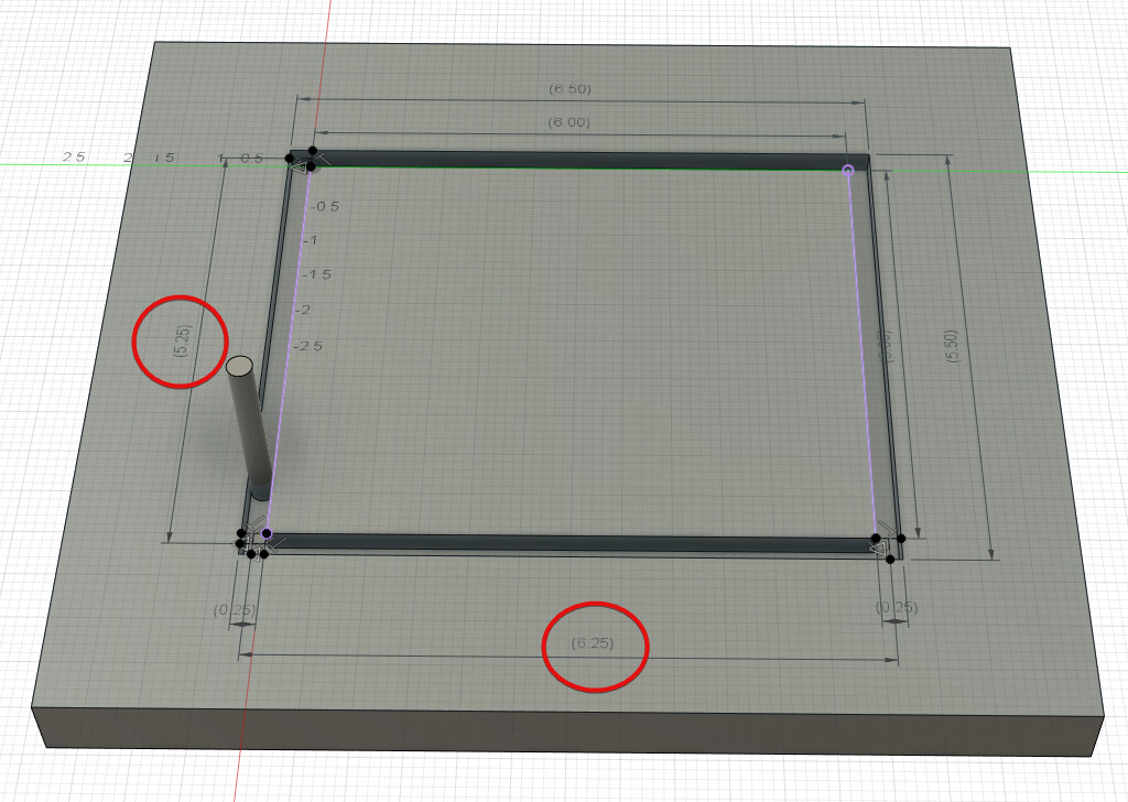

The center of the bit needs to traverse 5.25 x 6.25 because the radius of the bit is taken from each side. Ideally the bit center would traverse 5.25 x 6.25 and leave a 5" x 6" part and a 5.5" x 6.5" hole in the scrap.
It is as if you are losing the radius on one side only, which is part of what makes it so weird.
Maybe a 5" circle would indicate something. If you are running into soft stops then you would see flat spots on two sides of your circle but the diagonals would be the right dimension. A smashed rectangle is still a rectangle and it’s less obvious what is happening.

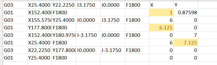

If it should be traversing 5.25x6.25, then it is a Gcode/EstlCam issue: I pasted a block of the gcode from estlcam into excel and converted the mm values to inches, there’s a 1" offset from 0,0 for both x and y, so therefore it’s traversing 1/8" less than it should on both axes.
SO… the error is indeed coming from EstlCam. Probably something that I’m doing.

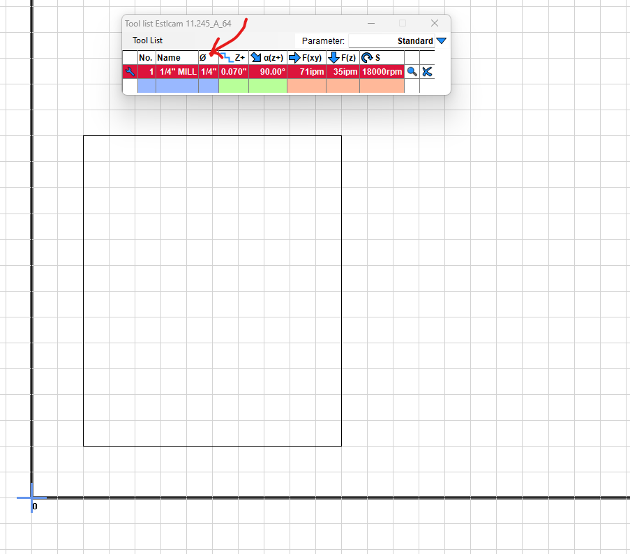

I think that I have my tool correctly defined as .25" diameter, but there must be something else that I’m missing.

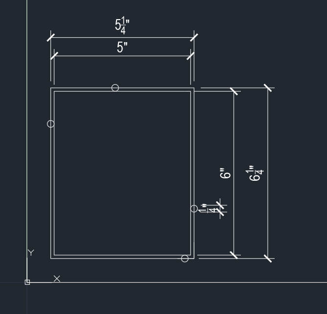

Maybe this will help clarify what @jamiek is saying
The red highlights are the dimensions of the center of your tool passing around the outside.
( Well…where they should be :slight_smile: )
Just figured out how to quote other messages. woohoo.
Thanks, yeah once I sketched it up, it made more sense to me.

I don’t have a good grasp at reading Gcode but if you look at the file I posted, it looks to me like it’s actually moving 5.125x6.125, not the 5.25x6.25" it should be (I started the rectangle at the coordinates 1,1):
I’m only slightly familiar…I’d have to defer to someone here with more experience

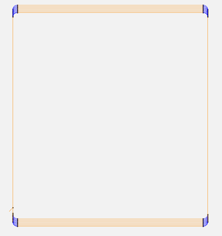

The G03 commands are the rounded corners. If you ignore the I and J parts, the X and Y determine the endpoint of the arc. The extreme X and Y values occur at the ends of the arcs. The extreme X values are from 22.2250 to 155.575 which is 5.25 inches. The extreme Y values are 22.225 to 180.975 which is 6.25 inches.
But maybe somehow the G03 commands are getting dropped? That might lead to a behavior like you are seeing, although I would expect it to truncate both sides by 1/8" for a 1/4" total width error. It would be consistent with a problem appearing on parts but not on holes.

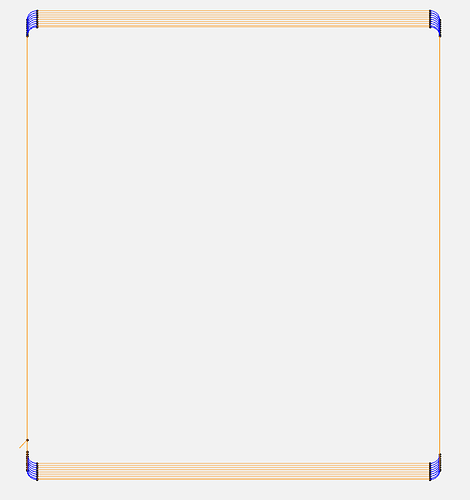

You can try disabling arc commands in EstlCam and it will produce many short segments at the corners instead. Maybe that fixes it.
I just loaded the GCode and was wondering the same about the arcs…
Seems like I’ve read a few times where Arcs have caused problems

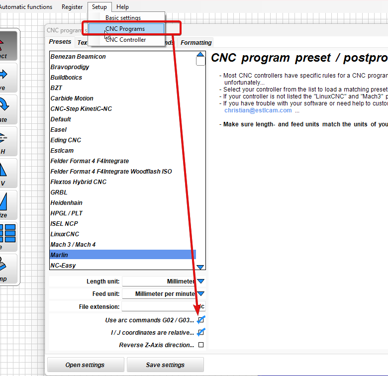

EDIT: NEVERMIND I FOUND IT - I WAS SUPPOSED TO UNCHECK “USE ARC COMANDS G02/G03” BOX ON THE CNC PROGRAM SETTINGS IN ESTLCAM

Thanks Mike. I’ve unchecked it and am running a test cut now…
I was just coming to post the same type of graphic. You beat me to it.
@pajarojo
Zac, notice in the graphic that Mike has “Marlin” selected for his CNC program preset. What selection do you have there?
