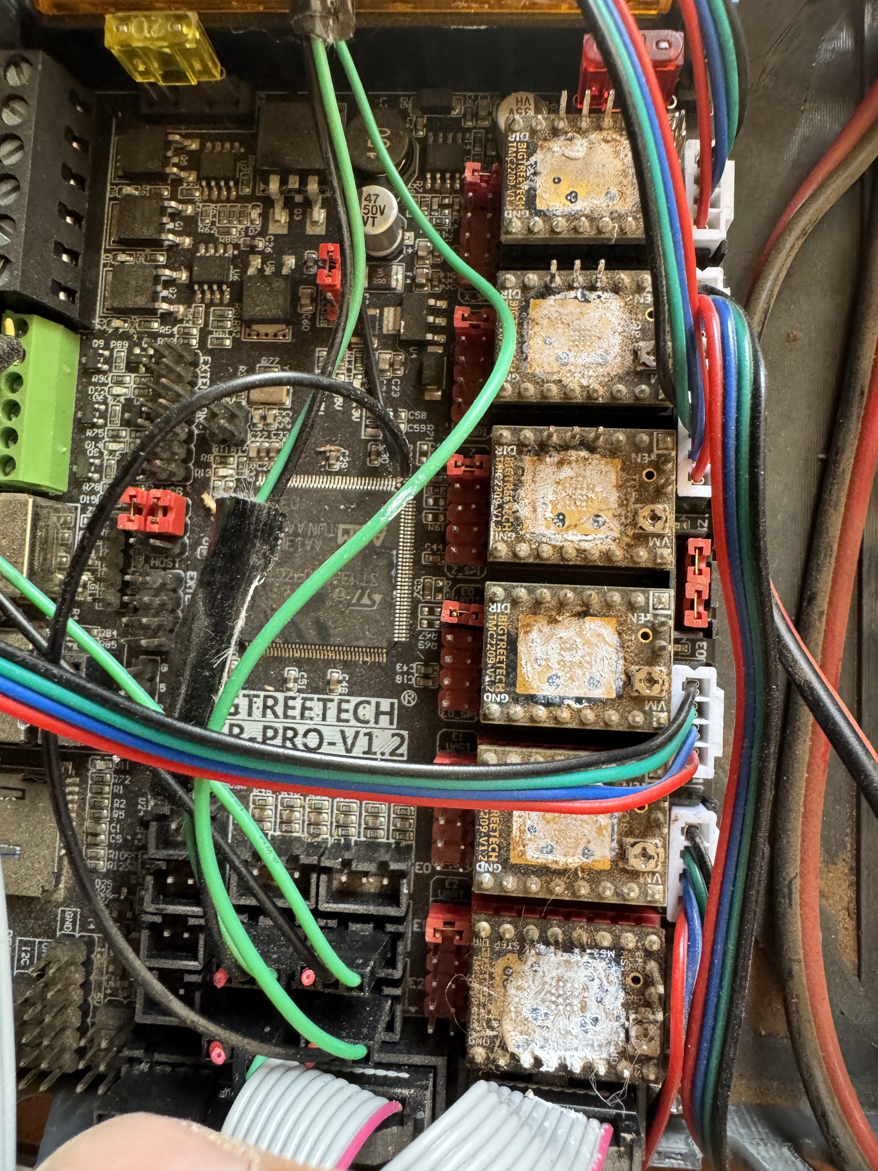

Anyway i purchased this used, the guy i bought it from said it was plug and play, WELL not so much. so know I am trying to figure it out .When i powered up i found that it is the following:
SYSTEM: Marlin 515D 2.1.1
Machine: V1CNC 515D
Board: BIG TREETECH_GD_TFT35_E3_V3.0
FIRMWARE: V27.x
When i connect my PC to the USB with G Sender it will not connect, I read somewhere that you can not hook up a pc, That you have to use the sd card. I just need some info on how to get started, is there a good place to start?
Can you post some pics of your machine?
From what you have posted you are running marlin firmware. Pics of the board will help us know for sure which one. My guess is SKR Pro but it could be something else as well. Once you are able to provide those pics we will be able to point you in the right direction much easier.
You may have to post pics one at a time until you get a few post in and move up on the “trust level” for the forum. It doesn’t take long for that.
So here is a pic, the heat syncs have come off the 2209’s. But i located some on ebay, i do plan on changing those out. You are correct it is the SKR PRO

My suggestion is to look over the docs here and double check everything is wired correctly.
After that download the test crown gcode and run that with a pen taped/zip tied to the tool mount. After you download the file and unzip it. You can move that .gcode file to the SD card and run it from there. it is already set up and ready to go. If you run into any issues just let us know and we will help out. Once you get the crown drawn we can move on to the next steps.
Jonathan, Thank you. it appears to be wired correctly, I do have movement using the touch screen. X, Y, and Z seem to be moving well. is there a particular software that i need to use? Like i was saying earlier g sender connects to my port but the software does not connect. I use lightburn with my laser engraver but i dont think it will work for a cnc.
I have never used a software to control the CNC when I was using the SKR board. I just load my gcode onto the SD card and do everything from the touch screen. I know many people do but I never saw a need for it. You need to be by the machine any time you are running it anyways for safety so I just used the screen.

The V1 documented g-code sender is Repetier-Host with setup documentation here.
The absolutely safest way to “send” g-code is to use an SD card with your display in Marlin mode. In your setup, you need to use the SD slot on the SKR Pro, not the slot on the display. Sending issues using other methods are rare these days.
gSender indicates it supports grbl and grblHAL, but no mention of Marlin, so I don’t think it will work for you.
