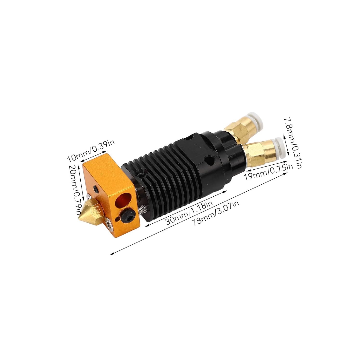

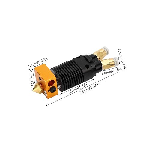

This is a revisit to an upgrade, got 2 in 2 Out Extruder 12V 40W Dual Color Cooling Chimera Hotend working somewhat. Both hotends heated on PLA preheat, only extruder 0 works off of Smart controller.
A Milled printer (V1 design) with RAMPS 1.4 for Arduino REPRAP Mendel PRUSA 2560 Board that I built in 2020 that I managed to get working with Marlin version at that time. , I need a complete download as if starting from ground 0, as config.H asking for files I don’t have. I’m in process of upgrading my printer to dual extruders single Hotend.
I got Marlin to recognize dual extruders, need to change coding on Reprap Smart Controller 12864 LCD Display to move extruders individually.
Did original programing with Arduino, kind of lost using Visual studio. Any help would be appreciated.
Please start a new topic. You should include more pictures of what you have since you are asking to use such old hardware there are lots of revisions.
