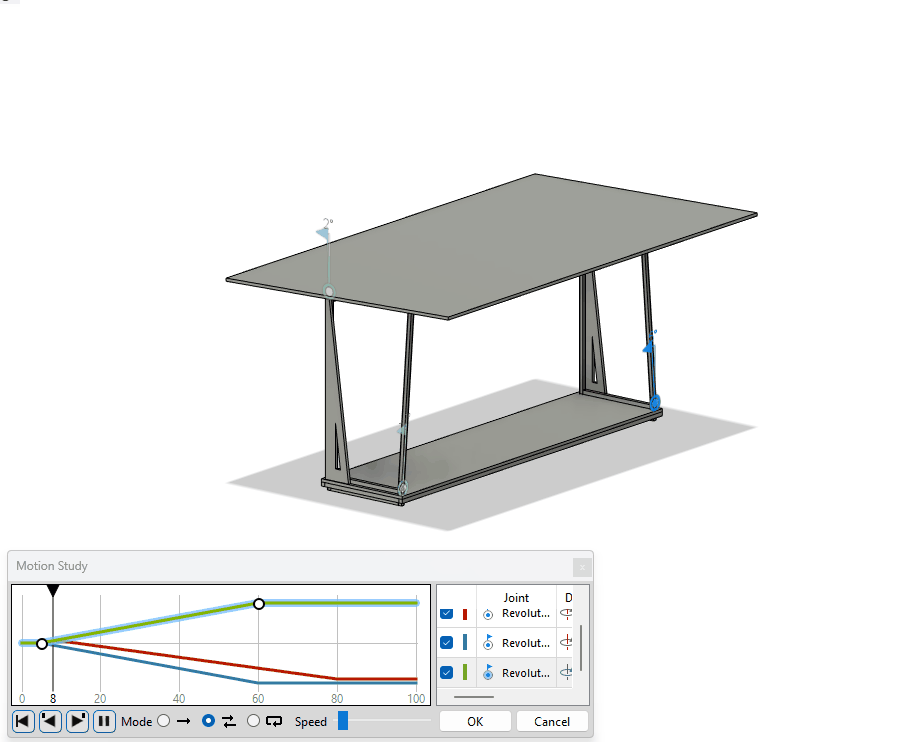

I had this one in mind. I actually toyed with the idea of building one of those.
I just saw he updated it:
I burst out laughing on that.
Reminded me of a certain fellow who once lived in a van down by a river.
I have a kind of odd setup that is meant to mount to any table. It’s very much in its feeble design stages.
I think the parametric table would be a good idea. Roof slung with fold out legs. If you need any bad ideas feel free to ask I am full of them lol
