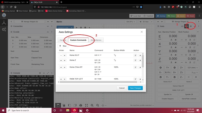

Ok, I got everything working… sorta. I was able to carve.
I forget the command Issued when I try to set the workpiece zeros. I had to use g92 in the terminal.

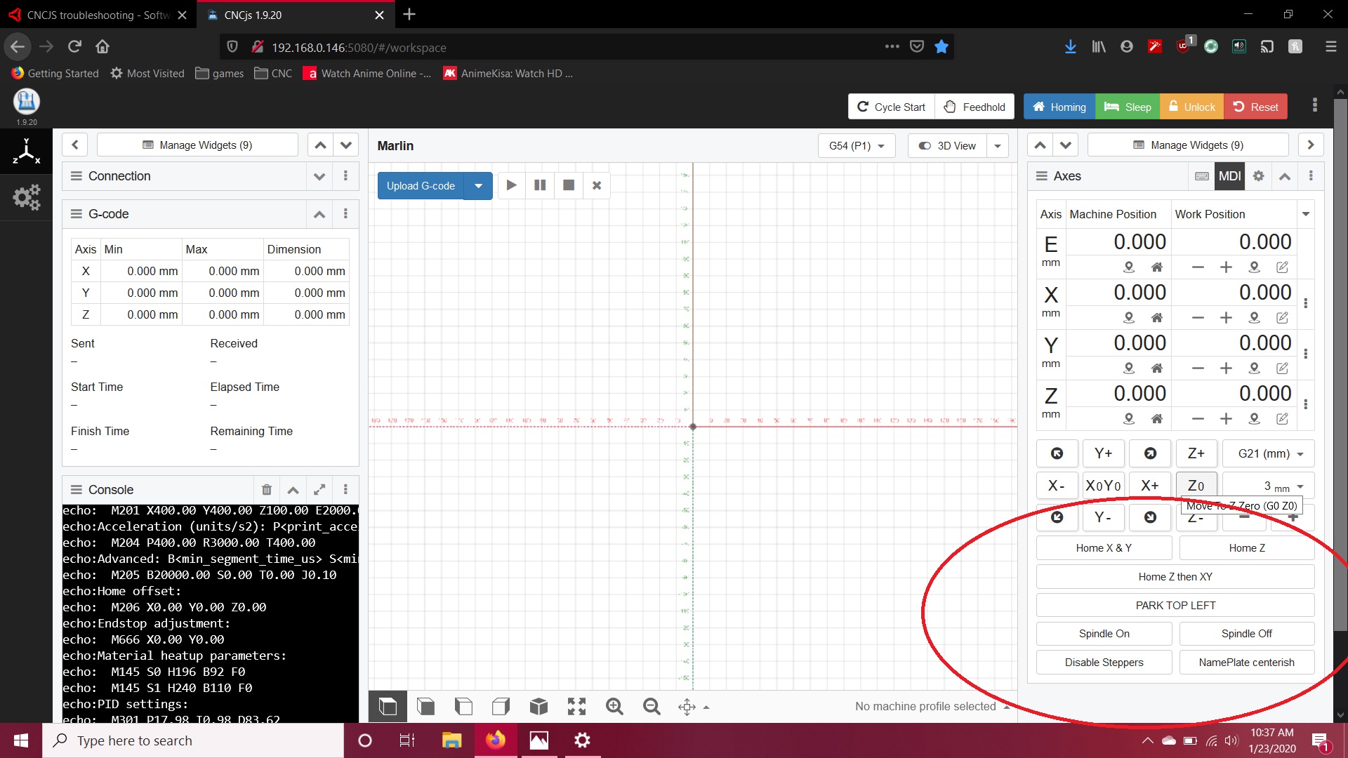

I believe in the top right corner under “work position”. Clicking the icons that look like a location pin on google maps will reset the work position’s 0 point.
I accidentally clicked the button under Machine Position and it tried to Home the machine… which I don’t have endstops :confused: I was just able to kill the power before the steppers started grinding against the side rail.
Thanks. I know the button, and what I am saying is that it’s not working correctly. I know a screen shot would have helped.
Ah. Sorry. It works on my laser, but it’s running GRBL. I haven’t played/tested it on the MPCNC with Marlin. I just got CNCjs on my MPCNC yesterday, but haven’t done anything with it yet.
Set you up some custom commands for stuff you will use ALOT. Dont be afraid to experiment.
I will look into that. I am trying to understand why it’s not working as I expected. I am good at missing details, I would rather catch a mistake early on than hack a fix. If in fact that’s what is going on.
CNC.js was developed for grbl. The buttons haven’t changed, but the backend commands have. Some of them may not work perfectly, and the macros are a good stop gap.
thanks. sounds like I didn’t mess something up. onto macros!
