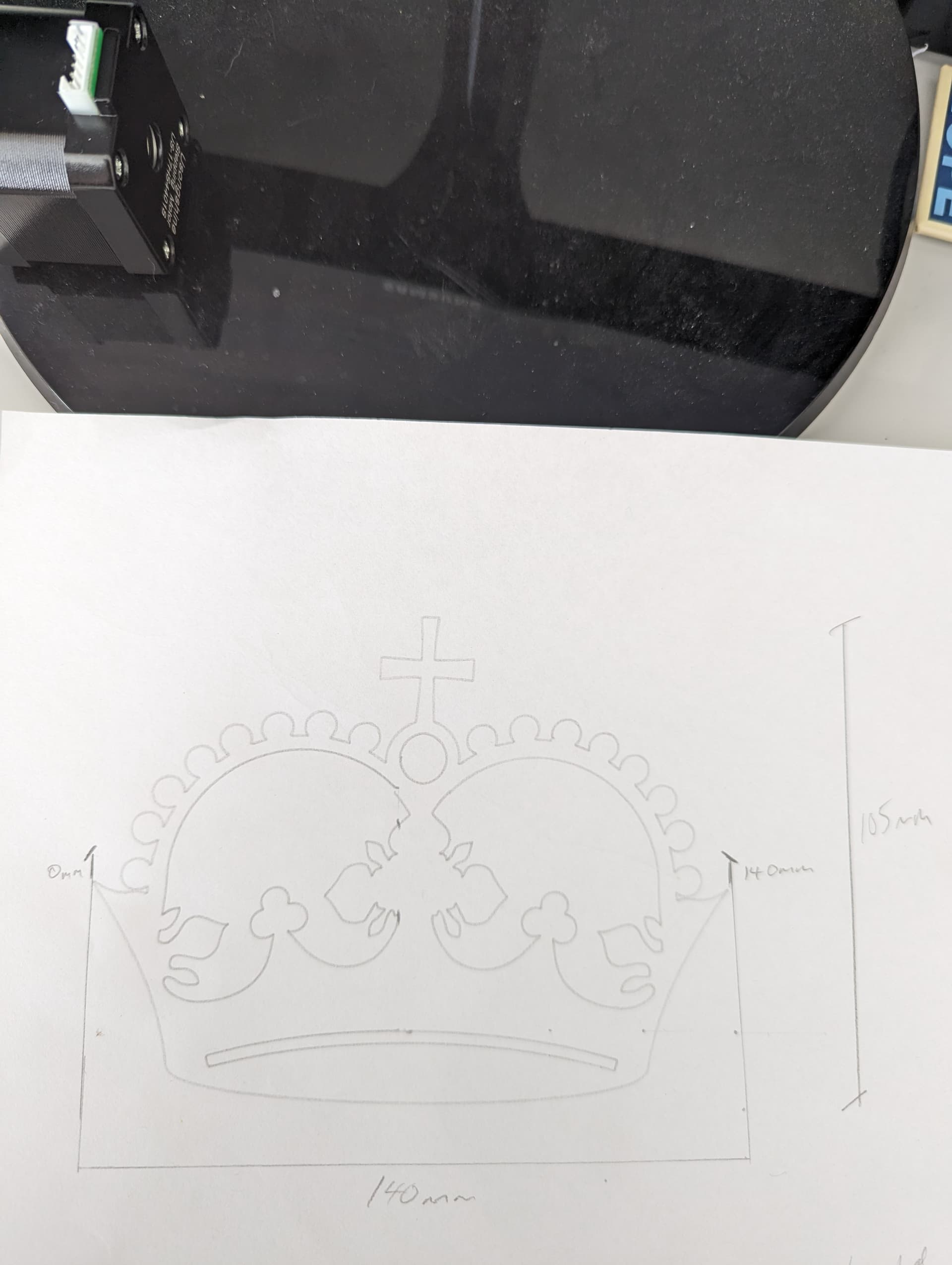

Long story short I did the crown test and it was set for 150w x 112.5h but it is coming out at 140w x 105h as shown in picture.
I bought my belts and pulleys off Ryan, and my motors are USONGSHINE 17HS4401S 1.8d, with CNCjs used to send the file
Just to be sure, are you running the premade crown or did you author your own version based on the SVG? The typical reason we see for this kind of inaccuracy is that the “wrong” pulleys are used. Typically, 20 tooth pulleys are used instead of the 16 tooth pulleys specified by Ryan. But your distances don’t work out for a 20T pulley.

Its late now but I will try out the GCODE you suggested and measure it tomorrow. I worked out that the movement for W was 93.3333% but the movement of H was only 93.1429% of what they should have been, and I thought it was interesting as they both have the same setup figures.

So, the pulleys are not your issue. You are left with:
  • Mechanical issue with the machine (loose grub screws on the pulleys are common).
  • Firmware issue (steps per mm not set correctly). What version of the firmware are you using?
  • Authoring issue with the crown.
Step 1 will be to test the distances moved. Your machine should be accurate to fractions of a mm.

Sorry I wasn’t able to get any time yesterday to test out the CNC, I have today and I tried the G0 X250 F1000 code and it produced 250mm accurately.
Looking at the comments I realise I wasn’t precise enough and yes I am using Ryan’s Pulleys, belts and wires. I have supplied my own boards, motors and drivers and they are as follows:
Arduino Uno
CNC shield V3 with GRBL
Drivers are DRV8825 with stepping set to 1/32
I retried the crown after successfully getting 250mm off the above Gcode line as I thought maybe there was an issue that I had resolved like zeroing prior to running, however the result was the same.

So, the machine is fine, and you have an authoring discrepancy. A number of CAM settings can impact the size. For example, if you were doing a contour cut, the width of the bit is used in calculating the g-code. Depending on whether you are cutting on the inside or outside of the path, the g-code will be bigger or smaller than the path by half the width of the bit you specified for the cut.
I’m not an Estlcam user, but if you post a picture or two from Estlcam of your crown, someone on the forum should be able to spot what is going on.

Robert you are right I had an authoring discrepancy, I had been using the testcrown 12mm/s GCODE from EstlCAM Setup - V1 Engineering Documentation which must be configured in some specific way to marlin/standard machines which had that sizing issue when I ran it on mine (Grbl), but when I ran it just now using the Crown Vector file imported into ESTLCAM and sized for 150mm it produced it correctly.
Which tracks with the fact it was able to reproduce that G0 X250 F1000 instruction to 250mm correctly, for now I will chalk this up to a win and look at buying a router and printing a bracket to suit.
