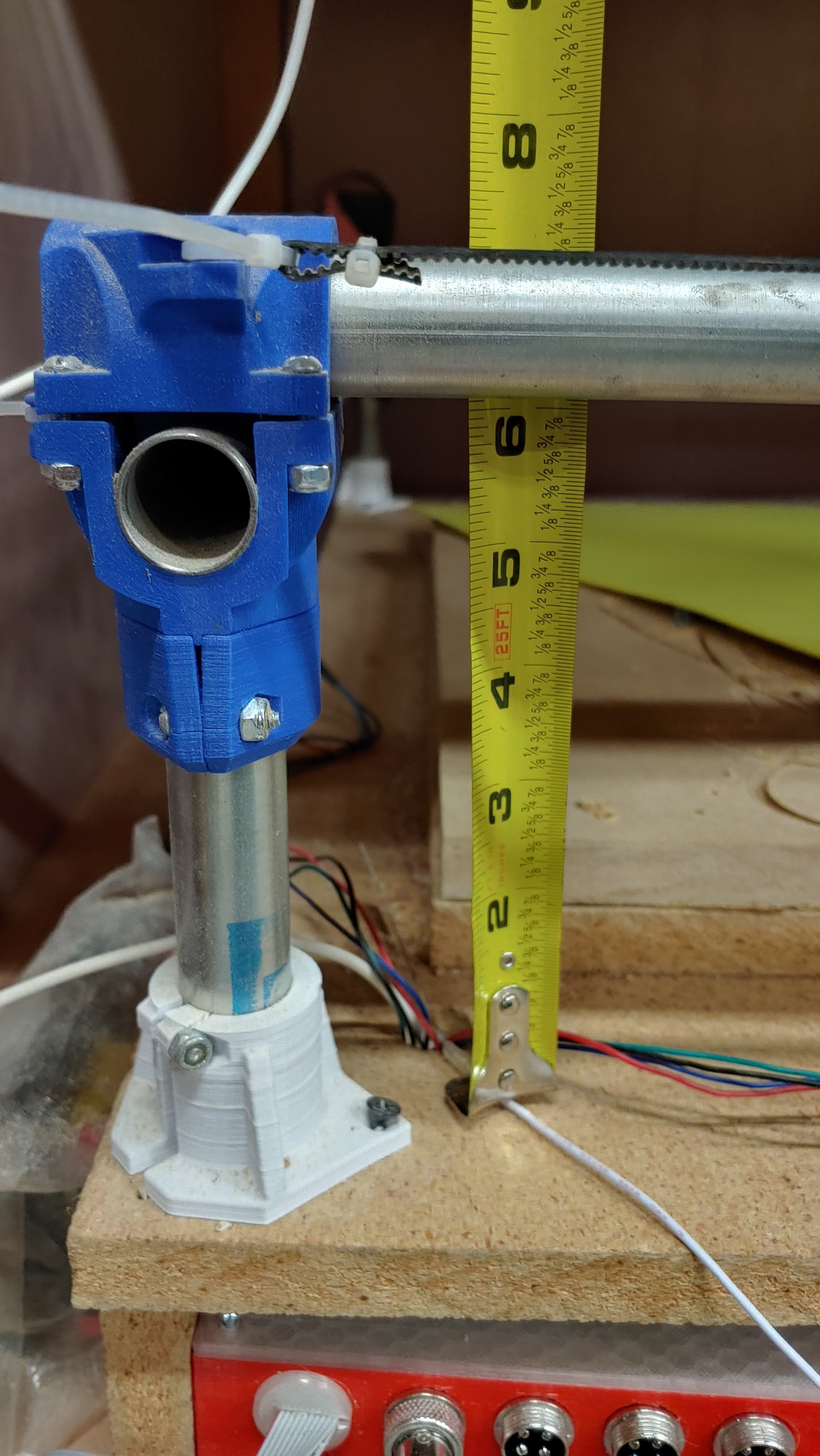

Here’s my current height… are you saying I’m too tall? I’m currently using 1.5" of MDF to raise my spoilboard up to the router, but will having the legs themselves this long cause issues still? It might explain why I always feel like my machine isn’t as rigid as some other pieces. I only made it this big because sometimes I pull the extra MDF off when routing the top of tall pieces.
Just observing this: your foot looks custom. It is screwed down and rigid?
That’s the old foot.
It’s not necessarily the legs that is the problem, it’s the z length hanging down. The legs give you a little flop, but the z tubes will flop more. Raising your cutting surface up closer helps with that.
Ok. I always thought I was good there. Something was just worded recently that made me think otherwise.
The foot is the original one. It is screwed down.
