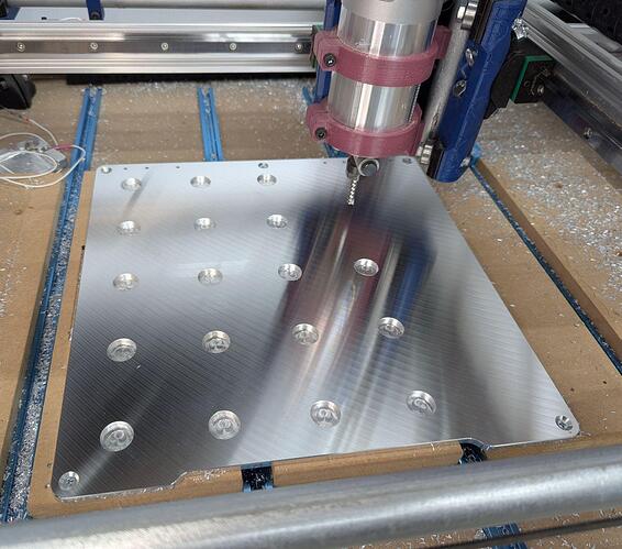

Another update to this zombie thread: I determined that there are outlets in the garage on different circuits, so I ran an extension cord that is used solely for the router, and everything else is as it was before ona different circuit (downside: my e-stop now doesn’t stop the router, only the motors and MCU). I also added some ferrite beads to the USB cable at the recommendation of someone else, but I’m not sure how much that matters.
Everything works flawlessly now. I ran multiple hours of aluminum milling in the past few weeks from gSender and not a single connection issue. Most of it was milling out cavities for high-temperature magnets in this 6mm 3d printer bed:
