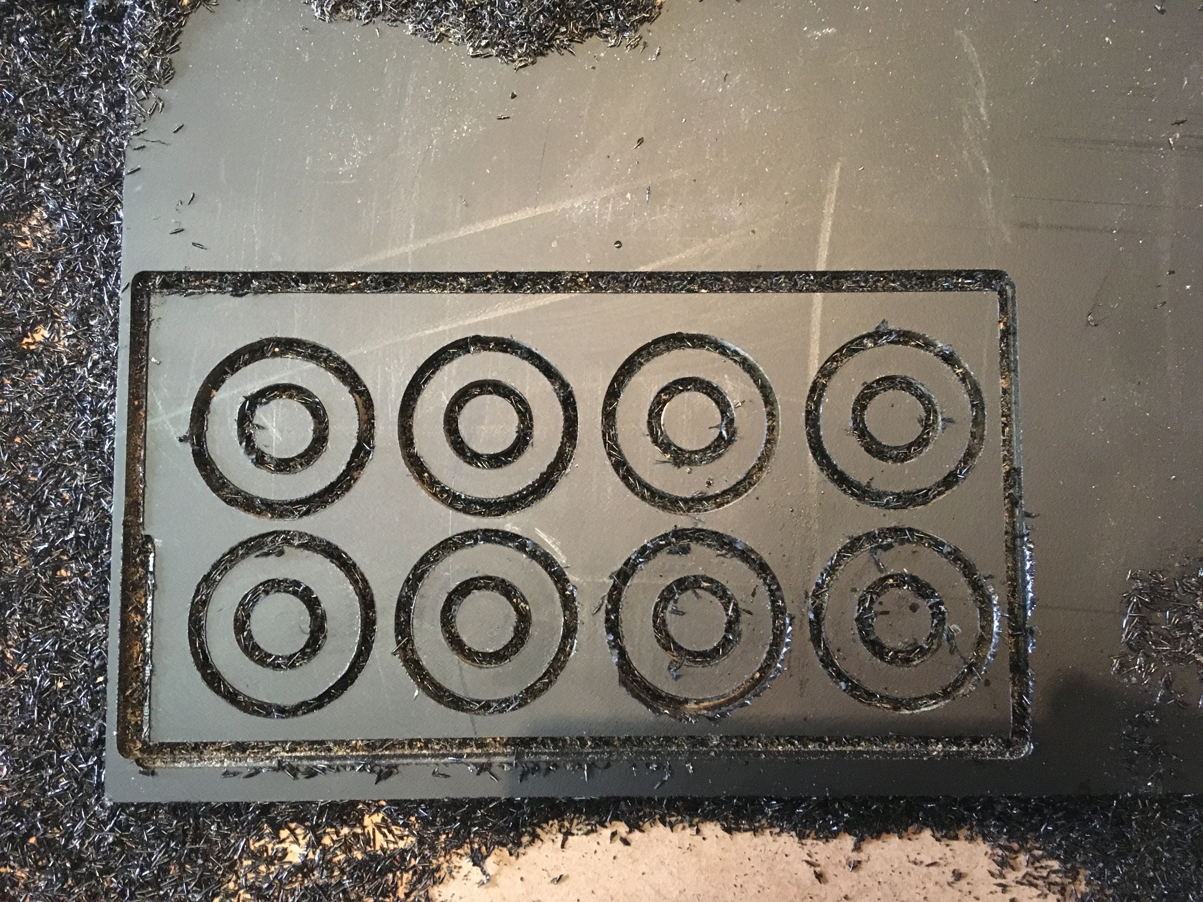

Hi,
While trying to cut some washers the centre hole seems to be shifted to the right and maybe a bit up. Hope the picture explains what I mean.
I drilled some marker holes in my bed at 60cm from zero and measured with a measuring tape. The Y axis seemed ok, but the X was 1mm less than 60cm. Would this cause this misalignment of holes?
Is there anything else that would cause this? Or is there a way of calibrating the machine?
Its strange that the centre holes are offset for all the washers considering they were cut one after the other.
Hope someone can help.
Cheers.

I can not think of a way it could do that other than CAM. If you cut the outside of one then the inside, then moved to the next it doesn’t make sense to be a machine issue. The outsides seem to be aligned correctly.
How fast and deep were you cutting with what diameter, and how long is your Z axis?
That’s what I was thinking was strange.
1/8 single flute, 12mm/s, 1.5mm depth of cut, with 12k spindle
Thanks.
Could you drop your gcode here and I will see if the circles are concentric.
Ryan, I have attached gcode.
Thanks.
washer_Array.gcode (518 KB)
I see what happened there is no way to diagnose this. You missed a single step somewhere.
Next time do each full part at once. Inside, outside, then next one, the last thing is cut out the whole thing. You cut out all the outsides somewhere in the middle you cut out the entire piece, them some more outsides, then the insides. This results in all the pieces not working.
If you do the sequentially, you will see where it went wrong, and always do the outer biggest cut last in case it breaks free or the comes loose.

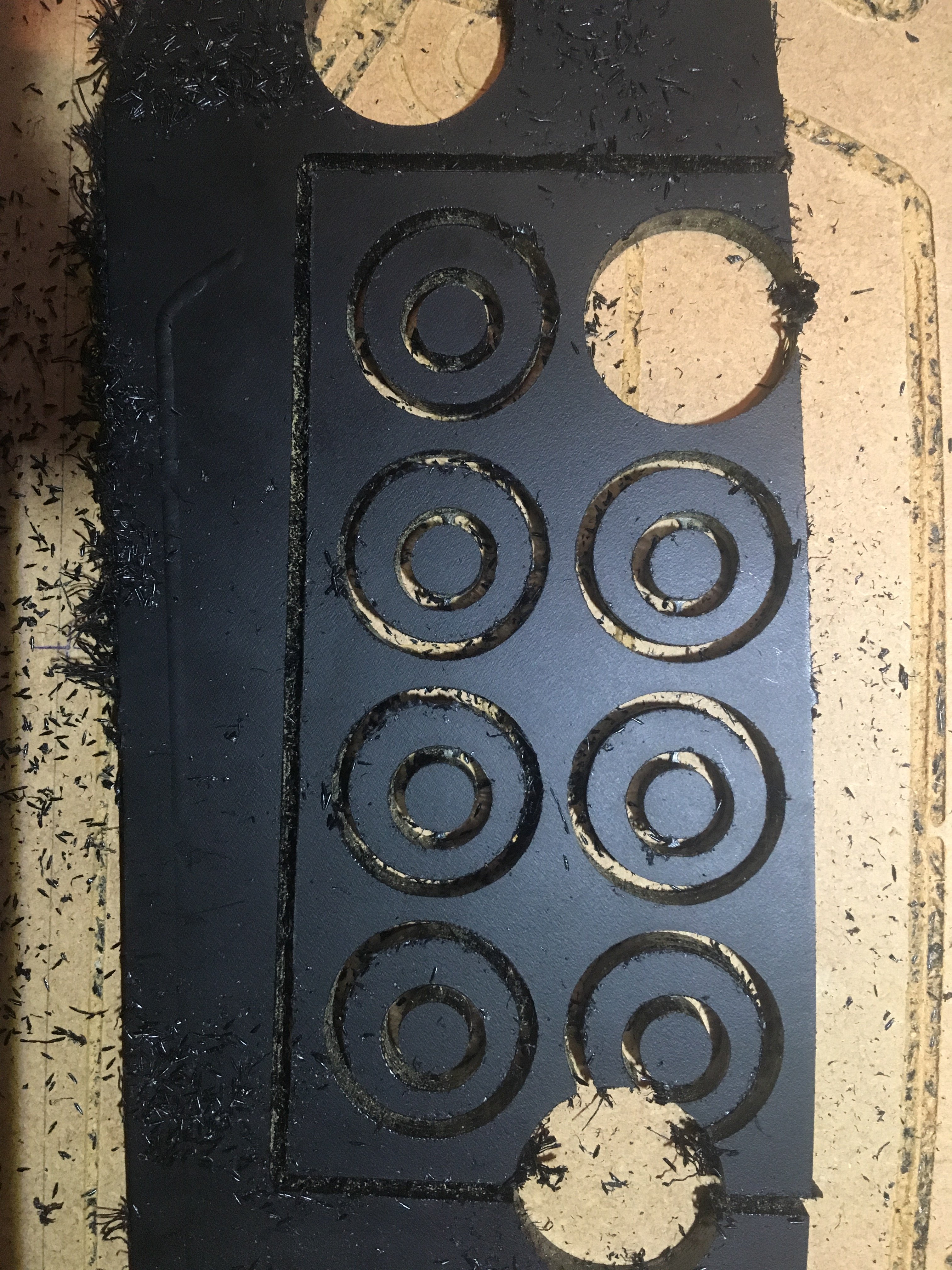

Ryan, ok that went better. Cutting the whole part at a time seems to have made a difference. Although on the first pass of the large outside cut it paused for a split second which made it cut the box wrong. You should be able to see from the picture.
So so does that mean I’m still going too fast, or too deep?
thanks

Is that aluminum? Do a test in something softer to make sure the Gcode is good. Check your pulleys, almost looks like one might be loose. (that would explain a momentary pause)
It should never pause, you can look at the gcode to see if there is any weird happening right at that point.
In aluminum fine tuning comes down to you ear for the most part. Too fast or too slow and the bit breaks, anything in between should sound good, as it cuts you should be able to hear parts where it obviously is under more load (90 degree corners). Skipped steps are usually a sign of other issues. The CNC is strong enough now to never skips steps it should always break a bit before it skips now. I originally designed it with weaker steppers and it would skips steps if your gcode was too far off. Now it is just a monster.
No, its HDPE 10mm thick.
When I say pause it was as if it struggled to cut and skipped steps.

Everything looks good, the gcode you sent was not from the previous pic?
There is a ton of moves in that file, try turning on arcs that is going to cut that code down significantly. Another option is slow down to 8mm/s and if that works make deeper cuts instead of faster.
You don’t have a 660 on there, so I can’t give specific suggestions, and I have no idea how long your z axis is. no matter what arcs should be on for circles larger than 6mm or so and go slower since you don’t have the power of the 660. If it is really tall you might need to go even slower.
I turned on arcs and reduced speed to 8mm/s. All went well until the last circle that totally went wrong. Its as if the bit hits denser material that’s harder to get through, which then throws off the rest of the cut.
I will try cutting shallower.
