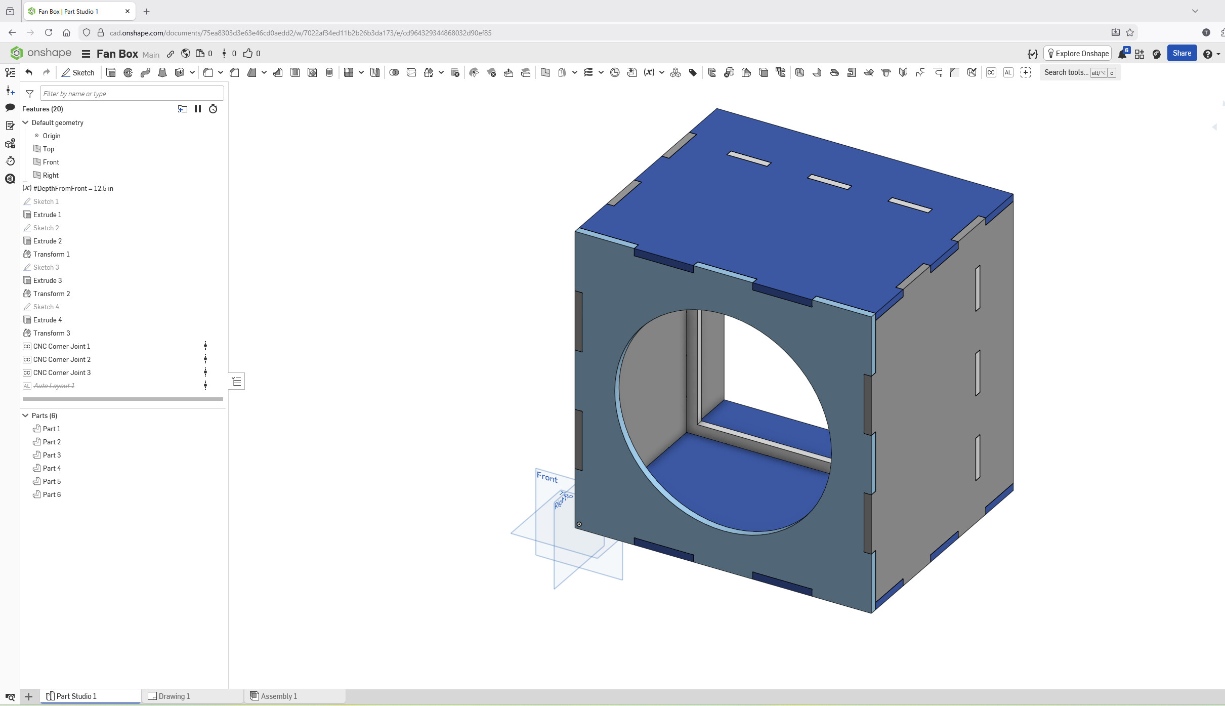

My shop is dusty. It probably has something to do with using a Shop-Vac as dust collection but I’m addressing that by buying a dust collector. Even so, I don’t expect it to collect everything so I’m waging a war on dust on two fronts. I made a cheap (under $100 for the housing, fan, and filters) air filter box and thought I’d share. It’s not particularly powerful but does a decent enough job and is quiet enough.
I made this more as an exercise to learn OnShape rather than to build a high performance filter - I’m a SketchUp refugee and I’m mad I didn’t discover OnShape before. I’m really liking it so much better. It feels like what SketchUp could have become if they worked on features instead of monetization.

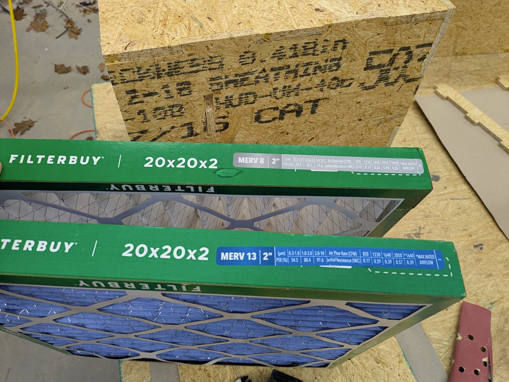

The fan I picked is rated at 1040 CFM, but that’s Amazon CFM so real-world is probably like 700-800? (Is there a free/cheap way to measure that?) It’s still within range of the low end systems on Rockler for $300-$400. The two filters used are standard 20x20x2 (actual 19.5x19.5x1.75) - I picked an 8 MERV outer filter and a 13 MERV inner filter.

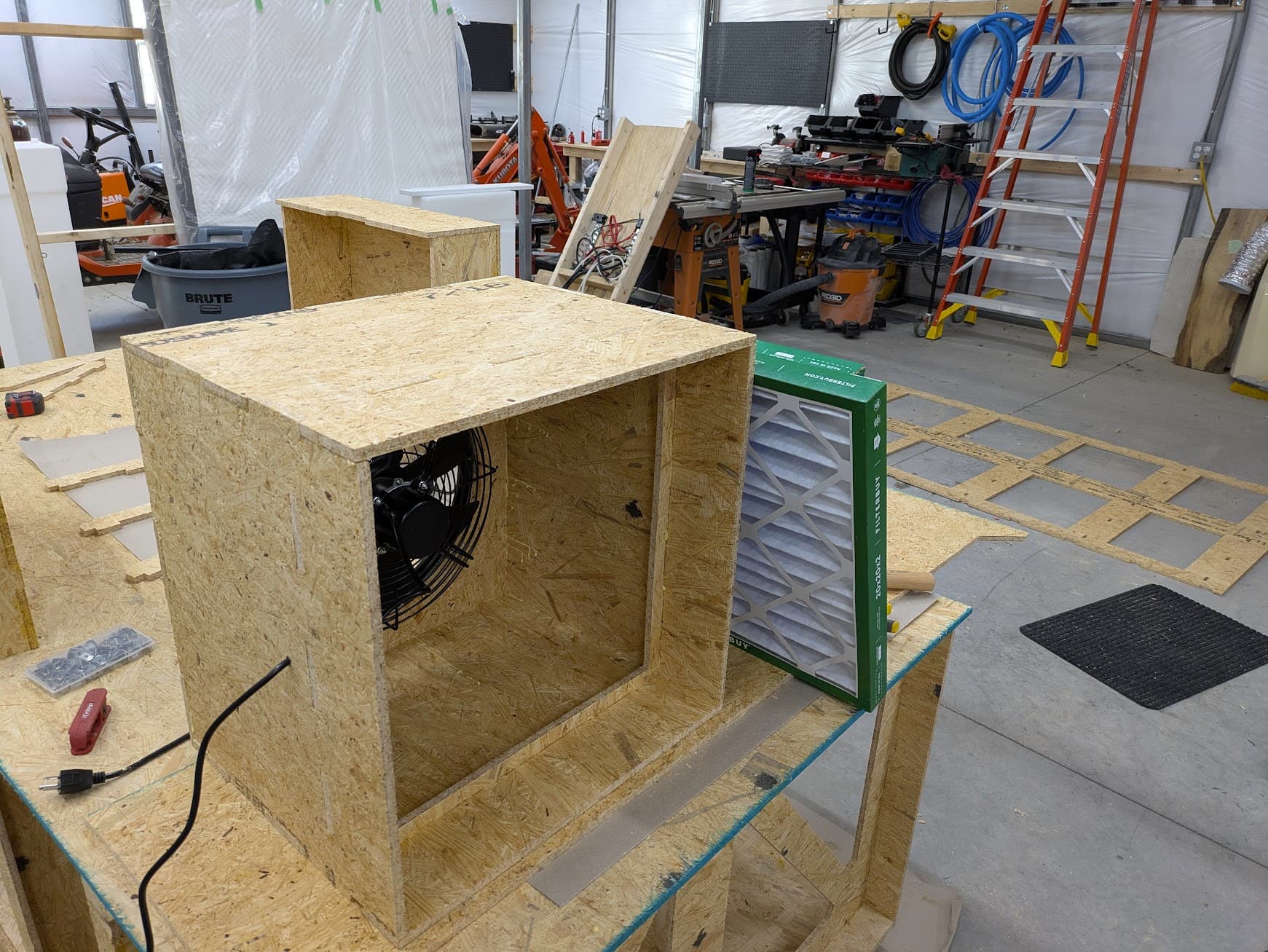

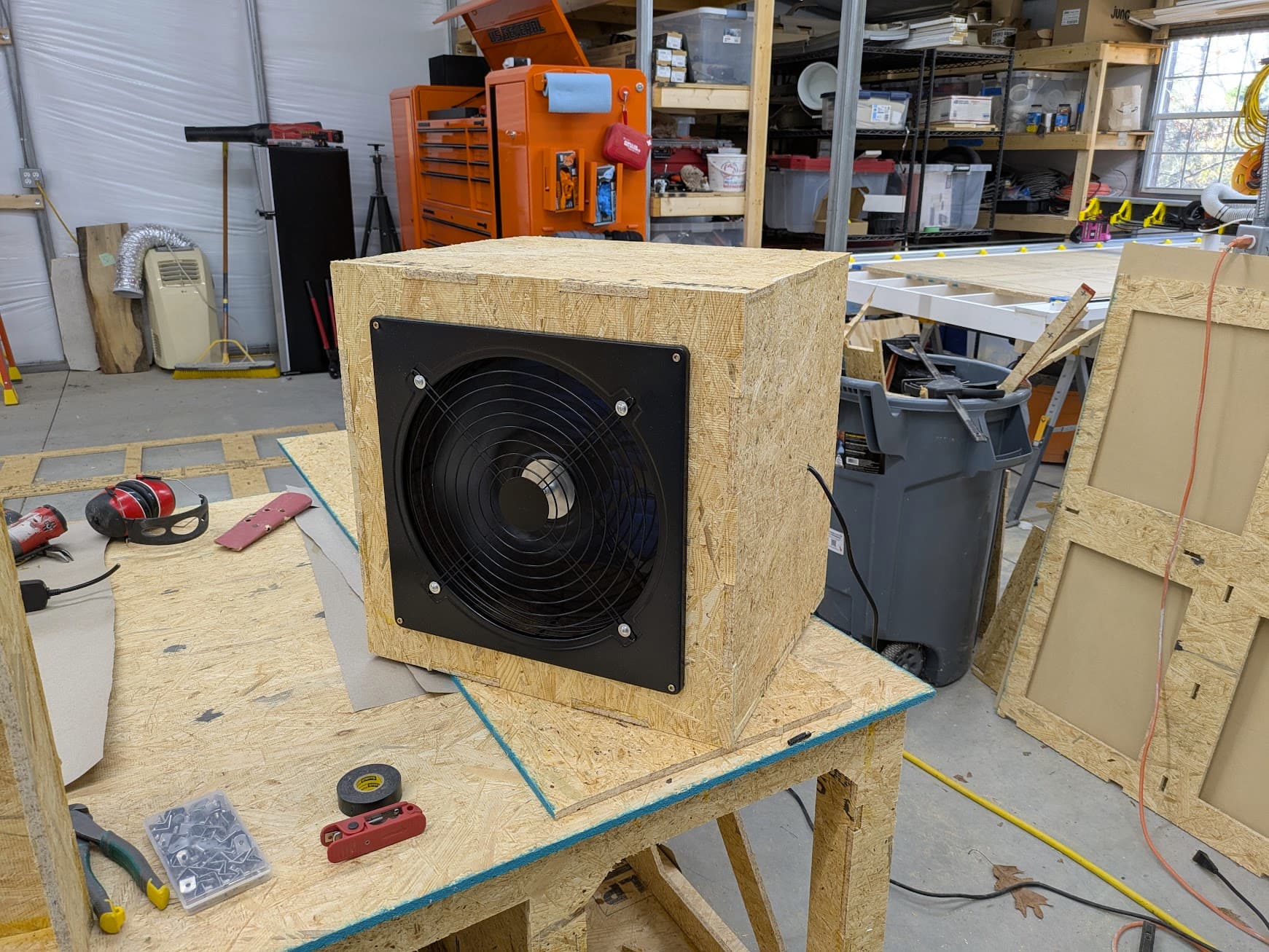

I cut the 6 pieces on the CNC table - note that 1/8” bit corner overcuts are already baked into the drawing via the magic of CNC Corner Joint extension in OnShape. It uses less than one 4x8 sheet of OSB. I used the scraps leftover from cutting out the table it’s sitting on in the pictures. Once cut, I’m pretty sure it will only go together one way and the L/R and T/B pieces are mirrors. Glue it up and throw in a few brad nails until it drys. Caulk around the inner seams if you have some on hand but this is probably optional with enough wood glue (I didn’t bother). Cut the silly in-line controller off the fan cord and drill a hole in the box to pass the cord thru on whichever side you want to to exit. The fan just screws into the front using wood screws and it’s flanged as well, so a bead of caulk there if you have the tube out. Wire to the 120v source of your liking. The filters just press-fit into the back. I left a half inch of overhang with the idea I could print or cut a holder if they were loose but that turned out to be unnecessary. It’s a nice snug fit. If you wanted to go for more filter space there’s a variable in the CAD that will move the filter stop in and out. You could reasonably put in at least (2) 4” filters before you start bonking the fan motor.
I’m going to screw in 4 eye bolts and suspend it above my primary woodworking area and wire it to the lights so it’s always on if anyone is in the shop.
I used 2 extensions here - CNC Corner Joint and Auto Layout. The mortise and tenons are all automatically generated, and Auto Layout gives you an idea of how to lay out your DXF optimally.
Here’s the CAD
Fan I used

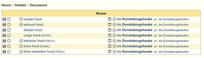

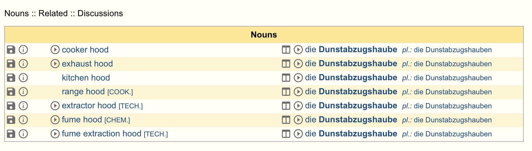

I am using my old stove hood thingy (don’t know the English name).
In English it’s “Stove hood thingy”.
Great, now I had to do the work of looking it up myself after being mocked. :stuck_out_tongue:
