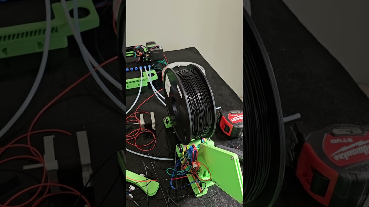

I guess I’m your ERCF Huckleberry lol. Ordered the Siboor kit about a week ago.
this is the kit I got. From Aliexpress though
I will start a build thread once I get started. Have to finish the panels for the V5 and do some ABS testing first. Never printed ABS before so we will see how it goes lol

I’m still chugging along with my ERCF build. Have hit a few self induced snags but slowly making way. I need to update the build thread LOL

I truly hate that my thread is pushing you away from trying to build one. You are the second person today to tell me that. I do everything the wrong way at least once or twice before I get it right and do whatever I should have done from the very beginning. That’s always been the case for me. One of these days I hope to learn from it but it doesn’t seem to be any time soon lol.
I really hope one of these other guys building one will make a build thread that’s not full of mistakes and aggravation. Mine is not the thread you should base building one off of.
I am sorry if my post read that way - I actually intended it to be a complement to you. I looked at the ERCF parts, BOM and build instructions and was quite frankly scared. It is a amazing project and you are showing it can be done, so if anything it is encouraging.
However, when I saw you go at it, it did show how even someone I admire could have trouble deciphering the nuances and options of the project in its current form. I still wouldn’t know where to start and feel like there has to be a way to “start small” in a multi-material venture. I’m sure you will ultimately be successful and hopefully blaze enough of a trail that someone like me could do an ERCF build, but as much as I like tinkering, building and learning, all of the options and accessories are too much for me ATM (ERCF, ERCT, ERF, ERPS, etc and versions / mods of each).
I am envisioning a 2-material machine that may have a higher per material cost, but since it is limited to 2 would still present a lower cost starting point. Also, by using off-the shelf cold-end feeders the build complexity could be a lot simpler.
I very much appreciate the chronology of things you learned along the way. Too many build documentations edit all that stuff out to imply a level of unrealistic competence. So, you have not turned me away - my assessment of my skills have driven me to seek other options.
I do my best to be open an honest. My build threads are basically “mess it up enough that eventually you luck up and get it right” lol. And I hope that someone can learn from my hard headed mistakes and not make them their selves
