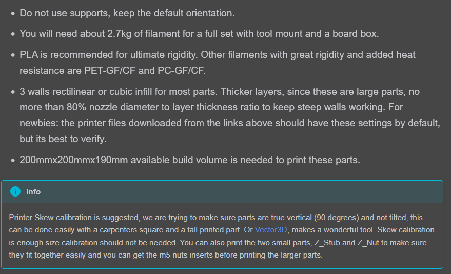

We do have a section here, highlighted. I am very open to wording this different if you have suggestions.
anyone making suggestions please link the section you think needs to be looked at, or where your suggestion would fit.

The more LR4’s I see being built using DIY printed parts, the more strongly I feel about Calilantern being strongly recommended to help save Makers time and material, and reduce risk of downstream assembly and operation related frustration.
Including a canary test of fit of the Z Stub and Z Nut, including verifying fit of captured nuts. e.g
Ryan already has that in there. Maybe just a flashing neon sign pointing to it :rofl:
Yep, exactly, the “Info” tip is too soft of a suggestion. My recommendation is a stronger “Warn” dragons be here if you don’t pay heed. A strong endorsement of Calilantern (and hopefully the owner provides a discount/affiliate to Ryan).
I think instead of it being at the end of the info section like that, it could be its own step, like:
Step 1: print these 3 parts at these settings, and see if they fit together. If not, proceed to printer calibration.
Step 2: ???
Step 3: profit
Step 1: Printer Calibration - CHECK SKEW!!!
Step 2: Print these parts to see if they fit
Step 3: ???
Step 4: Profit!
