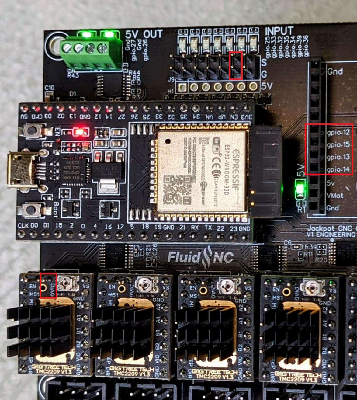

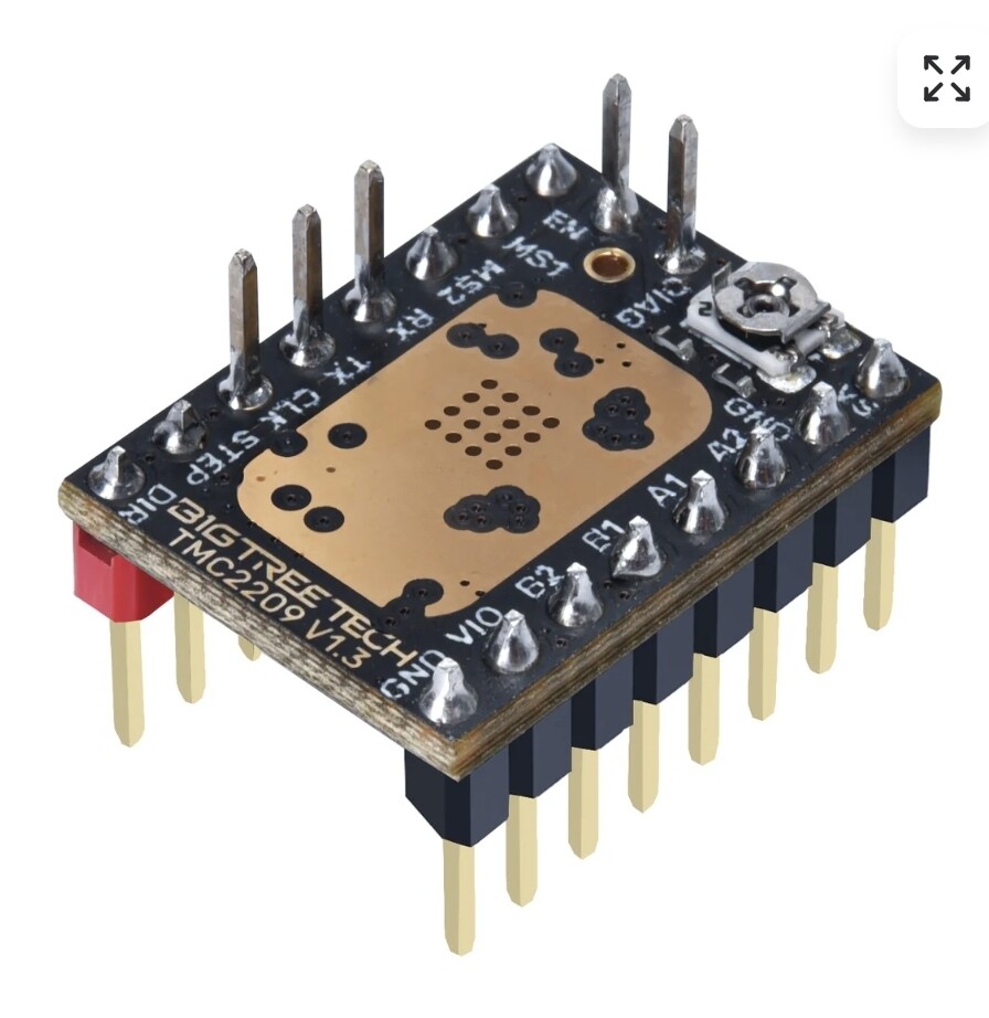

Connect the TMC diag output to a GPIO and assign it as fault_pin. Configure for stallguard mode and set the threshold pretty high.
The diag pin is the one in the middle next to the potentiometer.
I’d have to look to see what input to use on the Jackpot as a fault pin. You can only define a single fault_pin. Not sure if you can just connect all the fault pins together or if something more advanced is required. It looks like you could also use a separate estop_pin which has the same effect.
While the stallguard link I posted earlier was more related to sensorless homing, it still talks about the changes you would need to make to your config.yaml.

The configuration side of it makes sense to me, but I’m uncertain how to wire this (at least safely). I’d like to try connecting the diag pin from the X driver to gpio 39. It would be nice to use that one so you’d get an LED indicator when triggered. I’m not sure whether it would go to the signal or ground pin. I’m not currently using anything in the expansion socket so those gpios are available as well.
I’m guessing diodes would only be needed if connecting all of the diag pins to a single input? So, it would prevent the output from one diag pin from feeding into other diag pins?
I’m also guessing that the Jackpot docs say “No Stallguard” only because the diag pins aren’t connecting to anything (which I’m guessing is at least partly because there aren’t enough input pins).

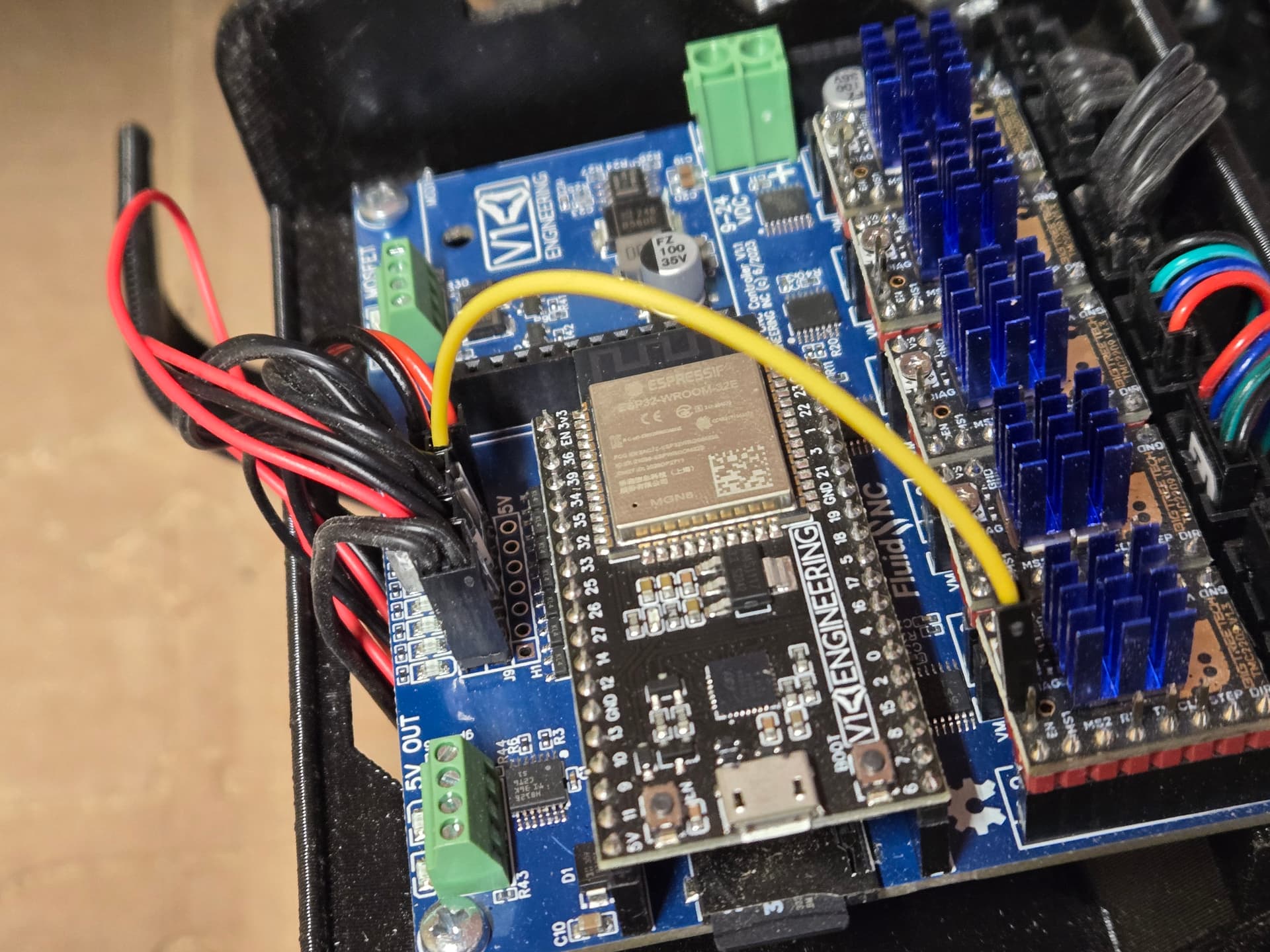

My current plan is to connect the diag pin from the X driver to the gnd of gpio 39. I verified that has an external pullup resistor. I also have an input board for the expansion slot which has some extra protection than connecting wires directly. Don’t trust me on the wiring part.

At present there isn’t anything to do on Jackpot for this change.
Testing at this point is just soldering a header on the TMC2209, and then wiring that to a GPIO as Jason is doing above.
I’d still do a wire OR tree for the drivers, but that’s me.
There are already pins so I was just going to do a short female to female dupont wire in between. I was going to test with just X before going further. I hope to try this over the weekend.
