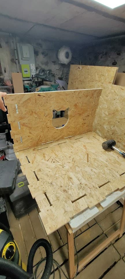

Back to business… first cuts (after 2 whole days of cleaning the shop….)

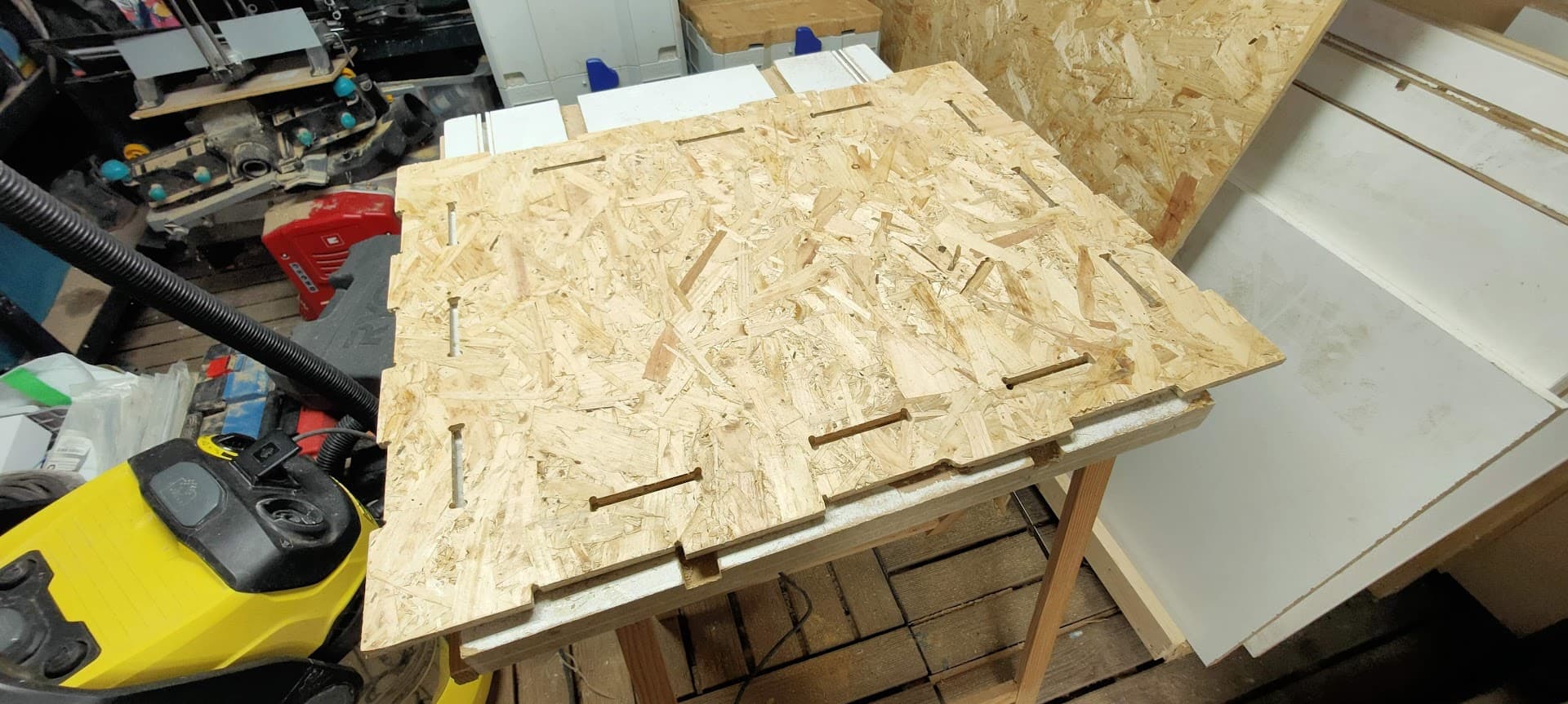

Had to replace a belt that snapped, reprint a mount that broke, used my last downcut bit… but it finally cuts….
First two panels are done, fitting is a bit too tight, I’ll have to open up the holes and shorten the fingers by hand one these

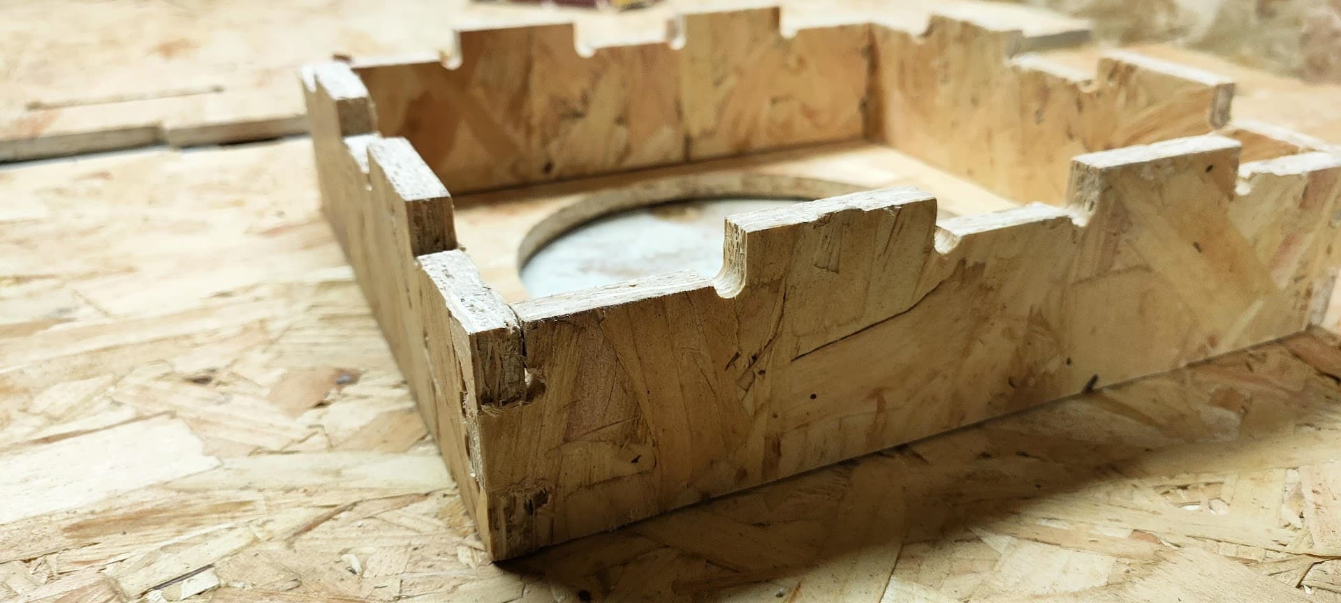

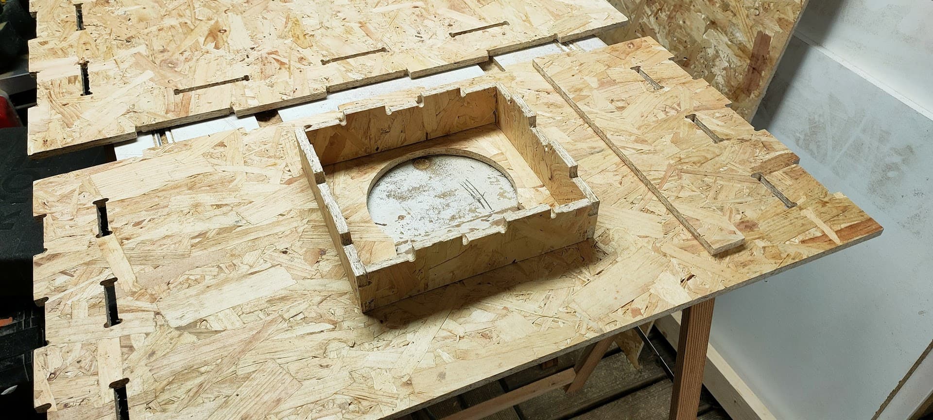

I cut some smaller pieces next, just to test the fitting using negative “stock to leave”
The fit is perfect, just snaps in place and stays there….

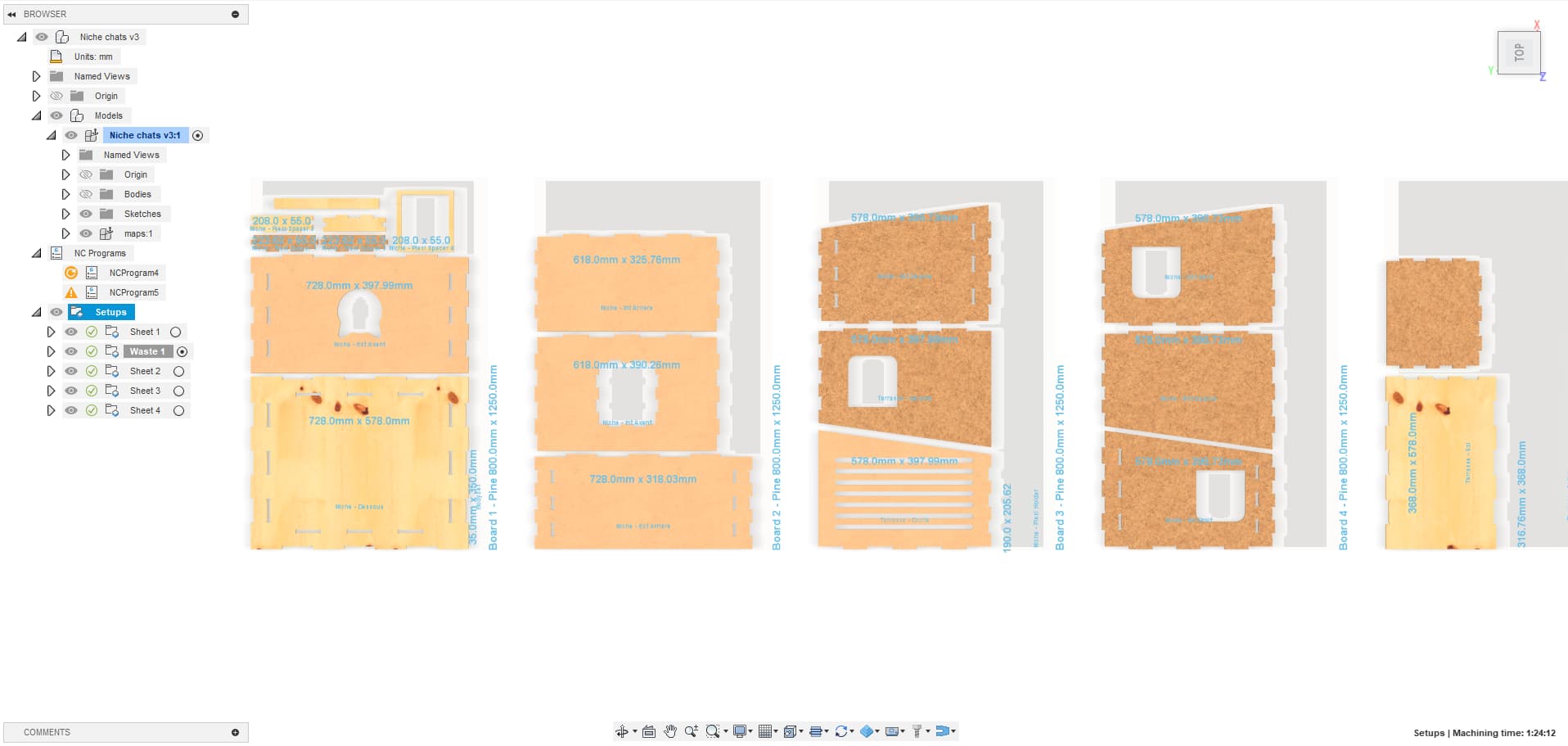

Also re-defined all my CAM paths as I messed up the orientation, and removed “Ramp” option as it added too much machining time
Now we’re looking at 01h24 machinig time, of wich 01h10 is remaining
