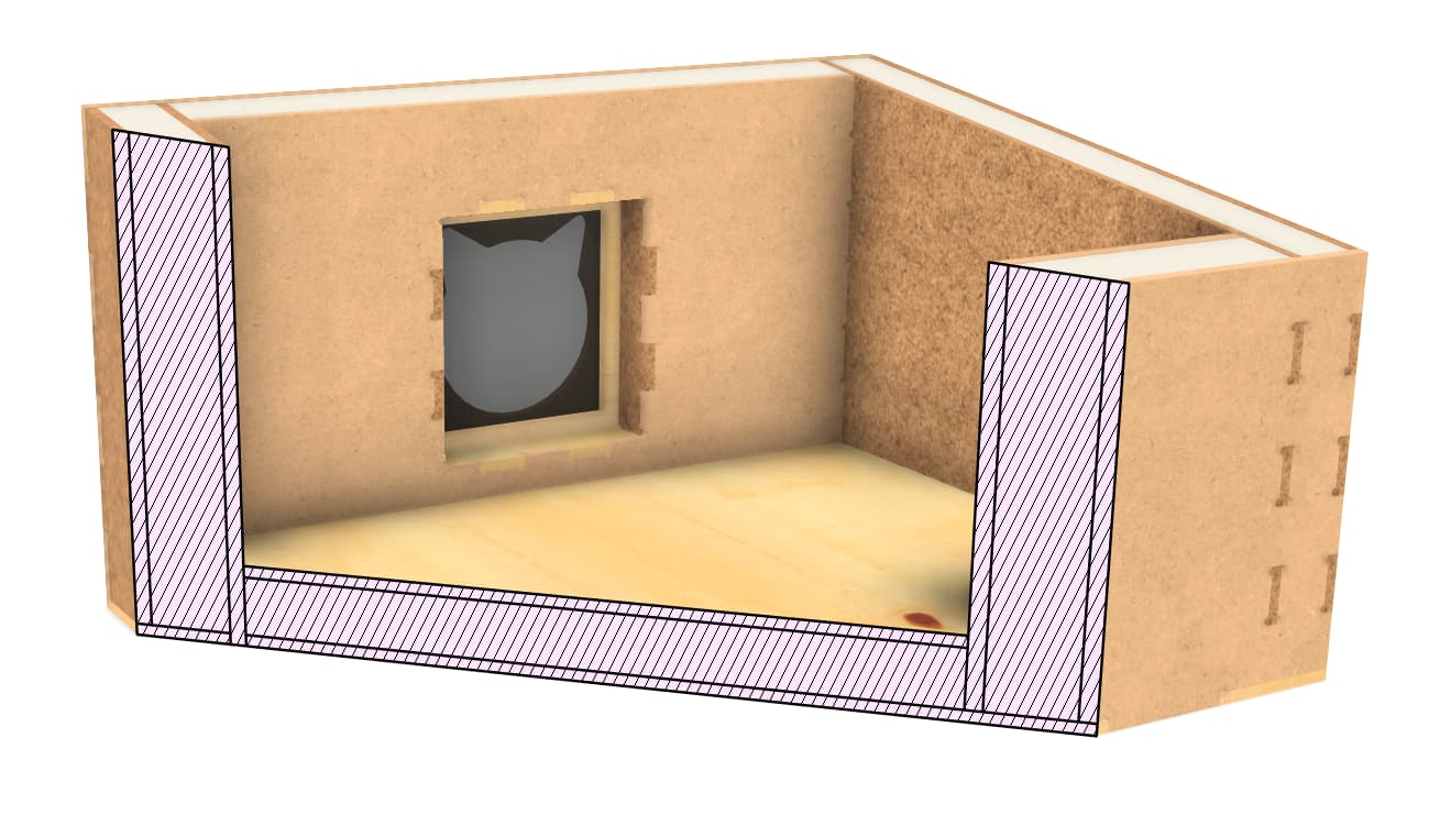

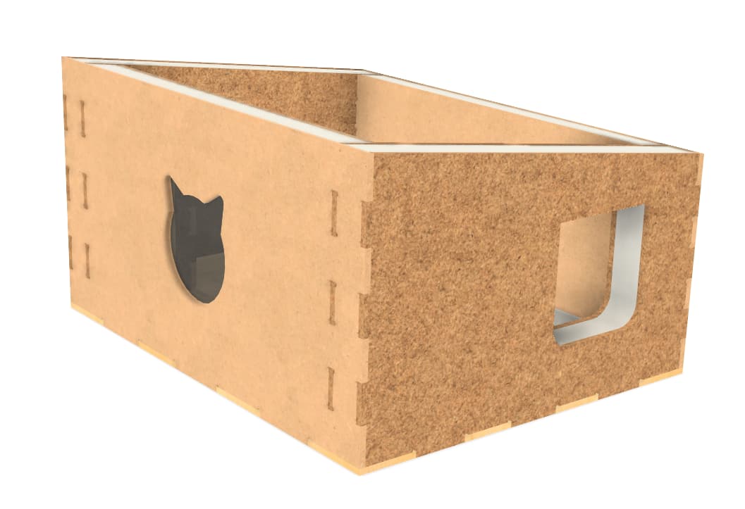

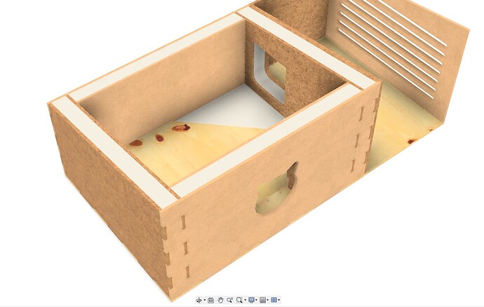

I’m in the process of designing and building a small hut/kennel for my two cats
They live outside and need a warm place to rest, so I’m planning on a fairly large well-insulated house
Design

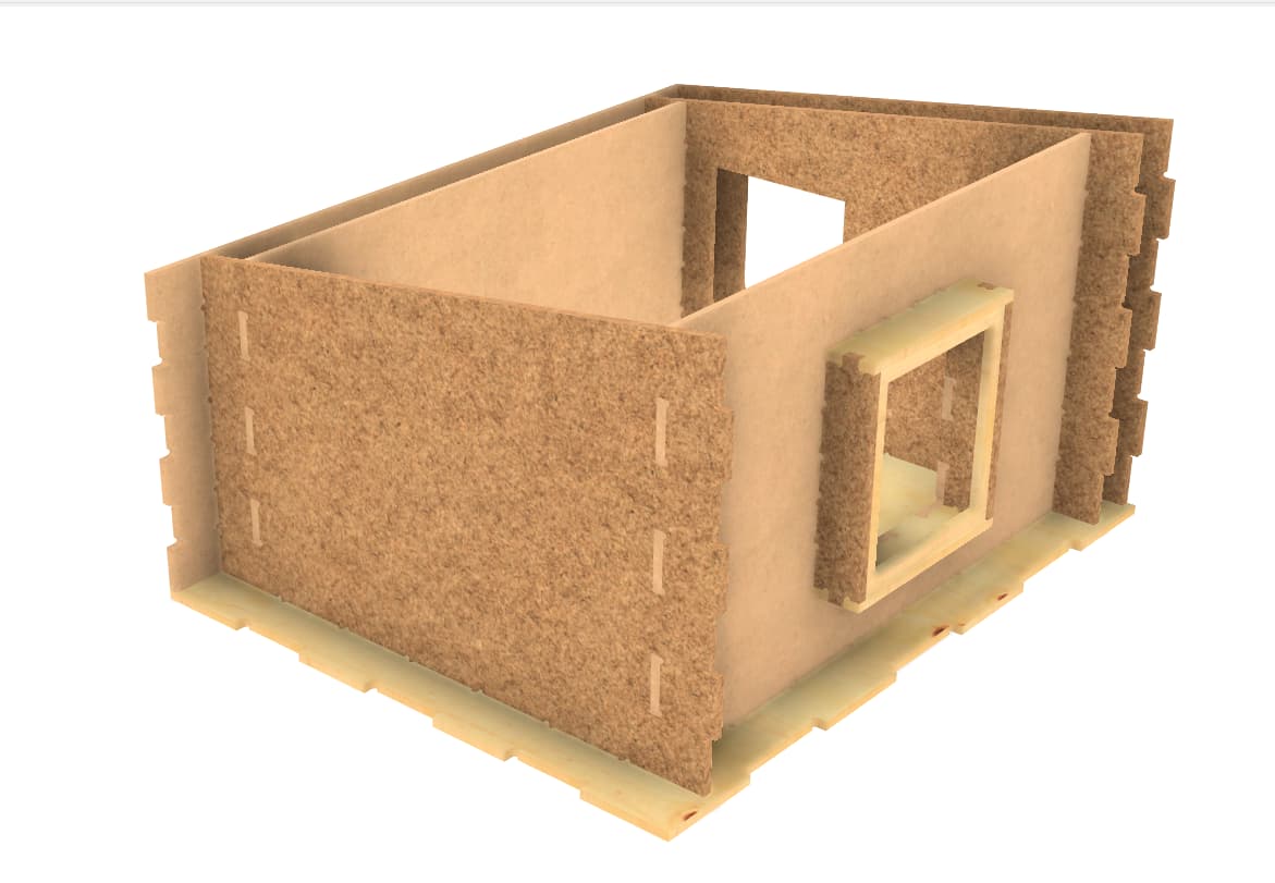

The build will use 9mm 3-plys OSB panels, assembled with finger joints, glued and screwed for reinforcement
Note: Different textures in the 3d model are only used to facilitate viewing the fingers
In-between walls, I’ll add some 45mm insulating foam, hence the double-walled structure
The whole structure is divided into 2 separate “modules” I can screw together, with a single common “roof” above
”Sleep module”
“Terrace module”
This allows me to have smaller parts , mainly for cost optimization (smaller stock needed)
This will also allow me to change some parts of the build if need be (eg: a larger terrace on the right side so that I can leave some food too)

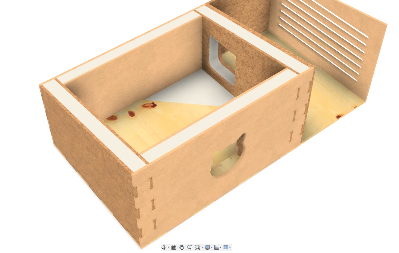

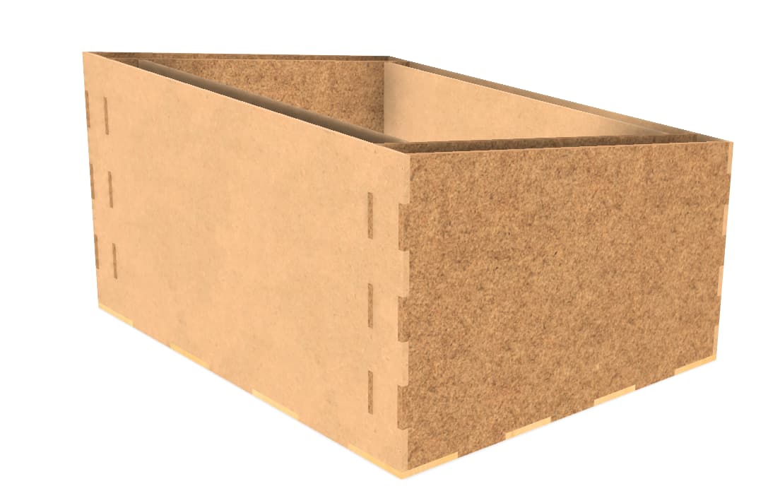

Modeling
The hardest part of this project is probably to design the fingers and corresponding holes.
I failed miserably at designing them at first, wasting 2 days with manually defined fingers that would break after every change in dimensions…
Then I discovered the “BoxJoint” plugin :slight_smile:

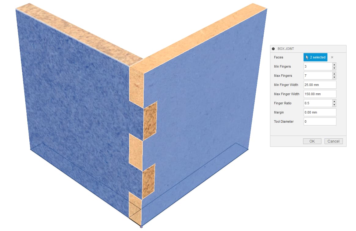

BoxJoint Plugin
This plugin is a true holy grail !
It’s quite simple to use:

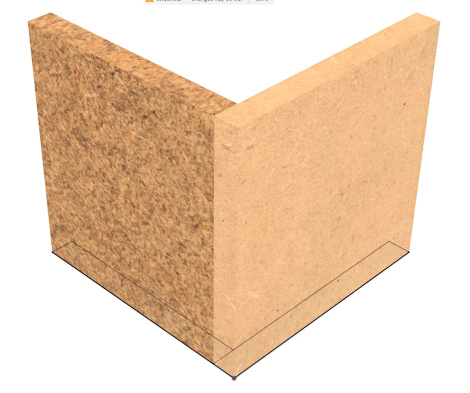

  • First just model your two boards with a simple “butt joint”
  • Click on the add-in
  • Select the two faces you want to join
  • Click OK… Boom! It’s done….
  • Need to change some parameters? No problem, double-click on the feature in the timeline
And you know what’s the best part of this? It’s free! :smiley:

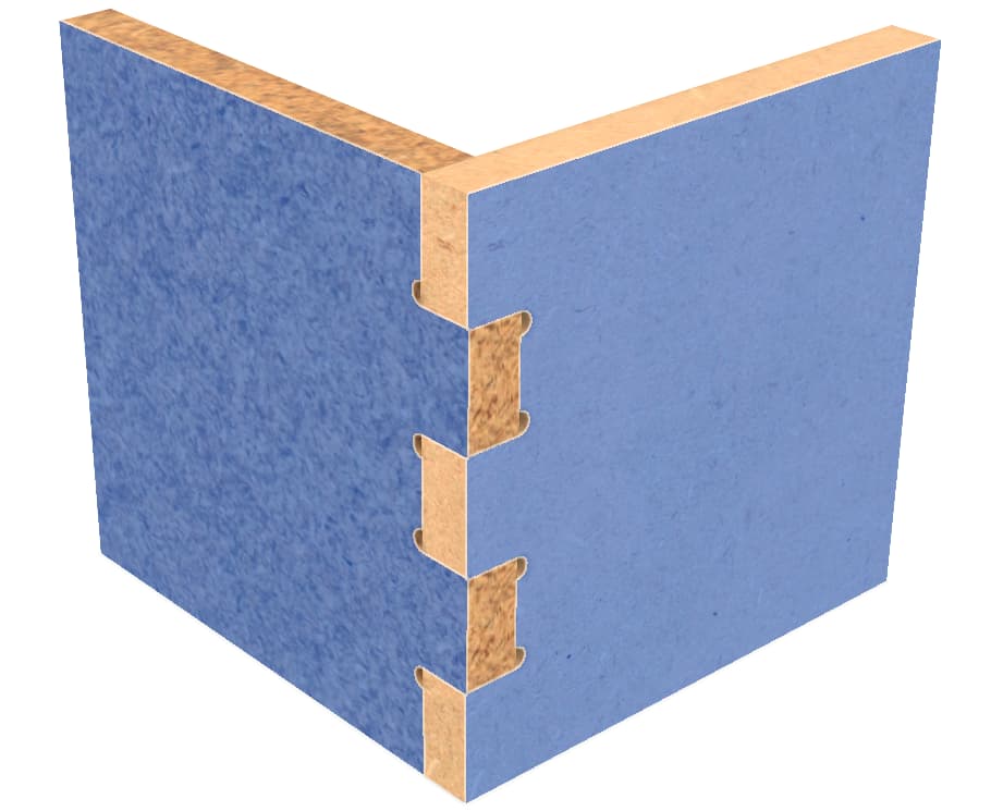

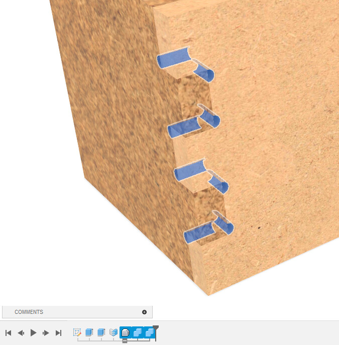

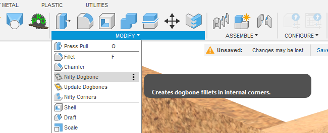

Dogbones Plugin

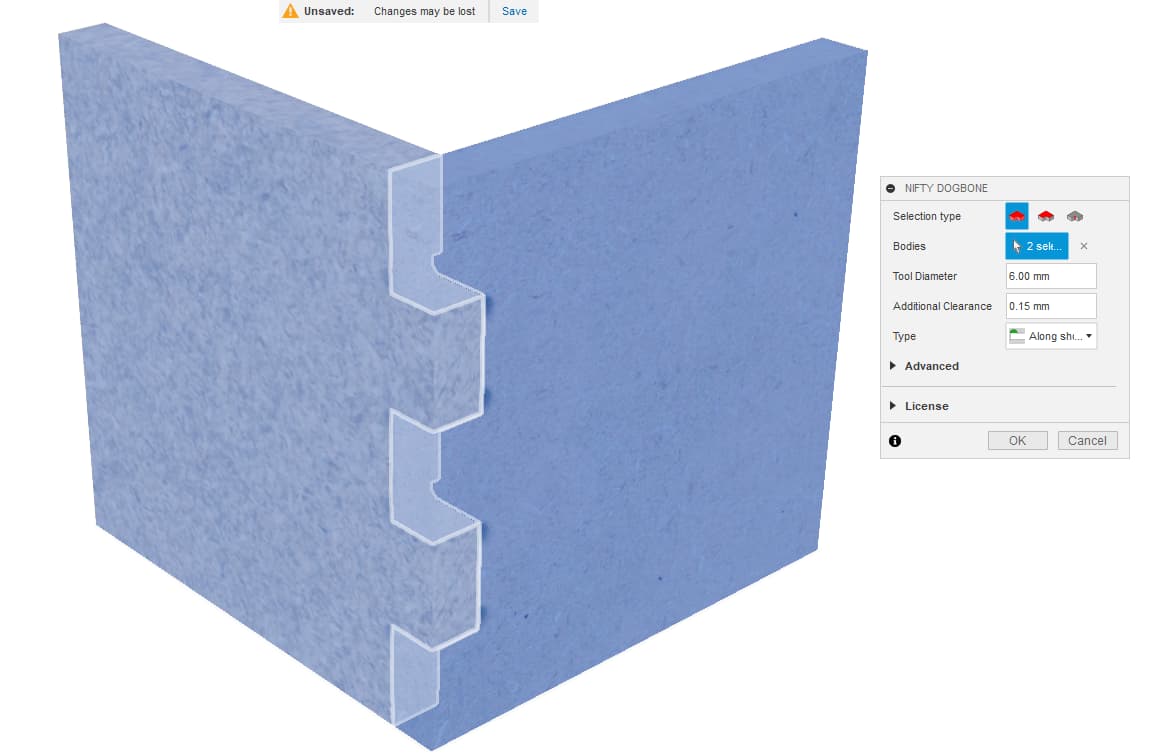

Now we have finger joints, but as you may already know, they’re not “machineable” as-is
The bit radius will keep them from sitting flush
We need to add “dogbones” to the holes and fingers to accomodate for the bit radius
I tried two plugins for this:
- Nifty Dogbones - Nifty Dogbone for Autodesk® Fusion® | Fusion | Autodesk App Store
Both plugin do the exact samle thing, and have the exact same options
Thay also have the same flaw;
it’s only a script that generates dogbones as a one-time operation, and you can’t modify the parameters later. You’ll have to delete the feature group and re-do the process.
The first one is free and open-source, and worked fine at first.
But it totally failed later in the project and I was unable to update or even re-model the dogbones, Fusion360 would just crash every time…
The second one is paid (20$) and I suspect it’s heavily based on the first one…
It’s a lot faster and more stable though, so I may end-up buying it anyway…
Here’s how it goes:
Note: As mentioned, the resulting feature will be a group of operation without any mean to edit or modify the parameters. I’d be quite ok with that for the free plugin, but I think it’s a bit of a shame for the $20 one

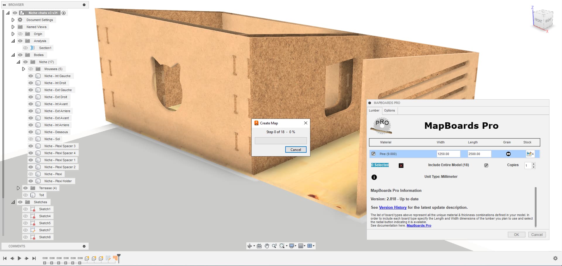

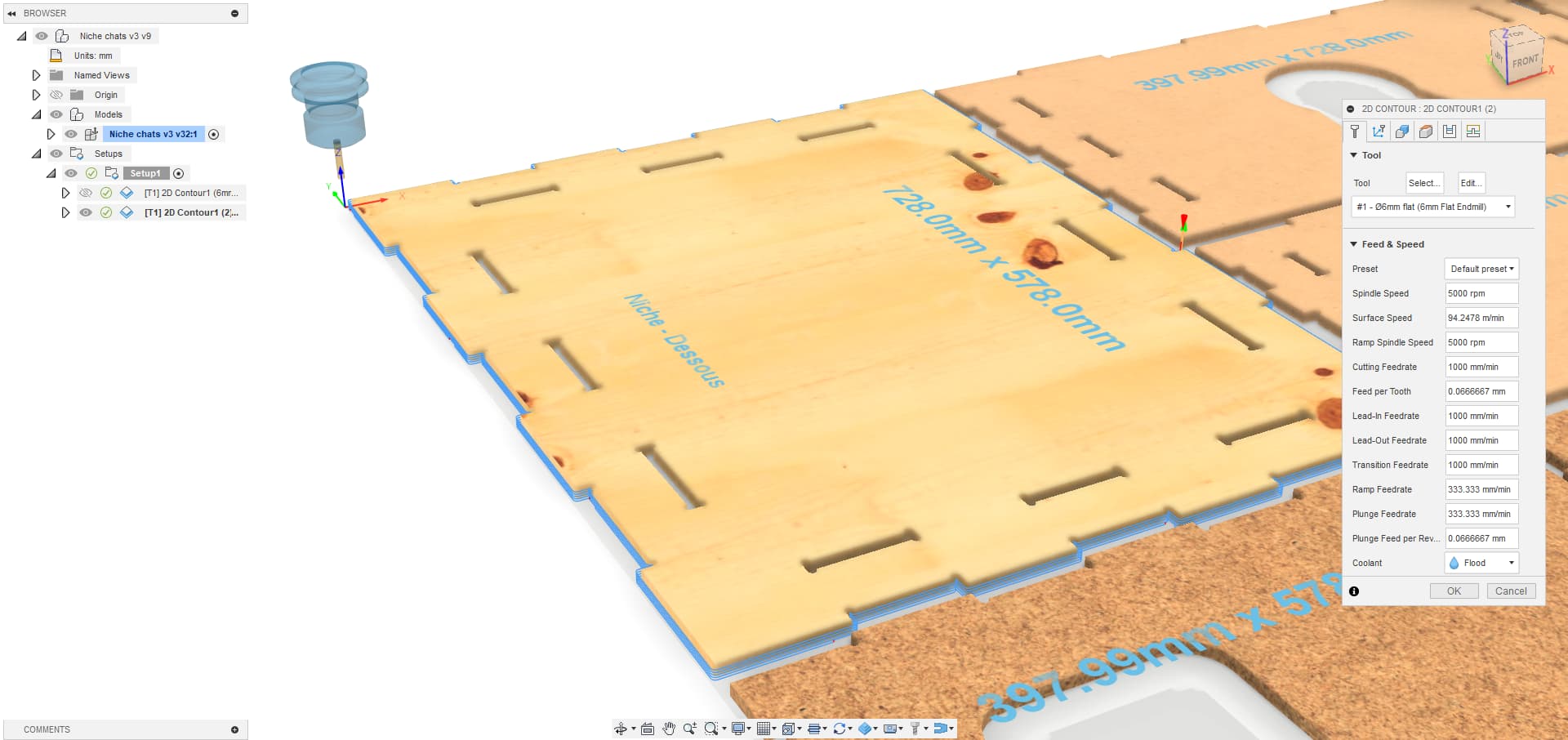

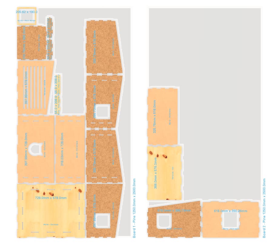

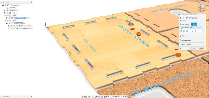

Layout

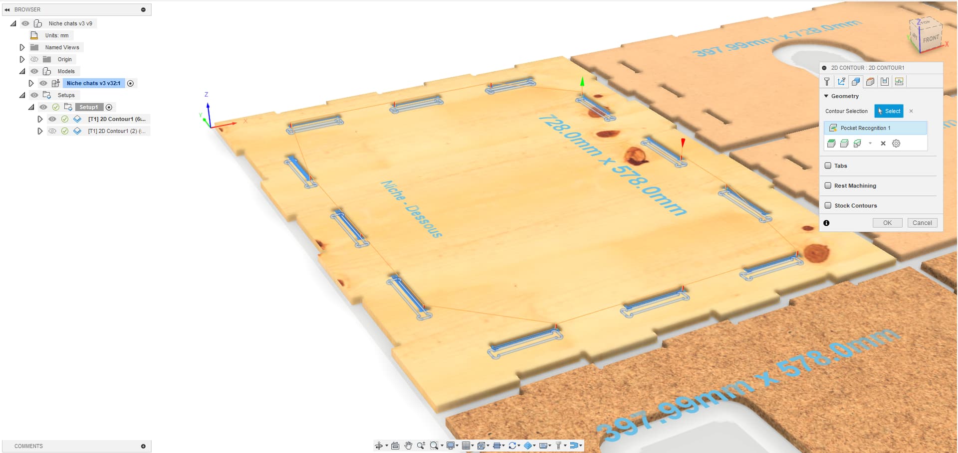

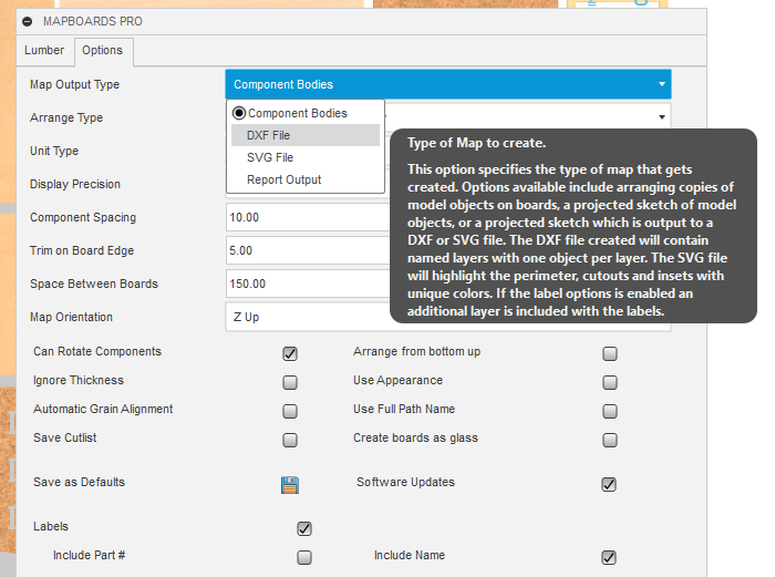

As usual, I use the trusty “MapsBoard Pro” plugin to create the layout for machining

I’m very basic in fusion. I usually export a dxf of the sketch I’m using and then import that into ESTLcam. Does the boxjoint plugin modify the sketch or the body? If the body, then do you just export that into your cam and program it like a 3d object even though its only 2d?
same. If you keep it all in fusion I’d love to see how you do all the setups in the CAM environment,
It modifies the body directly.
I didn’t really care about this because I use Fusion360 as my CAM program directly, I find the process a lot easier and error-free
If you want to use ESTLCam though, you can set mapsboard pro output to “DXF” and work from here
Note: I didn’t mention it for clarity’s sake, but BoxJoint plugin has a dogbone feature. It will generate “3D dogbones” that are a lot nicer visually, but also a real pain to machine. That’s why I use a separate “dogbone” plugin to generate them, so that I get a simpler / easier to machine geometry, and this one will be export-able to DXF without any problem
Never tried ESTLCam so I can’t really compare, but I always found Fusion360CAM to be pretty straightforward and easy
Create your setup, add clearing and contour operations, export you NC program, done…
Rinse and repeat for every stock sheet…
Also, If I happen to modify my model, the CAM program would also update automatically, which is a big plus for me… no export/import versionning error in this process…

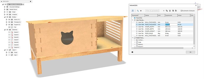

I love this hut. Design question… Is there a way to periodically clean it out without tearing it apart?
Yeah you really need to design and model with CAM in mind
Making the model as a “block” and then trying to split it into sheets in the end won’t work
But that’s part of the process, while I’m desiging, I’m also thinking the whole time about how I will cut and assemble the elements
All parts need to be “flat”, “extrude” is the one and (almost) only tool you should use while modeling those :slight_smile:
Keeping the model very “parametric” also helps a lot, as I can play around with the sizes in the end to make it all fit in the stock I have available, or adapt to other constraints

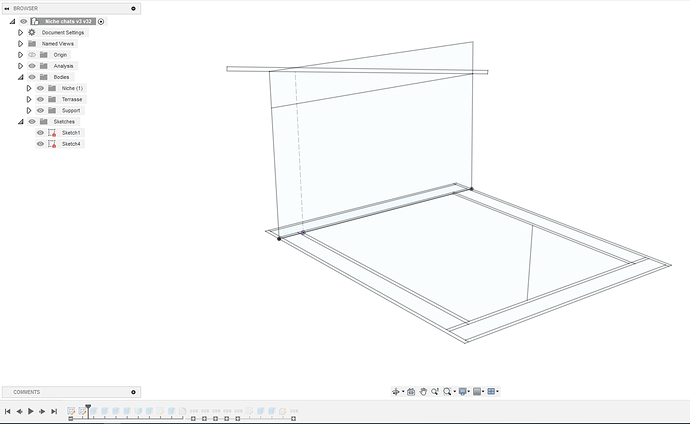

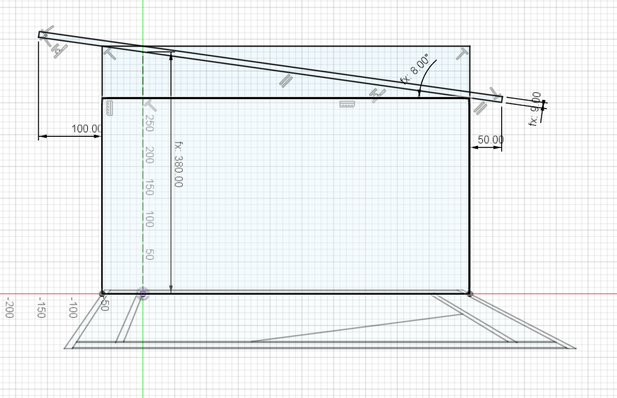

Some details about how I designed the parts

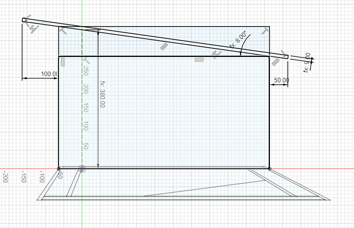

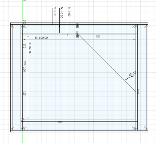

Initial sketches
Start with two sketches that will capture the dimensions
Think of these as your “Industrial drawings - front and side”
Note: Everything should be black, any “blue” line is not properly constrained and must be fixed

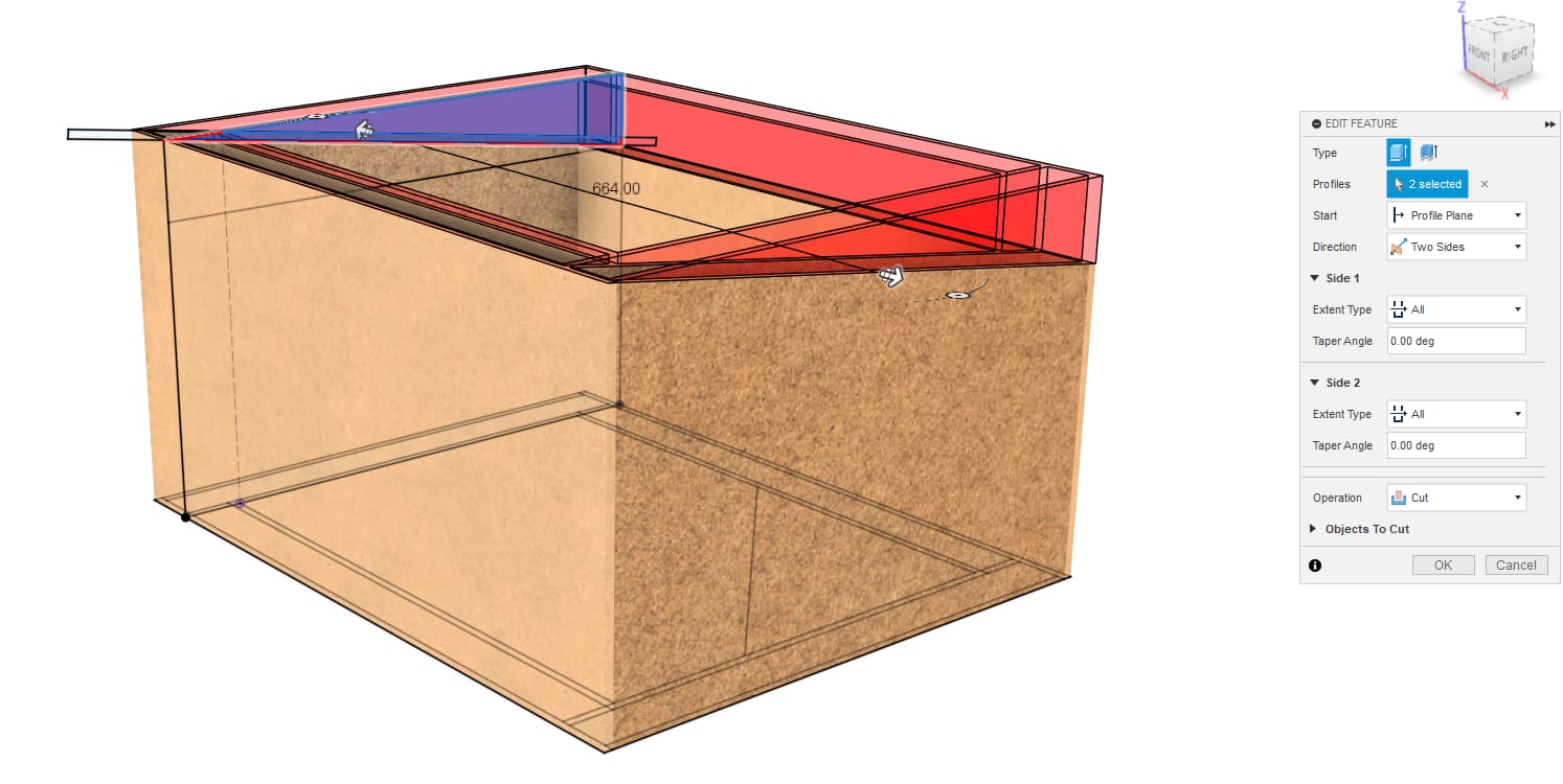

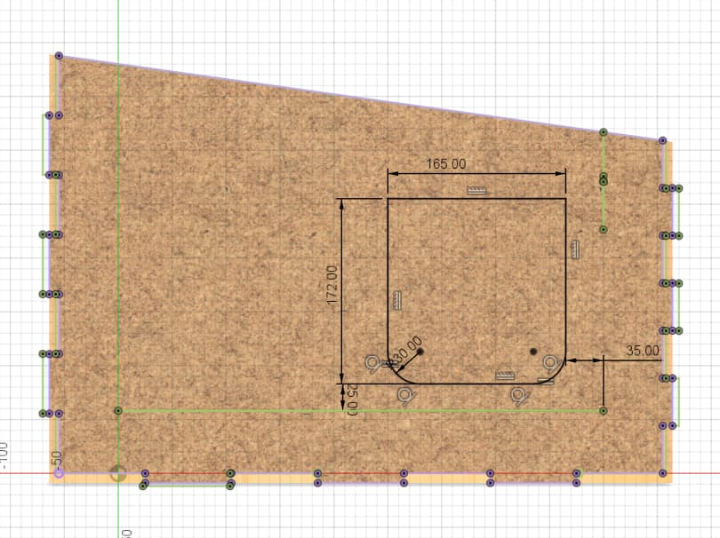

Begining the box

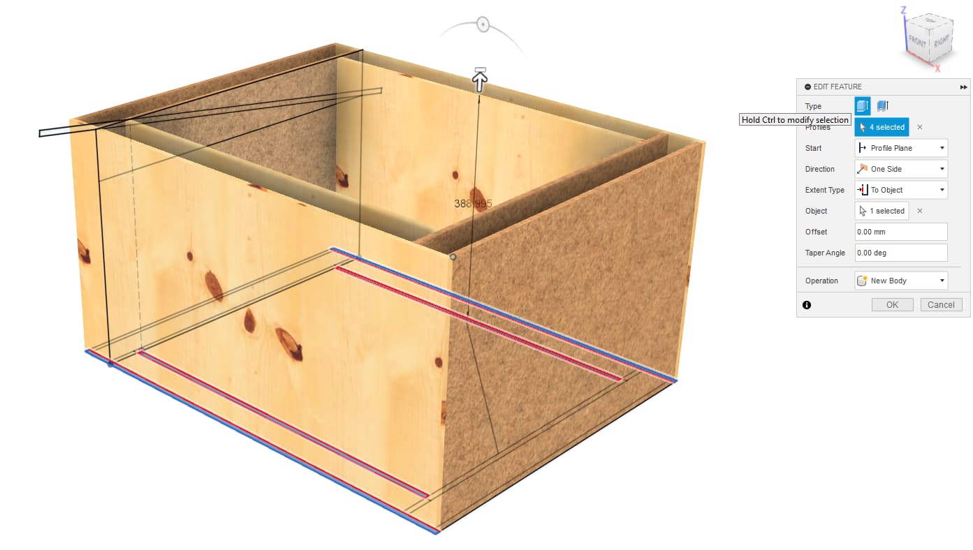

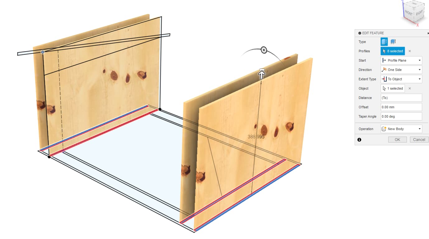

Then extrude the “sheets”
Notice I extruded each wall as a separate body rather than extruding a solid box, I’m modeling the sheets, not the whole object
Also note that in all extrude/cut operation I never referenced any “real” dimension in inch/cm, and always refered to projected points, so that the dimensions are all driven by the two initial sketches

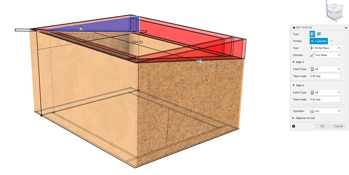

I’m extruding to the max height, and then use a “cut” operation to remove the slanted part as a way to minimize operations, but you could also extrude 4 sheets from the side sketch

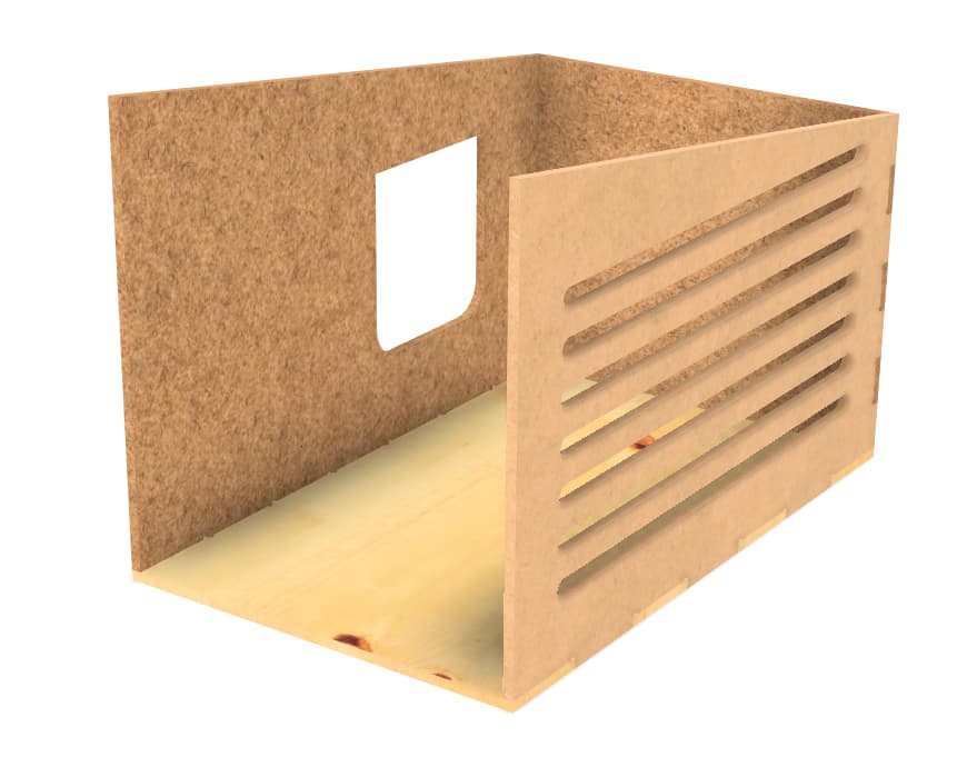

Finger joints are added
And a third sketch and cut for the flap

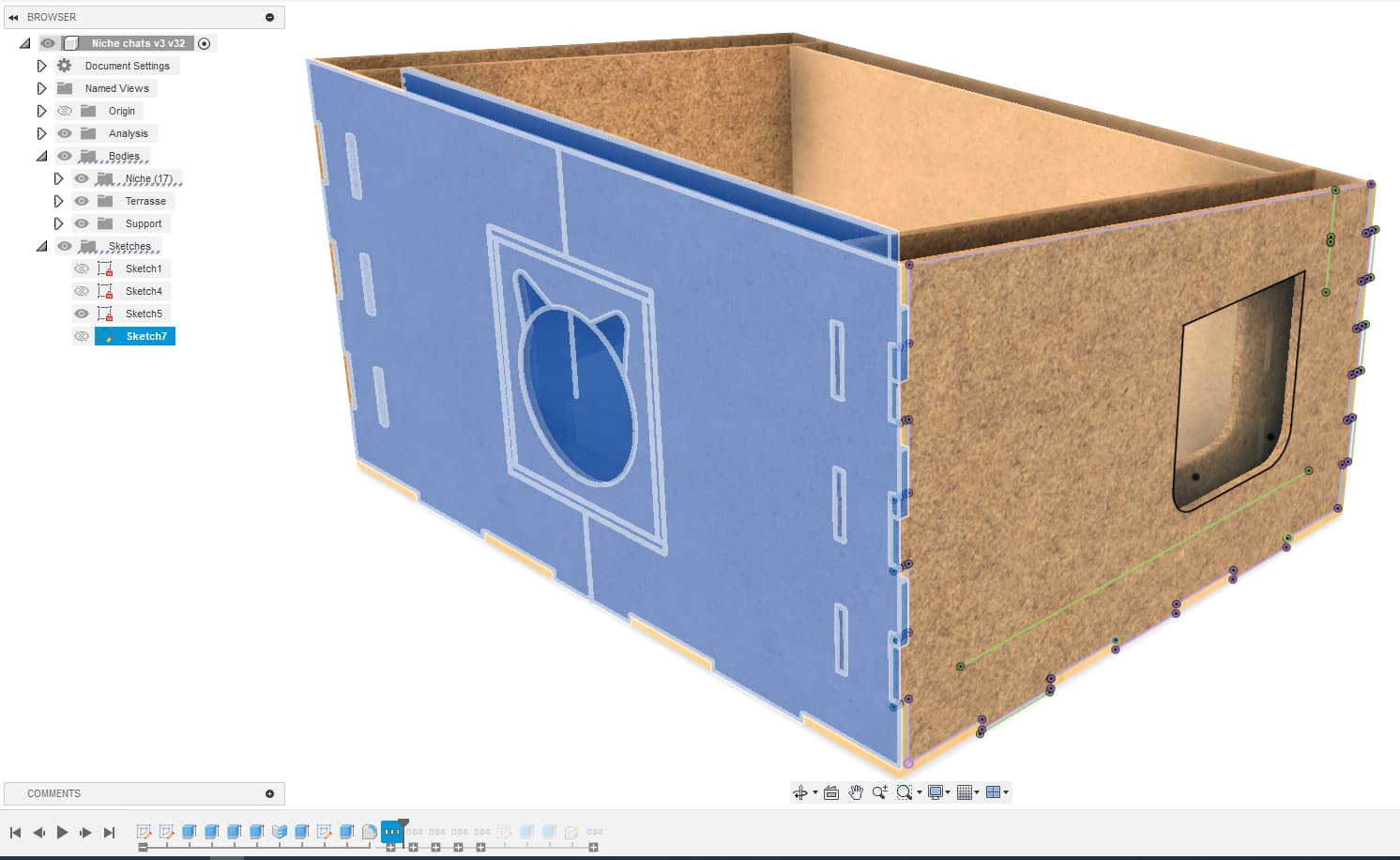

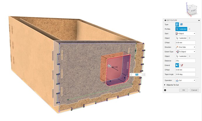

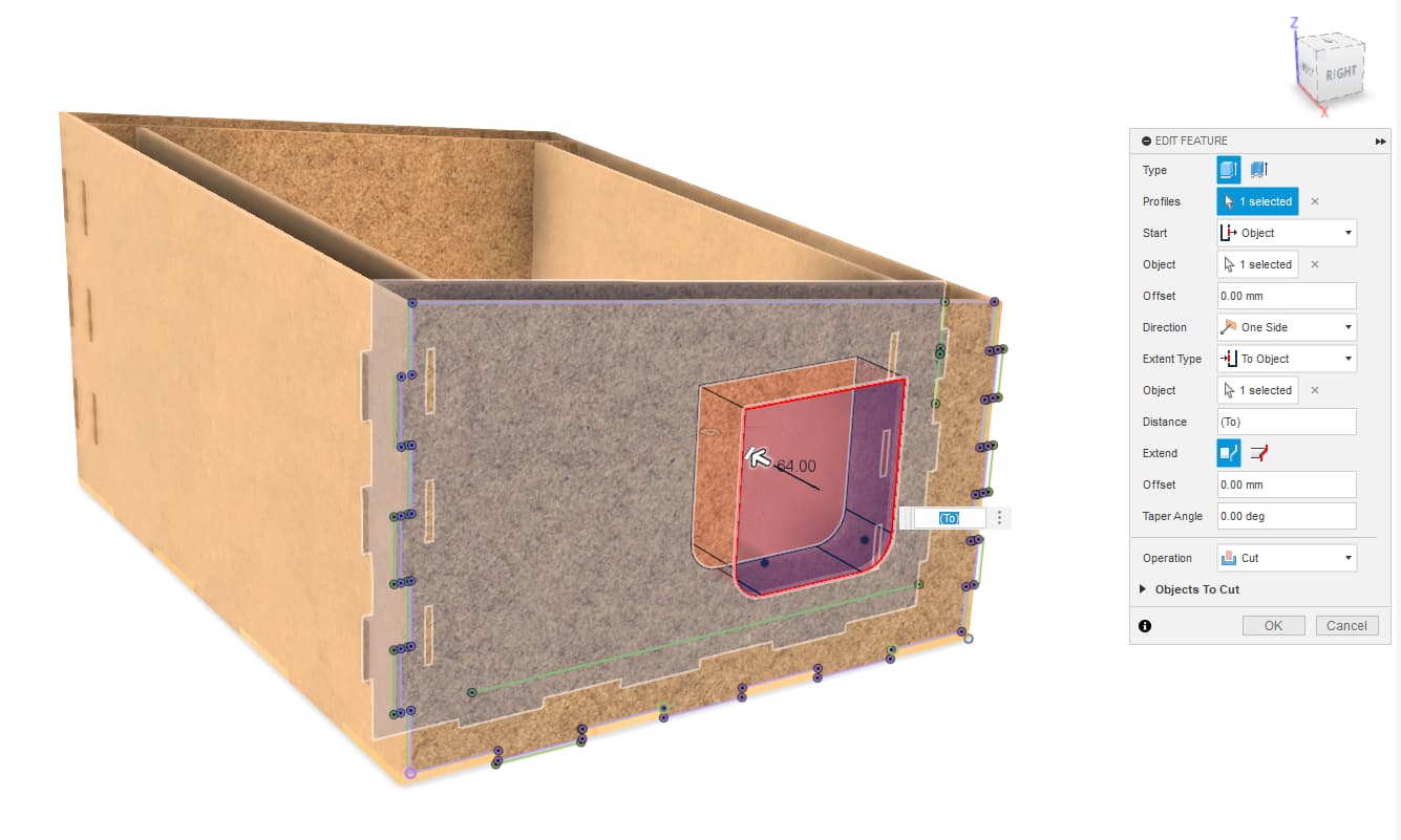

Adding some features
At this point, I already have my main features set and done, so I’ll create a group out of these
It really helps when you look back and make some modifications, and it also forces you to “think in features”, not mixing things up
As an example, I’ll then add the “cat head” cutout and plexiglass window, and this will also be a single group
If you select the group in the timeline, you can see the affected zone is well defined
And if I ever decide to delete it, things should keep in place :slight_smile:
Keeping some strict rules like that will greatly help you produce a truly maintain-able and machine-able model
There will absolutely be some errors and break when changing parameters (lost projections, various bugs and constraints that weren’t right, …) either because you didn’t define the “good” constraint, or because Fusion has some weir sheningans sometimes, but it will be easier to fix if the model is clean in the first place

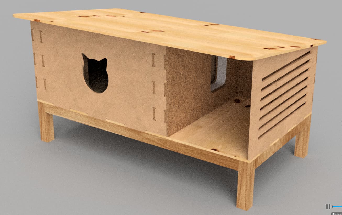

I plan on having the roof removable
Any other part should be easily accessible from there, walls aren’t closed on top for easy replacement of the foam if need be
The whole structure will be outside, but slightly protected by another structure, so everything should be pretty safe

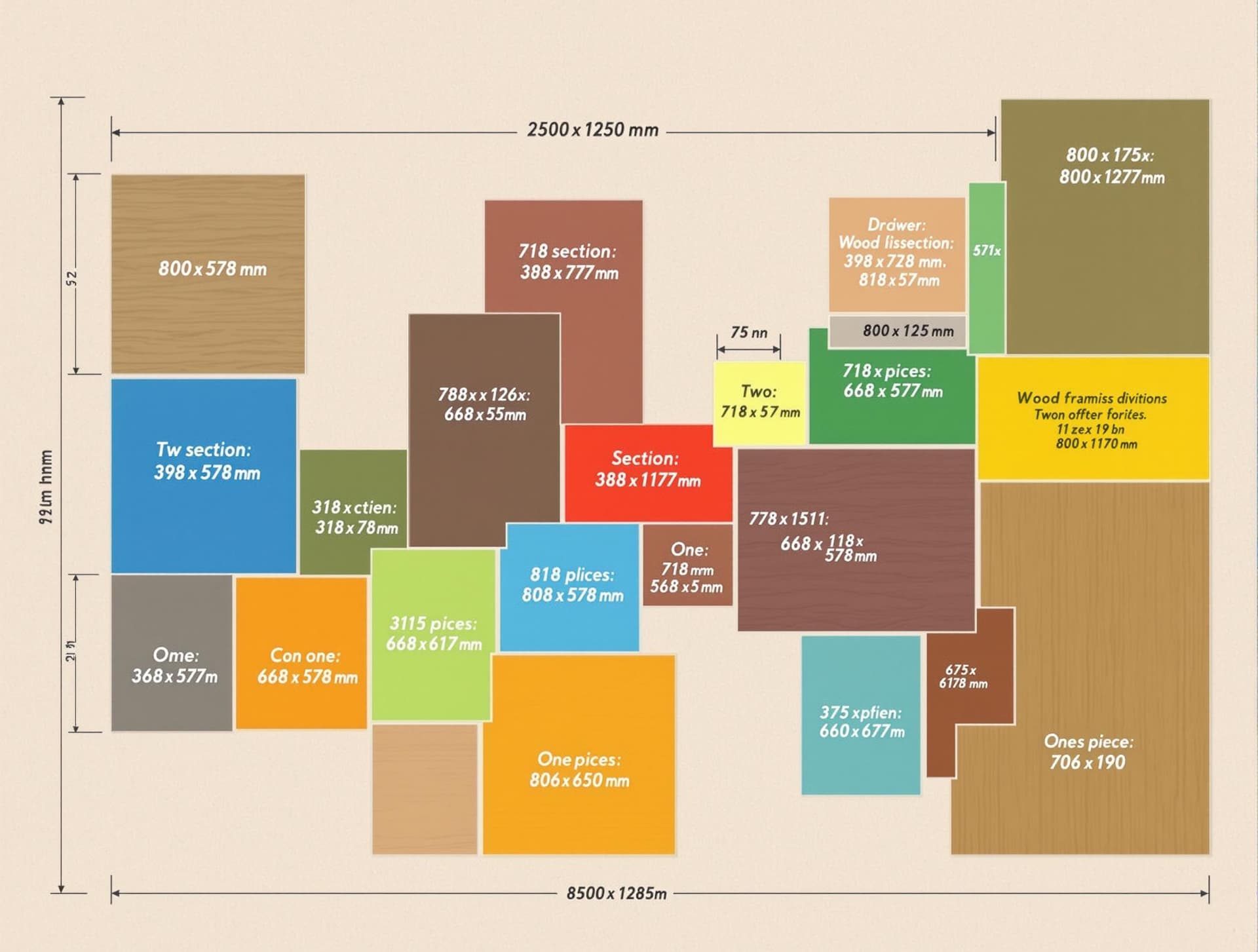

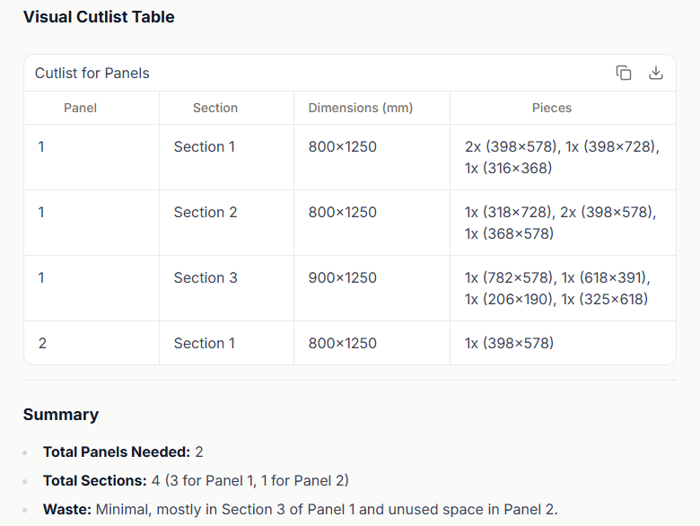

I’m trying to optimize the stock I need for all those pieces
My LR3 has a work area of =~ 820x1800, and I need to be able to carry the panels in my car (ideally inside the car, or on the roof) over 50km
Normally, I would look toroughly at the sizes, grab a pencil and paper, and think hard about this…
But now we have AI :smiley:
I want to optimize the CNC cutting of wooden pieces in 2500x1250mm panels.
The dimensions of the pieces to be cut are as follows:
- 782x578
- 398x728
- 318x728
- 398x578
- 316x368
- 206x190
- 398x578
- 398x578
- 398x578
- 398x578
- 398x578
- 368x578
- 325x618
- 618x391
My machine has a maximum cutting area of ​​800x1500
How many panels do I need?
How do I cut them to make them easier to transport (with a minimum number of cuts per panel) ?
Here’s the response I got:
To optimize the CNC cutting of your wooden parts in 2500x1250 mm panels, while respecting your machine’s maximum cutting area of 800x1500 mm, here’s a structured approach:
1. Constraints to Respect
  • Panel size: 2500x1250 mm.
  • Maximum cutting area: 800x1500 mm.
  • Goal: Minimize the number of panels used and the number of cuts per panel to facilitate transport.

3. Cutting Strategy
Since your machine can only cut a maximum area of 800x1500 mm at a time, each 2500x1250 mm panel must be divided into smaller sections that fit within this limit.
Step 1: Virtual Panel Division
A 2500x1250 mm panel can be divided into:
  • 3 sections of 800x1250 mm (since 2500/800 ≈ 3.125).
Step 2: Optimizing Layout
Group parts by size to minimize waste.
Example Layout for One Panel (2500x1250 mm):
  • Section 1 (800x1250 mm):
    • 2x (398x578)
    • 1x (398x728)
    • 1x (318x728)
    • 1x (316x368)
    • Remaining space: Can be used for other parts or will be waste.
  • Section 2 (800x1250 mm):
    • 2x (398x578)
    • 1x (368x578)
    • 1x (325x618)
  • Section 3 (900x1250 mm, since 2500 - 2x800 = 900):
    • 1x (782x578)
    • 1x (618x391)
    • 1x (206x190)
Estimated Result:
  • Panel 1:
    • Section 1: 2x (398x578), 1x (398x728), 1x (318x728), 1x (316x368)
    • Section 2: 2x (398x578), 1x (368x578), 1x (325x618)
    • Section 3: 1x (782x578), 1x (618x391), 1x (206x190)
  • Panel 2:
    • Section 1: 1x (398x578) (only one left after Panel 1)
    • Remaining space: Can be used for other parts if needed.
4. Number of Panels Needed
With this approach, 2 panels should be sufficient to cut all the parts, with efficient space usage.

7. Verification and Adjustment
For precise optimization, use nesting software (such as CutList Optimizer, DeepNest, or OptiCut). These tools automatically visualize the layout and minimize waste.
How cool is that? :smiley:
It even generated a visual representation when I kindly asked… although it doesn’t make any sense!!! :smiley:
I managed to make it output a simplified cutlist though, and it doesn’t seem too bad

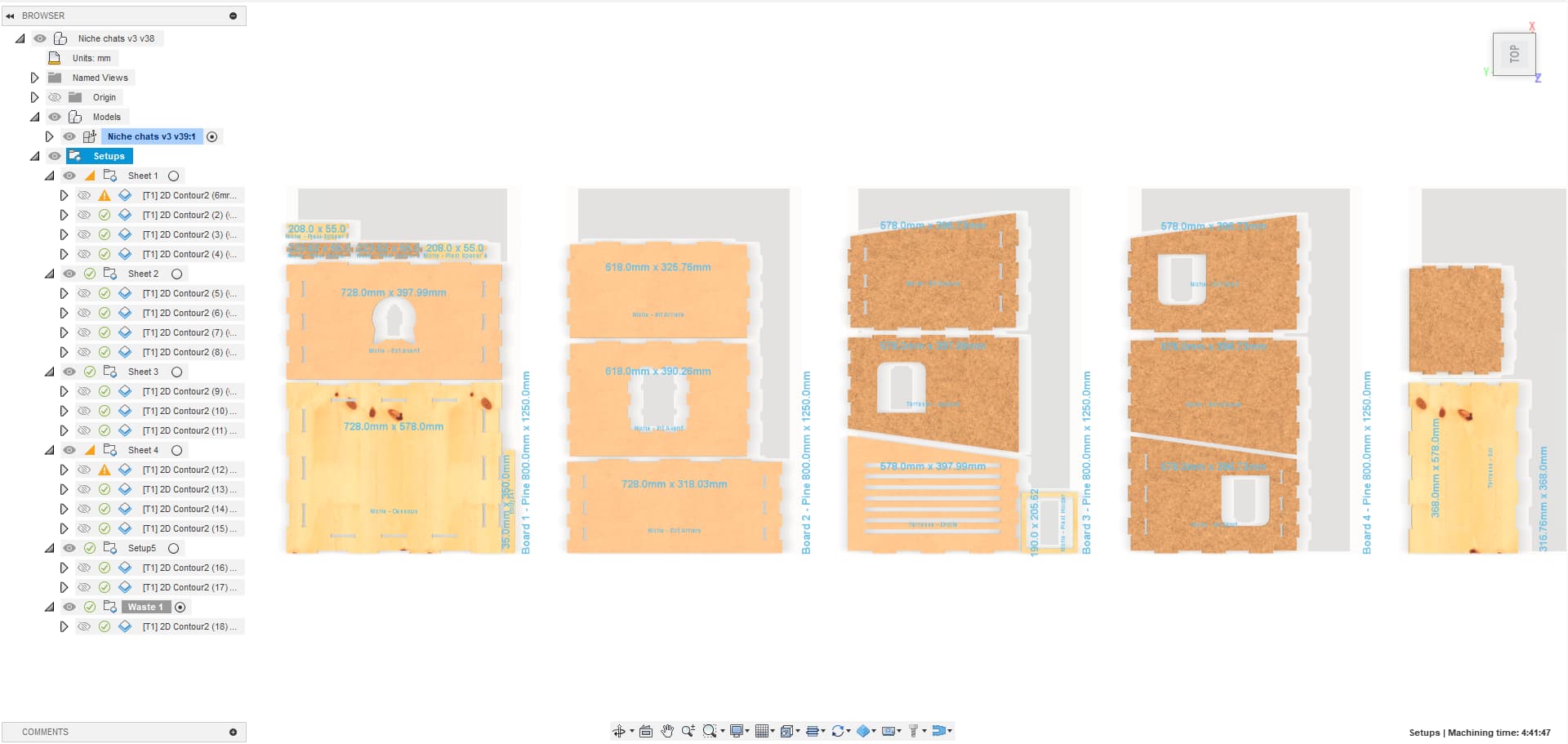

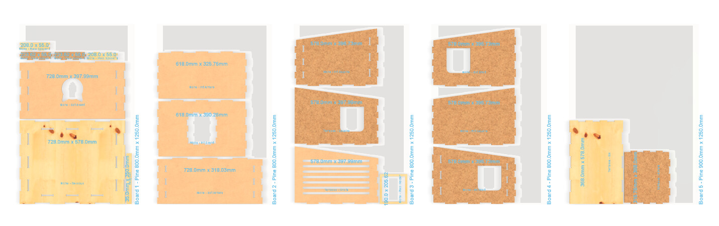

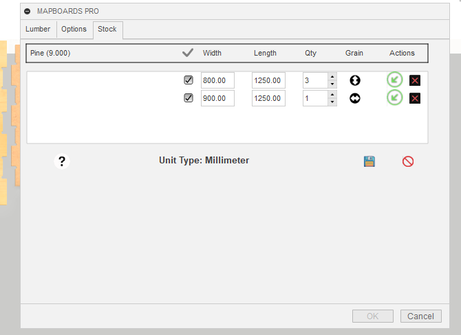

OK, let’s plug that into MapsBoard Pro

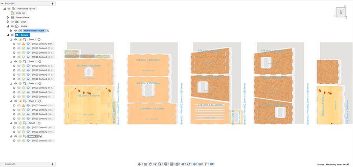

Mmhhh not quite, but we’re almost getting there….

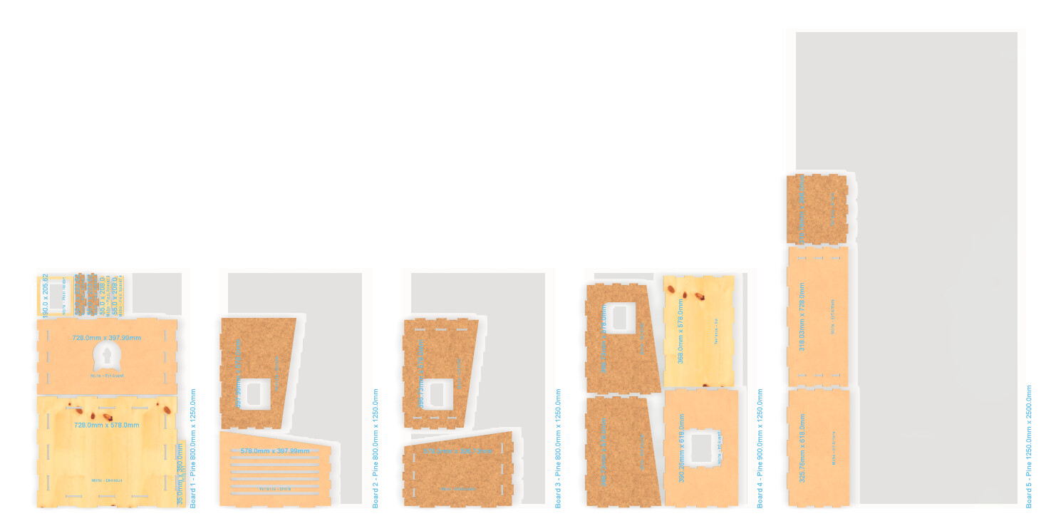

Manually adding a 800x1250 section solves the problem and we still have some left…

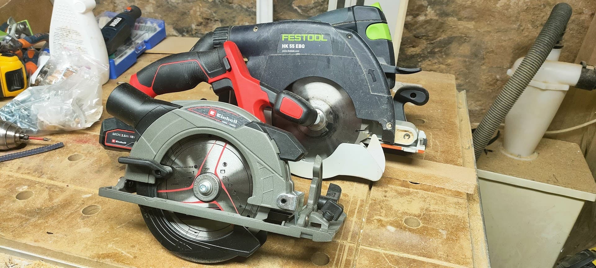

Now I only need to find a way to cut those sheets on the shop’s parking lot :stuck_out_tongue:

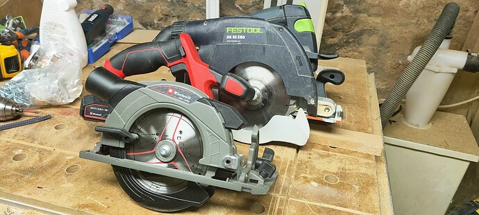

Hint: I made a small purchase but shhhh… don’t tell my wife :stuck_out_tongue:
If it was the Einhell she won’t notice, if you also bought the Festool she will because there isn’t any money for food left. :sweat_smile:
So… that’s 04h42 machining time at least… whooo…
@Tokoloshe can you drop in real quick and lend me yourt fast LR4 ? :smiley:
And nope, it’s “only” the Einhell (it was a steal… 50€…), the festool one I bought long ago (with tracks and an MFT3)
No regrets, great tools, and they’ve seen some use :smiley:
I guess it isn’t faster than yours, I am just stupid enough to run it faster. :stuck_out_tongue:

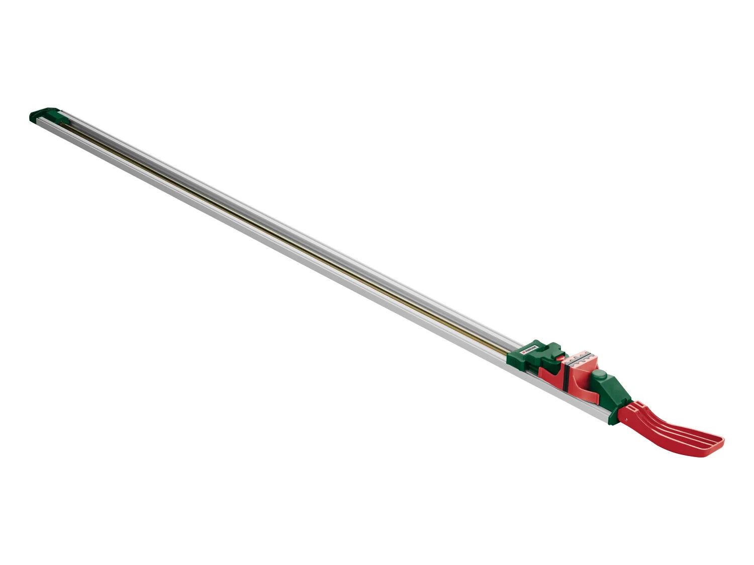

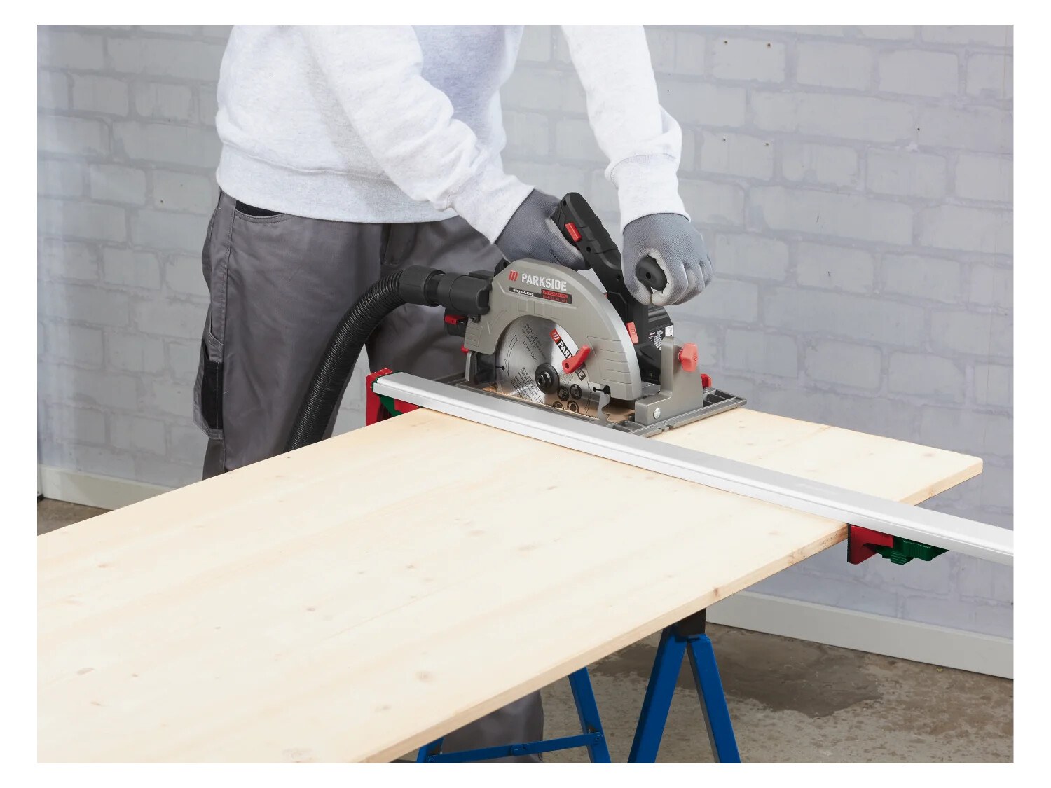

Put a few 2x4’s to prop up the sheet and cut with one of the Kreg edge guides. Should fit on your nice new tool. Sure people look at you but awkwardness / shame at breaching social norms are personal feelings, you can learn to ignore them with enough practice.
Concrete curbs work too, or so I’ve heard. :wink:
Not a big fan of the Kreg system, It’s quite pricey and bulky I think
I already have this Parkside guide rail/clamp that works pretty well.
It’s very light and portable, and at 8€ it won’t break the bank
Only thing I’d change would be some kind of way to see where the blade will land (a bit like a track saw rail)
I’m just not quite sure it’s long enough for the sheets I want to buy, I’ll need to check
If not, I think I’ll just build a quick and dirty plywood tracksaw as a makeshift…
EDIT: Max length is around 90cm… I need 125cm… plywood track it is then…. or maybe a DIY system similar to the Kreg one for my one-time use… I’ll see…
I use a bit of 3mm MDF with a straight bit of 16mm mdf glued to it! :rofl:
Exactly my thought… and use the saw itself to cut the excess so that it “auto-calibrates” itself…
But do I have a 150mm long (and straight) mdf strip left? that’s the whole point :stuck_out_tongue:
