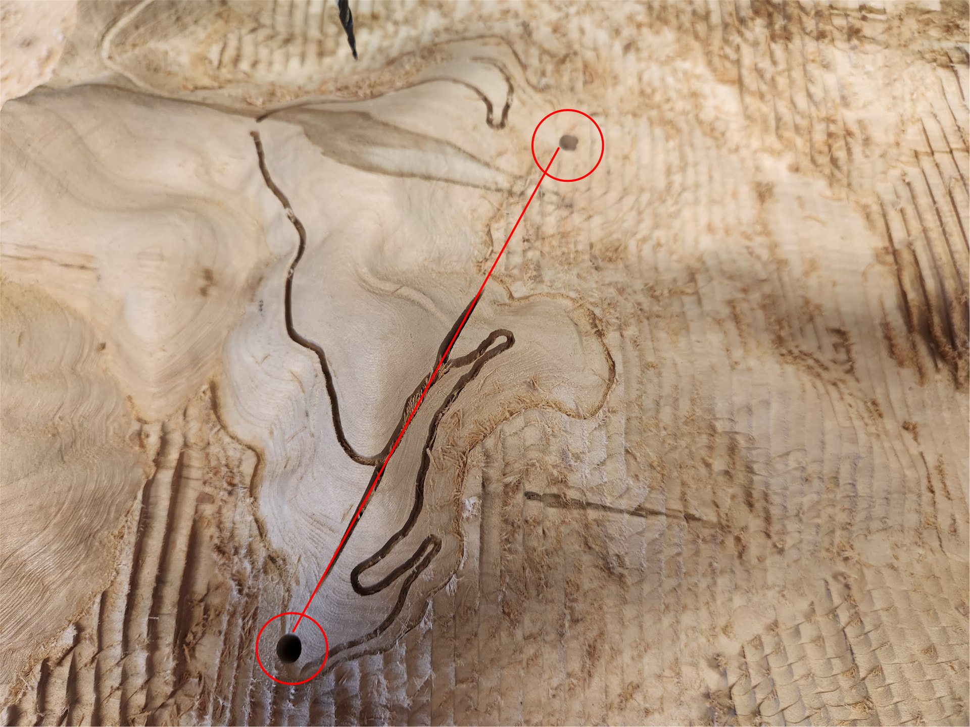

All of a sudden, I hear the sound of major material removal; by the time I make it downstairs, it’s drilled two huge holes in the workpiece and carved a decent sized trench along an axis extending from one hole to the other. See pic below (red line is axis of trench; the curvy trench is supposed to be there–it’s the trail).

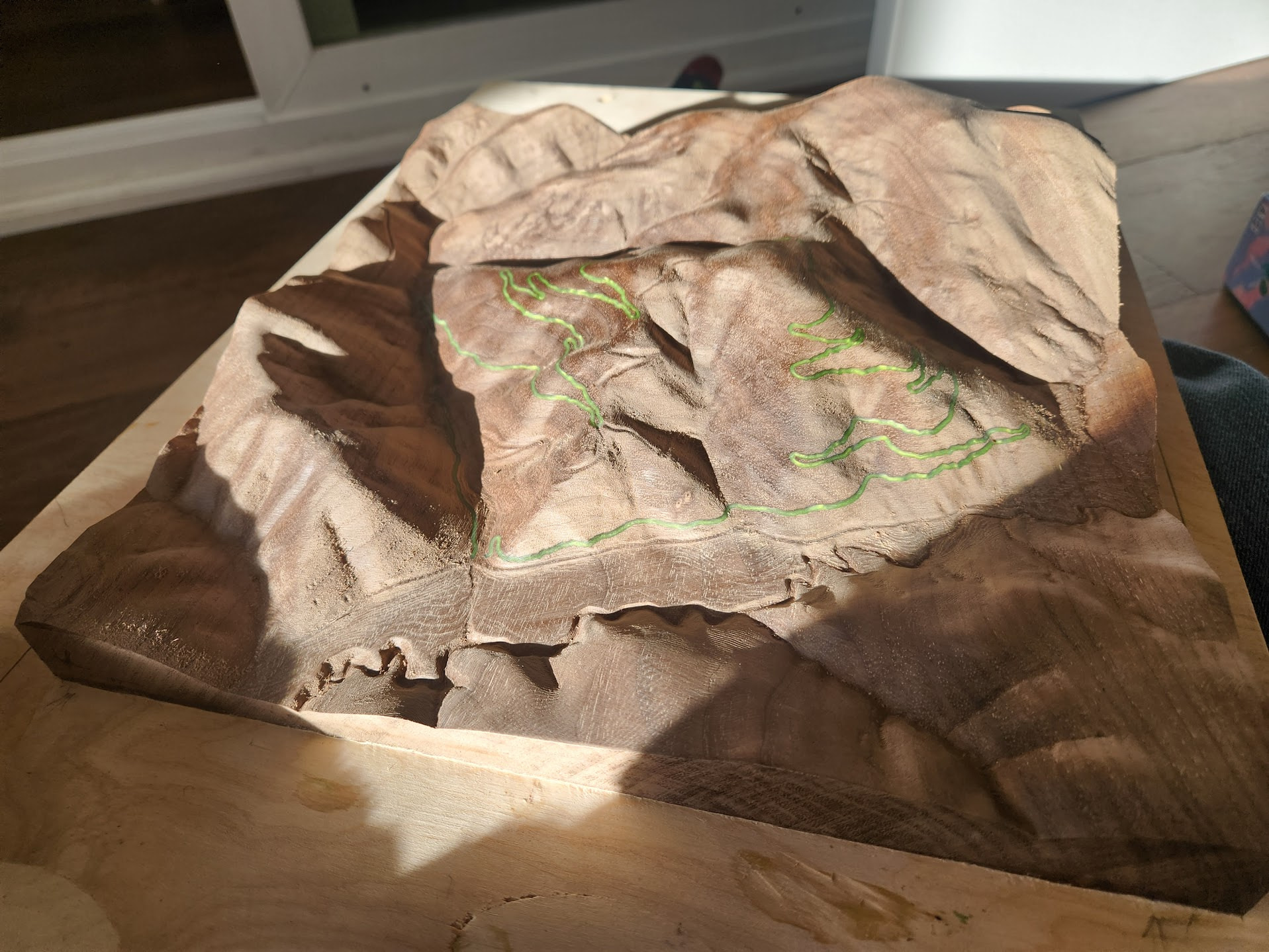

I’d done this same process a few weeks ago on the same equipment with an 11” square, 2.75” thick workpiece and using a similar approach (different model files, however–due to aspect ratio, had to change extent of map). No issues and it turned out gorgeous–there’s a photo below of it before I completely finished it.

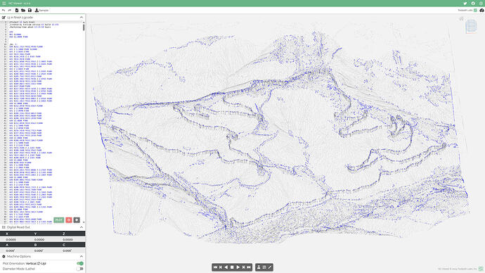

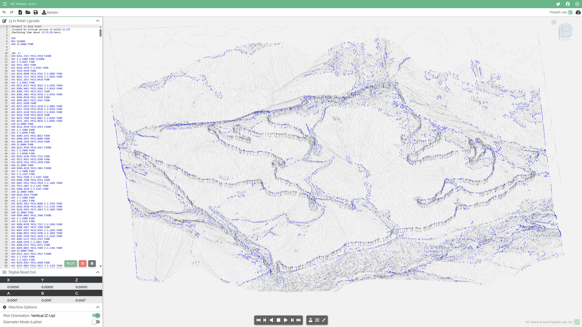

I checked the gcode that I was using (attached), and I can’t see any odd low points that would cause it to suddenly start drilling straight down. A preview of the gcode shows nothing like these features. It seems like it must be the controller misinterpreting/misexecuting the gcode. But I’m no gcode expert so maybe I missed something.

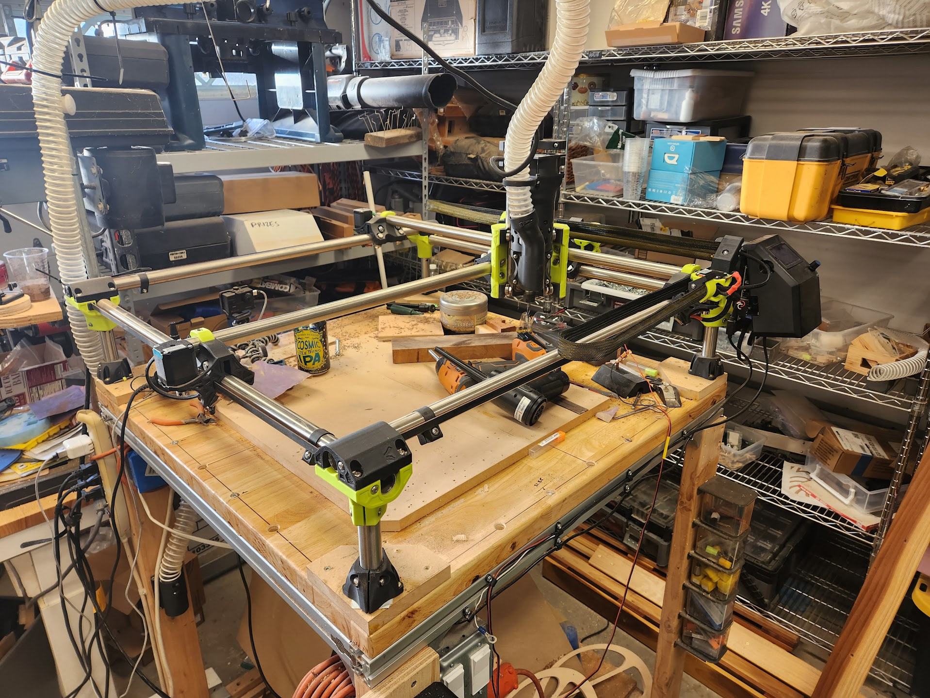

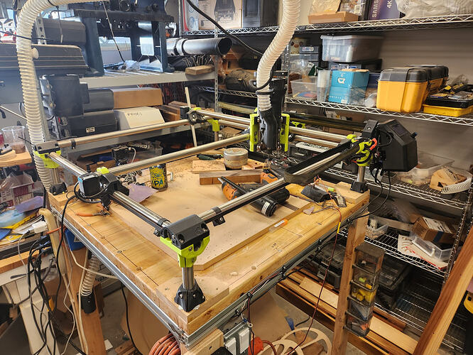

The mill itself is an MPCNC Primo, but the control board is from ~2020. It started out as a Burly, but I re-printed all the parts as Primo this year and upgraded it. The controller stayed the same and is a Rambo Dual running Marlin 2.0.x (whatever it shipped with–never bothered to update it, I think–maybe that was a mistake). The dual endstops are enabled. It is attached to a V1 “full graphic smart controller (big)”, which has the SD input, display, and scroll dial/selector. I’ve never had it do anything like this before–the issues that I’ve had have usually been when a workpiece breaks free and bounces around the table.

The casualty….
What the preview looks like of the finishing program (first stage)….
The MPCNC…it’s pretty big, but has worked well until this.
The previous attempt at something similar.
