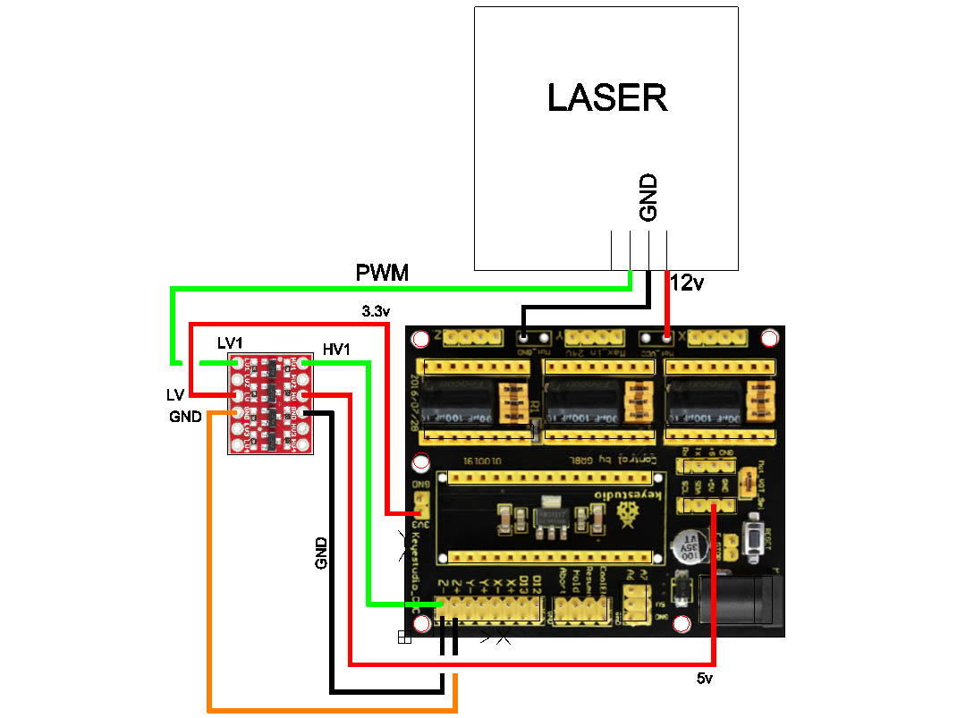

After wiring the jumpers on the keyestudio board, thought I would draw up the circuit diagram to make sure this looks correct. I had to bend back the 3.3v pin on the board so the usb plug could connect to the nano board. @dkj4linux & @dart1280 see if this looks correct?
That looks as though it should work to me…
Me too, although you don’t need both ground wires going to the level changer board…one will suffice.
Ok, Thanks @dkj4linux & @dart1280. I did think it was odd that keyestudio would put that 3.3v connector so obviously in the way of the usb connection on that nano. I will test this sometime in the next few days, maybe even today.

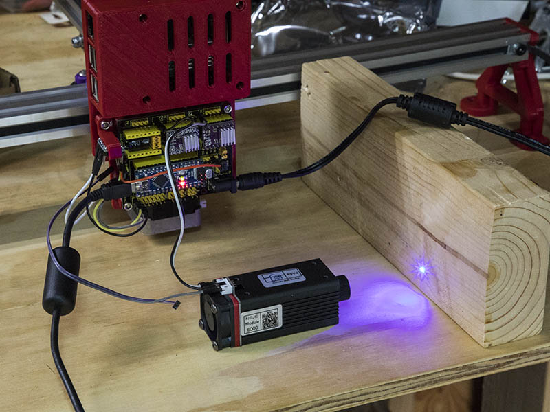

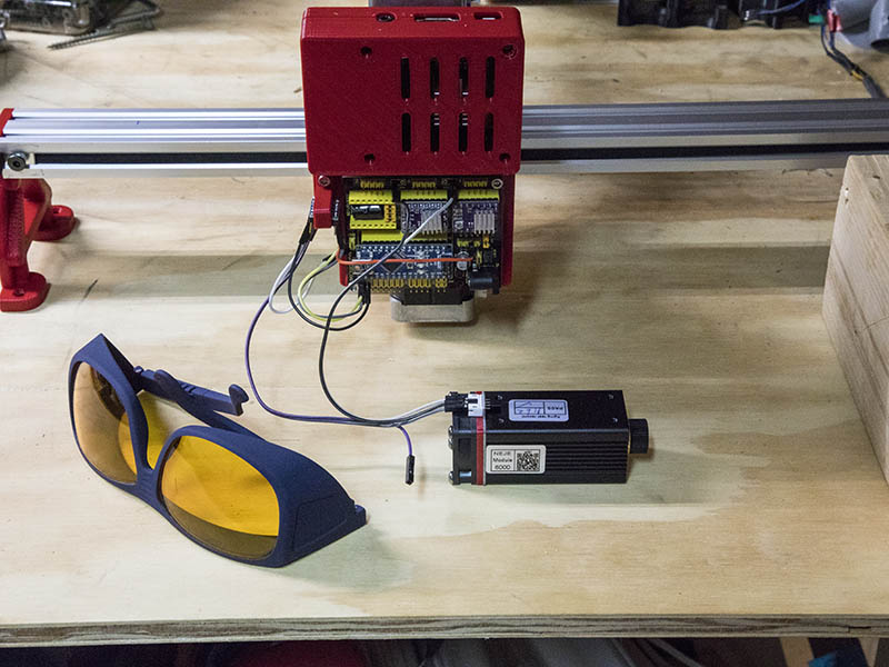

I was able to test it sooner than I thought. Yeah, Both laser work. Initially the 1st laser would not come on except for the fan, but seems to have been a loose connection on laser PWM wire. 2nd laser was really out of focus to start with, but after a few turns of the adjustment knob it looked good. I turned it off between each time I focused it. Laser glasses seem to work well. All I saw was the dot on the wood at M4 S200. I used the openbuilds control software to test it instead of the pi for the 1st run. You can see the black dot on the wood from the 1st laser test. Think I only used M4 S100 for 2nd test.
I usually use S2 for framing and focusing…that way you don’t mark the target at all. Glad to hear it all works ok for you. I am always amazed with all the problems people seem to post about when trying to get PWM working with the ‘banggood’ type of laser module with the separate PSU with the two TTL and PWM labelled connectors… it really shouldn’t be that difficult.
For the test I was not concerned at making using it low power, but it is good to know what number you use for focusing. I did actually want to burn a dot to make sure it would burn. You can see the 1st burn dot a few inches to the left of current dot. I have pretty good safety glasses & might not be able to see the dot at that low power, but will start with S2 when I do a test burn. You might also notice that I changed the end feet. They are not as wide & are a bit thicker since I was getting a little flex movement in them.

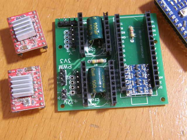

I offered you a pcb a while ago that has no wiringP9070045
Whilst I didn’t design in a jumper to select the voltage level of the PWM if you wanted 5v for some reason (bearing in mind that any device that is looking for a PWM signal at 5v will work fine on 3v3.) adding a single jumper wire to select LV or HV as the PWM source would be child’s play.
I didn’t see the photo with the components populated before & missed that the level converter was actually soldered to the board. That does simplify the wiring. Maybe I should get a couple of those boards from you for future use. I believe you would send one to me for a $1.60. How about if I send you $5 for 2 of them? You can PM me your paypal email or whatever way you want the funds.

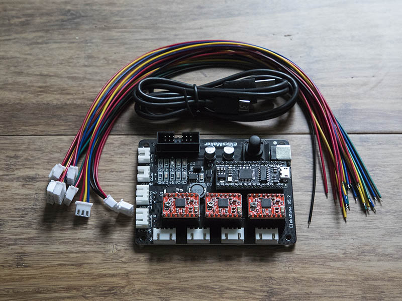

I receive a couple parts in this week. The EleksMaker Mana 3 Axis Controller Board arrived. It was $26.46 total from Aliexpress with the parts in the photo. That is a nice looking board. I also ordered a few things from Zyltech last weekend since they had a 20% off labor day sale. I got a 2040x600mm length V-Groove which should give me about 20" working area along the 2040 axis.

Since I had one of the 0.9 step angle motors, thought I would get another & use these on the laser engraver & see if the 0.9 degrees makes any difference. These are 40mm in height which is a little shorter than the 44mm thick one I currently have on there which gives me a little more ground clearance.

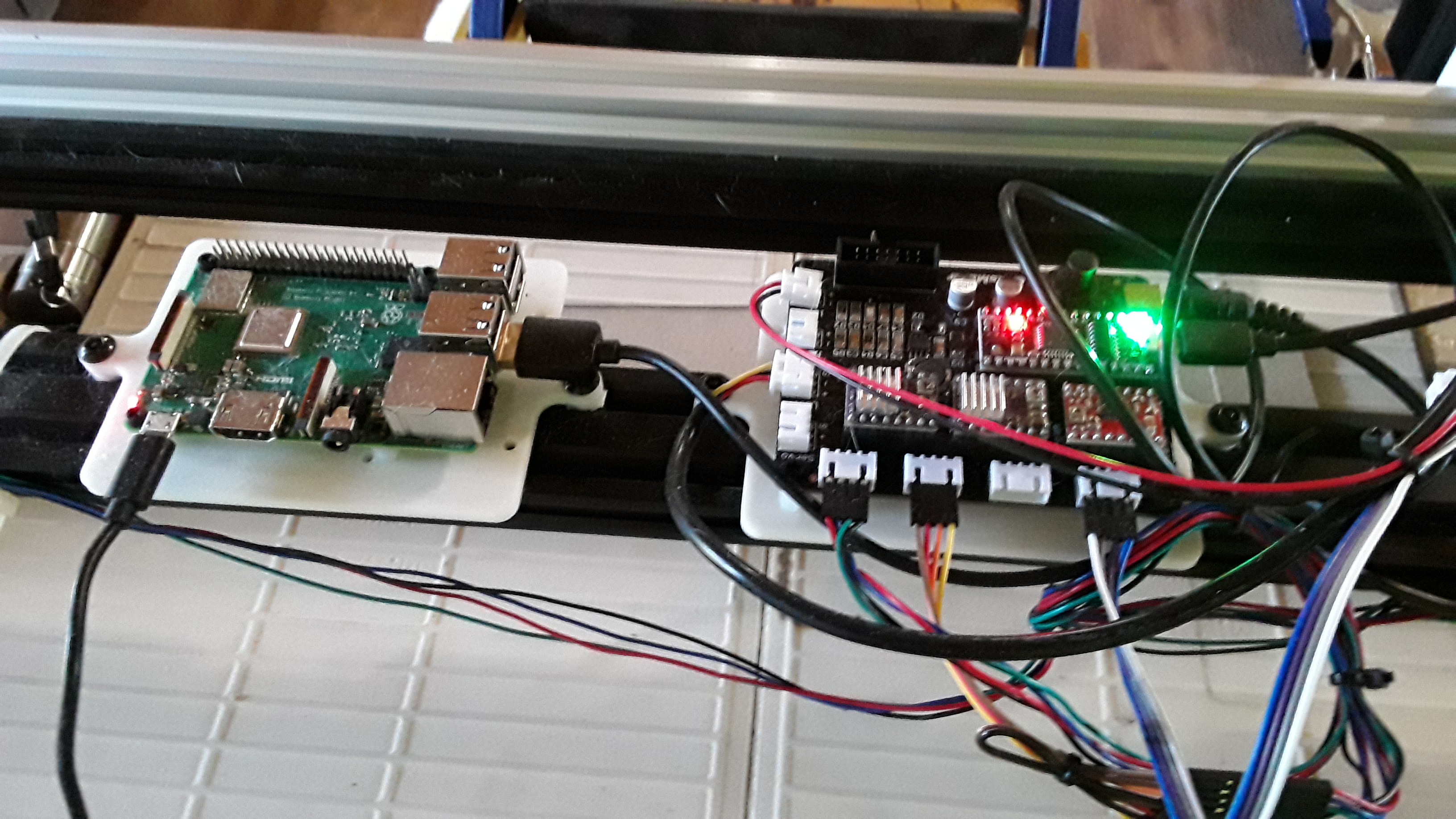

Thanks, Dave, for the board offer but now that I’m confident I can use the 5V PWM output to drive the Neje laser modules, I’m good. And I really feel I “need” the Z-axis most of the time so that Eleksmaker board suits me just fine. I’m really not sure what you’re saying about “being friendly to the CNC.js program”… I use all my boards with CNC.js almost exclusively and without issue. Here is the Pi/v1pi and Eleksmaker boards currently riding on my rolling gantry…

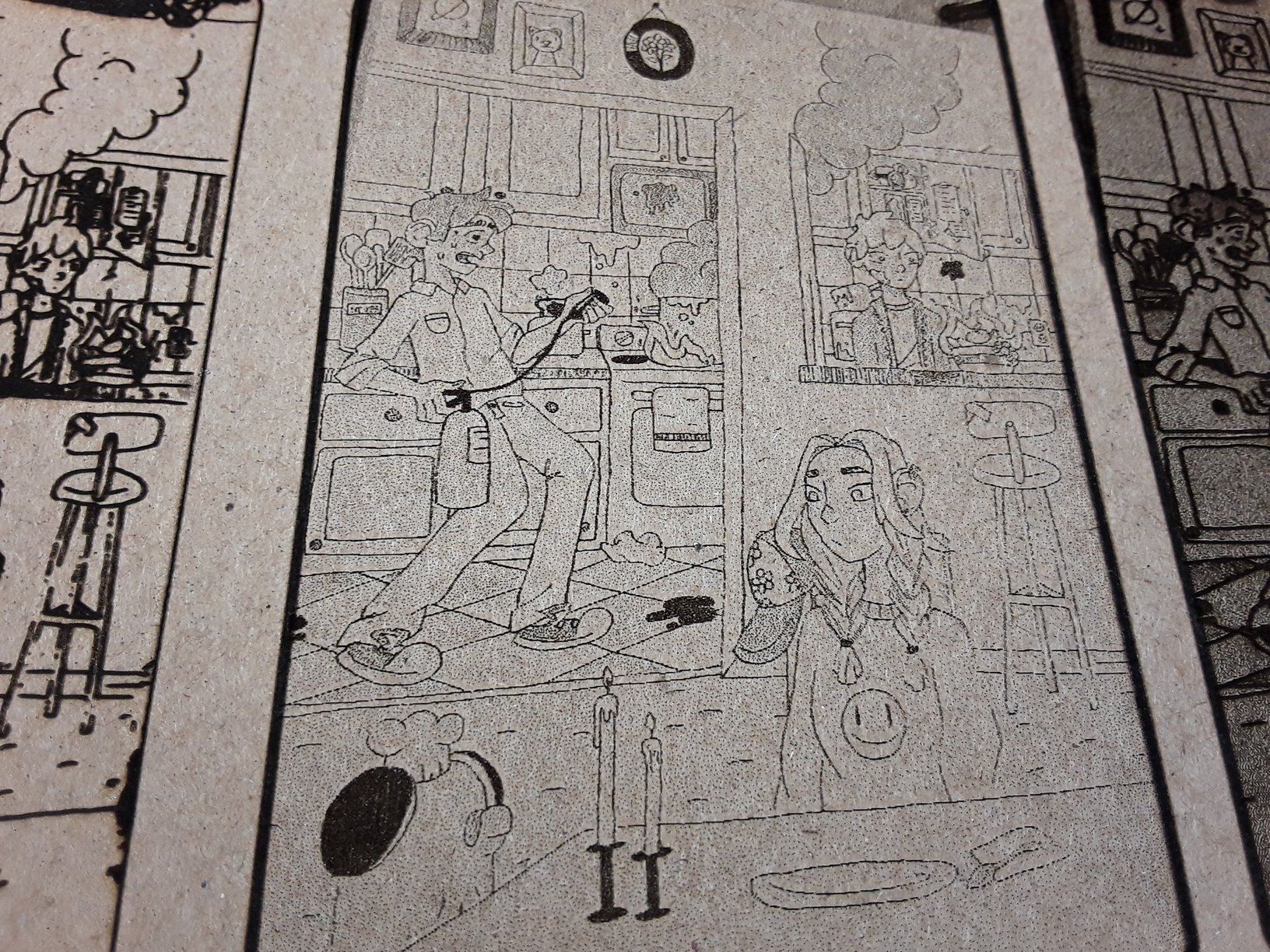

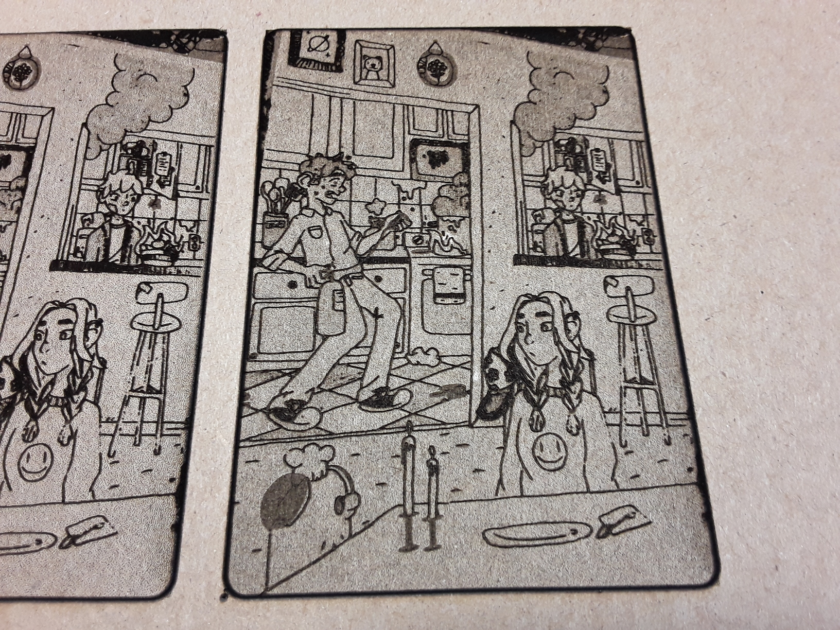

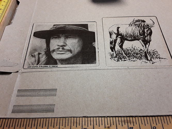

On my grand-daughter’s kitchen sketch, maybe 8" x 10" in size… I “lost” a lot of line thickness when I shrunk it down to a smaller size. So, I center-line traced the sketch in Inkscape 1.0 (a new feature) and kept it overlaying the original image. Importing to Lightburn and resizing as desired, I was able to defocus the traced lines layer by adjusting Z by 5mm, to thicken the lines, and then adjust back 5mm to best focus to raster engrave the image layer… all in the same gcode file.
Here’s the result without center-line trace…
and with defocused center-line trace…
