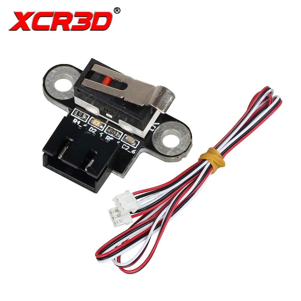

I was looking for JST 3pin cables to connect to the laser control on the Eleksmaker board & splice it to the cable that came with the laser. I could not find one with those search perimeters, but after having a hard cider it occurred to me, some limit switch boards come with these. Here is one for $0.85 with a 1meter wire that would be perfect. That is if the picture matches the part, but seems to be as reviewers have photos of their received part.
For future reference, does anyone know what kind of connector it is on the laser end. It does not match the 4 pin JST connectors I have, so it is not that.
The connectors you probably have are called JST-XH, they have a pitch of 2.5mm, they are most commonly used in Li-Po battery balance leads. The connector on the Neje laser modules are called JSH-PH and have a 2mm pitch, so they are practically the same…just a different size (and are a b**** to crimp…better to buy pigtails)
https://en.wikipedia.org/wiki/JST_connector
p.s. the ones you linked are 3 wire, better go for 4 wire JST-PH 2.0mm …then the connector will fit properly
https://www.aliexpress.com/item/4001235017139.html
Thanks for the info & links. The 3 wire connection was for the eleksmaker mana board end and not the laser end, but will get some of the JST-PH 4 wire pigtails so I don’t have to cut the wires that came with the laser. I prefer not to crimp those connectors either as I don’t always get it right on the 1st crimp.
I bought a couple of connector kits off aliexpress for a few dollors, 2 and 2.5mm pitch, that way you can fit the 3 wires into a 4 way female block so it fits the laser properly and there is zero risk of inserting the plug offset one pin. This type of purchase is never wasted money as you will always need odd connectors at some time.
