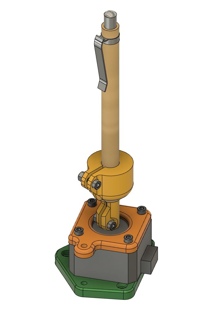

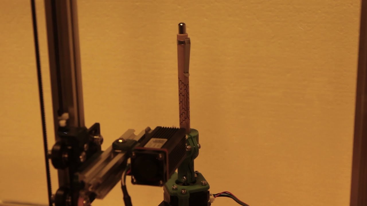

I couldn’t get anything to work right today. First problem which I should have foreseen was the wood is not flat. Second problem was getting that pen vertical. I tried several ideas, but was never happy with any of them, so I designed a special pen spindle holder. The nice thing is it is not a very long print and only have to print 2 parts. I spent a half hour modeling the pen as accurate as I could. Another advantage to this is the laser can get a lot closer to it. The pen should be pretty close to perpendicular to the motor now. If this works well, I will have to make spindle for a toothpick also.
I am finally getting back to this. After having several failed prints halfway thru the print or so, I simplified my idea and made it so not overhangs were happening.

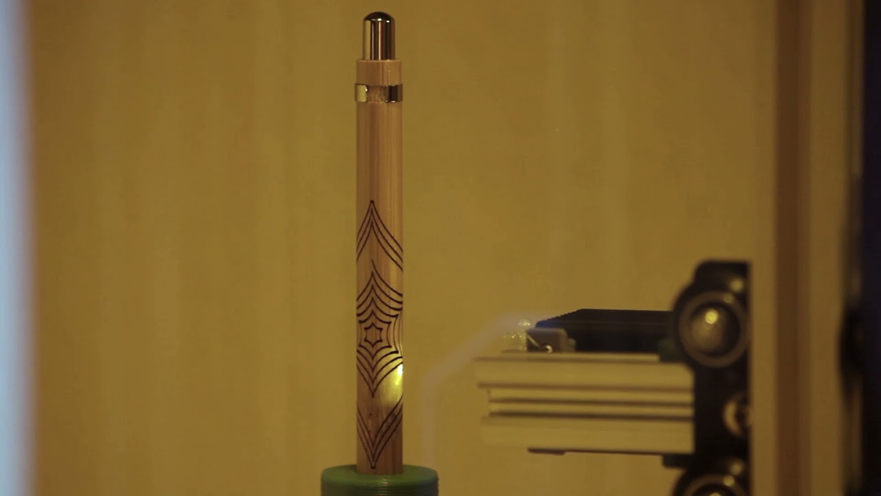

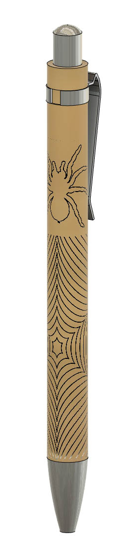

I was playing with ideas for engraving on these bamboo pens & decided to play with sandify. I set the machine dimensions to the dimensions of the area I was engraving. Here are my settings I changed:
machine size 63,27
Web shape
large circle radius of 1
initial width 3
Initial height 2
X offset 0
Y offset 0
Rotate 0
Number of loops 18
Keep in tack
Scale of 100
I exported the data to gcode & wrote a lisp program to read the gcode & create a long polyline in intellicad. I took out the lines that connected the web. I found a spider dxf file from Insects | Free DXF Files | Maker Union I wanted to see what it looked like wrapped around a pen, so I inserted a decal of the created graphics into fusion 360. I might put a little more detail in the spider & see if I can calculate the spider web to wrap close to exactly around the pen. So far it looks pretty good to me.
Engraving of a spider & web wrapped around the bamboo pen came out well for the first pen engraving.

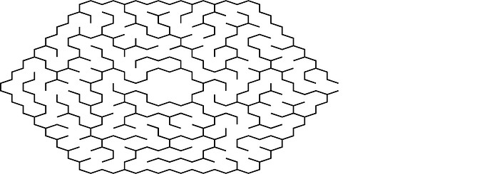

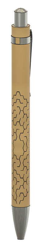

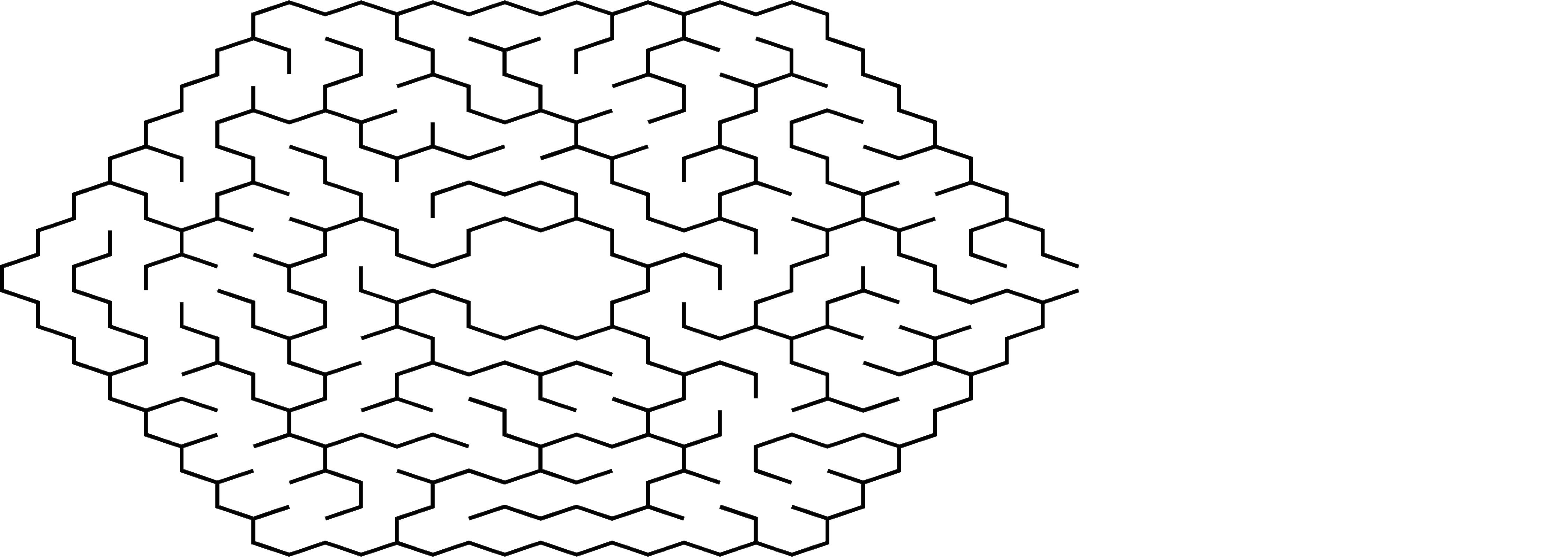

How about a hex 8 cell maze ( Maze Generator) wrapped around a pen.
That’s incredible!
Here is a video of the engraving of the maze on the pen. I found some free artwork of a running squirrel, added it to the beginning of the maze & couldn’t resist adding a cute title for the video.

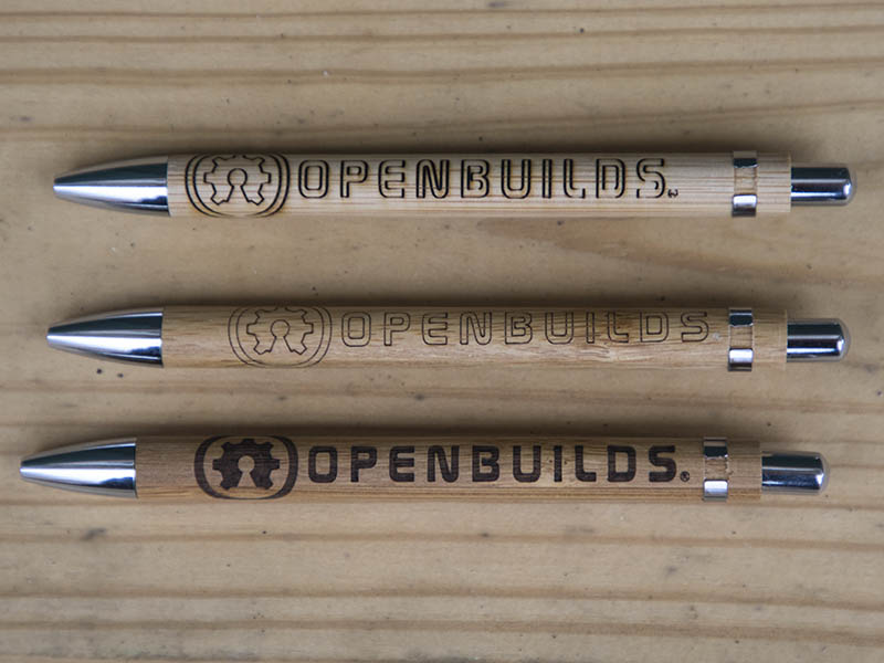

I was having a problem with the openbuilds logo not coming out well. I had the rotary settings wrong. Although they worked, I noticed the engraver was moving faster along the X-axis than the rotary axis.
The settings I had before were:
$102=27.000 ;Z-axis steps per millimeter (Rotary Axis)
243 in the Lightburn rotary mm per rotation
I essentially had these backwards, but the numbers work out to more even ones now and make more sense. Don’t know how I missed that before, but it is correct now.
The correct settings are now:
$102=200 ;Z-axis steps per millimeter (Rotary Axis)
32 in the Lightburn rotary mm per rotation (DRV8825)
The top pen in the image was with the old settings. You can see where it was coming out lighter along the pen (X-axis) which is where it was moving faster. I was quite surprised that the ® on the bottom pen was actually readable.

I uploaded the design for this simple Pen turntable to thingiverse along with source files in f3d, step & skp. Simple Pen Spindle Turntable Laser Engraving by GeoDave

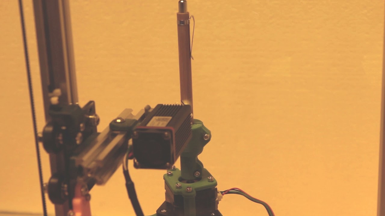

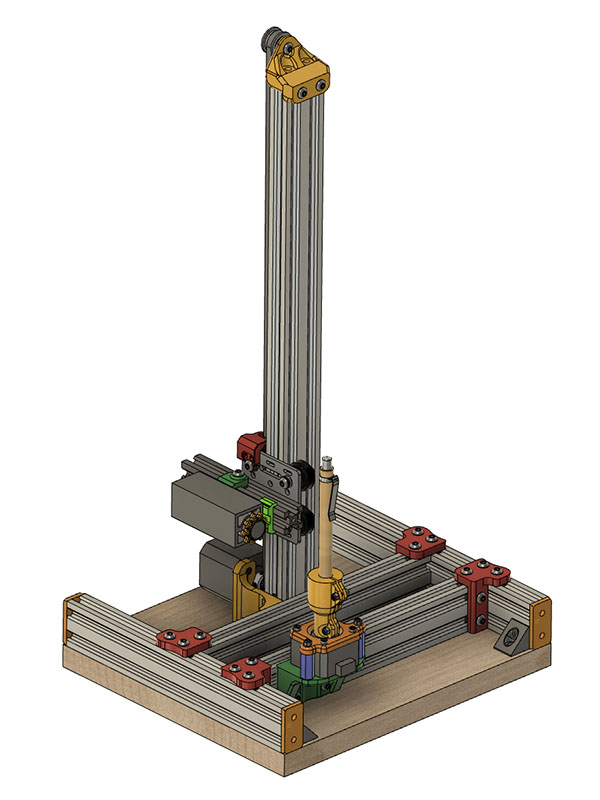

I have been playing around with the idea of a dedicated rotary axis laser engraver incorporating the simple turntable idea. I started a build log of it on openbuilds site here: Dedicated Compact Rotary Axis Laser Engraver | OpenBuilds
Here is what the current design looks like.

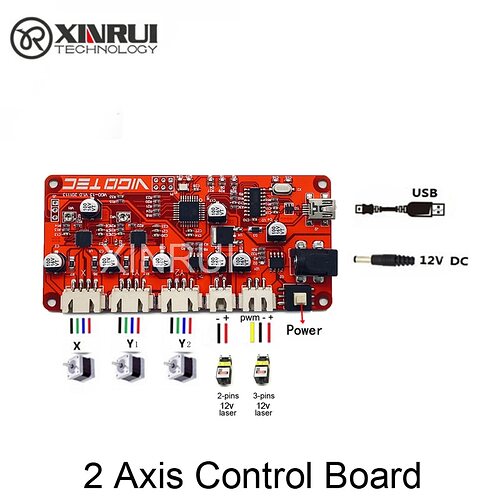

Anyone have thoughts on this 2-axis grbl controller board? Looks to have soldered on DRV8825 drivers & 2 or 3 pin connections for laser & might be perfect for my dedicated rotary axis engraver.

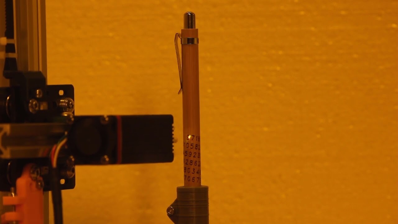

How about Pi to 100 decimal places engraved around a Bamboo pen?
