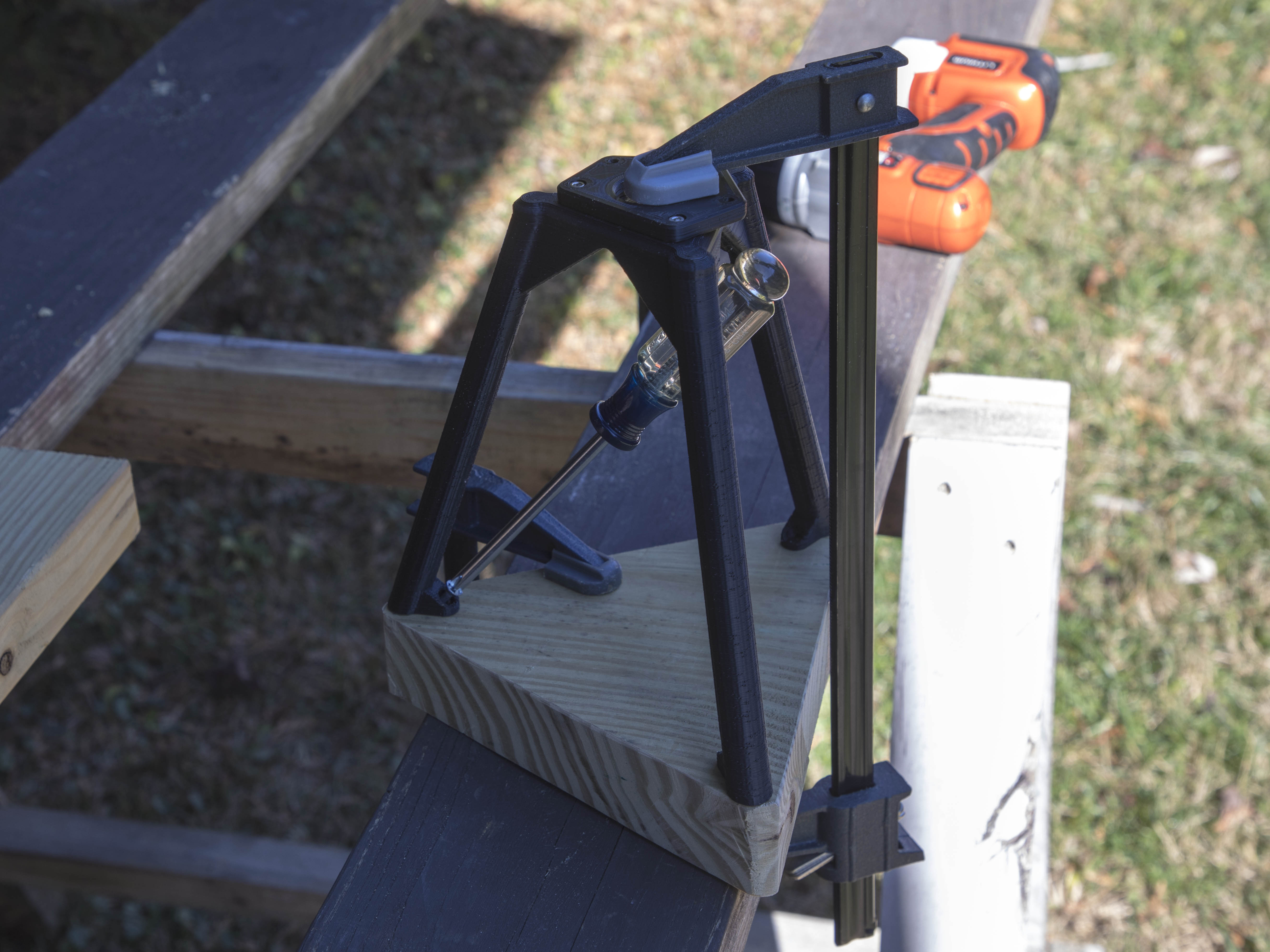

I worked on a table mount for my turntable today as I wanted a better table to mount it to. After looking thru a couple of stores today, I decided to take a stab at making a 3d printed table. The turntable is fairly light, so the table doesn’t need to be that beefy. The hex legs are 16mm diameter, legs are 220mm long and splayed out at 73.7degs. The round supports are 6mm in diameter & initially drawn as 6mm extrusions & then rounding the edges. They might need to be thicker. The table is about 208x180mmx226mm. I have mounting holes for the table to mount to base plywood & the turntable has 3 mounting holes to this. Print time is estimated at 5 hours 42 minutes. I also made some hexagonal spacers instead of using round ones to see if they will work for smaller objects to cut out the additional adapter for smaller objects. I added a rounded slot on outside edge of each of them to attach another rubber band for tensioning. I can add an addition 3 flat shims between the hexagons if needed. Anyone have suggestions for this design?
I had some problem printing what I call a stool for the turntable. I had 2 failed prints about 1/2 way thru. The nozzle hit the overhangs & pulled it off the bed the 1st time. The 2nd time, I used glue stick & it stayed on, but shifted the carriage when it hit this time, so had a layer shift. Since it is screwed to a piece of wood 1.5" thick, it didn’t really need the reinforcement, so changed the design to just 45 deg braces at the top. It still hit legs when it was about 9 minutes before finishing it but was usable. I probably needed to have a lift Z after it reached a certain height along with a retract on layer change after a certain height to overcome this (Using PrusaSlicer 2.4 beta4). 20/20 hindsight, I probably would have made this stool in 2 parts & bolted them together. At any rate, it seems like this should work sufficiently.
I had some left over 2x12s, so I cut the base out of this. The wood gives it a pound more weight & makes it more stable & brings the total weight of this to about 2 lbs. If it needs more stability, I will add another piece of wood to the bottom of that one.

I clamped it down so I could drill the holes. They had to be at an angle to be able to drill & screw them in. The drill just barely fit. I am hoping to test it sometime today.
