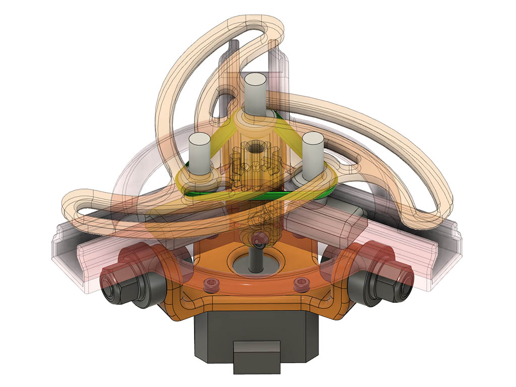

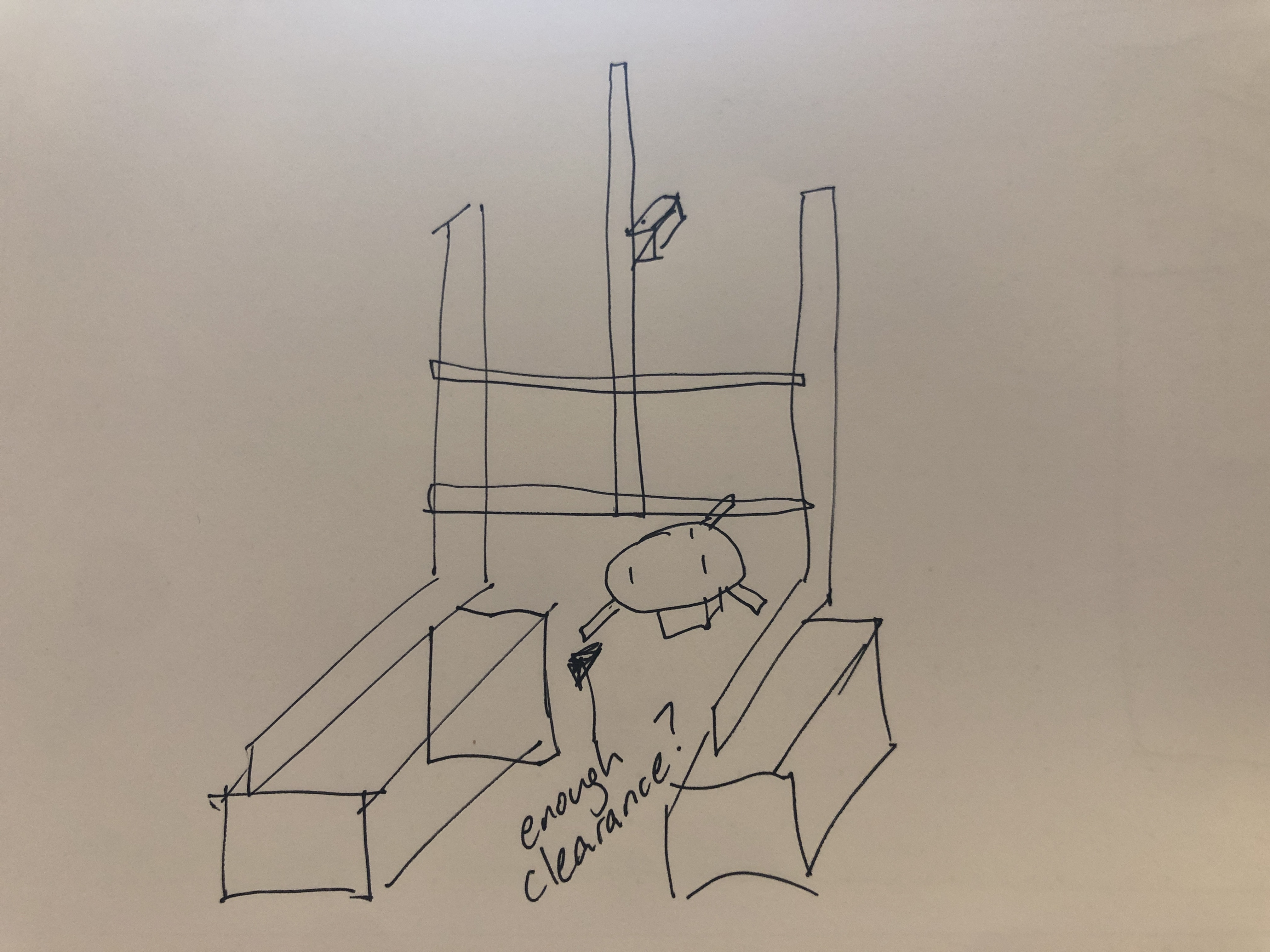

Yeah I was afraid of that. What if the pegs had a live hinge at the base of them? Not sure how that would be modeled to print easily and it wouldn’t stand up to much use but then then could fold out of the way when you pull them out of the clamp grooves. Probably more work than its worth.
Or threaded posts could work and then you just unscrew them and flip the clamp bit around and then thread them back in again. That way you could actually have different length bits the posts thread into so they don’t stick out so far.
I’m thinking the bad part of them sticking out so far is that they will hit the vertical rails of the laser support. If that’s the case, what if you put the gantry on top of something so that the aluminum rails are higher than the clamp bits that stick out. Then they may not be as big of a deal.
Clearance was my main concern, but with the z-axis 2020 & the machine being more rigid it might not be a concern. I am tired of looking at this turntable design for now & will put it aside until I or someone else gets a better idea for it.
Here are some interesting ideas someone at openbuilds pointed me to.
https://youtu.be/orGCtB_oTl8

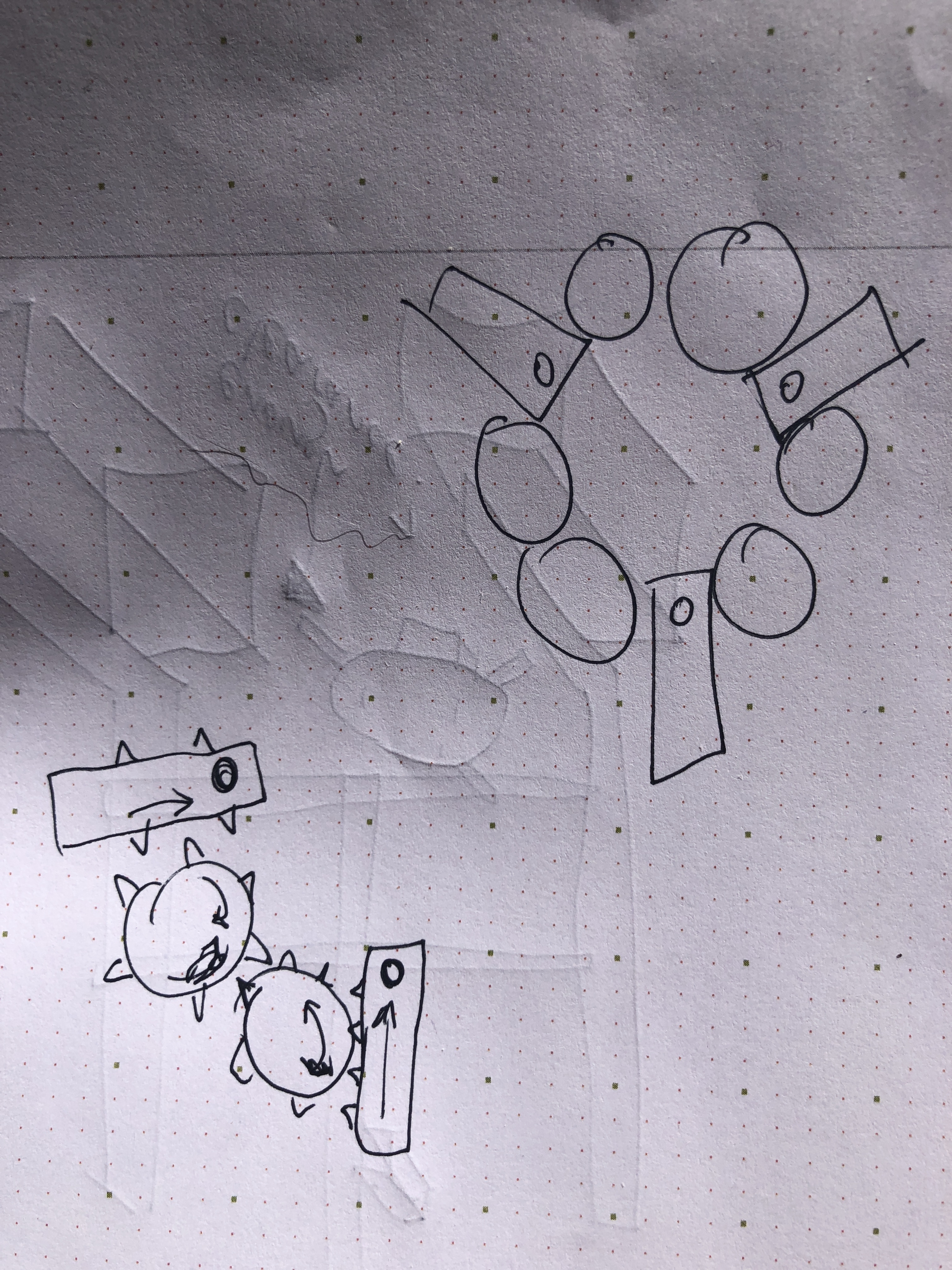

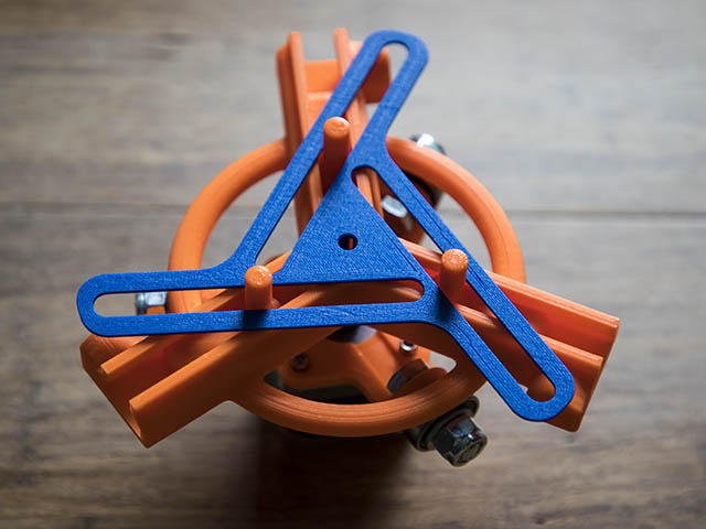

What if you made the top plate solid with just straight slides for the pegs, and put springs behind the sliders? That way you don’t need set screws for the sliders, and you can just put a plug in the ends as a stop, and they won’t stick out. This also will auto-center the workpiece.
What about using gears to keep them mostly aligned? You don’t really need to keep force on the mug do you? It’s really just that you want the pegs to stay equidistant from the center of the platform.

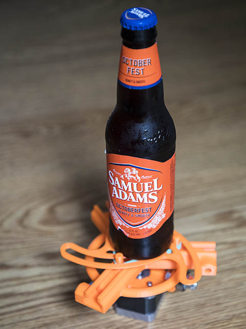

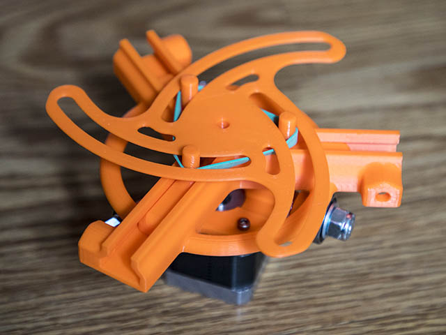

I like the spring idea, but then you made me think about using rubber bands. Thanks for triggering the light bulb in my head. They are a perfect simple solution with no other electronics needed. I will have to adjust the sliders a little to give a little lip under the pegs & make the pegs probably a little longer. Here are a couple of photos to show proof of concept. Just when I am ready to put this project aside, ya’ll pull me back to finish it.

Ahh, yeah, that makes way more sense. I was picturing hollow work pieces like a tube, or an upside-down mug. :sweat_smile:

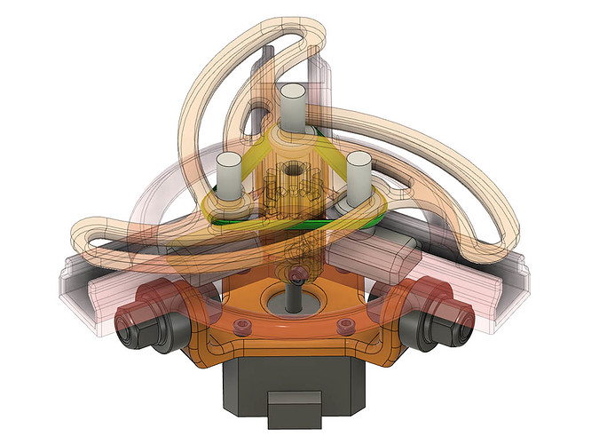

I had to try the straight slots to see what the problems were with them versus the curved slots. During the design, one problem that is quite apparent is the end of the slots are a lot closer to the sides of the other slot next to it. They also don’t move well along the straight lines as they do along the curve. I am printing the new design today & maybe try it tomorrow.
IMG_1505_640x480
Is the top cam plate necessary? Won’t the tension from the pins naturally center the piece? I’m just guessing, I’m no engineer!:sweat_smile:
EDIT: Just went back and realized the motor shaft connects to the cam plate. :frowning_face_with_open_mouth:
It was a good thought. I tried it & no dice. It does not necessarily center it without that top plate.

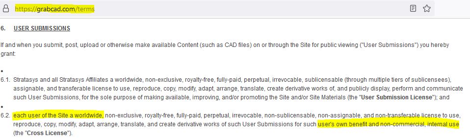

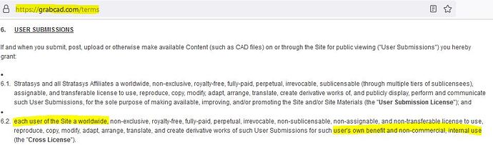

Since this self centering turntable is a derivative of a design I found on grabcad, I am wondering if I can publish it to thingiverse as a non-commercial license.
Is anyone familiar enough with this lingo to tell me whether I can do it or not. Here is info from grabcad’s website concerning the use of the data.
Sounds to me like if you don’t sell it, your fine. :man_shrugging:
You are probably right, but did not feel like I should. I did realize this morning these sliders are just like the Trammel of Archimedes & I drew one of them up a while back. I will just redraw it based on that design, then I won’t have any problems. The top is not a problem as I drew that based on the longworth clamp construction method. I want to make one with a little bigger diameter anyway. Here is a link to the Trammel of Archimedes I mentioned. Remix of Trammel of Archimedes by GeoDave - Thingiverse
