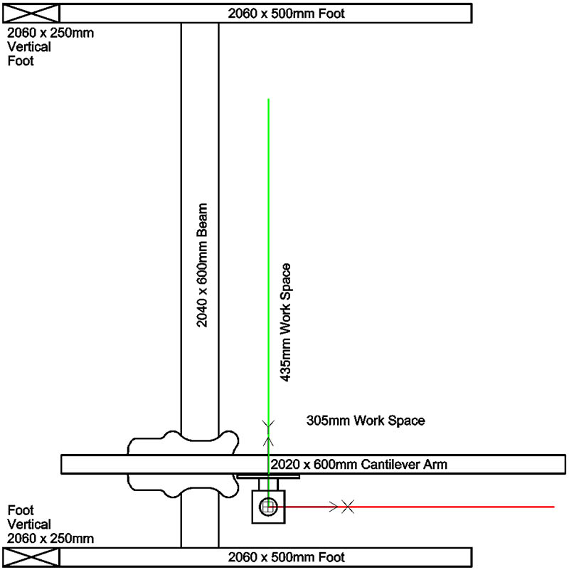

Lets start off with the X & Y layout. Direction of the motors depends 1st on what direction your Main Beam axis is & your Cantilever axis. Using the V-Slot sizes in the below diagram will show the direction your motors should go in the positive direction along the Red Line (X-axis) & the Green Line (Y-axis). Where the Red & Green Lines intersect will be 0,0
If your motors are moving in wrong direction, you can either turn your wires around on the board connection if they are dupont connections or use the grbl settings as shown here:
grbl/settings.md at master · gnea/grbl · GitHub
$3=1 (Invert X direction motor)
$3=2 (Invert Y direction motor)
$3=3 (Invert X & Y direction motor)
If you use the Cantilever arm as your X-axis you might also want to consider rotating your laser gantry carriage to the other side of the cantilever as 0,0 the edge of it might hit the 2060 feet & you might have to change the limit switch brackets. You can see about where the laser is located in the 2 screen shots.
If you are planning to use the rotary turntable at some point you might want to consider this. I am currently using the X-axis along the main beam as I wanted the longer axis to be my X, but since adding the 2nd 2020x600mm back beam, I made my cantilever arm 700mm and am able to get a 435x435mm work area and cantilever seems to be more solid than with the 600mm with the single 2040 beam. The only reason I would start using the cantilever arm as the X-axis is because Lightburn currently does not have a way to use Y-axis for what they call the “scanning axis” in rotary mode & they say they are not likely to add it. Looking at their G-code, it would be easy to make a post processor for this to just substitute G1X to G1Y & G0X to G0Y

I am currently not using the limit switches on my machine as they would not work well for me with the Eleksmaker board. I am using x,y & z limit switches on my openbuilds Sphinx CNC machine & the only settings I changed were $22 & $23 for homing. I had to invert X & Y homing on that machine, so I had to also change $23.
$22=1 (homing cycle, bool)
You might also have to change
$23 = (homing dir invert mask) Probably only need to change that if you change the $3 direction mask as shown above.
Since you are not using a Z-axis, I believe homing should work mostly like your 3d printer. Someone else might give a better understanding of the limit switches than I can.

You are welcome. That info had not been explained well before in this thread, so thought others could also benefit from it. One other thing to consider if you move the laser carriage to opposite side of 2020 cantilever is to rotate the motor mount 180 degrees since the belt path is offset from center. The belt path offset was needed to miss the wheel locknuts. If you are concerned which side your wires are attached to motor, you can rotate the motor for the best wire management. Looks like the idler mount STL file would need to be mirrored also. Maybe I will make a mirrored version of each of those parts.

so i was able to finish the build, got homing to work and laser fires but im just now realizing that using 2020 for X axis was a really really bad idea…lol… I Shouldda stuck with your original build plans but i have so much 2020 thats just laying around collecting dust. Either way its clearly not going to work.
So im gonna buy some 2040 and 2060 but i noticed @geodave that a new design you made uses 2 x 2020 for the X axis vs 1 2040… Based on the photos you uploaded the 2X 2020 looks really stable and beefy…but not sure. …based on your testing which one do you like more? ie more rigid / stable?
Im only planning on using the laser in horizontal (regular) not vertical…not sure if that matters.
I can go either way at this point and the cost will be about the same for either option… cheers

I am not an engineer, but since the double 2020’s are spread apart just as much as my 2040 & 2020 should be about the same. I did not have an extra 2020 the same length or I would have tried it. I used that engraver with the plastic feet for a while & it will work. The V-Slot for the legs does make it more rigid and balanced. While you are ordering the 2060, you really should consider getting 2 - 2060x250mm & 2 - 2060-500mm & brackets to be able to make horizontal or vertical since it opens up some more possibilities for engraving. What laser & controller do you have on your machine?
