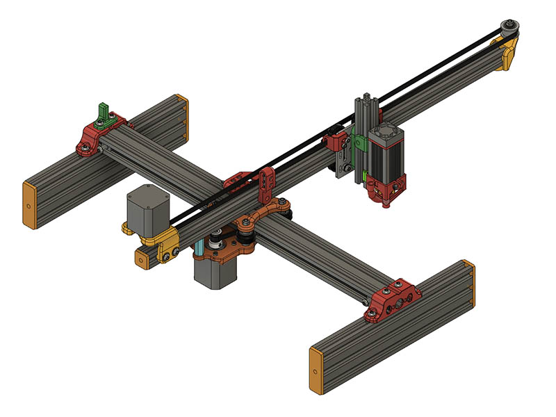

I spent most of today working on making a fusion 360 assembly of all the parts. Here is what it looks like. The 2060 endcaps press fit in so no need for any hardware on those. I might try a press fit design for the 2020.

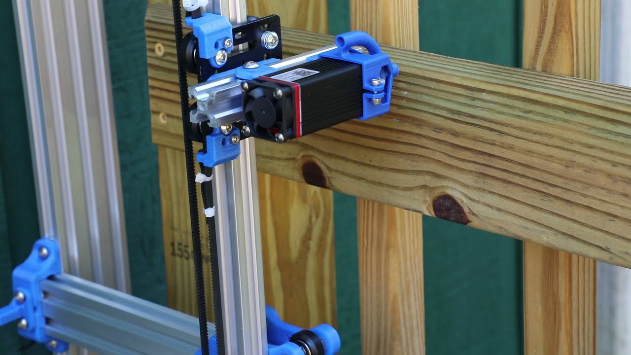

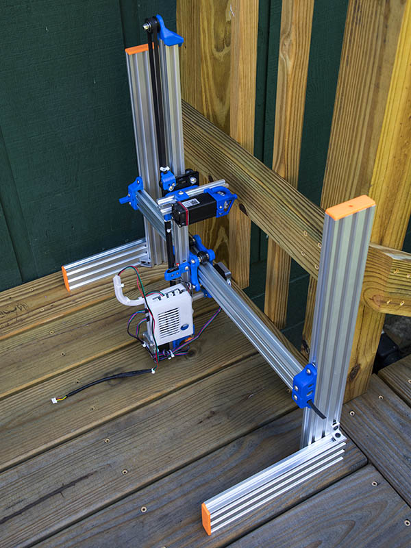

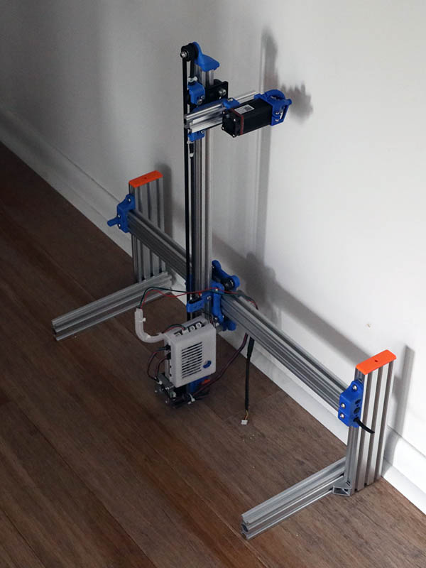

This machine might be more versatile than I thought. Here is an idea I had not considered. Mark at openbuilds asked if it could do vertical lasering with this setup. I moved the feet back enough for the motor to miss the floor & put a 2040 on each foot with one angle bracket & feels like it should work. It might need a stronger connection than that, but having only one screw connection on each member would allow it to adjust a little off vertical if whatever you are burning is not quite vertical. I would also put the 2040 on the outside of the 2060 feet for better clearance of the back motor. A 2020 might also be enough to work, but 2040 felt right to me to test. This could work similar to the LaserPecker, but with more burning room. What do you think?
Now you are fighting gravity one of the larger nema17’s might be needed for the up/down (Y) axis
It stays in place by itself except for initially moving a few mms & is not a lot of weight. Think the motor I have is rated at 1.5 A, 0.42 Nm, 59 ozin. Total weight of carriage assembly is probably a little over 3lbs. Once I get it stabilized & enough ballast on the bottom to keep it in place I will test to see that motor is enough. I am going to cut a 1 meter length of 2060 in half today & change the legs from 250mm lengths to 500mm lengths so I keep configuration set for either situation. That makes the machine only 1 lb. 3.5oz heavier. I might just put a piece of 2x6 board on the back as that might be a better weight ballast for it. I could probably go ahead & test the movement before making these changes, but will see if I cant get the 2060 cut first. My problem with cutting the aluminum is covering my miter saw to keep the shavings from going everywhere. I have a little 7 1/4" Kobalt sliding miter saw that works well for cutting these.
I would say the first test looks like hardly anything to change. It does have some settling creep, but that should be easily fixed by making a plastic block to replace limit switch & just slide it to meet carriage & make that Origin for that axis. I am quite surprised at how well this worked on 1st try. Maybe I will try a real test tomorrow on my CNC table leg. Someone commented on the video that reminded to look into the grbl settings again. I am going to set $1=255 to keep motors energized & see if that solves the settling problem.
Here is the video.
Here is the current setup. Original feet changed from 2060x250mm to 2060x500mm. I used the 2060x250mm for the now vertical feet using 2 angle brackets on each side. Weight is about 8 lbs. 10oz. Since the machine does not move very fast, I did not use any additional ballast.
