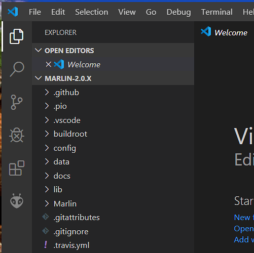

I’ve tried uploading via platformio but the blue banner is missing the compile (checkmark) button.
I only see the left most buttons everything to the right of the home button is missing. I’ve tried uninstalling and reinstalling. I’ve restarted my computer, just can’t figure it out.

The alien head on the left is the platformio plugin. You can click that and then I think you need to use the platformio buttons to open the project instead of the file menu. It is goofy, I know.
Arduino should be easy too though. At least for ramps. If you want to try that, post a screen shot with the first error.
If it is installed correctly that means you just opened the wrong folder for it to be automatically recognized. When you use “open folder” make sure you are selecting the one that contains platformio.ini directly, if it is one deeper it is not automatic.
