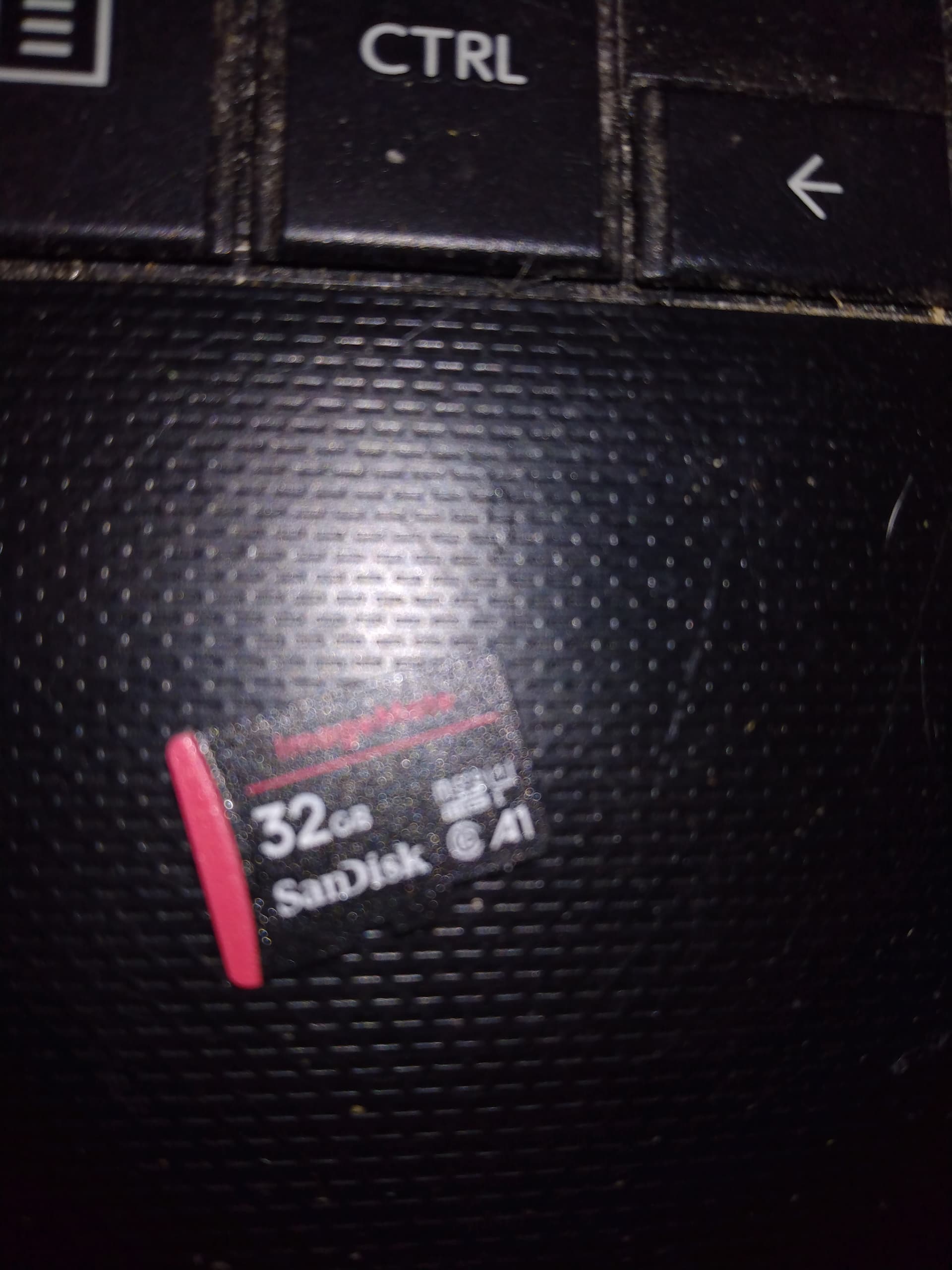

Cant connect to boad usb or wifi
fat32
windows 10 and 11 also tryed an old xp comuter
i can read disk on computer also usb ports work on comuter with other devices
yes i did but it didnt find anything
The only thing I can read on that picture is “A1”.
Jackpot CNC Controller - V1 Engineering Documentation - " No memory card showing up - Try a class 6 card, or slower formatted in fat32. New fancy high speed cards are hit or miss. A1 rated cards seem particularly troublesome."

We already know your card is likely part of the issue. We just need to figure out if you have used the cp2102 drivers linked in the instructions.
yes still no usb conection but changed sd card to different brand it works
Did you download and install these UART drivers for the Jackpot?
You need them to connect over USB to the board.
